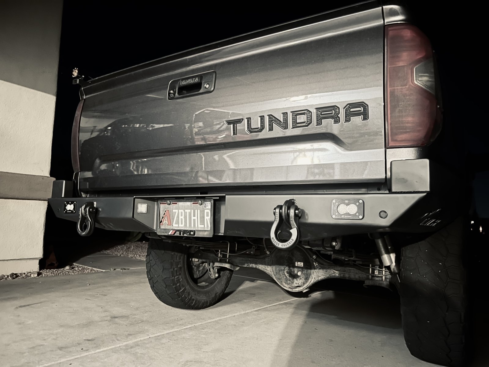

    Pair of moose knuckles to finish it off.

    Thanks for the info. I have an Expedition One rear bumper on the way, so I am in the same boat for the BSM sensors

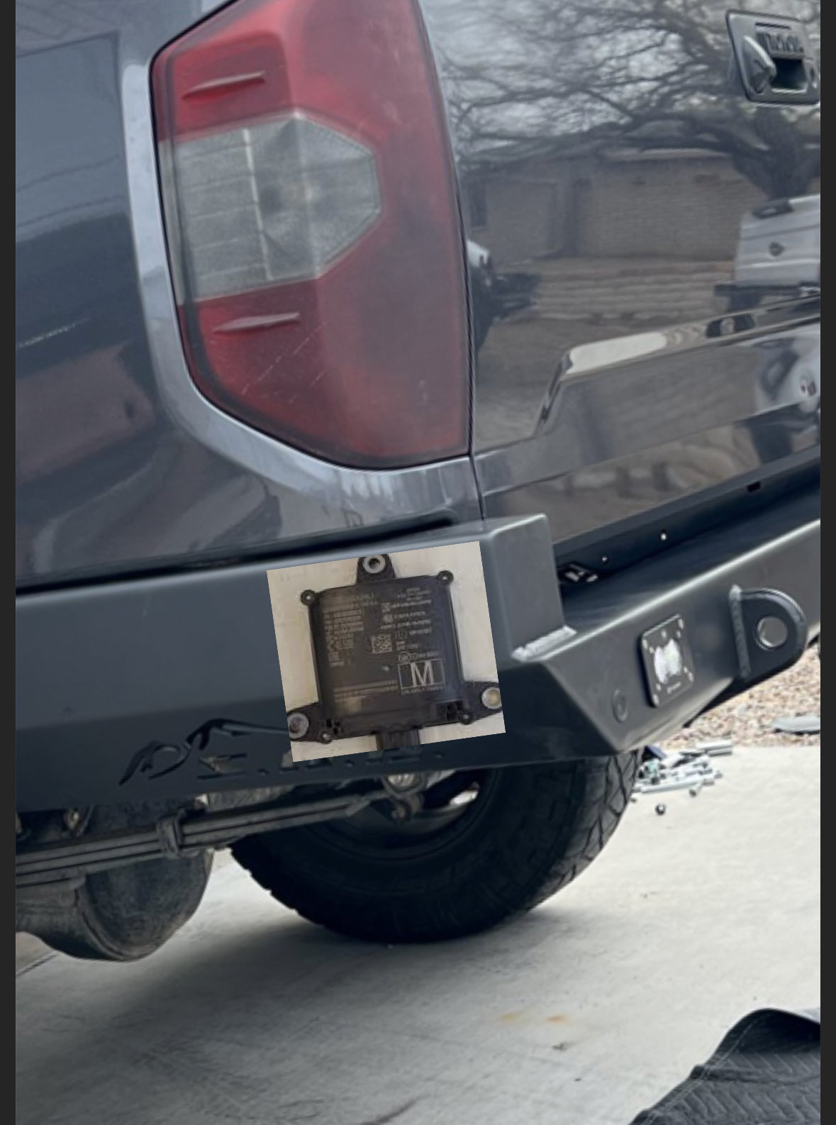

  15. Feb 29, 2024 at 9:25 PM
    #135
    Mater
    Mater New Member
    Feb 23, 2019
    #26579
    3,501
    Nick
    SD
    2016 MGM Platinum
    And I’d be willing to bet you could make it work here if you got the tree protectors.
    At least my old sensors don’t seem to be super sensitive. I plugged them in and had them dangling facing out. Didn’t throw a “see dealer” message.

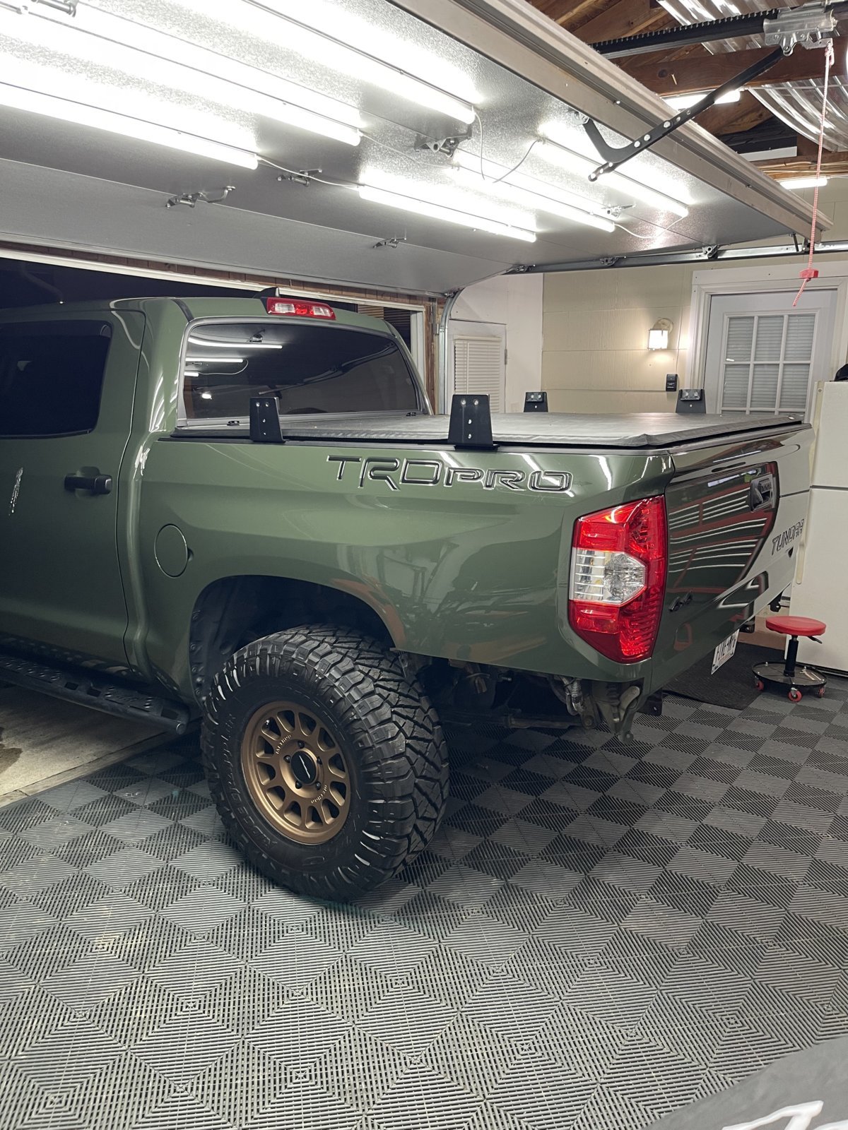

  27. Mar 11, 2024 at 1:26 PM
    #147
    FiveO Enduro
    FiveO Enduro New Member
    Mar 21, 2020
    #44167
    40
    Buffalo, NY
    2020 Army Green Pro

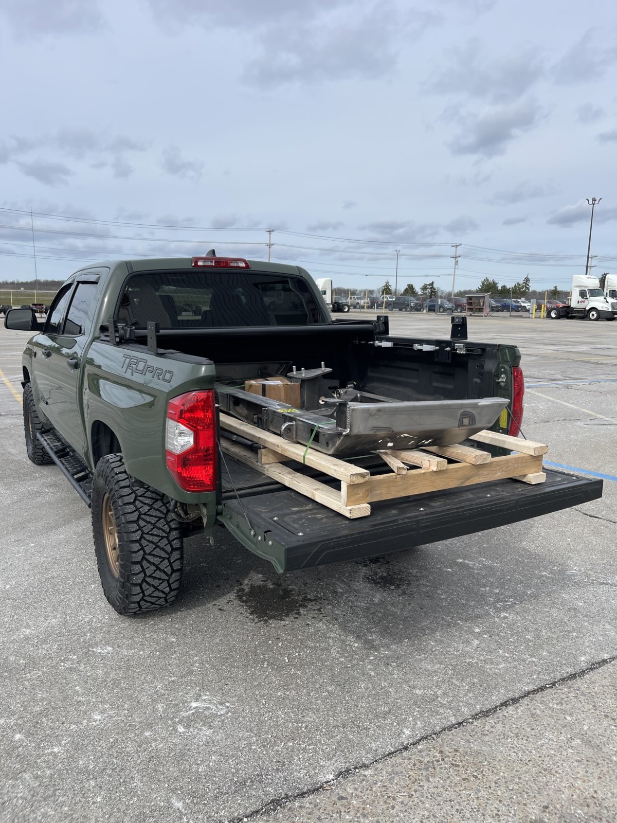

    Update: I finished up the hard part of cutting up the bed side.. at least I think. I just picked up the bumper and prepping it for Steel-it.
