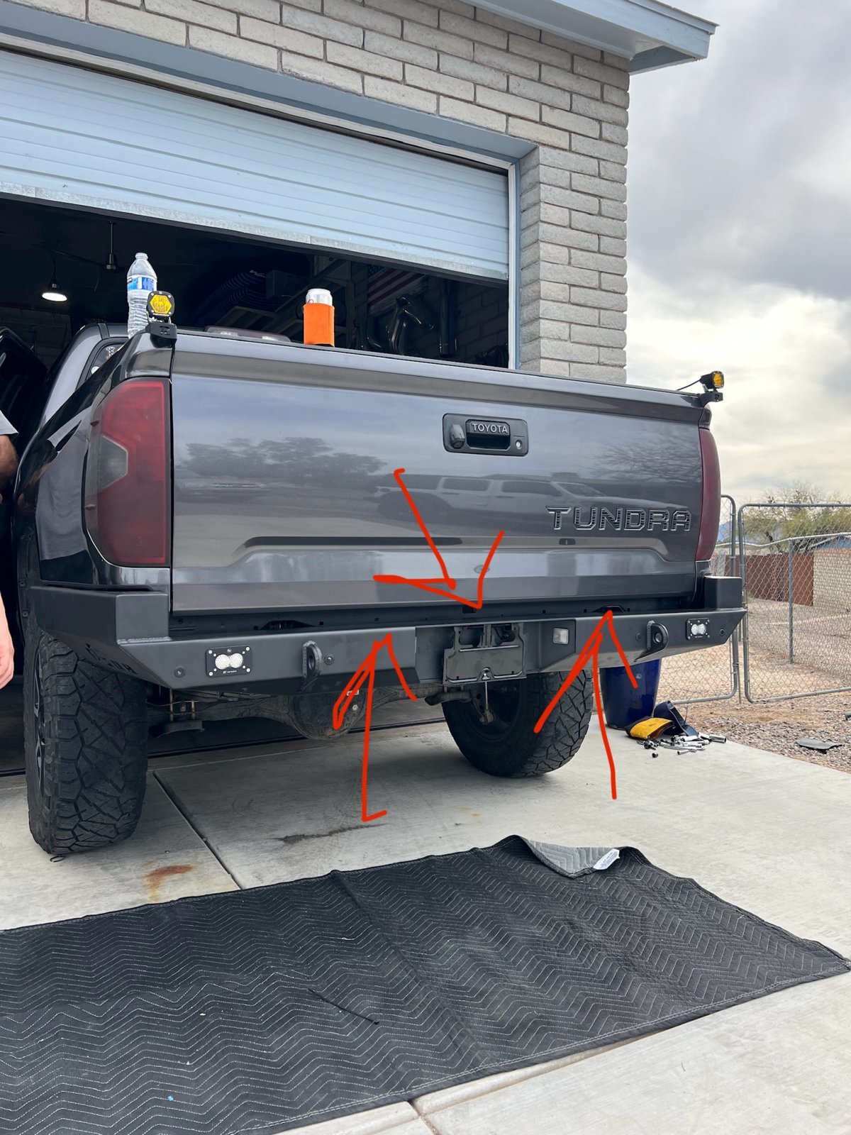

    It's about 7.25" higher and 6" further forward.

    Only pulled our travel trailer once with the new bumper and no issues. It’s a 30’ 5.5k lbs keystone bullet.

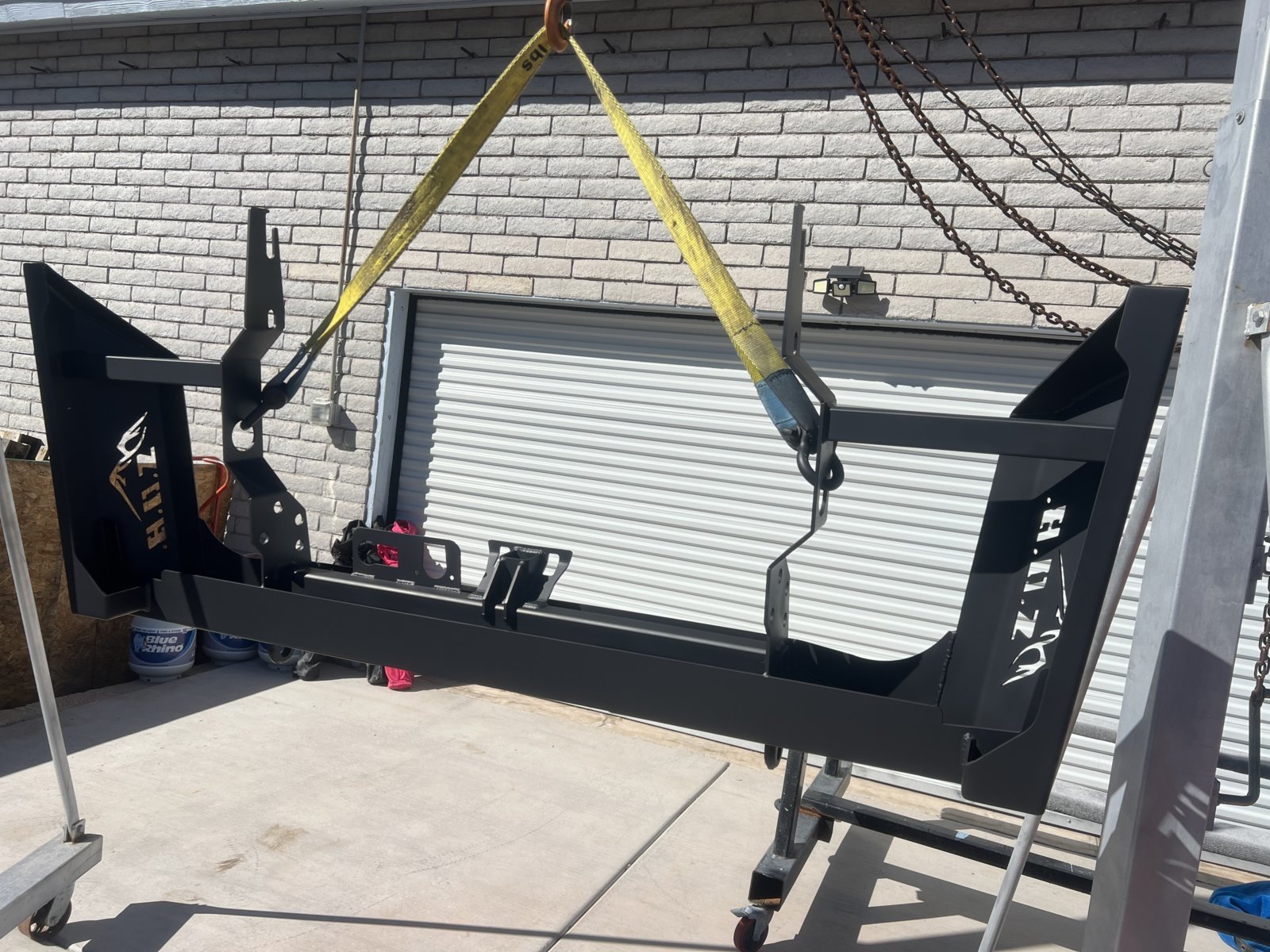

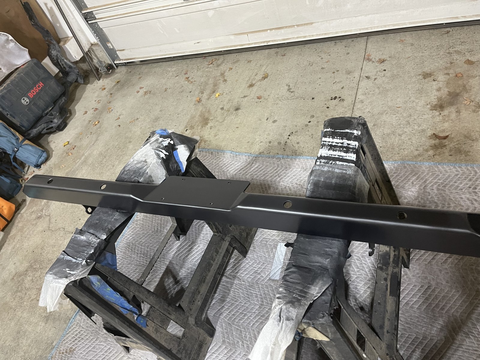

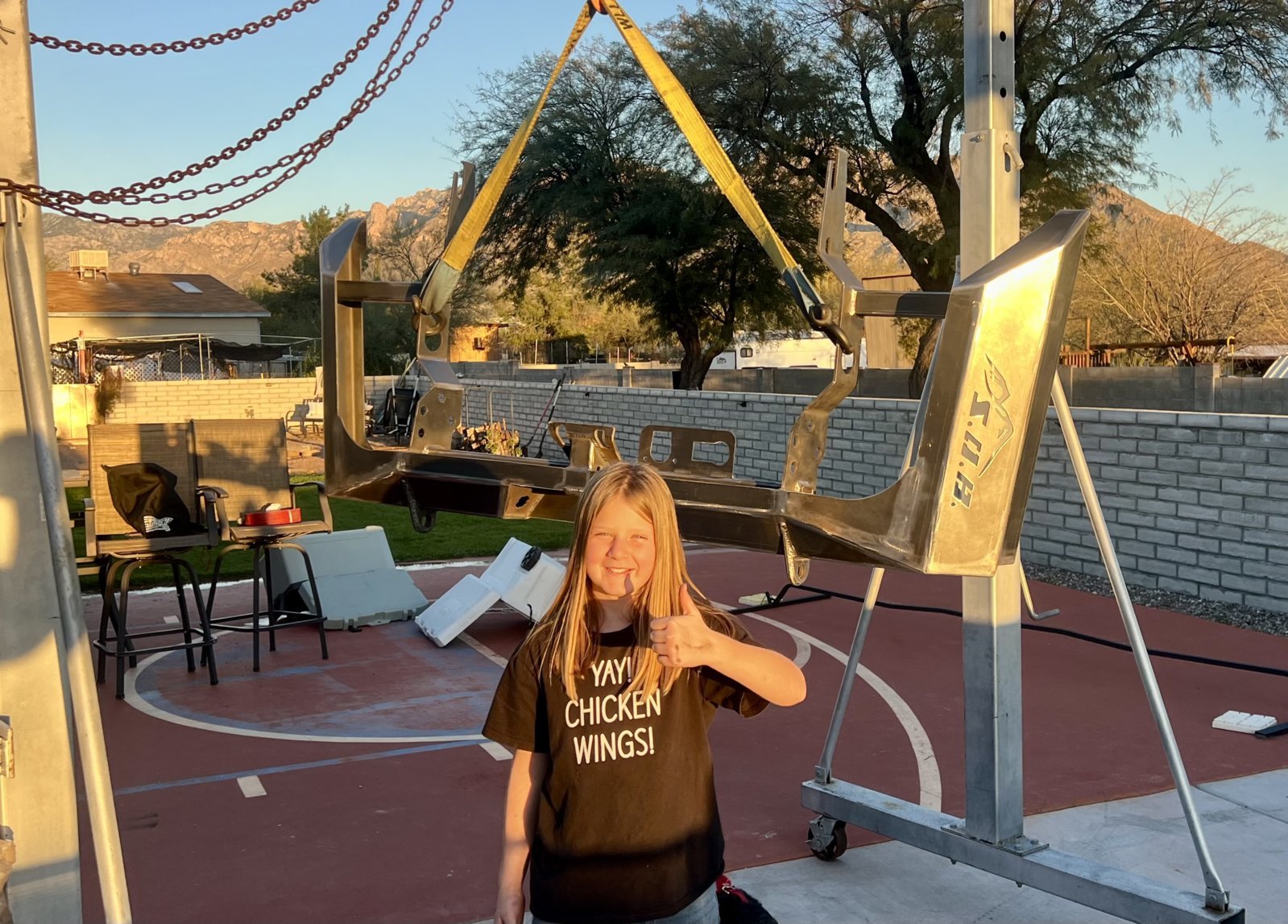

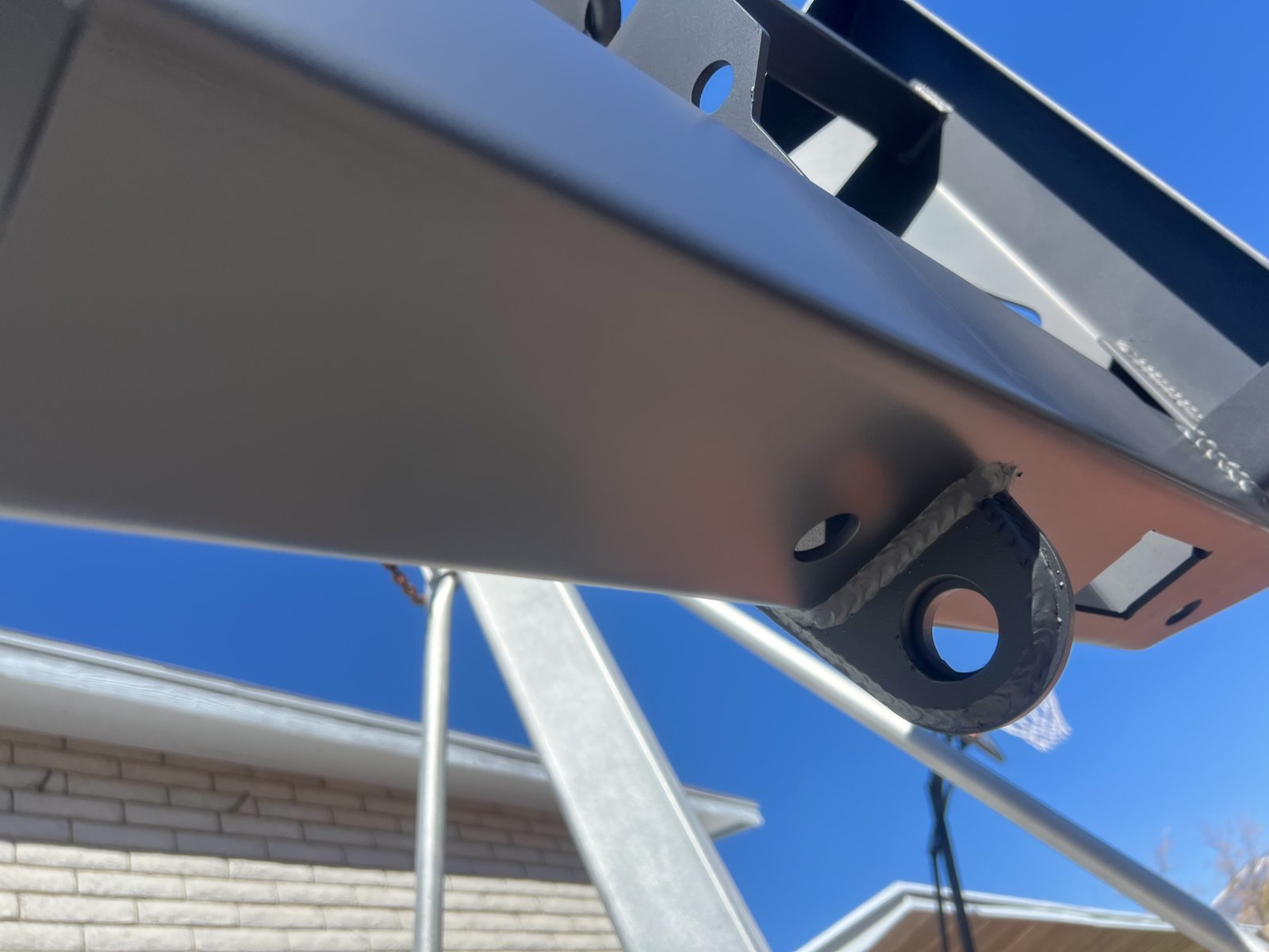

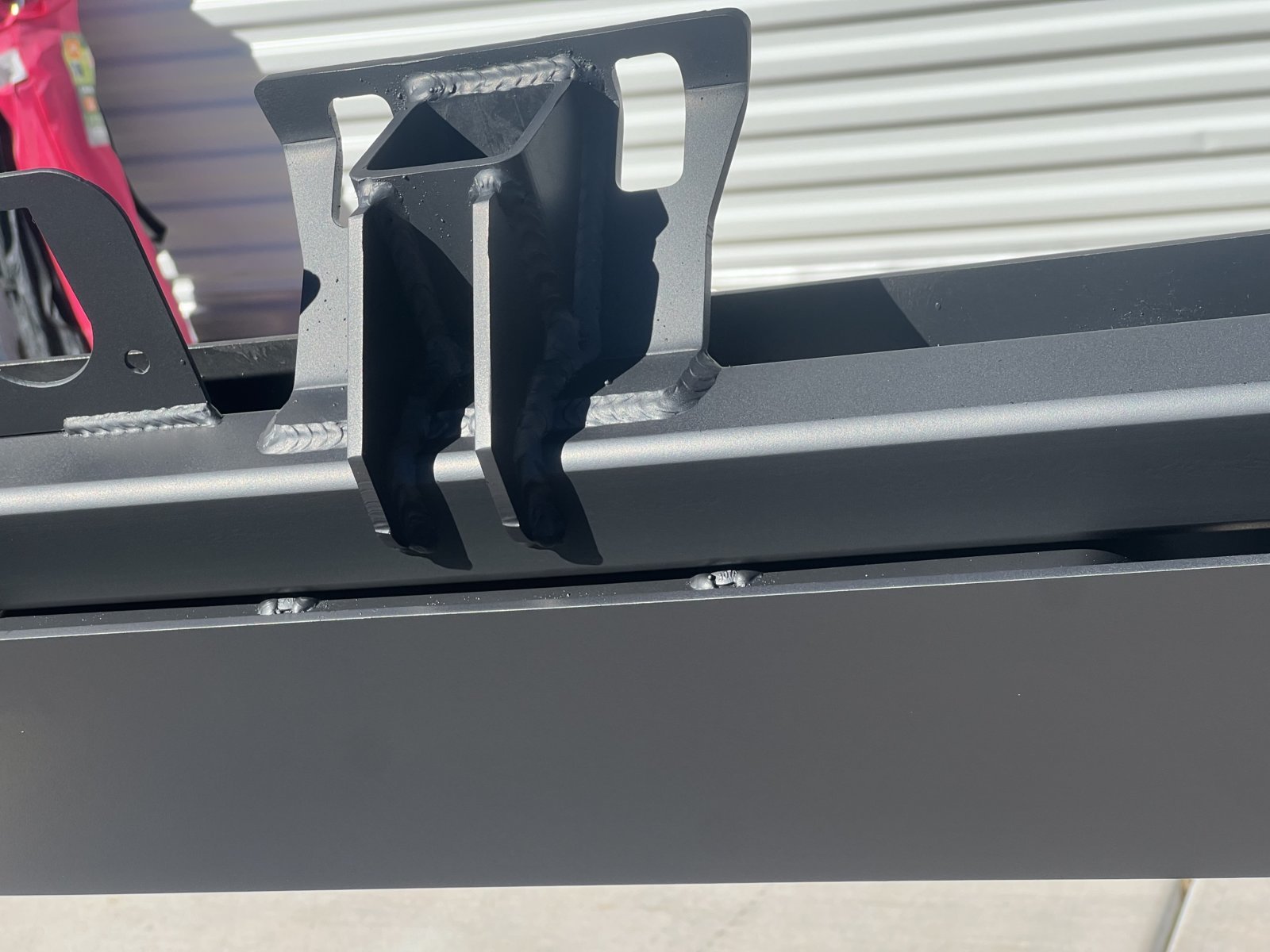

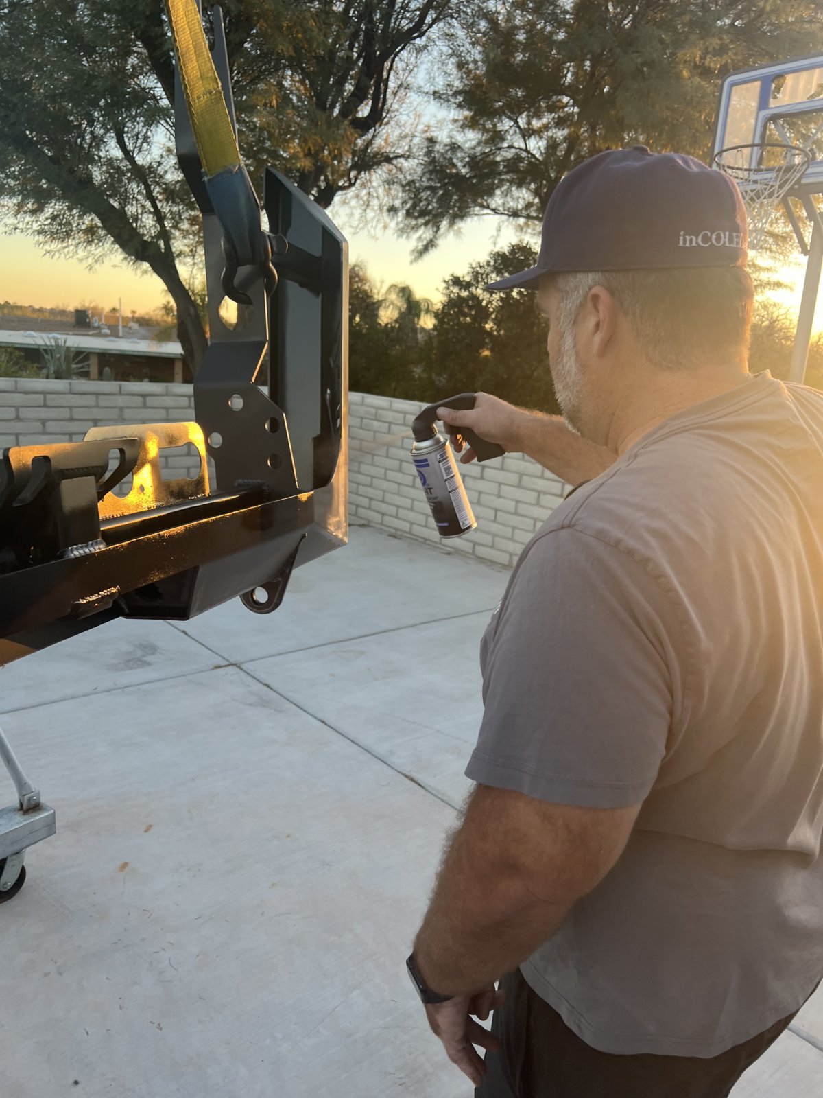

    My daughter helped me scuff it and spray it. Surgery has been scheduled for 2/25. :eek2:

    That looks awesome!

    Wow, making me second guess powder coat! Looks good.

    That steelit FTW
  13. Feb 18, 2024 at 9:51 AM
    #103
    reywcms
    reywcms New Member
    Dec 20, 2021
    #72040
    7,515
    Rey
    North Plains,Oregon
    2017 Tundra Platnium
    Too many mods to come
    Steelit is amazing stuff use it on my rig in many areas.

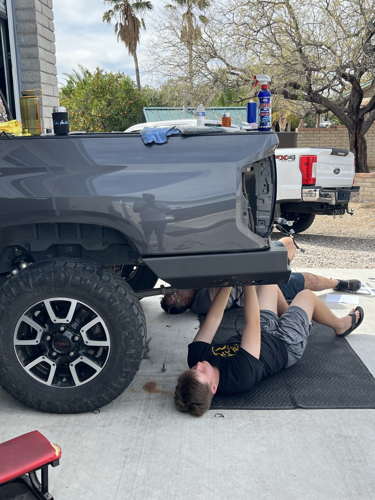

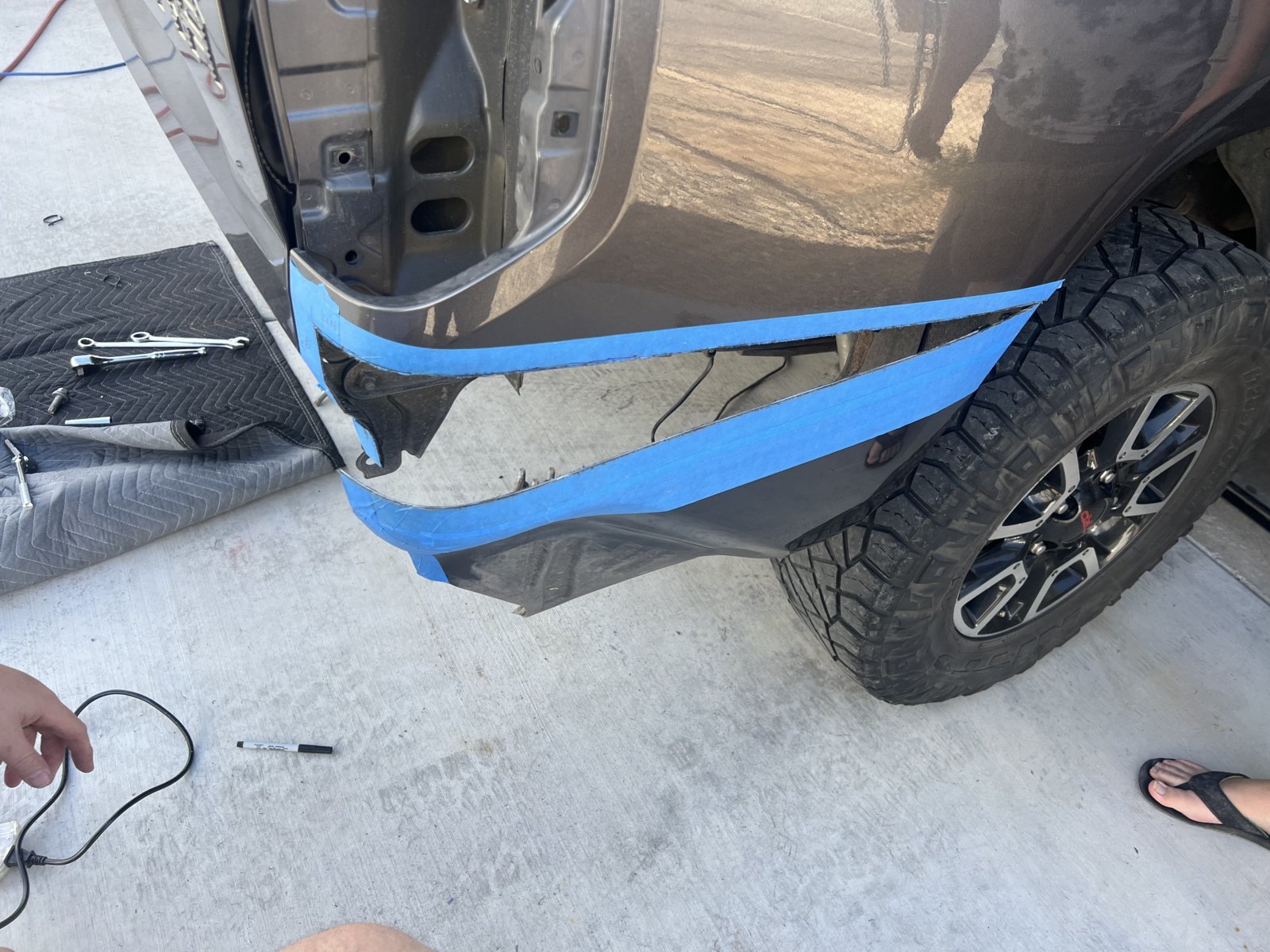

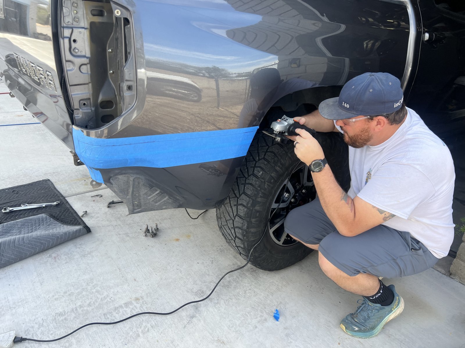

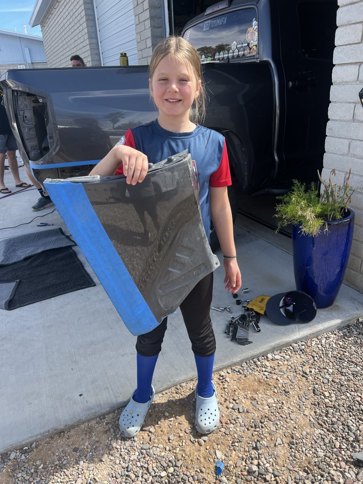

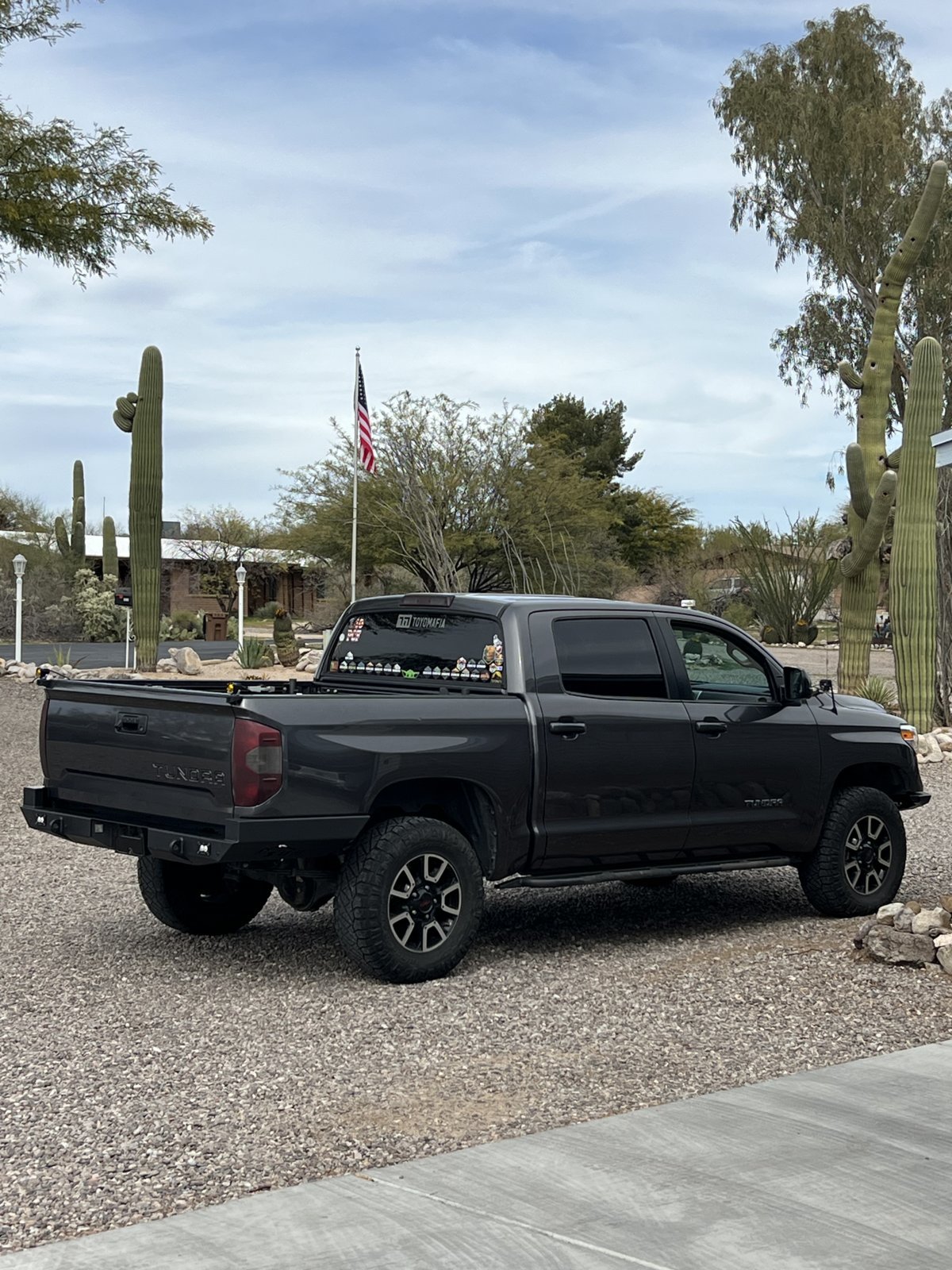

    It’s on and it’s amazing.

    Nice job! Awesome to see the kids helping out with The install :thumbsup:

    This seriously has me reconsidered dumping the BSM and going higher clearance

    Have some friends help - we had 4 of us - probably could manage with 3 but having a guy lift each side while someone lines up the mounting holes and gets bolts started requires the most manpower.
    Be careful of the wiring harnesses towards the back and cutting around the tailgate strut. Not much room but we got it done.

    One more suggestion I forgot - you can see more immediately under the tailgate with the new bumper - we hit that area with black steel-it after cutting and before putting the bumper on to have it match the new bumper.

    Nice, thanks! How many cans did you go through for the whole thing?
    STravis likes this.
  27. Feb 26, 2024 at 12:26 PM
    #117
    AZBoatHauler
    Aug 13, 2019
    #34576
    9,206
    So.Arizona
    We opened 3 - have about half a can left. We sprayed some in a plastic cup and brushed it on the cut sheet metal to protect it.

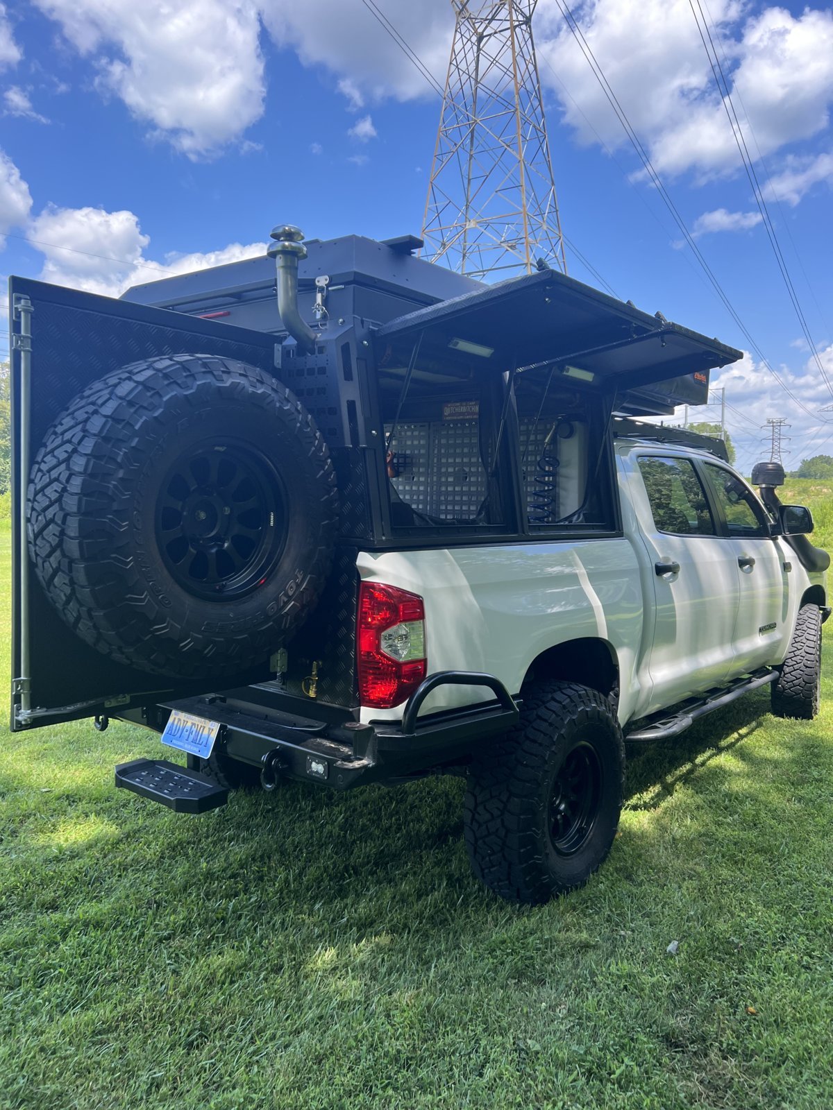

    Hey guys, I’ve made some updates to the truck and have towed quite a bit with it. The bumper is still holding just as strong as the day I bought it!
