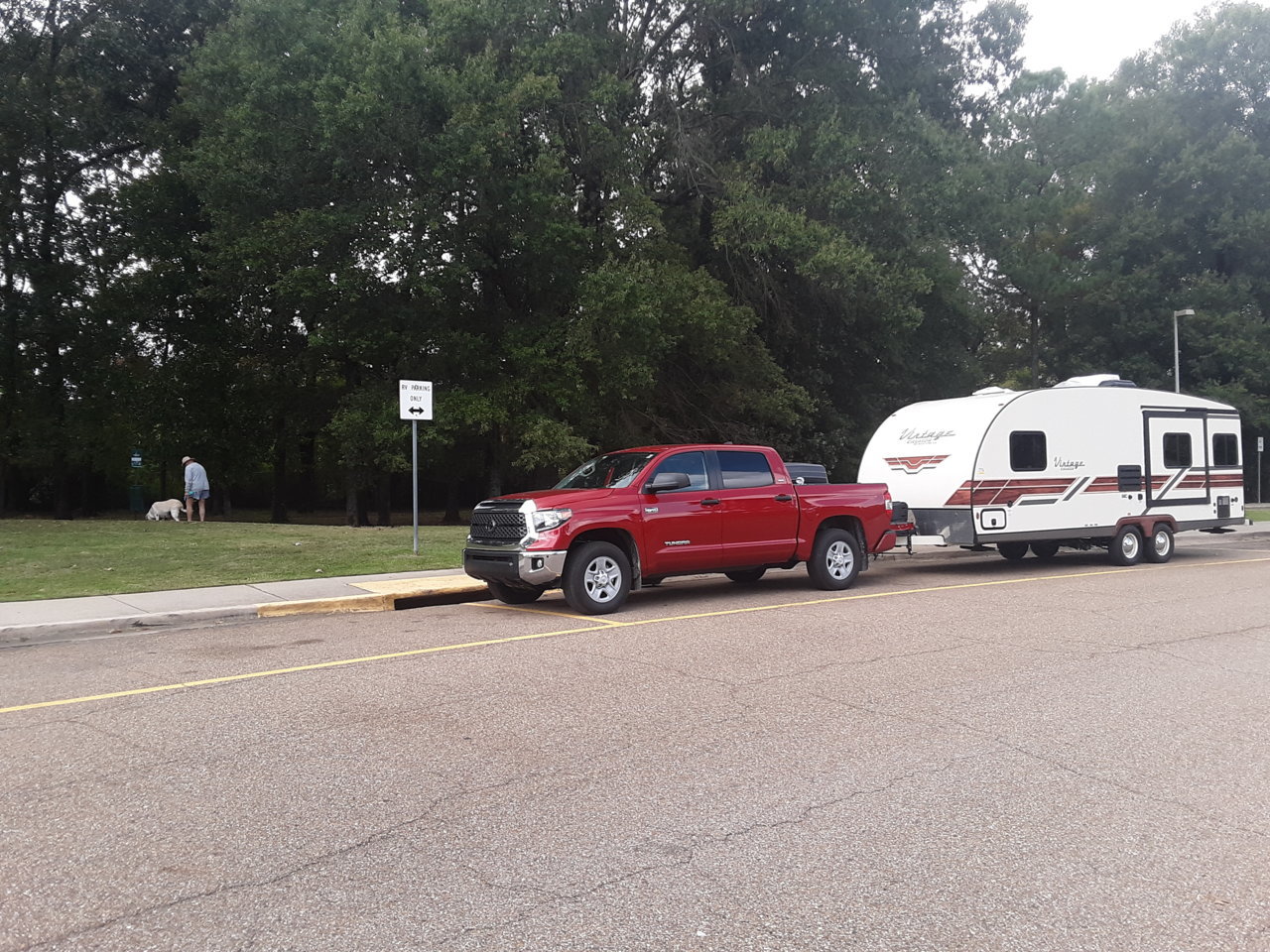

    We looked into traveling for over a year before buying our Tundra and TT. Since our daily use vehicle was a very good condition 2011 Element buying the Tundra and selling the Element wasn't an unreasonable option. Buying a used gasser class A got most of our attention but most had that dreadful Ford V10. Dealers were asking outrageous prices and private sellers all got 10 MPG at 70 MPH and didn't have service records.
    Our use was going to be a split of living in this trailer in a RV park over winter and traveling across the country in the summer so a balance between large for the winter and small for driving each day and camping that night was our goal. We both agree that living in this thing since Thanksgiving 2021 has been very easy and towing it 5,000 since Oct 1st 2021 has been better than expected. Even one day with 35-40 MPH crosswinds.
    You have year to make your choice. That's helpful.20211020_204910.jpg 20211013_134232.jpg

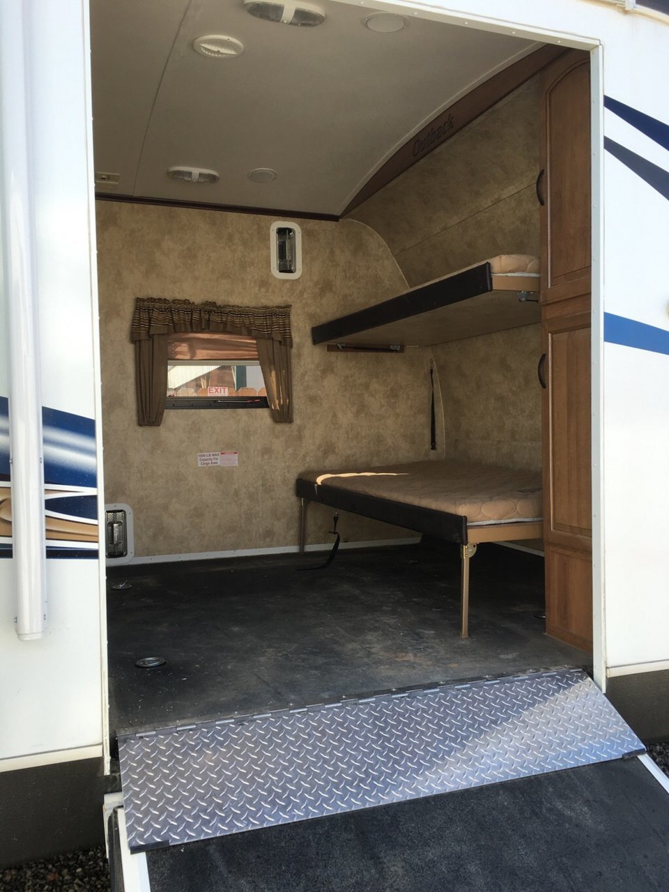

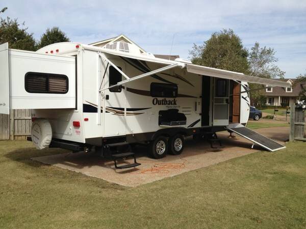

    One thing when looking with large breed dogs and an option we really liked for them….you hauler with a side ramp door.
    500B8480-91AE-4160-89D9-7867A8671AC3.jpg 0662A0C7-C4EE-48B5-9B51-7CC7D0430989.jpg
