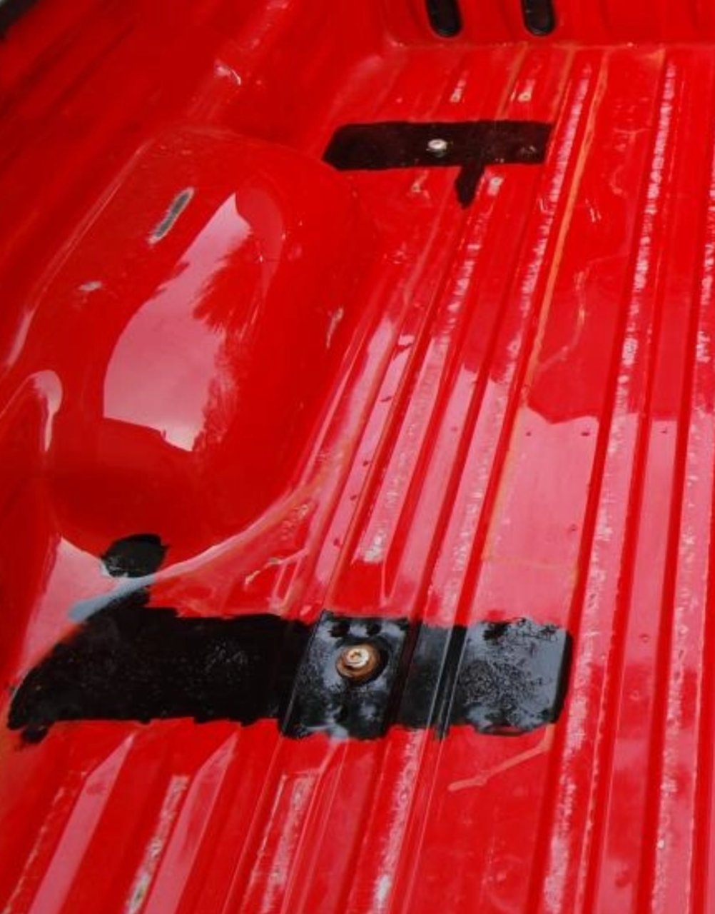

    I did call my local toyota dealer the inside bed is made up of 4 parts front,right,left,and bottom, our issue is still a part of the sides The right and left side panels for my truck are 700 each if I had the money thats the way I would go. Because they are just put in with the panel glue like the rest of the teuck.

    I saw on another board someone put a LineX in when the truck was new. Liner started to bubble up, took it back for warranty and was informed a hole was rusted through from the bottom up.

    Yep I think thats right their is not really any way to get away from this. If you look at this pic you can see where I grinded it the top on the edges are solid and everything in between is just rust .Cutting it all out is just about the only way to fix it for sure .20190122_093817.jpg

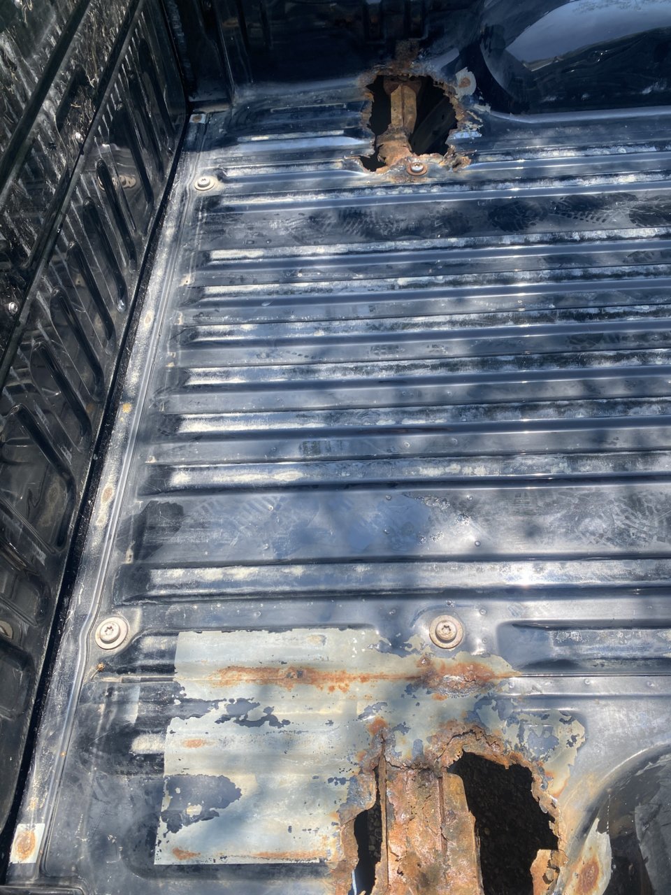

    I have a 2013 tundra with a rusty box and just took it to toyota.....I'm waiting to here back...I suspect it will be know coverage

    What years was this an issue with Tundras? I have a 2008 Crewmax that is developing a large hole in the bed and it's been covered with an A.R.E. cap the entire time. Do they sell replacement panels that can be welded in?

    I have a 2014 Tundra. Rusted through already in the four corners. I had a spray in bed liner that hid the rust. It also looks like Toyota also tried spraying on a sealant to prevent crud from getting into the crossmembers. This sealant actually hold moisture, and it hid the rust until it was too late. Already talked to my dealer and they blatantly told me no over the phone.

    I agree the rust is starting under, but I believe the drop in bedliners is speeding the process up. My 2011 now looks like this. I put in a Toyota plastic bedliner right when I bought it brand new in 2010.

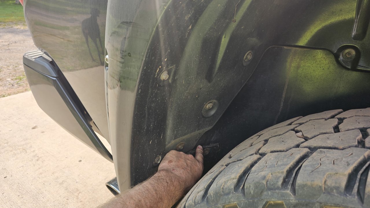

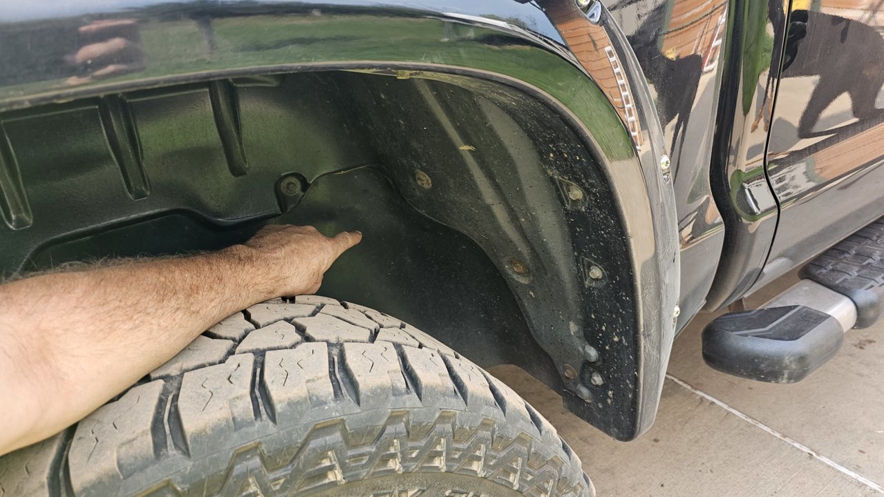

    Its not the bed liner, its from constant sand blasting from the tires, the stock wheel well liners cover less than a thong.
