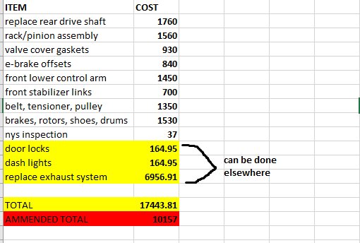

    Keep in mind, I'm in NY, the Toyota service center here charges $160+ an hour. Average mechanic charges a little over $100 anyway.
    I included a breakdown. The portion in yellow is what I don't "need" to be done by Toyota. The exhaust system can be fabbed by shops where I am, and the power locks and dash lights I was going to take care of myself. I'm sure I could handle the belt and tensioner, etc as well. The flange looks like it's about to fall apart, as does the piping and the muffler. Really the whole truck is just in terrible shape underneath. All the prices are for parts and labor using OEM parts. Everything on the list was shown to me. I wanted to jump off the roof when I saw the state of it on the lift.
    If they're willing to use aftermarket, I'm fine with that, the truck is 20 years old and I didn't intend for it to be anything other than a weekend/side-job truck. But the more I started surfing this forum and others, the more I thought of ways to upgrade and modify it, especially the interior.
    I'm not against cutting my losses. But if compression test is good, and the engine is a good as it sounds and feels, I'm alright tossing in a few thousand. Just not ten.
    Thanks for the advice, everyone.

    Bejesus! What are you buying, the CATs too? How do you even know they're bad?

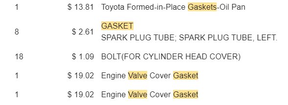

    Valve cover gaskets are a DIY, you're looking at under $100 in parts and 1-2 hours work. I ordered direct from Toyota this info, see for yourself:
    Replace rear driveshaft... why? Is it really rusted out that bad, to the point it's out of balance?
    eBrake parts are also something very DIY-able that will cost you a fraction of what's quoted there.
    Rack & pinion, most people don't want to do, OEM costs a pretty penny, you're out $650-850 on parts, and it's really only if you need it. Do you really need it? You can get the price down a couple hundred buying a quality aftermarket, NOT the bullshit your local auto parts store is selling.
    Lower control arms ... same story as rack & pinion. While I won't normally tell people to use 3rd party, supposedly NAPA lower control arms are ok. Whatever you do, if someone is changing the lower balljoints, always go OEM on those. It's the one suspension/drivetrain part you cannot fuck around with aftermarket.
    Front sway bar (stabilizer) links, for good aftermarket, maybe $150 and it'll take you 15 minutes to change out each side, max, with basic tools.
    Belt, tensioner, pulley is likely timing belt. It's important, these trucks have an interference engine and if it snaps, there's a good chance the engine is toast. But they should be adding water pump. $1350 is average what they charge down here using OEM parts, but it would include the water pump. You can find shops that'll do it cheaper, supposedly, but good luck finding anyone to do the work for less than $800 with parts, and you only want to use Aisin (the OEM supplier) for parts.
    Brakes, rotors, shoes, drums, you can find a local shop to do half that price, even if new calipers are involved.
    From my perspective, everything that's in white vs. yellow, there's no reason that couldn't be half what it is. Someone is nickel-and-diming you.
    And that "complete exhaust system" bullshit is a joke.
    I get the feeling someone is trying to get out of doing the work, takes you for a sucker, wants you to get rid of the truck, or some combo of the three.

    Can you turn some wrenches?! That estimate is downright laughable! As in I would laugh in their faces after handing me that estimate!
    Yeah, what @shifty` said!

    I don't know if that exhaust system quote includes it. The guy knows that's out of the question and will try to remove it in one piece. I'm not concerned about that, it's absolutely out of the question and I don't consider it part of the quote, since right off the bat we talked about getting any exhaust work done elsewhere.
    The brake lines are shot, rusted to hell, in some places crimped. There was suspension and brake work done on it that looks like hell, using aftermarket parts. Basically a shit show under there. The quote for the front lower control arms are because he might not be able to get them out without damaging them, but will try. As a rule, I never believe more than 10% of what mechanics tell me, of course.

    Yeah, the Toyota exhaust is all bolted together and each CAT includes the exhaust pipe for the 02 downstream sensors and the section that connects to the resonator/muffler section. They're $2500 each, so even if you go elsewhere, make sure they can weld to the existing CATs since they're expensive and don't really go bad that easily. If they say they can't weld to them, don't believe it and go elsewhere because they're probably trying to sell their own cheap CAT replacement.
