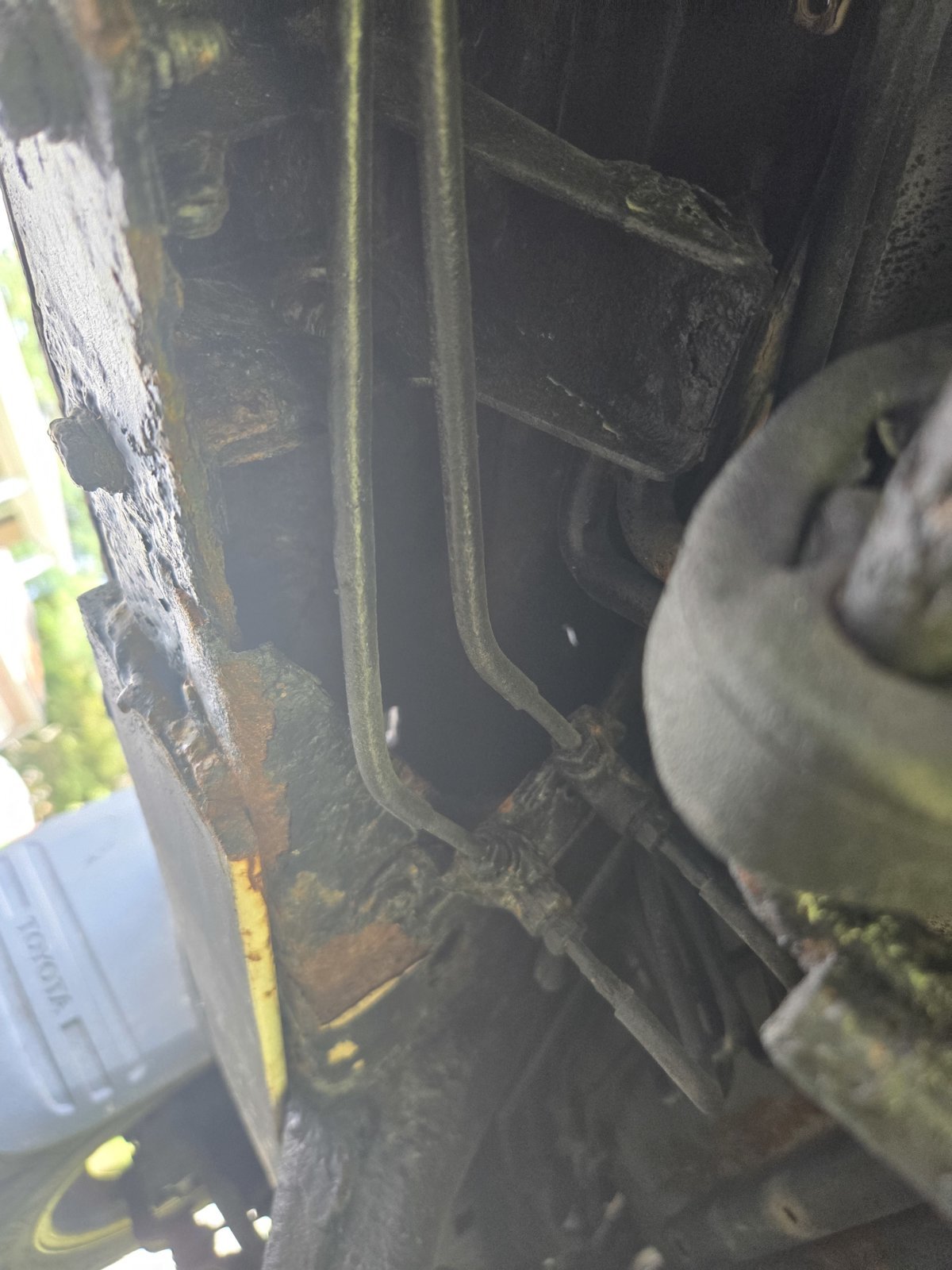

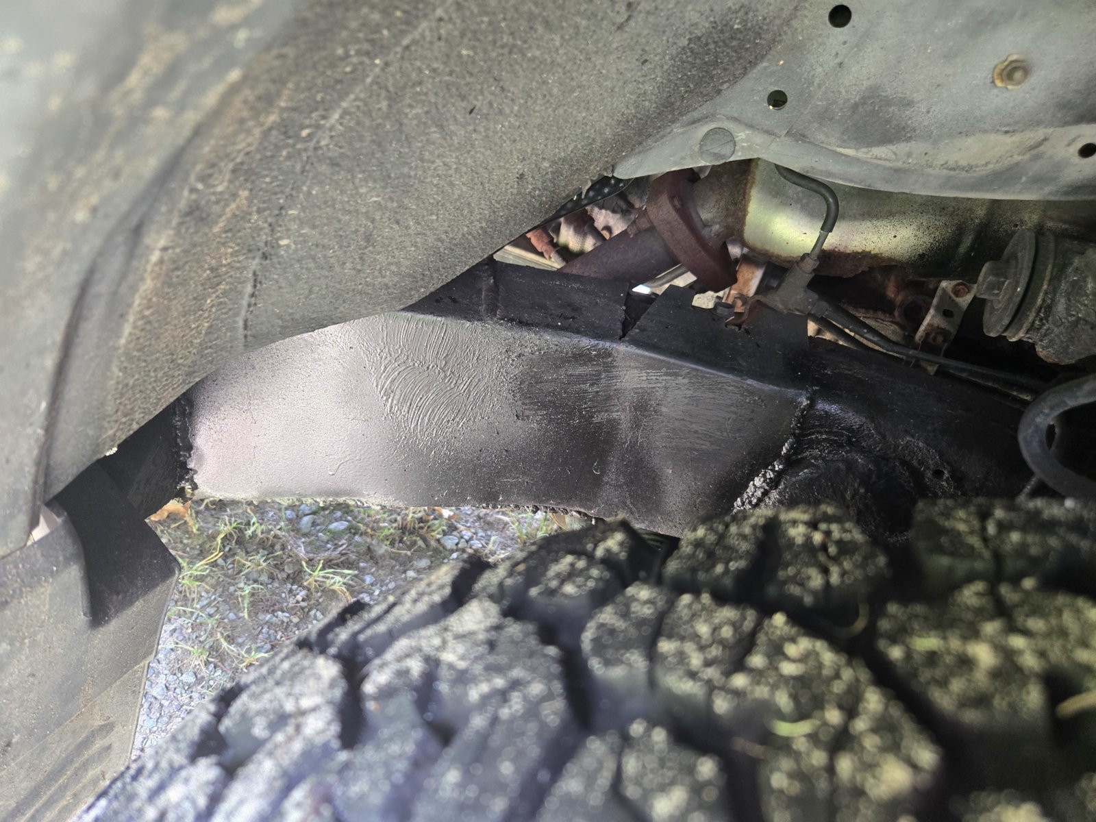

    Front left wheel well, I slapped a big plate over where a bunch of rot was (grinder it out 1st)
    Passenger side section near the wheel well, did my best patching a spot here but it was extremely thin20240814_144210.jpg

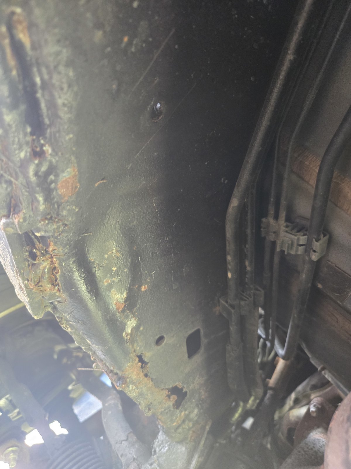

    This is right past the passenger wheel well neear the motor. There's even more but it's very tedious sending pics on mobile lol. I live in VA too which has strict frame repair stuff20240814_144147.jpg

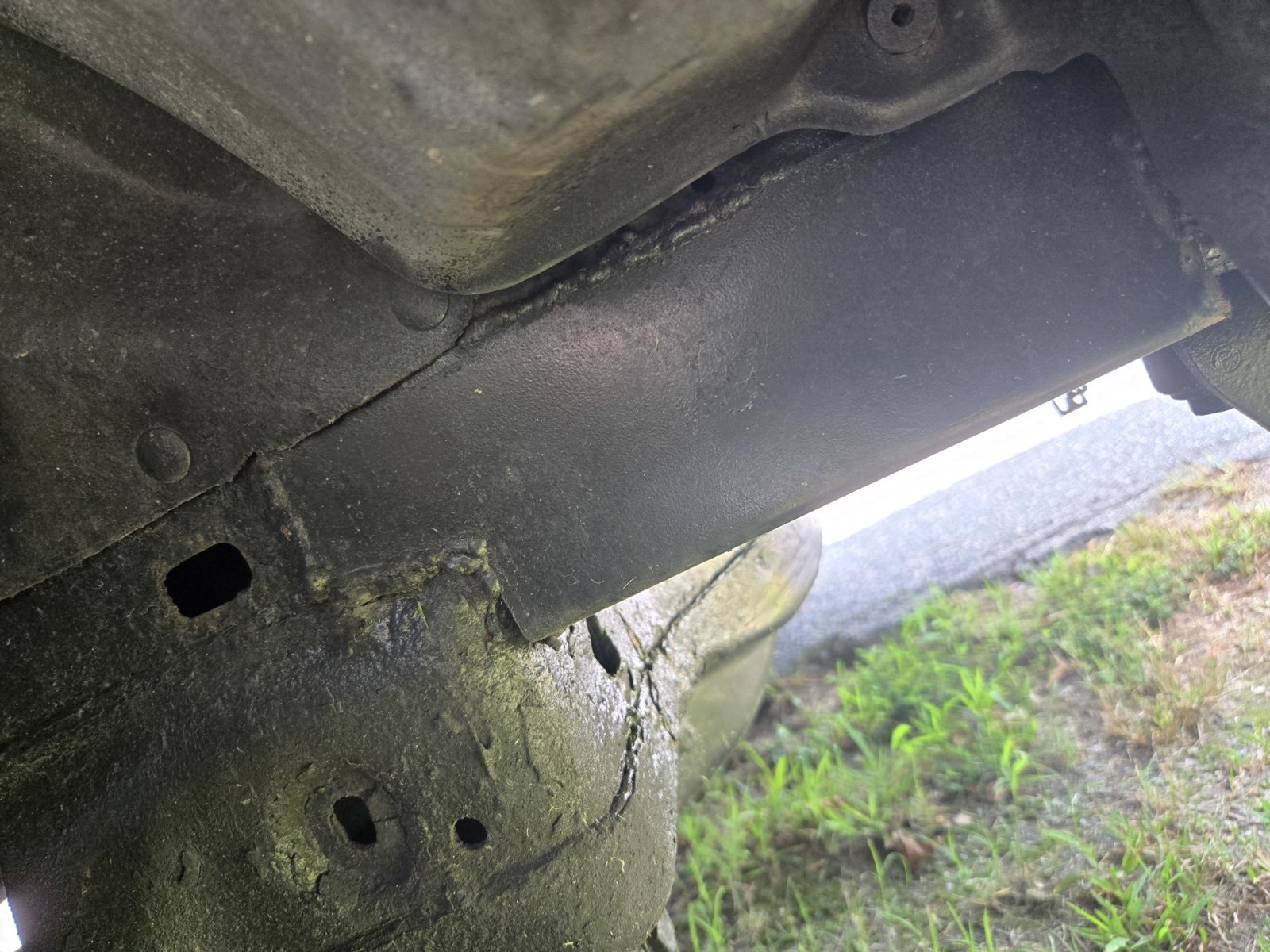

    Pretty major spot here as well, gutted the crap out beforehand but still I didn't do it properly so it won't pass inspection

    Looks like decent patch work and doesn't look "too far gone" at all, I've seen trucks with worse frames than that still kicking around. So the crown won't "approve" that frame for inspection? This is beside the point but that's infuriating and total BS. What everyone in VA has to be a bougie new car driver?? Fuck anyone who doesn't play the trade-in-every-two-years game?
    I suggest you try and take it to a less stuck-up DMV, or do a mail-in out of state registration with south dakota or florida or something similar. But getting a new truck because the state won't LET me reg it based on a DMV worker's opinion? F that.
