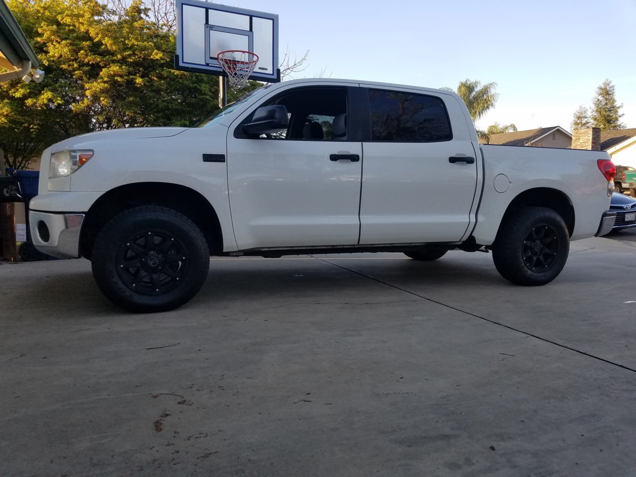

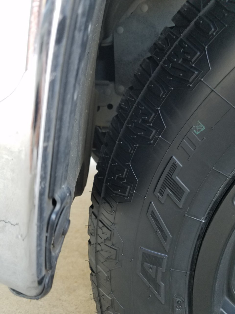

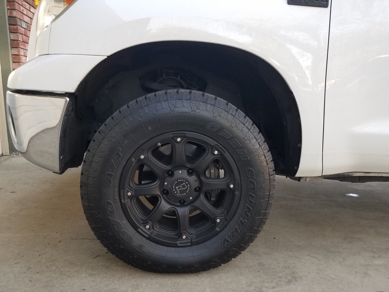

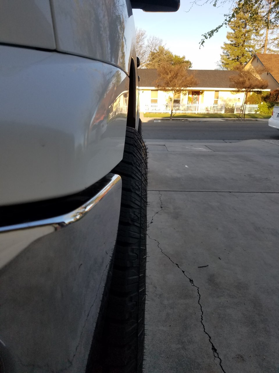

    I have black rhino glamis 18x9 12+ .....my box they came in shows 12 I really don't know off sets to he honest...but here are some pics

    gdiep
    gdiep I like cookies
    Sep 14, 2016
    #4540
    1,011
    Syracuse, New York
    2014 Red Tundra CM SR5
    I have 2 sets of wheels: stock alloys with blizzak 275-65-18 and Worx Sentry with 275-65-18 Firestone Destination AT.
    The destination AT is taller side by side compared to the blizzaks (I can do a true side by side when I change over for the season). The wheels are the same width. So yes, tires can vary in height despite the same size even when brand new and set at same inflation. Also, the Worx wheels are +18 offset and sits out more past the fenders compared to the stock alloys. This combination of offset and slightly taller tire rubbed against the little aero flap in front of my front tires while the wheels were turned full lock (especially when reversing out of the driveway or parking spot). I had to remove those flaps.
  26. Mar 18, 2018 at 8:02 AM
    #26
    Rica25
    Rica25 [OP] Got Bam? IG ......@TNDRA08
    Dec 6, 2017
    #11380
    5,553
    Ricardo
    Tulare
  27. Mar 18, 2018 at 8:04 AM
    #27
    Rica25
    Dec 6, 2017
    #11380
    5,553
    Ricardo
    Tulare
  28. Mar 18, 2018 at 8:07 AM
    #28
    Rica25
    Dec 6, 2017
    #11380
    5,553
    Ricardo
    Tulare
    With Billstein 5100s at highest setting
  29. Mar 18, 2018 at 8:36 AM
    #29
    gdiep
    Sep 14, 2016
    #4540
    1,011
    Syracuse, New York
    That looks like a 12 offset, it sticks out slightly more than my 18 offset. Doesn’t look like it should be rubbing on anything. Probably just a new tire slipping on a wet surface or a painted line on the road. I can tell you that painted lines are pretty slippery up here in the north during the winter. Sometimes, when I mash the peddle in 2wd at a stop light, I can trigger the traction control. Usually when it’s a bit icy on the roads. Painted lines seem to be just a bit slicker. But it looks warm where you are. Could just be the newness of the tires.
