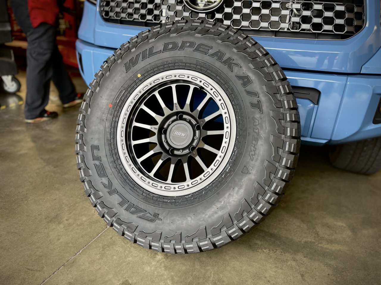

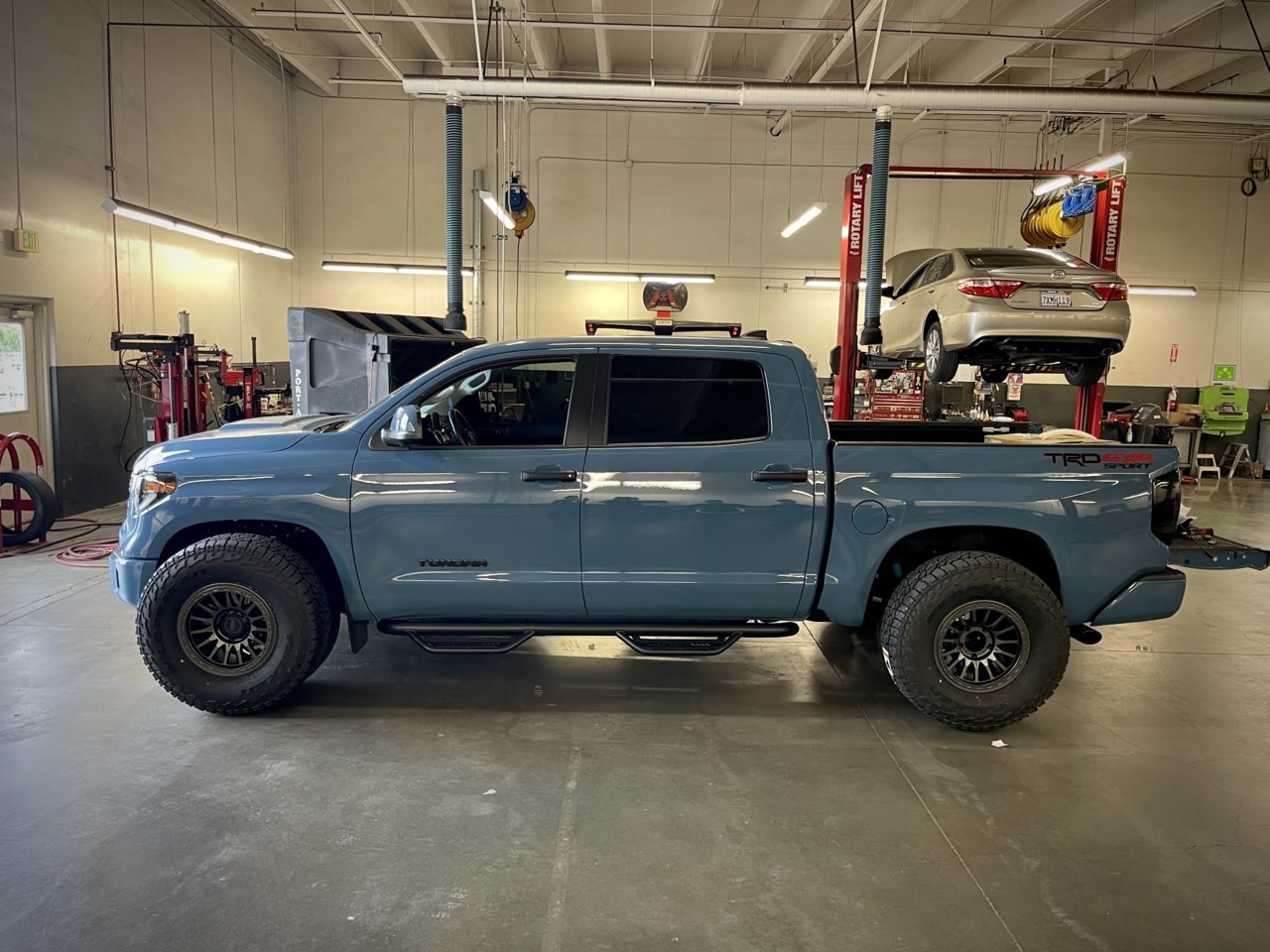

    Whoa! They look good! Now I'm second-guessing if I should go for 33x12.5 ....

    Thanks fellas. The difference is pretty negligible between these and 295/70s. If you like wider then these, like taller the 295s. I’d get whatever you find the best deal on.

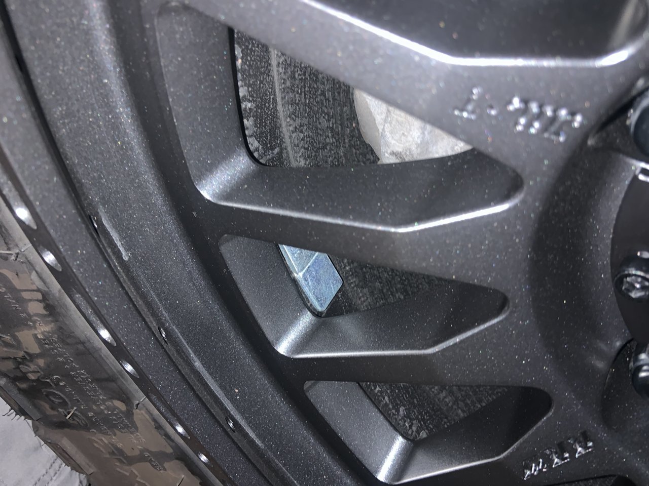

    how was the tire weights install. Not too close to the caliper ? tire shop knew what to do ?

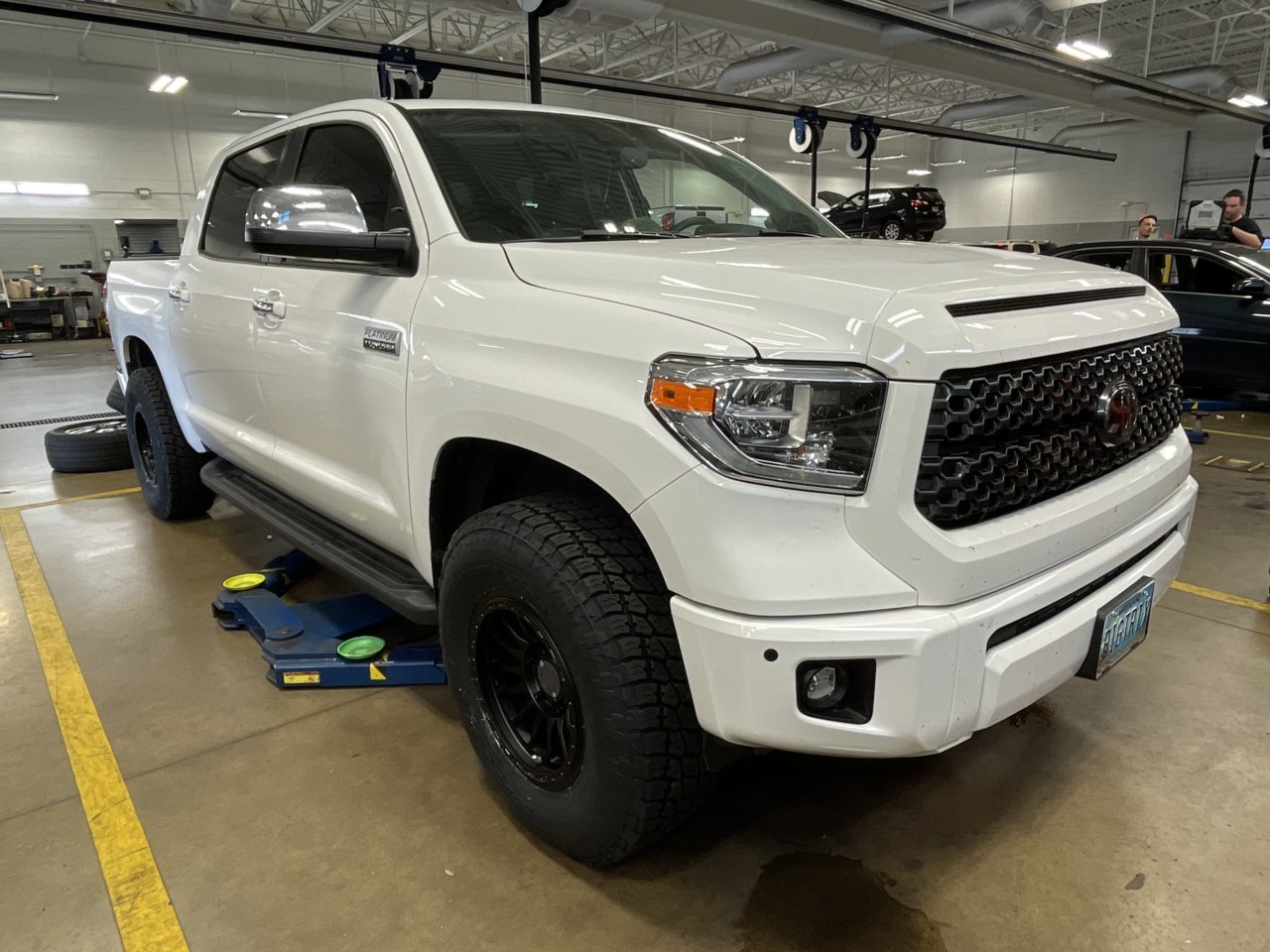

    0639F8A7-6DB7-4E96-BCF7-FBF3FCB707FD.jpg EB71C2A9-8A54-4534-AB55-A4016C3BAD47.jpg (Excuse the dirt/bug guts/etc) GOT EM ON!!!!! Sitting stock, but I do have rub with the wheel cranked so now I gotta decide what leveling kit to do
    OR
    do some cutting/trimming which I’m hesitant to do! What are y’all’s thoughts/suggestions?
    wheels are wrapped in Nitto Terra Grappler G2
    (285/75/17)

    Lol I’m the wrong person to ask for suggestions if cuttings ok. I would say BMC chop and tuck the liners etc then a good quality leveling kit.

    My usual local tire shop didn’t have any issues. The weights are just riding on the slightly raised lip behind the spokes and then the inner most edge. No caliper issues. I think the 0 offset helps make the placement of the weights less of a pain compared to less aggressive offsets because it centers the caliper in the wheel better, but could be wrong.

    hahaha I respect that. If I went with just the leveling kit, I wouldn’t have to cut/chop right?

    and a good alignment.

    Not being funny, what would a good alignment entail? Like any specific things or just a good shop who knows wtf they are doing?

    looks so good, what suspension setup are you running??

    Might be close. I cut and chop as needed lol

    do you have aftermarket UCAs ? a good alignment they would be able to push the wheel a certain way to avoid some rubbing

    Thanks! I’m using Toytec ultimate coilovers in the front at 2.5” and a toytec mini AAL leaf pack in the back for about 1.5”.

    I am BONE STOCK! Truthfully not looking to do anything crazy with the suspension which is why I was just thinking leveling kit

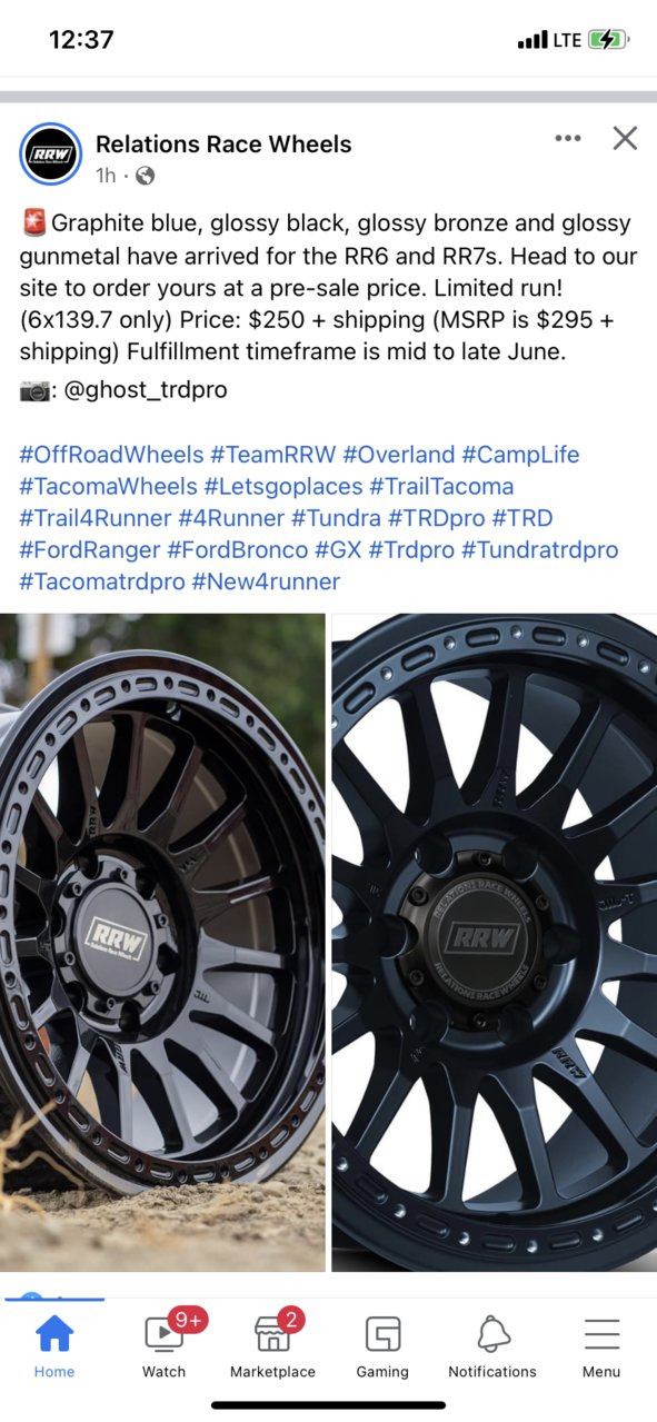

    Oh sure now they offer the gloss colors.:mad: If that were an option I would have preferred it. Not offered in our lug pattern either way apparently.

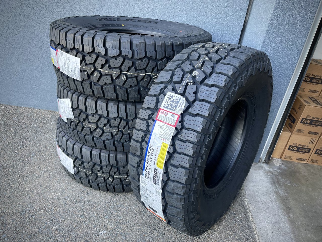

    Ya know… in my mind 35’s seemed like a great idea. The cost was expensive and the thought of a 76 pound tire adding so much rotational weight felt justified by the power of the 5.7L V8.
    then the delivery guy opened the back door and rolled them towards me. These tires are dauntingly massive… like I instantly feel worried that the route I went for suspension and body mods won’t be enough to get these badass tires mounted up. One tire is as tall as three laying on their sides.
    :fingerscrossed:

    Yes! It's going to be fine lol

    you sure? 5100’s on top clip, bumper spacers and a CMC?

    I think it should clear one way to find out lol

    I think you’ll be fine fitment wise. I’d just say be ready to also ditch mudflaps if you have them but you may have already figured on that. You’re going to need the full swing back to where the cab Mount chop is. I had the same size on the same lift on my previous 2010, except that had an offroad bumper so the front clearance was never a thought. It’s gonna look sick you won’t even care once it’s done lol.

    I'll take them off your hands..haha
    suspension/bmc and maybe UCAs + good alignment.

    graphite blue looks pretty ballin
