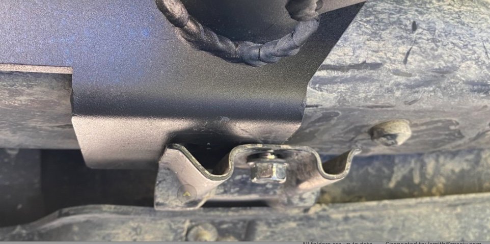

    Something is up. I have no brackets like that along the bottom of my frame on the driver's side. Some kind of skid plate mount???
    and this...
    Should look more like this..

    Here's how everything showed up. they showed up packed in individual (massive) boxes with lots of paper. Nice package.
    My only complaint is that I had to grind a slot in one bottom tab on each side to clear the frame rivet. I also drilled and added two bolts through the bottom tabs along each side. I would have preferred these holes to hit existing frame holes, but only one exists that I can see and it looks to be threaded for 8mm.
    It is clear that RRW would benefit from some installation instructions.

    I also bought the fully welded V3 from RRW.
    I have the same issue as everyone else here (rivets are in the way, holes are not lining up, etc).
    Seems they completely screwed up the design of the bottom tabs.
    I was so easy to have the holes (better yet should use slots) in the bottom tabs line up with the existing tapped holes on the bottom of the frame...IMG_6745.jpg IMG_6749.jpg
    I'm guessing there will be many more pissed off members as shipments start coming in, and people bring these sliders up to their frames and see nothing lines up, curse at the part and the fucking idiot designer, search the internet, discover this thread (like me), and see others having the same issues.
    RRW should pause production of these sliders immediately and update the design of the bottom tabs to actually work with the Tundras (instead of getting in the way of the install).
    I doubt they will do anything for any of us who already received our sliders. But they should, if they want to stop damaging their reputation.

    Seems that buying a unibut or grinder and hitting that small area that’s on the rivet would be the fix. It’s unfortunate that it’s necessary but it is what it is. I’d rather modify than deal with shipping them back. Still feels very strong/sturdy and looks good
