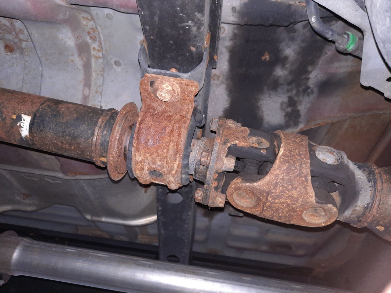

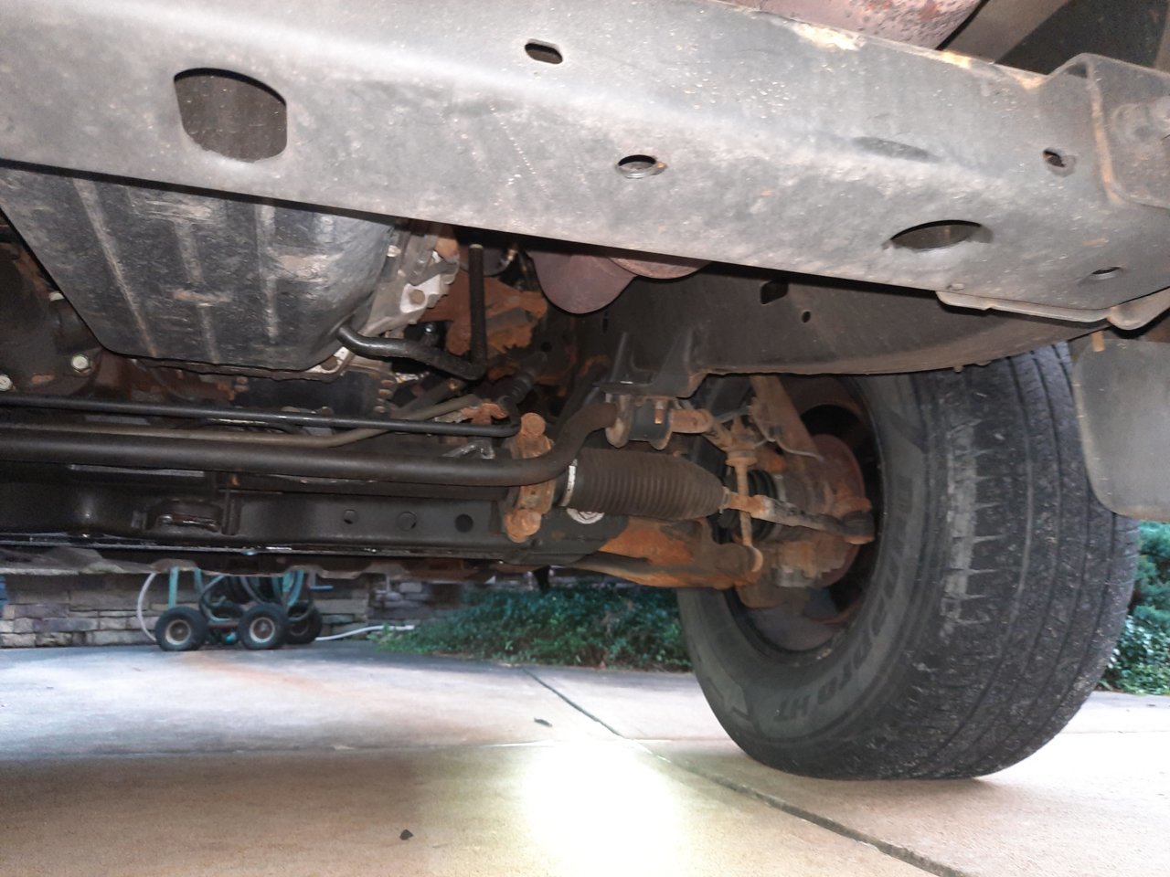

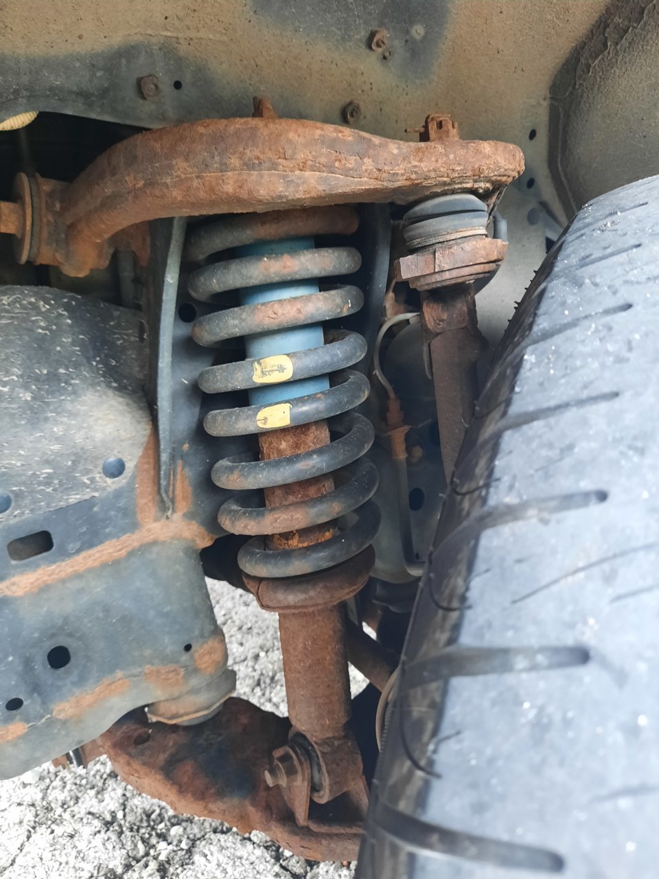

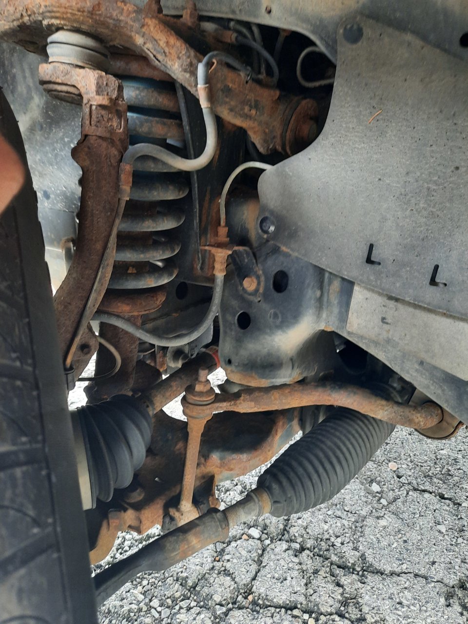

    @shifty` I've attached some pics of the suspension, let me know if you need more. I've also attached a picture of what I think is causing the squeak at takeoff. It's the piece that holds up the two drive shafts.

    The “thing connecting the driveshafts” is the carrier bearing. The symptoms you describe could be caused by it. If you get a replacement, and plan to install it, consult with folks here first before buying the part and installing, you’ll get all the help and warnings you need.
    You’re at 338k … when was the last time your shocks were replaced? Any of them?

    Rough ride is likely a combination of bad bushings and worn out shocks. Yours appears to have the TRD package judging by the coils. New 4600 or 5100 Bilsteins all around and new bushings for the arms and leafs will likely smooth things out. And yeah, that carrier bearing looks pretty saggy. Probably worn out which would cause driveline vibration. Essentially that truck is suffering from maintenance neglect.

    Well, I see the frame has a significant amount of rust. Is it rusted through anywhere? Not that this would have anything to do with your situation or anything.
    It's almost cliché at this point, but ... your driver's side valve cover is leaking.
    Like any truck, the solid rear axle makes bumps harsh. It's the nature of the beast when you don't have independent suspension. But beyond that, some more questions:
    Do you see any evidence of branding (name brands, part numbers) on the rear shocks? They look like KYB which was the non-TRD offering. But it looks like you have the blue/yellow Bilsteins in front, which was a TRD offering. Maybe one is original, other is not.
    Do you see any evidence leaks on the rear or shocks?
    When you look at the lower shock mounts, back and front, do the rubber bushings (inserts) look plump, crack-free, and equally thick all-around, or are they all cracked up and jammed thin on one side?
    If you stand on the rear bumper and jump up and down, how does it feel, any noise?
    Regarding pics of the front ... Can you take a couple of photos like this, so we can see the entire front strut, its lower bushing, and the steering components?

    The frames and attached structural components which are the biggest rust concern.
    Here's what I'd tell you.
    First and foremost, when Toyota replaces the frame, they don't always replace a lot of other stuff, like swaybar links, upper and lower control arms, knuckles, springs etc. That's why all of your front suspension parts are gnarly like that. If some of those words don't make sense, or you don't know what the suspension parts are, check this reply out (and the replies that follow it in that thread) so we can all be talking the same language:
    https://www.tundras.com/threads/how-to-plan-out-suspension-tires-part-of-build.128410/#post-3277935
    That said, I don't think your swaybar bushings look too bad. And your lower strut/shock mount bushings look fairly OK in the pic you shot. The strut/shock itself looks pretty much f'ed up though, and those may be the original springs. I'm guessing your upper control arm bushings are blown. I wouldn't be surprised if the lower control arm bushings are also. but that said ...
    If I were you, I'd give you some short and long term advice:
    Short term, to hopefully resolve your immediate problems:
    • Refresh the struts, springs, and rear shocks; I recommend this kit to get you a nice OEM ride (you could also get just the struts alone for around $600, but ... pay once, cry once, smile the next 100k miles; those springs are probably tiiiiiiiiired!
    Long term, if you plan to keep this truck:
    • Start getting the frame coated with Fluid Film, Woolwax or similar; find a shop near you unless you want to DIY. If DIY, read the labels and warnings!
    • Start looking at replacing your upper and lower control arms - avoid Mevotech brand for the lowers; see this thread for options
    • Get a good replacement swaybar link (I like these).
    • I can't see your lower ball joints, but I recommend evaluating; if you replace, only use OEM parts for this specific item!!!! (Don't let anyone sway you otherwise)

    Those front shocks look Jurassic era.
    Step one: make sure the truck is worth keeping as it pertains to the rust situation.
    Step two: replace the shocks, those are beat.
    Step three: replace bushings, ball joints and tie rod ends.
