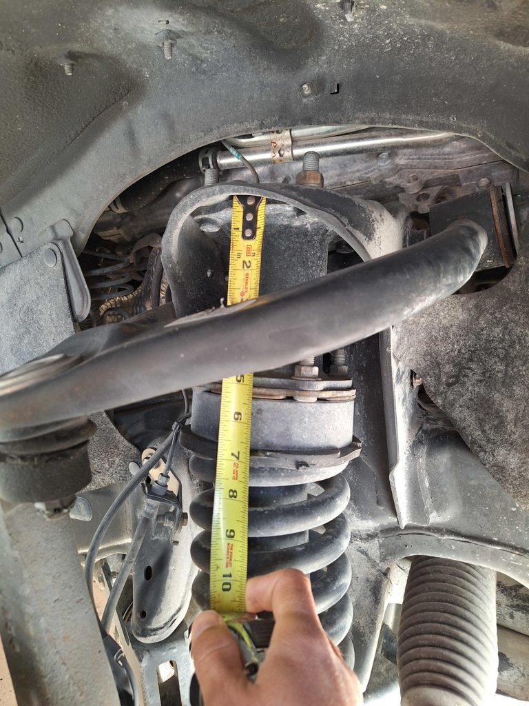

  22. Nov 12, 2024 at 2:58 PM
    relentless23
    relentless23 New Member
    Jun 5, 2020
    #47585
    10
    DFW
    2015 Inferno TRD Pro
    Hey guys, I just got my vertex coilovers installed last week and I’m loving it. The adjustable dampeners are awesome, I currently have mine set to 3 and rides way better than my old pro Bilsteins. I have a ’15 TRD Pro just for reference.
    But my question is…will the front end settle and drop a bit more after a few weeks? I ask b/c the front end is about 1.2 inches higher than the rear right now (rears have the vertex adjustables as well, but I think these are only stock height only). I measured this after a week and did a few measurements on a level surface comparing the center of the hub to the fender. The guys that installed it said that they will settle and lower a bit more after 2000 miles, is that accurate? I thought settling an inch is quite a bit.
    Just for reference, here are my measurements (center of hub to fender)
    LF: 25.0”
    RF: 25.0”
    LR: 23.75”
    RR: 23.85”
    If they aren't going to settle anymore, I feel like my options are to adjust the ride height in the front to be lower or to add lift in the back by either a block or shackle. How hard are these coils to adjust? Can I do it w/ the tires in the air or will it require it to be disassembled? I do like the look of the lift in the front, so I’m leaning a bit more on adding a shackle. Either a CB +2 or maybe the Toytec adjustable. Any feedback would be appreciated, thanks guys!
