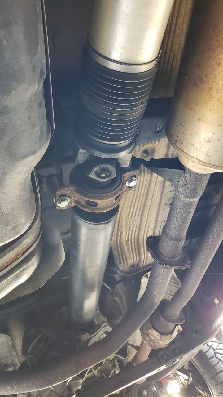

    I’m thinking you might need to drop the drive shaft carrier bearing more OR the shop removed the drive shaft and then installed it in the incorrect position. The drive shafts are rotationally balanced from Toyota, so if you remove the drive shaft, you would need to bolt it back up to where it originally was.
    How’s your pinion angle? Can you take a picture of your rear axle?

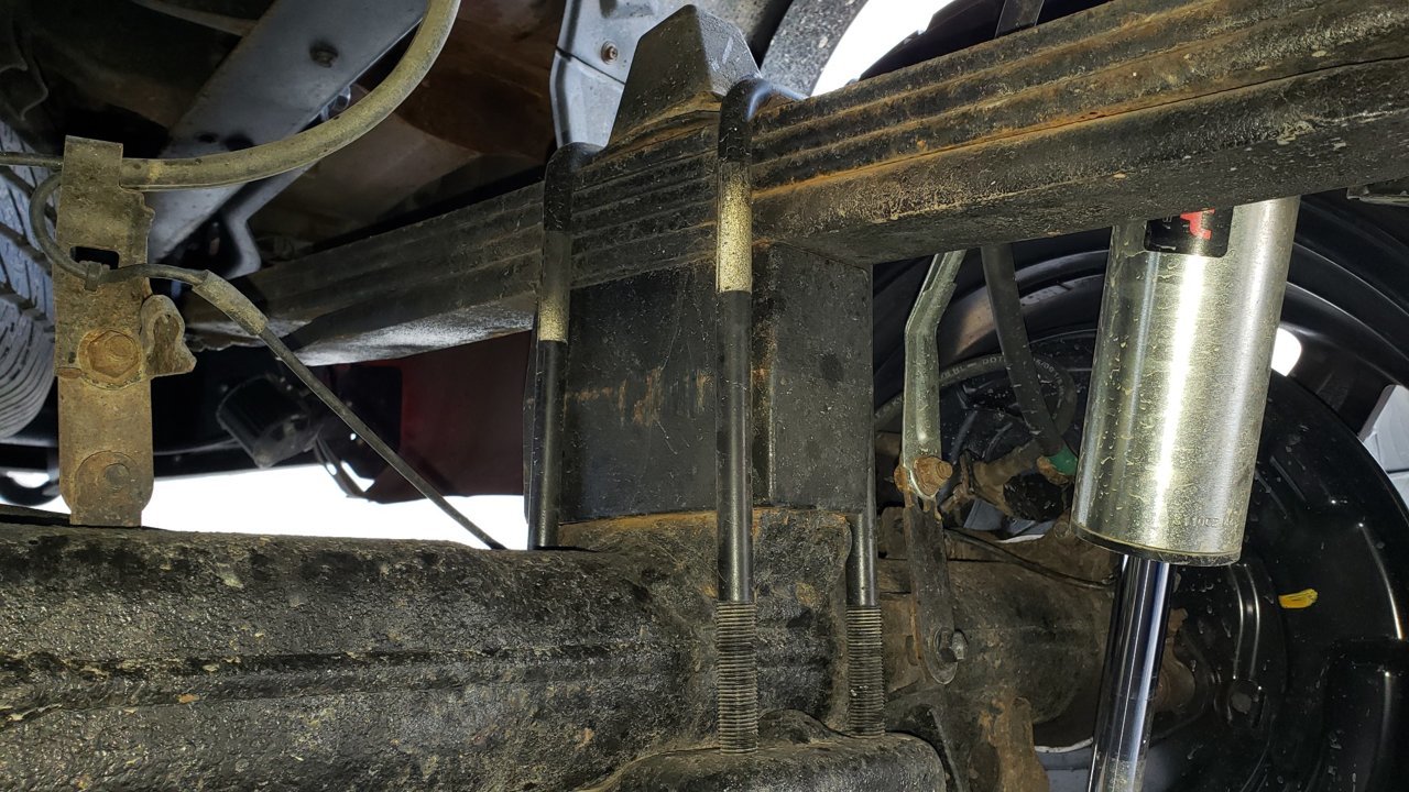

    best shots i can get while at work

    Carrier bearing might be toast, as I said before, since you are not capable, see to it that you get the truck to a true mechanic, not a parts changer. Being a jackass to someone giving you sound advice will not help you get it fixed.

    1. Looks like you actually have a 4” block instead of 6”
    2. Your 3rd member is leaking, likely at the pinion seal, may want to look at the pinion bearing while in there.
    3. You mentioned bed bounce, longer shackles usually address that. So if you like the height of the rear you could install smaller blocks and pair it with longer shackles to get the same lift height.

    Good advice. I was actually thinking of better shackles. The pinion is dry is shadow showing on the picture.

    so i took some better photos of both rear blocks i do not see where there is a tapered shim under the blocks as i did with my other trucks. And the one u bolt is definitely turned on the drivers rear vrs the passenger.

    looks like the shim is on top of the block and is thin side for thick aft as it should be.
