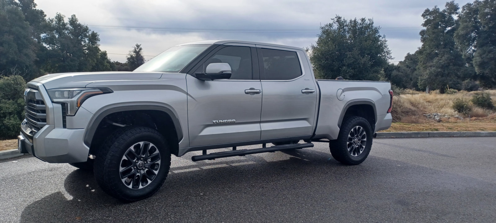

  2. Jan 12, 2023 at 6:03 AM
    #62
    kcm5899
    kcm5899 New Member
    Jan 3, 2023
    #89678
    5
    What offset are you running? Great looking setup.
  3. Jan 12, 2023 at 6:08 AM
    #63
    GTundra2022
    GTundra2022 New Member
    Feb 18, 2022
    #74778
    26
    2022 Tundra 4x4 Limited
    Thank you! +18 on the offset.

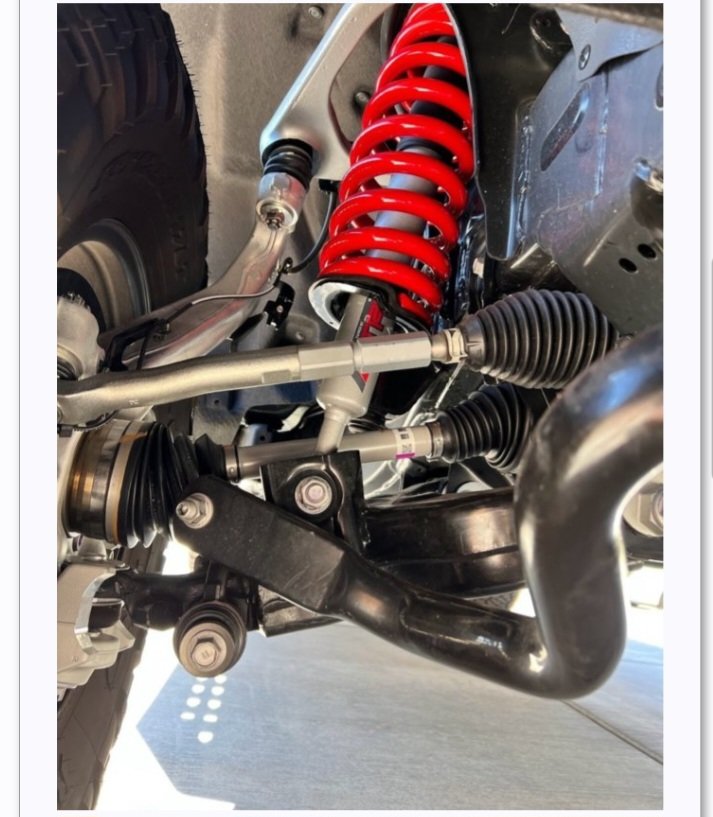

    Rc 3.5 lift,35s,Rc nerfs
    I’m new here and have owned 5 trucks all with various packages, some of which are Rc.I just put a Rc on my new 23 not a serious trail rider but it gets me around the winter mountains of Idaho just fine.

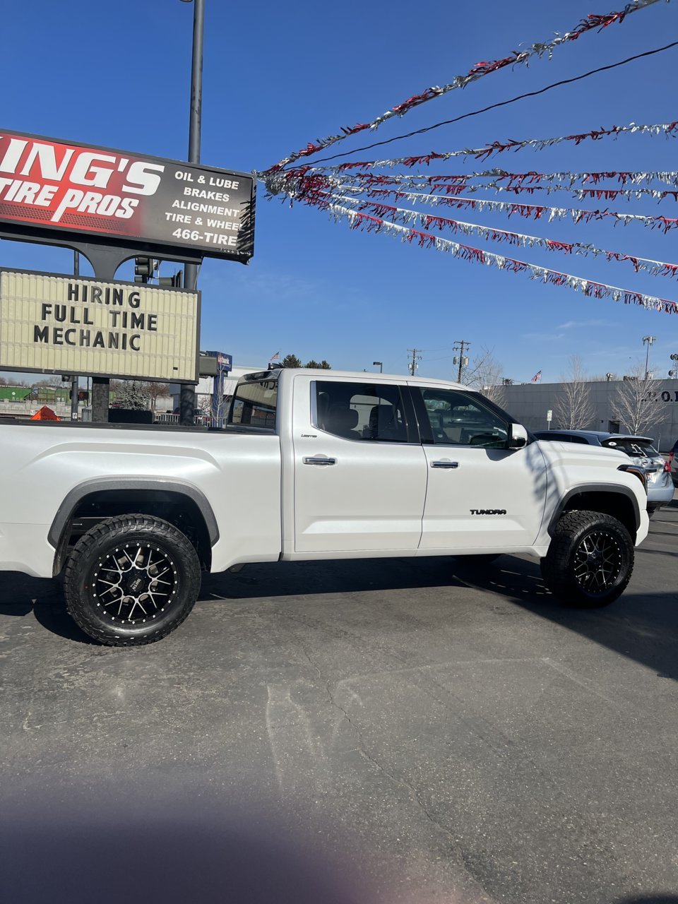

    New 2023 Windchill Pearl…still has some work.

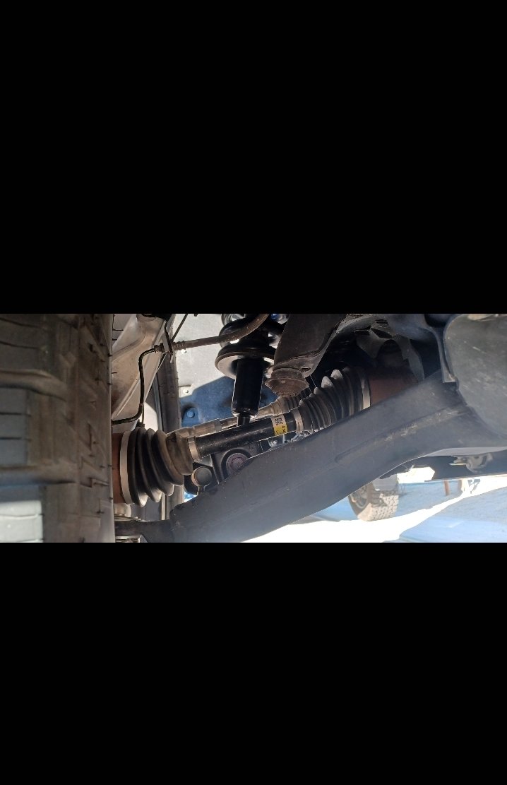

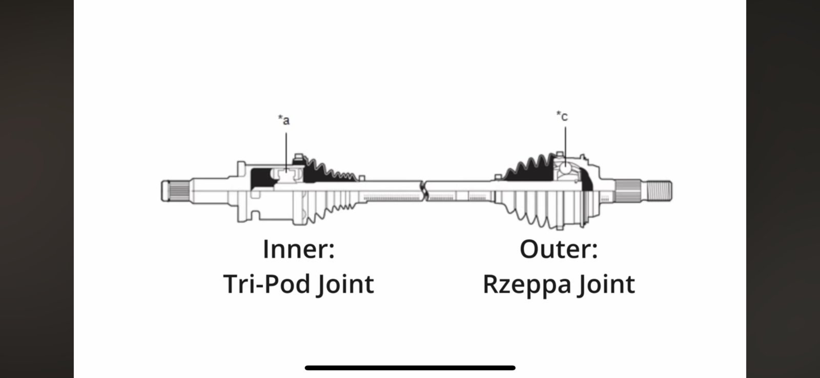

    Just installed the 3.5 lift with the rear avs load leveling system. Kit looks and feels solid. I do have an issue when I put it in 4wd high and drive at low speeds, I get vibration. When I let off the gas it gets worse. When I try to disconnect 4wd it doesn't what to disengage. I got under the truck with the company that installed it and don't see anything out of the norm. Waiting on RC to let me know what they think might be the issue. The truck drives great in 2wd. Anyone else have this issue? Thanks

    Just speculating, but if you are on firm ground like pavement, your 4wd is going to be jerky especially at low speed. Also, I hope you are rolling forward when trying to disengage the 4wd. If these two suggestions don't apply then you might have some things to figure out. Good luck.

    How is the driveshaft angle? Maybe need a carrier bearing drop kit.

    Drive shaft angel is good. This truck with 4wd doesn't have a place for a carrier bearing shim. 2wd is completely fine. The shaking is coming from the front. I know you get a little tire friction on the road when in 4wd high but this isn't the same. The big thing for me is that it has a hard time disengaging from 4wd. It seems under pressure. Rough country has no complaints about this kit nation wide. I was on the for with the tech from RC measuring everything , all seemed right. It will be going back to the shop that installed it tomorrow.

    I still bet is something with the driveshaft. It has been a bit since my last oil change but I really thought the 22 has a 2 piece driveshaft, just like my older tundras. Look forward to reading the outcome. Best of luck.

    You are correct, it is a two piece with a extension sleeve. I'll let you know what we find . Thanks

    Toyota factory kit has more of an angle on the cv axels. My truck with RC 3.5 just needed to settled in.

    Ya 1/2 is a huge difference on an angle of a cv axle. After a couple weeks it dropped about 1/2 and all is good. I gained 4.5 in lift with 3.5 RC and 35.

    You are running on the ragged edge of problems vs. no problems if only 1/2" of ride height makes the difference. Better not get off the asphalt with that thing.

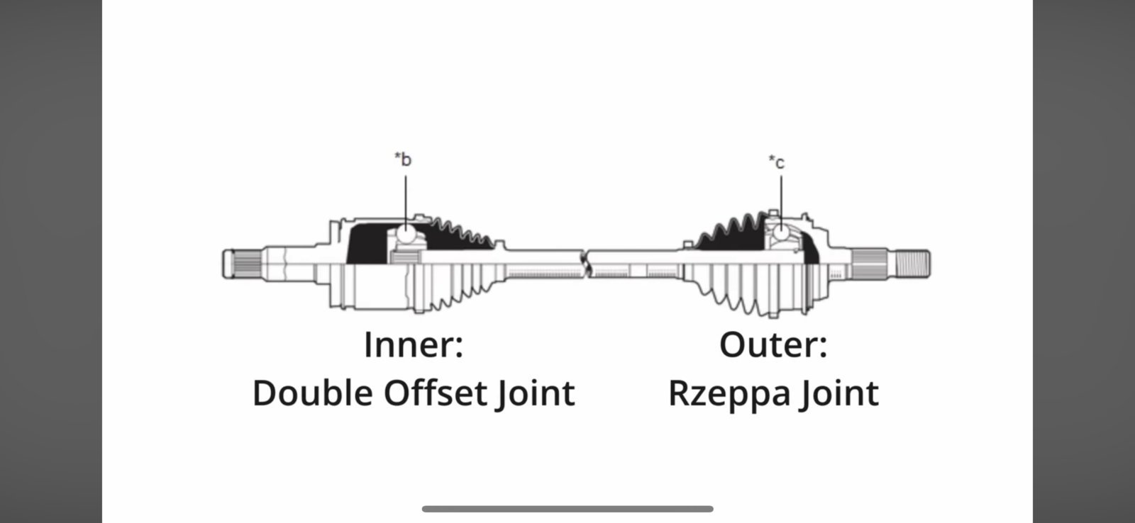

    The TRD lift axles have different internals. The black axles are tripods and the off-road models are double offset. I would assume the TRD axles are offsets like the off-road also
