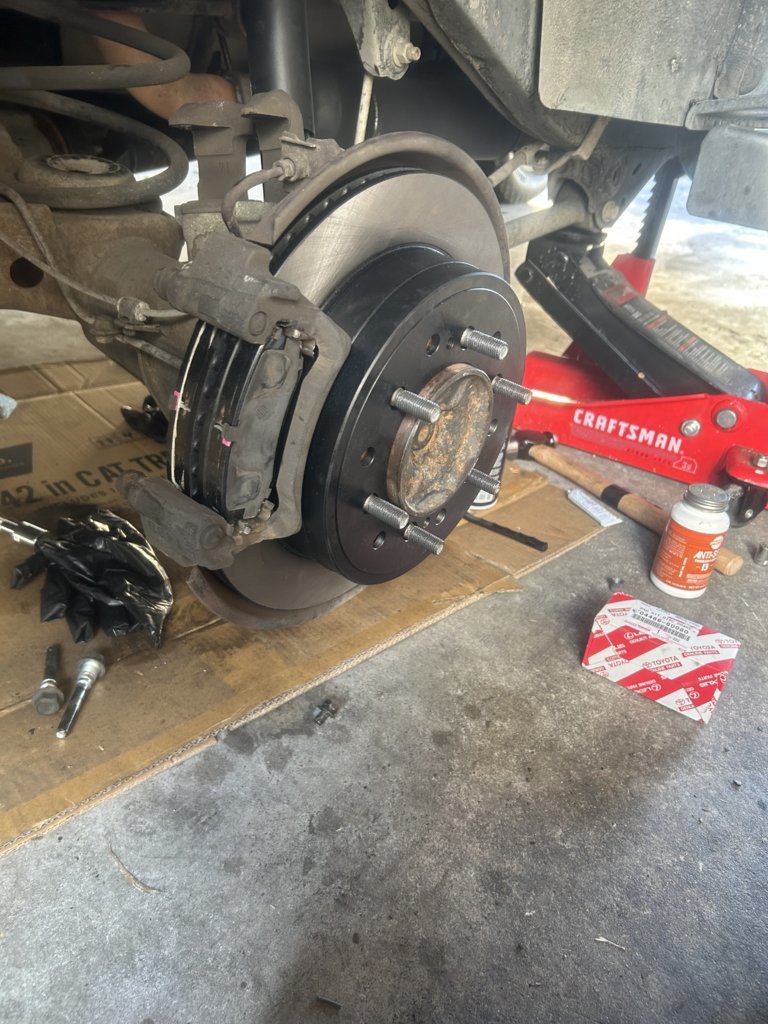

    Update guys, so I got the calipers and pads apart no problem. But I can’t get this F**kin rotor off for the life of me. Best I can do is get a bigger hammer from Harbor freight, I’m out of ideas on this one. I could just slap new pads on it and be done, but I’ve already smacked tf out of the rotor so idk if that’s wise…any ideas?

    Also tried adjusting the parking brake adjuster thing as one video advised to help get the rotor off, that didn’t work either…

    First, take your BFH and tap the face of the rotor, around the lugnuts, all the way around, at 1, 3, 5,7,9, 11 o'clock, do this 3-4 times to break it free in case the inner hole of the rotor is rusted to the hub. You don't need to smack the fuck out of it like a pimp on his trick, just moderate taps.
    The rotor has slots in the edges. Use those to your advantage next. Get two stout screwdrivers, and insert one at 12, one at 6 o'clock. Using the handles of the screwdriver, push in on the top while pulling out on the bottom, and alternate directions, like you're trying to walk the rotor off.
    It *SHOULD* come off. If not, repeat a the above a couple more times before you give up.
    If/when you get it off, you may want to brush off any rust from the edge of where the hub seats, and from the mating surface, then apply anti-sieze so this doesn't happen the next time.
    I'm shocked to hear a Cali truck is having these issues. Normally I hear about this happening on rust belt trucks, or on little imports that have a screw holding the rotor in, a lot of people strip the screws because they don't give their screwdriver a couple of good whacks before impacting it off (or they don't use an impact driver)

    There should be two screw holes on the rotor face, 8mm I think. You can thread in a bolt on both and tighten to slowly walk the rotor off the hub. Should be.

    Don't give up yet! Rod may be right. I know the drums have two threaded holes, opposite sides of each other. Just thread two bolts in, hand tighten till snug, then do 1 full turn on each bolt, alternating. It will 100% come off.

    One of them snapped, not even sure what size this thread even is…even a 10mm doesn’t fit

    Wait a minute it didn’t snap, but it’s making a popping noise, not sure why the rotor isn’t coming off

    IT WORKED!

    It took two 12 mms for me, but it came off, thank you guys so much, let’s see if I can finish this without issue

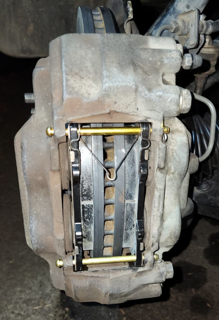

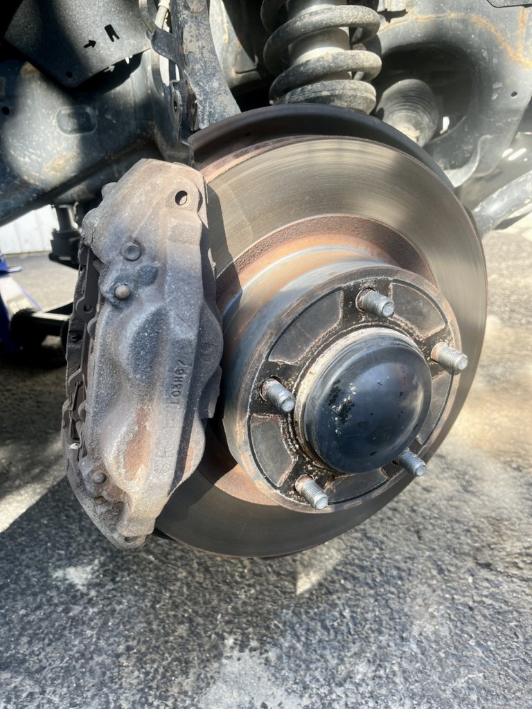

    Consider bedding Advics pads per their 30-30-30 instructions.

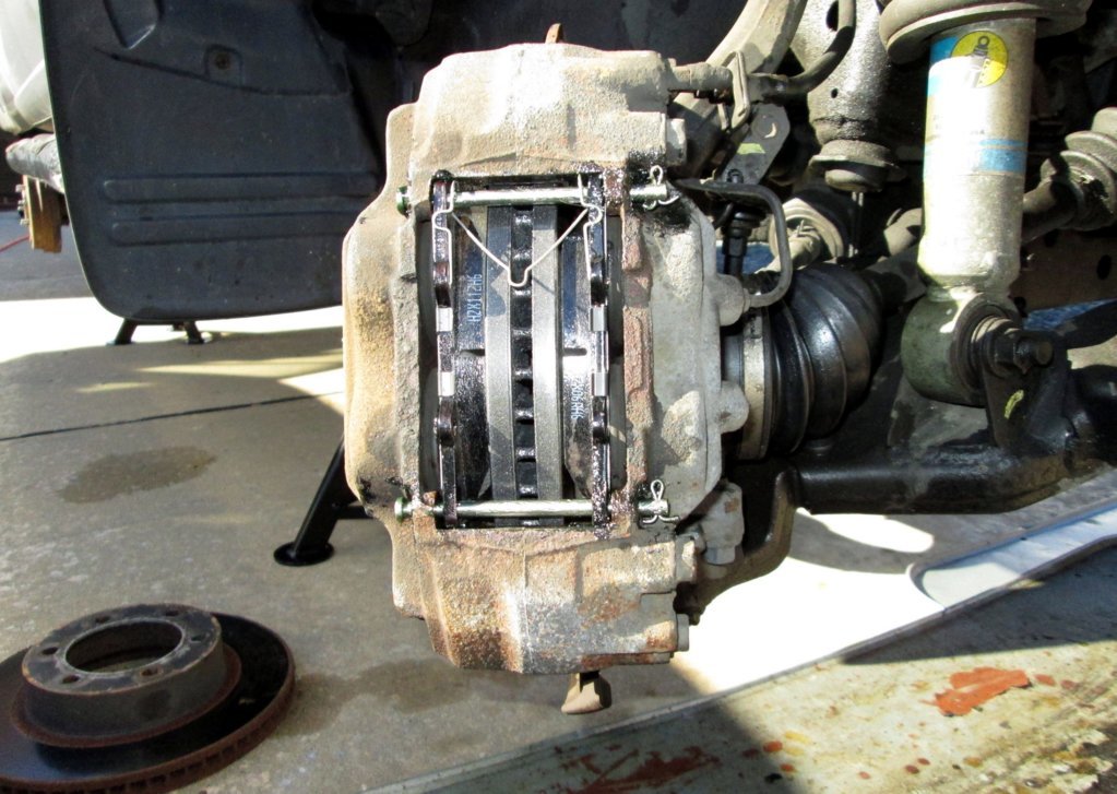

    And per @shifty` fronts look like this when done with squeelers outward and upward.

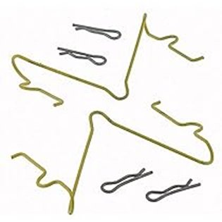

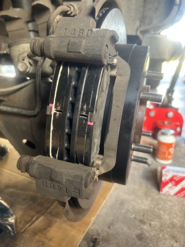

    If you bought the OEM Advics pad replacement kit, they give you all new replacements for those!
    The kit comes with:
    • Replacement slide fasteners
    • Replacement springs
    • (4) New pads, with shims already glued in
    • Packet of brake grease to apply to the rear of the pads
    For the people 2003+ with 13WL calipers, Avics kit is part number AD0976. Kit comes with the following, note the hardware, and shims already glued to the pads ... you didn't buy something else, did you?:
    Close up on the hardware included:

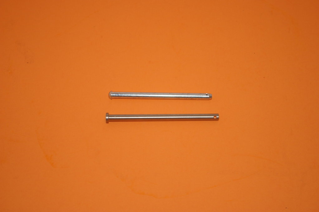

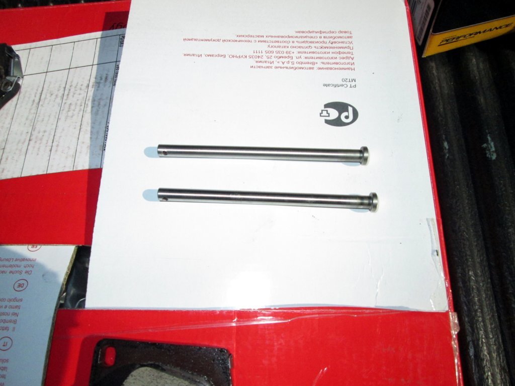

    I replaced the OEM pins 6 years ago with 316SS clevis and cotter pins from McMaster-Carr. They still look new. The OEM pins were always rusting.
    Part numbers 92401A844 and 98355A070. Unfortunately you have to buy 50 cotter pins so you will have 10 lifetimes of them.
    Top is OEM. Clevis is a little longer but is fine.
