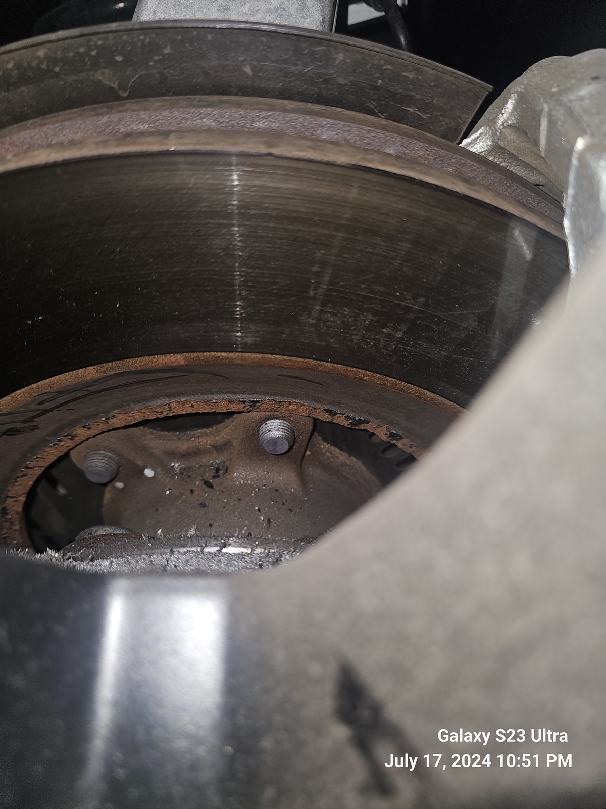

  16. Jul 20, 2024 at 5:37 AM
    #46
    Del&FeFe2024
    Del&FeFe2024 New Member
    Jul 10, 2024
    #119693
    Del&FeFe
    2023 Toyota Tundra Limited Fuck It Edition.
    Stock at the moment, well I mean, added the Integrated DashCam, Carmate DX4000RA 360° DashCam. Window tint, Bed Mat, additional lighting, TRD Pro Grill
    My rotor Left Front @ 2200 miles:
    Towed to Dealership awaiting findings
