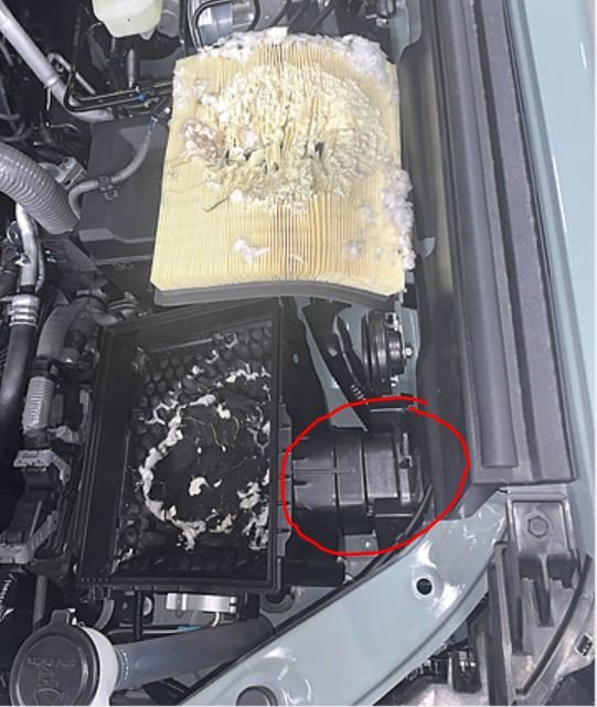

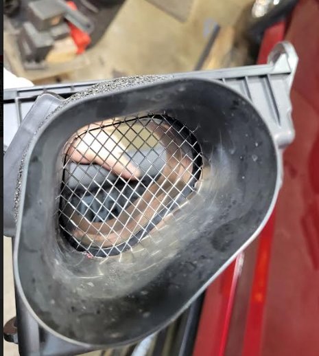

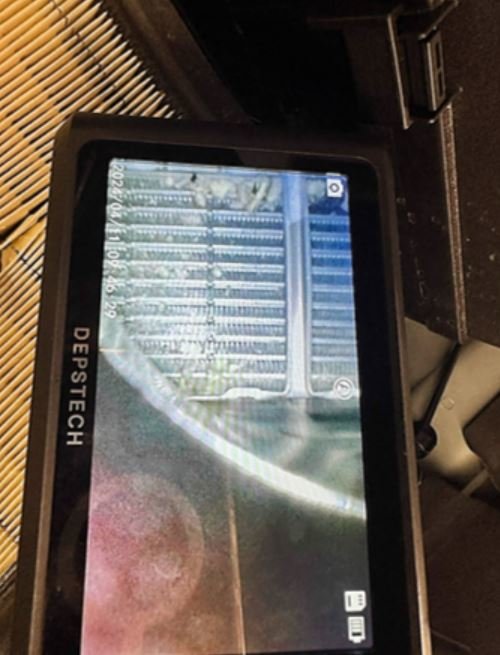

    air box and point of entry circled in red.jpg scope camera of inter-cooler.jpg I had the CEL come on a few weeks ago. Truck drove fine but took it in regardless. Dealership cleared the errors and couldn't get it to come back. After the first appointment the light came back on and I made an appointment to get it serviced again. This time they found that a rodent had crawled up in the outlet of the turbo and ate the filter and the top of the turbo box. When I drove the debris apparently got sucked into the intercooler and that now needs to be replaced.
    I haven't seen my truck in person but got these photos from the insurance adjuster. According to him there is no screen blocking entry to the turbo system and it daylights under the fender. Has anyone had this issue?
    I'm also looking for ideas for a screen or something to prevent this from happening again, if anyone has suggestions.

    The rodent didnt get into the turbo outlet...it got into your airbox. The debris then made it into/out of the turbo and into the intercooler and possibly into the engine. I dont think the paper and bits of plastic would ruin either the engine or intercooler but I cant imagine the plastic being good on the turbo...the paper will just shred apart.
    The airbox intake is in fact a straight shot into the fender. I guess you could fab a metal screen to prevent them from getting in...something thin wont affect air intake but idk how effective it would be

    You are correct it was the air box, apologies for the poor wording. Apparently the intercooler won't pressurize so that will be getting replaced. Won't know if the turbo needs replacement until they are able to test the whole system.

    1. For your air filter, you can put screen over the inlet to the air box. We use very flexible mess screen and screws from the OUTSIDE!!!

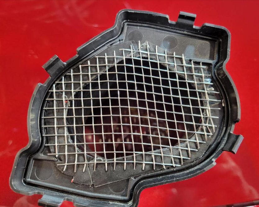

    Best solution I’ve seen yet. Find you fresh air inlet into the cabin and screen that too. Metal galvanized mesh with nothing larger than 1/4” sq.
    One way to also keep them outside the cabin is leave ‘RECIRC’ on when you park. It physically shuts a door to the outside. I replaced my entire heater assembly on my ‘07, and while in there I covered the entire inlet opening with 1/4” screen. Geez, any one of the cats in the above photos could have fit thrum that opening let alone a rodent!!

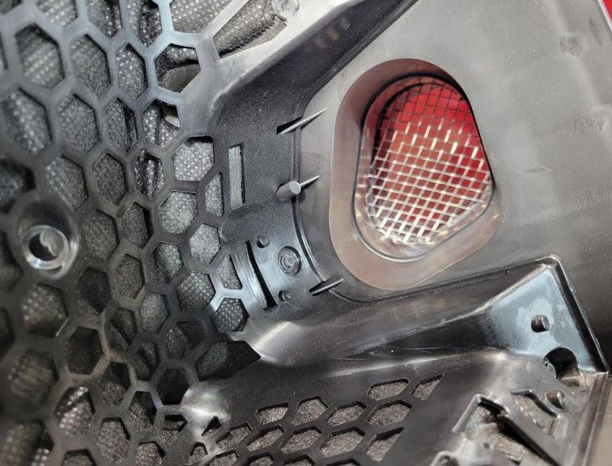

    They aren’t cotton and they have a metal mesh screen.
