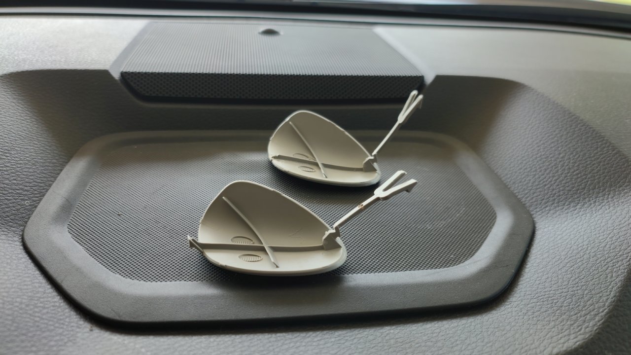

    Finally got tired of my grab handle caps popping off. To my surprise , you can buy them separate. Here's the part number if anyone needs it. This is for the driver lower and passenger upper . I got lucky because the picture was crappy. Other picture you can see the tab that I broke off by prying up on the wrong side of it 1sr.
