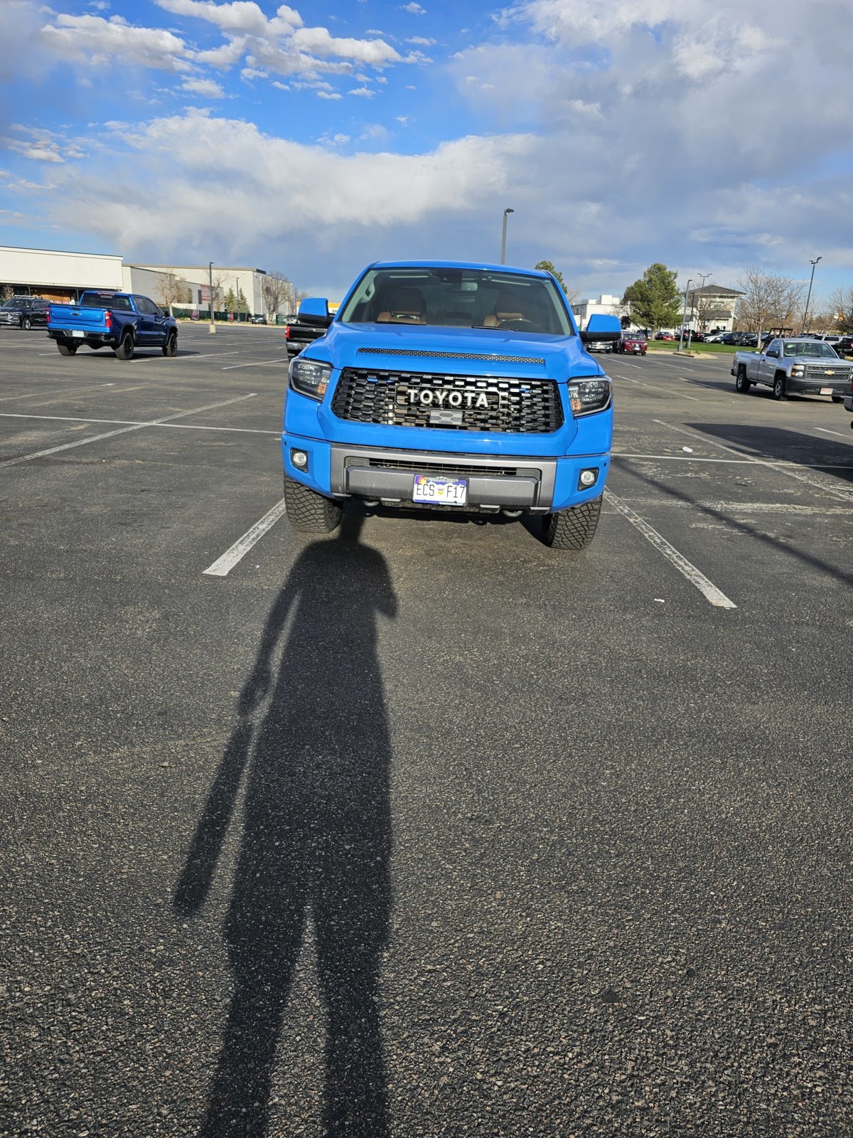

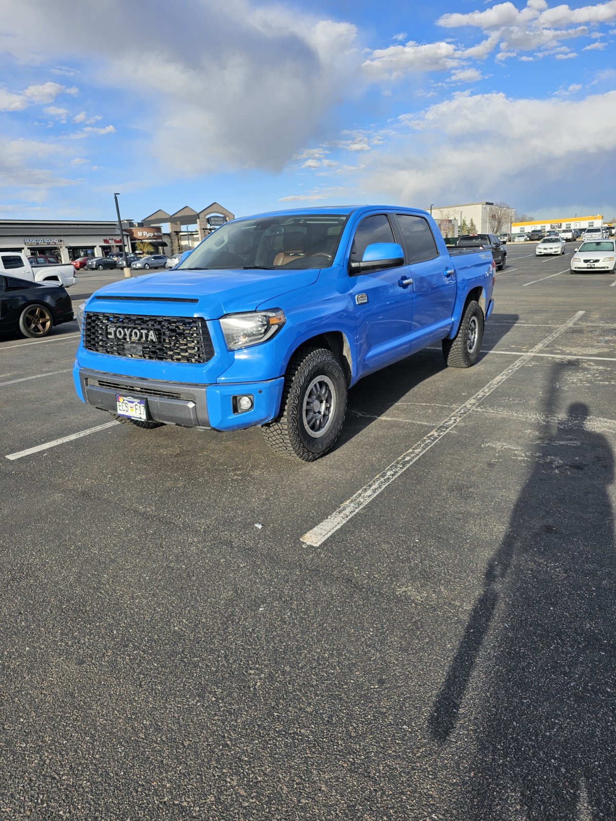

    2020 Voodoo 1794 RW Wheels 315/70
    Goodyear Territory MT 315/70
    Stock suspension for now

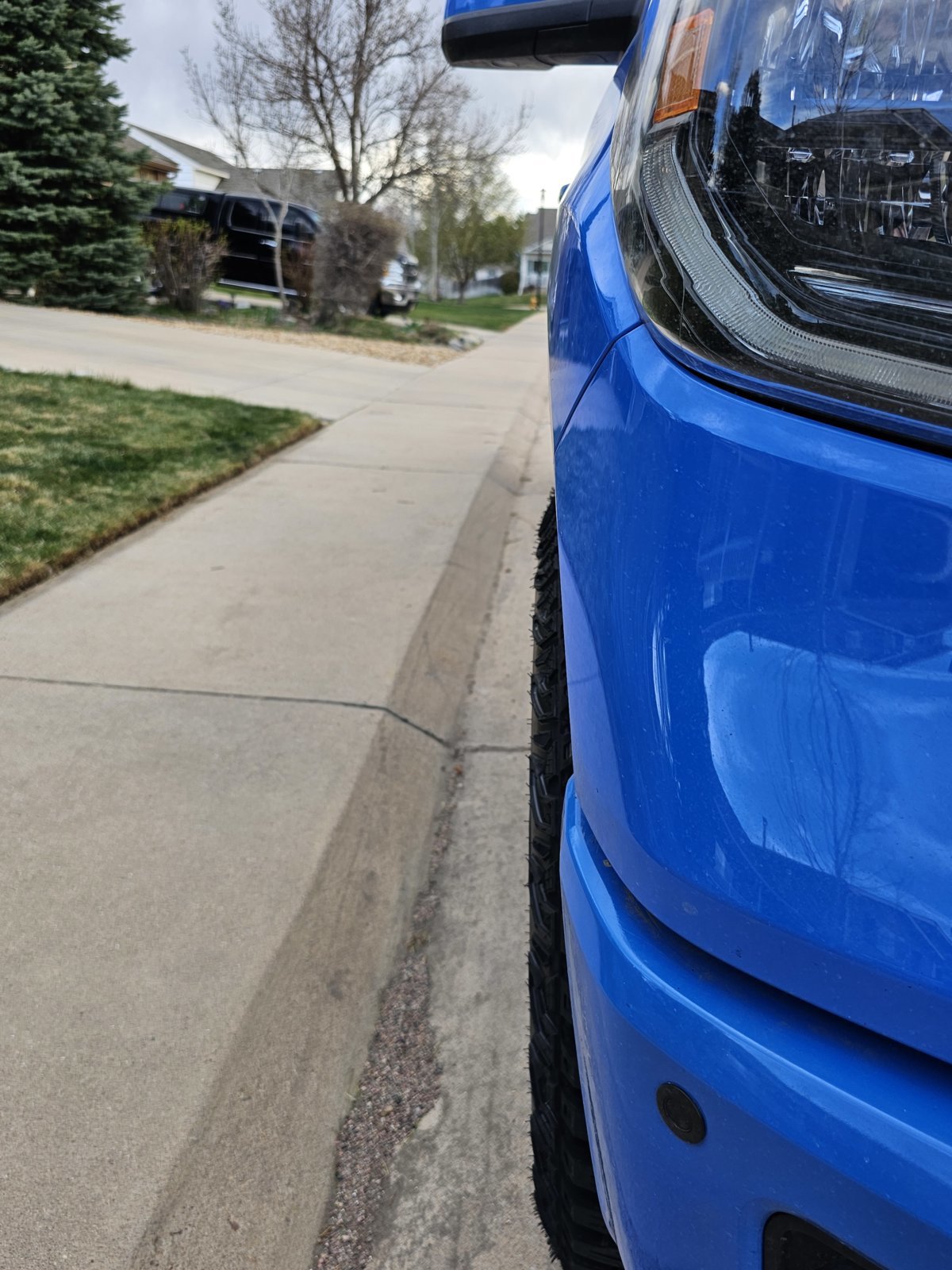

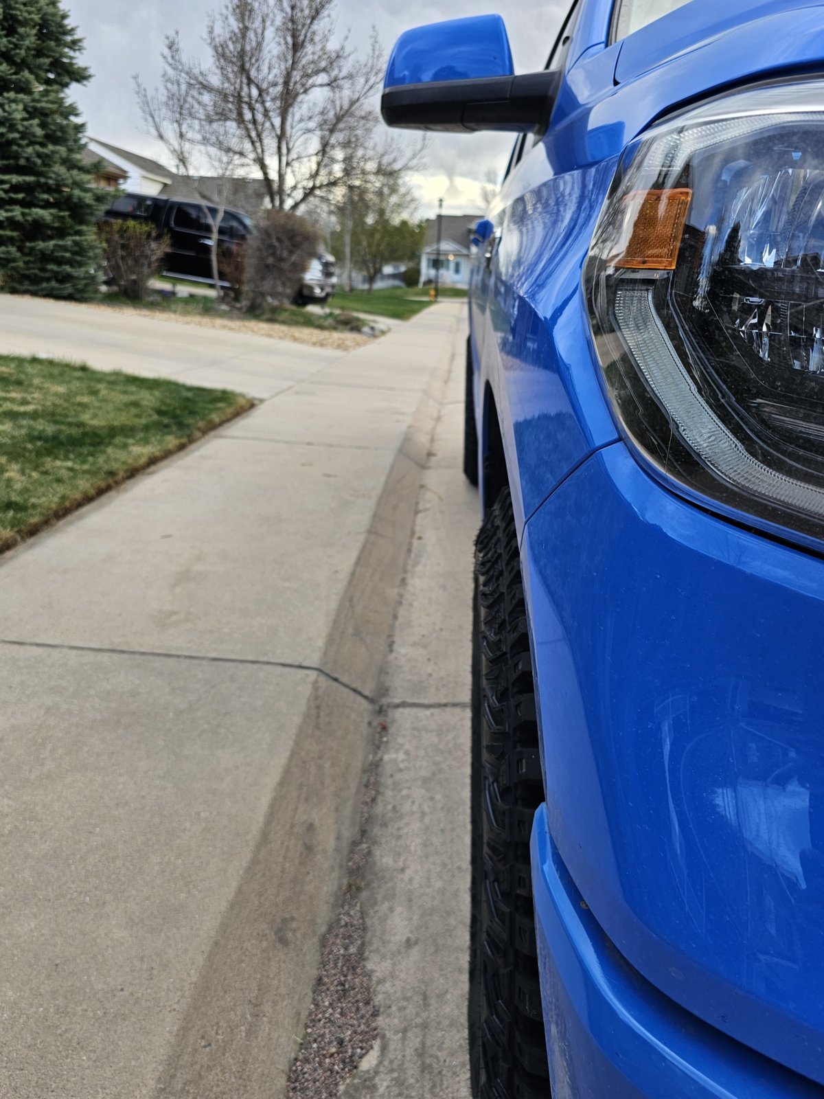

    Just the slightest poke

    I've got about the same amount of tire outside the wheel well. I live on a half mile long gravel road. My tires throw gravel up onto the side of the truck now. I'm going to have to get some fender flares.

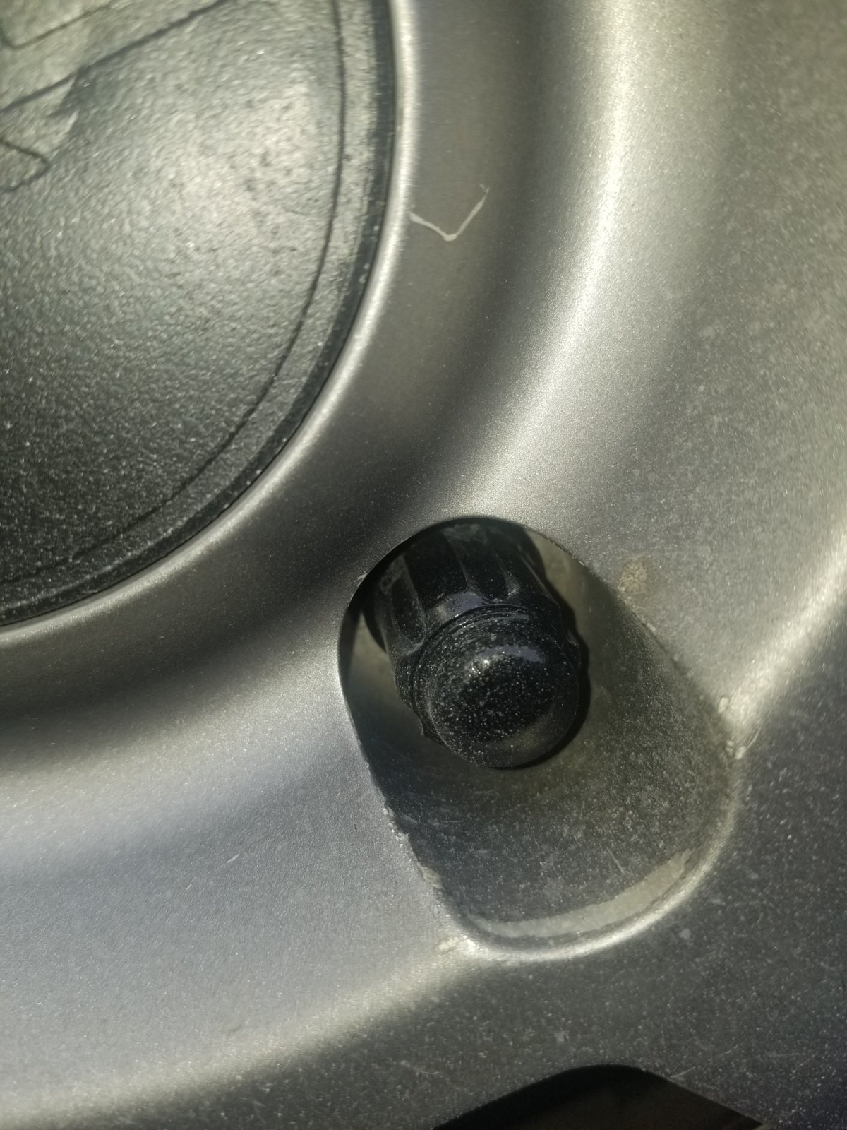

    For anyone following or who may search this up if they're in a similar situation, I found the socket. It's a 45/64 6 Spline. I have no clue what brand the lug nuts are, but maybe this can be helpful.

    Your rig is looking tough with the new wheel and tire combo Brandon. What are you leaning towards with suspension?

    ordered 6112/5160. #3/1.9". have the 3 CB spacers and 3" CB shackle for the rear. will probably get SPC UCAs as well to add a little caster and try rekgen flaps
    waiting to pick up RCI bumper and sliders. have the skids sitting in the garage already. got the new RCI low-pro bed rack as well and a 23Zero RTT that i'll swap with the tonneau cover as needed

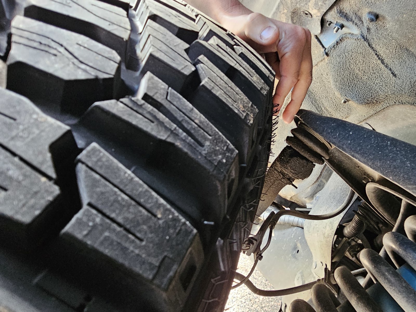

    Not very. The Territory MT also aren't a true 315

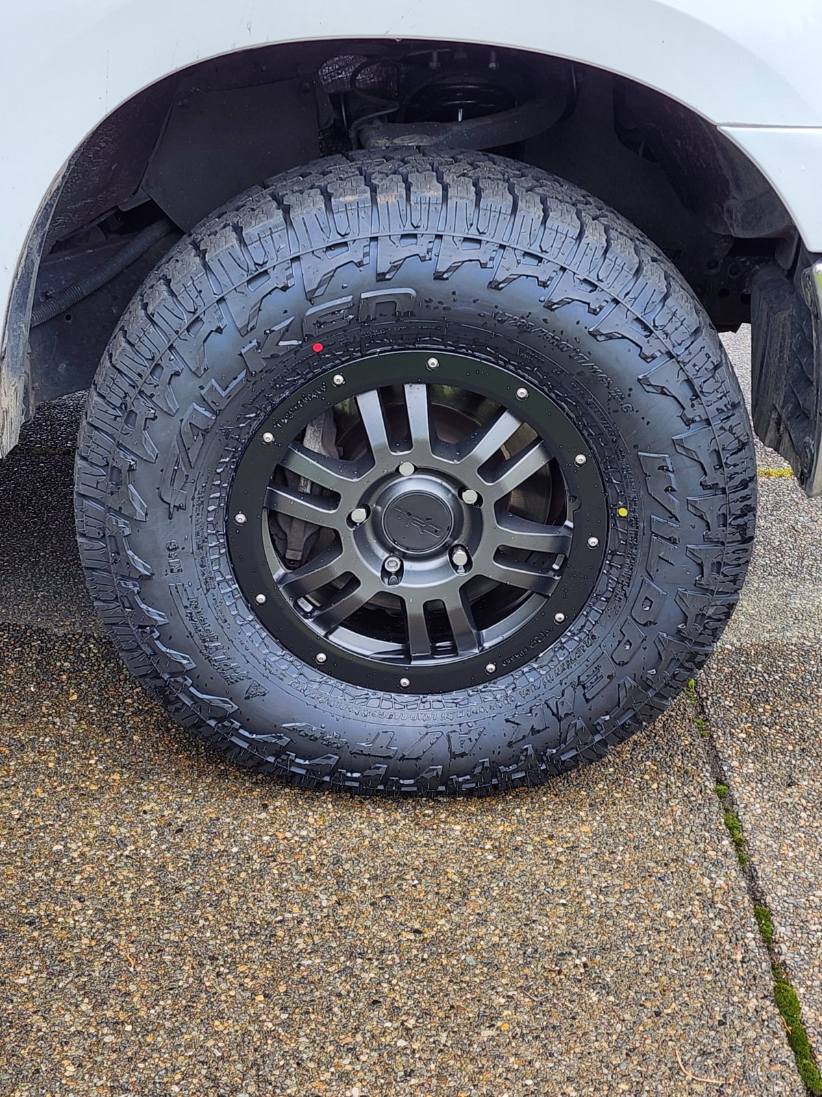

    Found a set of RW wheels for sale locally. One ring had a chunk taken out of it. Decided to have that repaired and have the wheels refinished. 6112/5160 combo at 1.3" front, stock rear height. 285/75R17 Falken Wildpeak A/T4W tires.

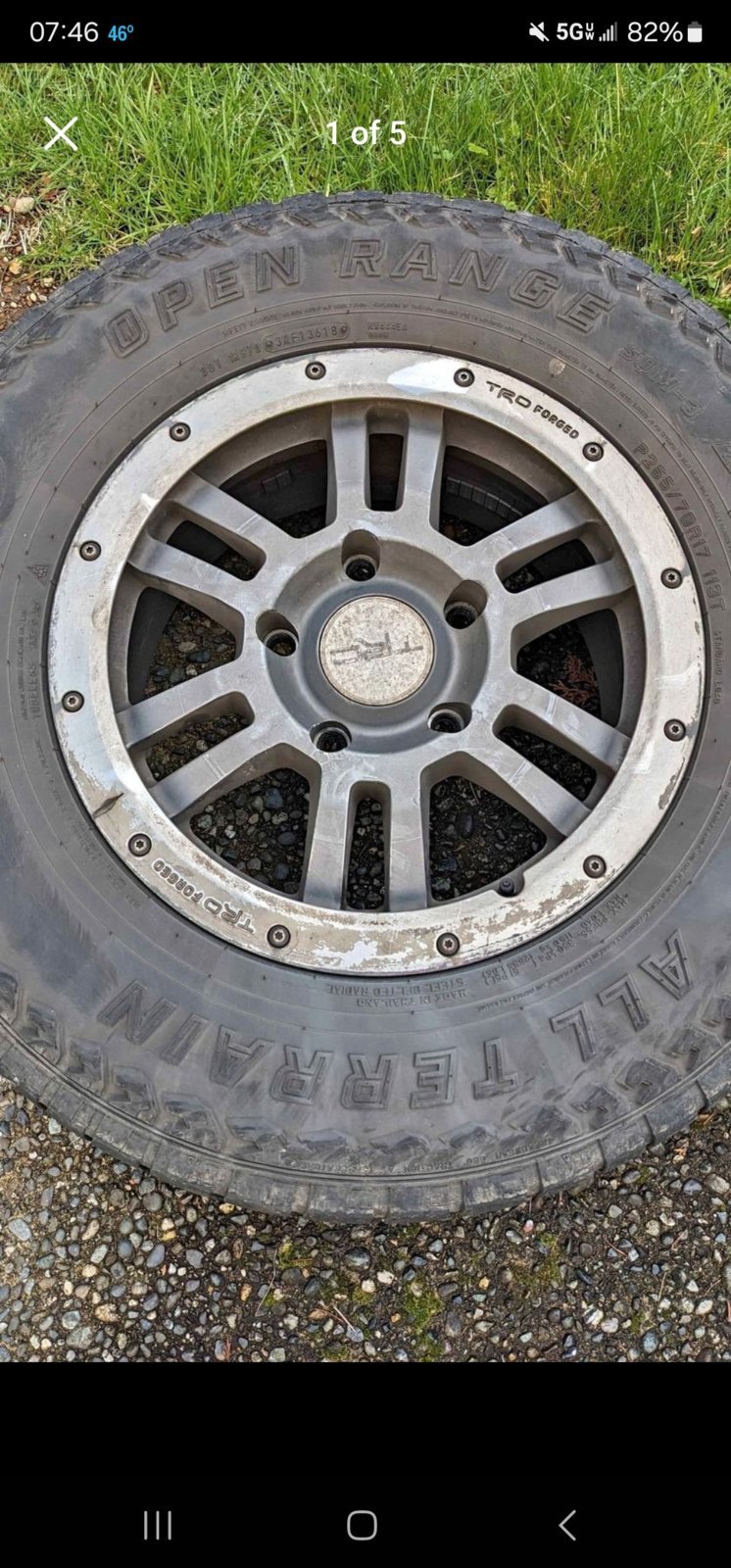

    @bmtrujillo98 Sound Wheel Works in Bellevue, WA. Corey did a awesome job. Here is the wheel before the repair. The damage is in the lower left.

    Looks fantastic!!
