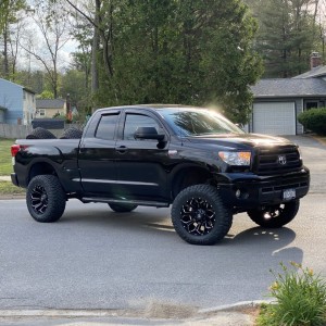

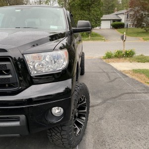

    Empty pockets build
    Empty pockets build New Member
    Dec 31, 2023
    #109412
    9

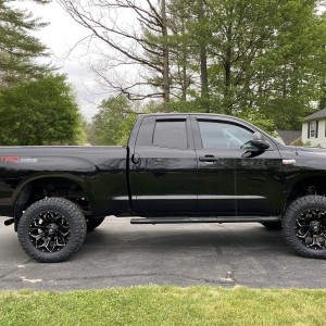

    13 dblcab tundra 4x4
    3 inch level / lift kit , tough country ucas 34 x11.50 x 18 ridge grapplers 1.5 inch wheel spacers.
    So so sick.

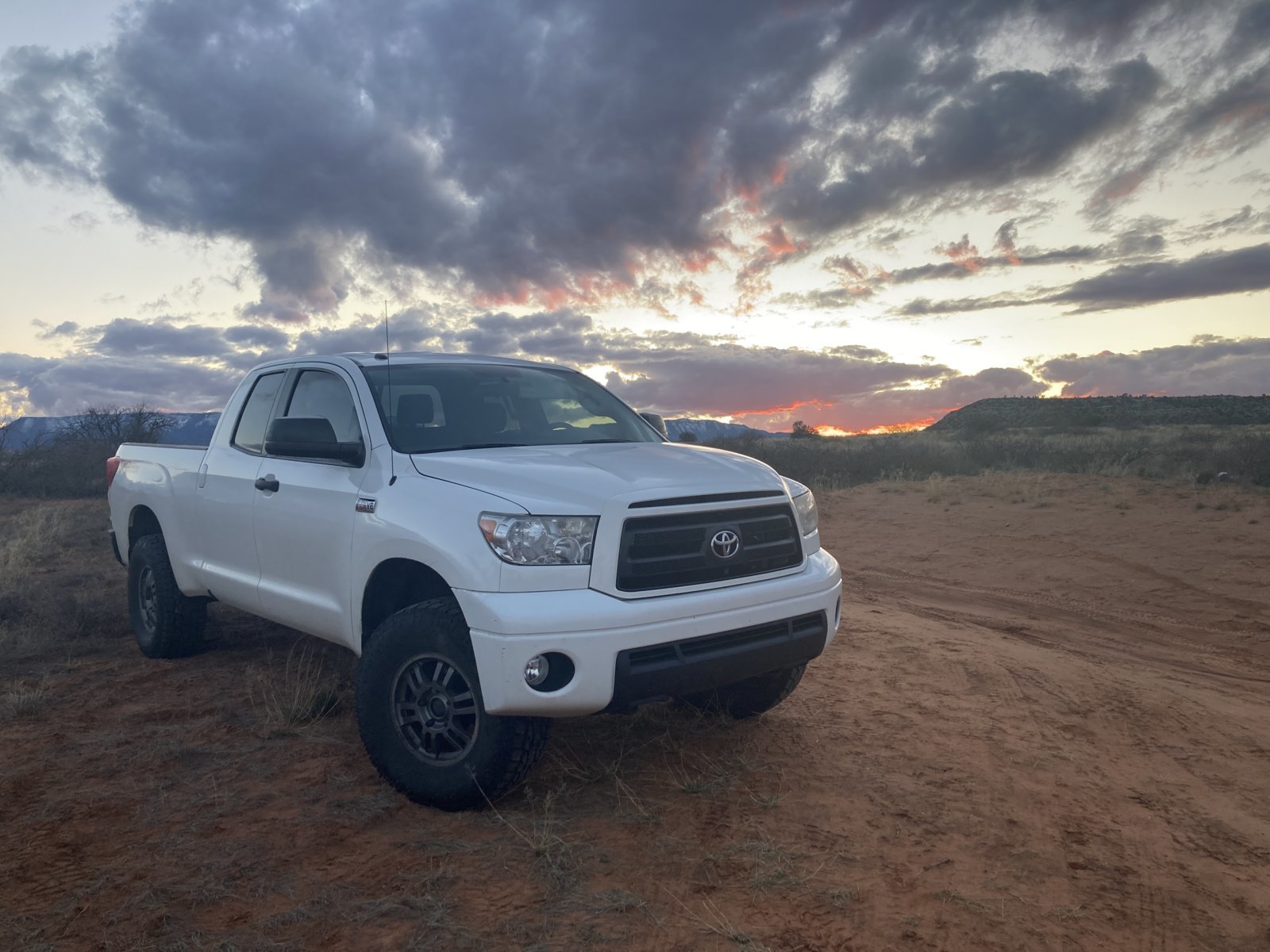

    I run 35x12.5 Toyo's with no wheel spacers. I also have stock Rock Warrior wheels and only see minor rubbing on the inner fender liners.

    Yes, I do. I have the Bilstein 6112's up front with the clip/notch set at the 2" of lift, and Bilstein 5160's w/Deaver add-a-leaf in the rear for 1.5" of lift. I am running stock upper control arms. It all clears.

    Your truck looks really good. nice job.

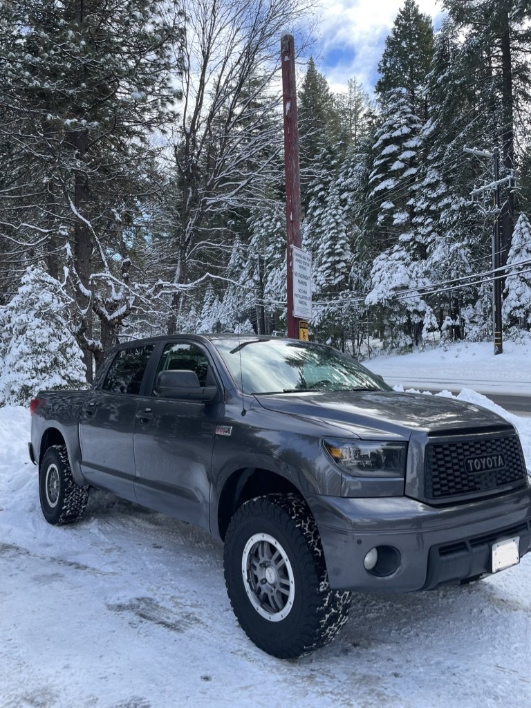

    "New to me" 2013...

    Dang...that looks great. Making me wish I had gotten a Magnetic Gray Metallic Rock Warrior instead of white.

    Thanks AZEric.... The PO did some tasteful mods IMO. This is the first time I've strayed from buying "all original" types. I was leaning toward a Gen 2.5 until I found this. Already has Morimoto headlights that look much better than stock. I'm thinking I'll add their fog lamps to match...

    Tasteful indeed. He gave you the pro grill, headlights and looks like some suspension upgrades as well. You have a really nice rig as it sits now.

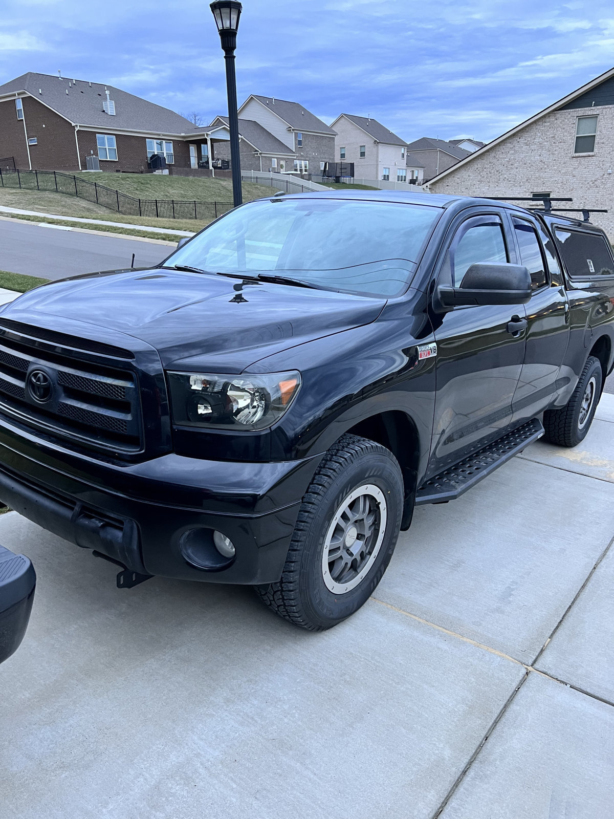

    Do you have any pictures with the stock size
    tires and the lift?

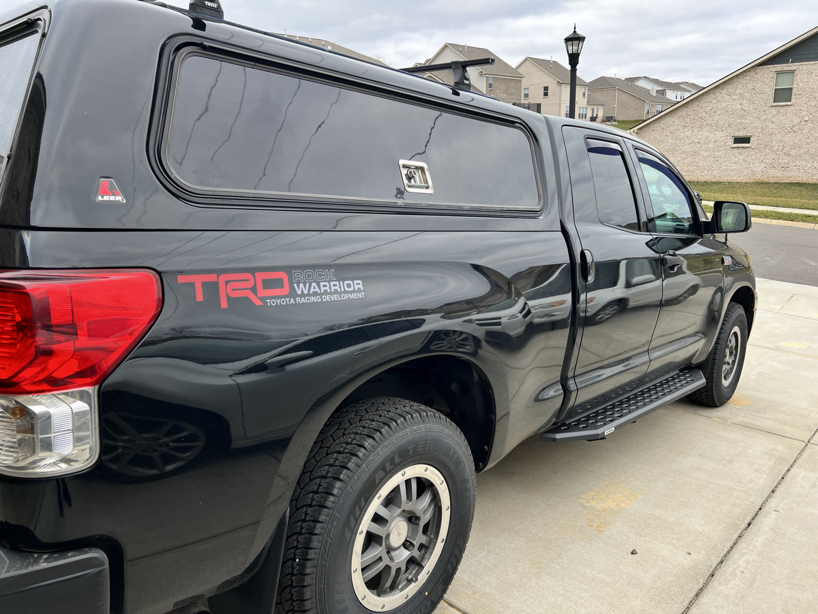

    Technically it's a leveling kit. About 2.5" in front and a little over 1" in the back with new shackles and shock. It's a little older picture, but stance is the same.

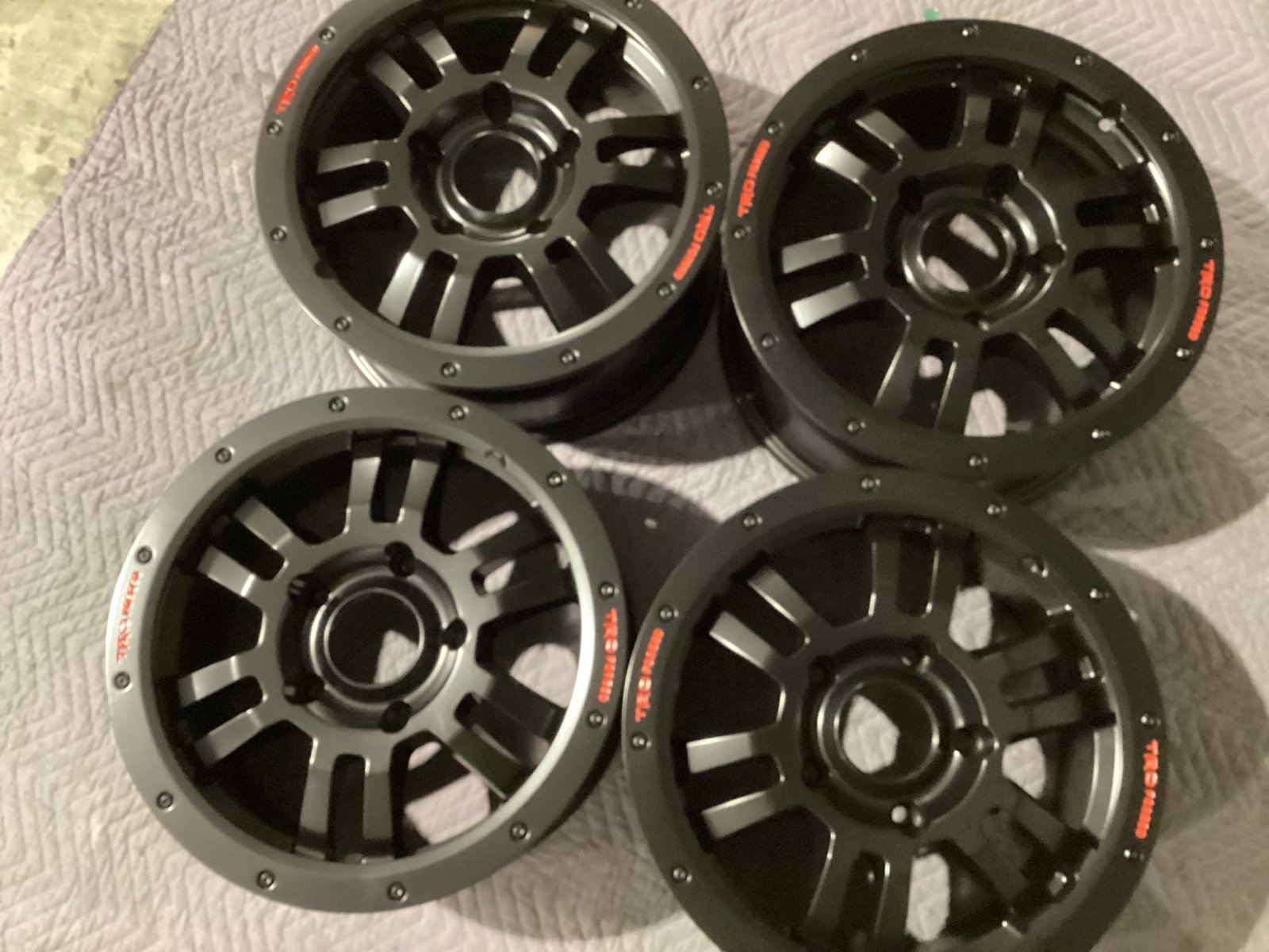

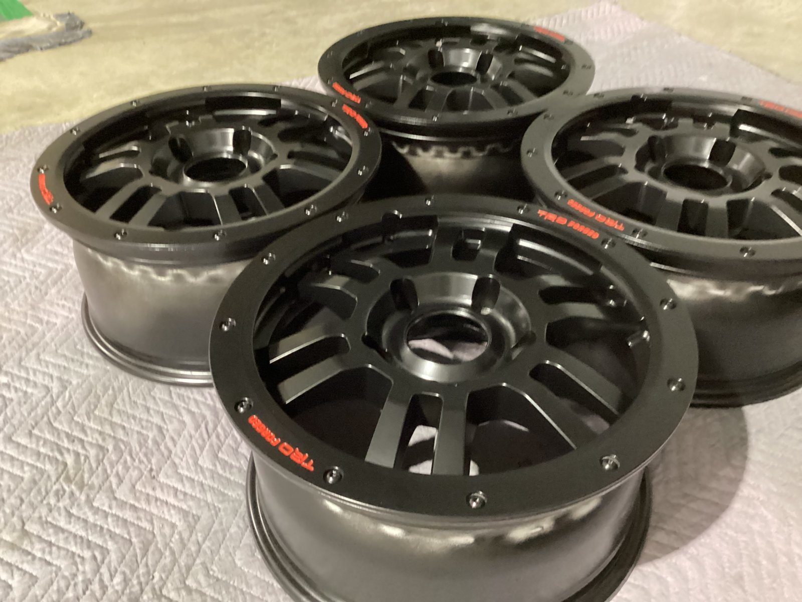

    Just got the rims powder coated.

    OHHHHH SNAPPPP!!!! That looks so good! Are the letters Powder Coated as well or did you hand paint those? Do you have a good set of center caps to match?

    I think the guy powder coated the red also. I think I'm going to just paint the center caps black and the trd red.

    35” KO2’s. Has a 2/1 Bilstein Lift

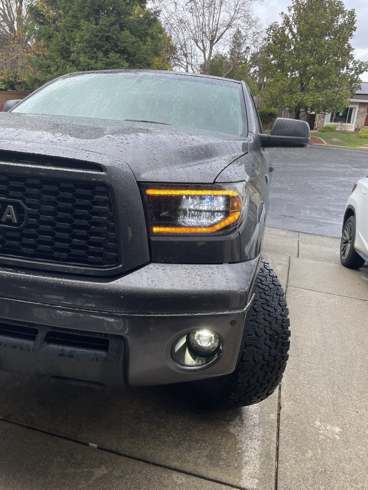

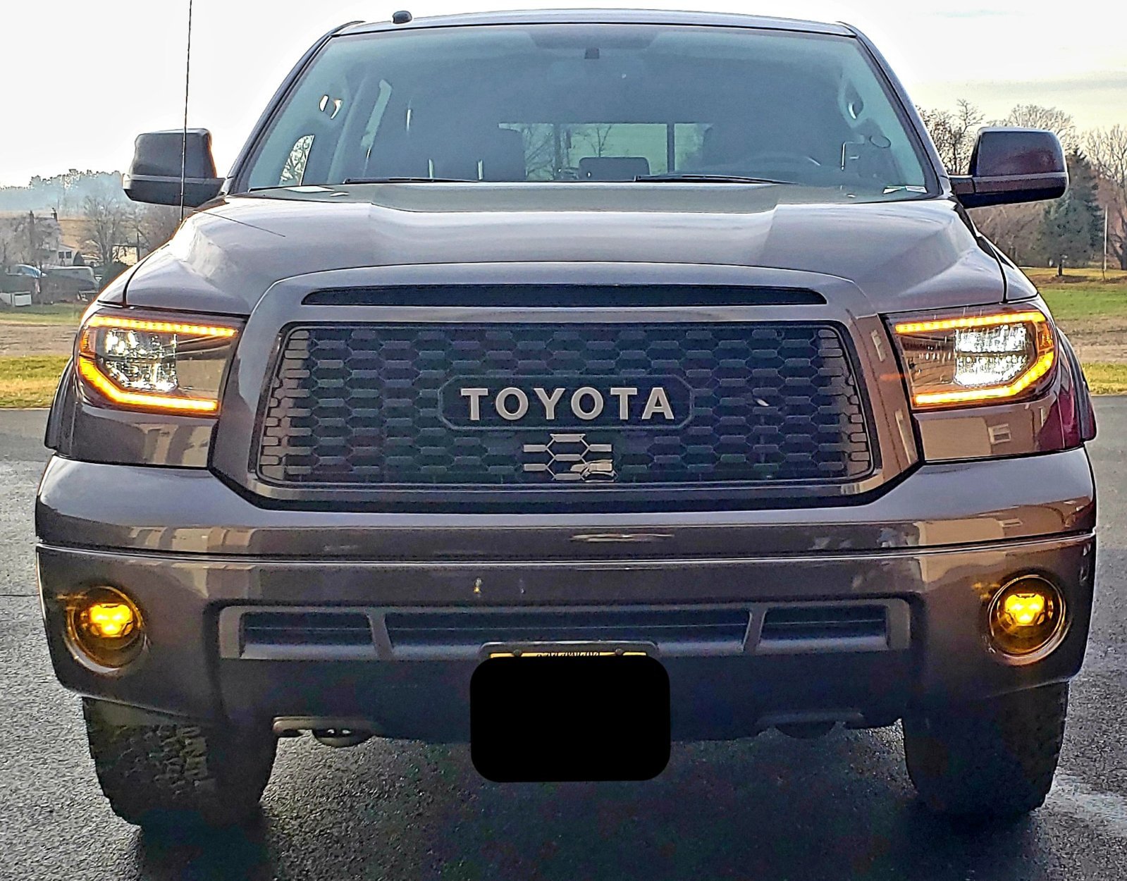

    Got matching Morimoto fog lights installed. Their electrical connections left something to be desired, but otherwise seem like good quality.

    How reliable are the Morimoto products?
