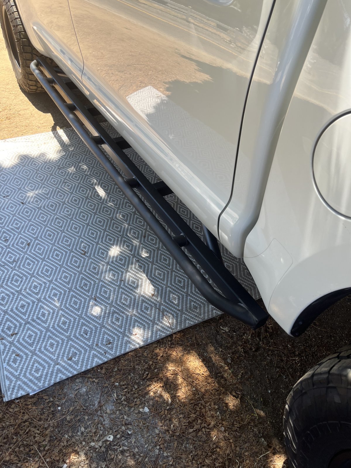

    RCIs are 100% bolt on and will support the vehicle. However, if you are using them in 'extreme' conditions they do recommend frame drilling (I believe 4 holes per side) for the additional support. I've been very happy w/mine went w/powder coated and no top plate.
    Pics of mine before and after install so you can see how they are designed.
    84922
    I don't 'rock crawl' or regularly drop the truck on obstacles like some of our more aggressive crawlers (@Cruzer :boink:)... However, if you are doing the type of activity he's doing, I'd probably suggest drilling into the frame for the extra support; nice thing about the RCIs is that you can install bolt on and then drill in later if you decide you need the added support.
    Other options being used out there are White Knuckle Off Road and Westcott Designs... both of which require drilling :thumbsup:
    Here's another thread dealing w/the sliders and some of RCIs skids/cat guards as well that may be worth looking at for additional info and comments... 42

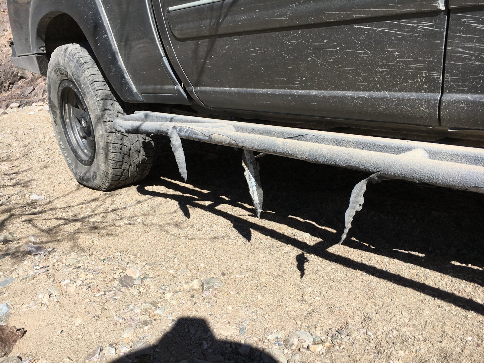

    169A0985-43CD-4DAA-BBD1-2C0ADCDDEF56.jpg Just don’t do Bedliner, unless you like dingle berries

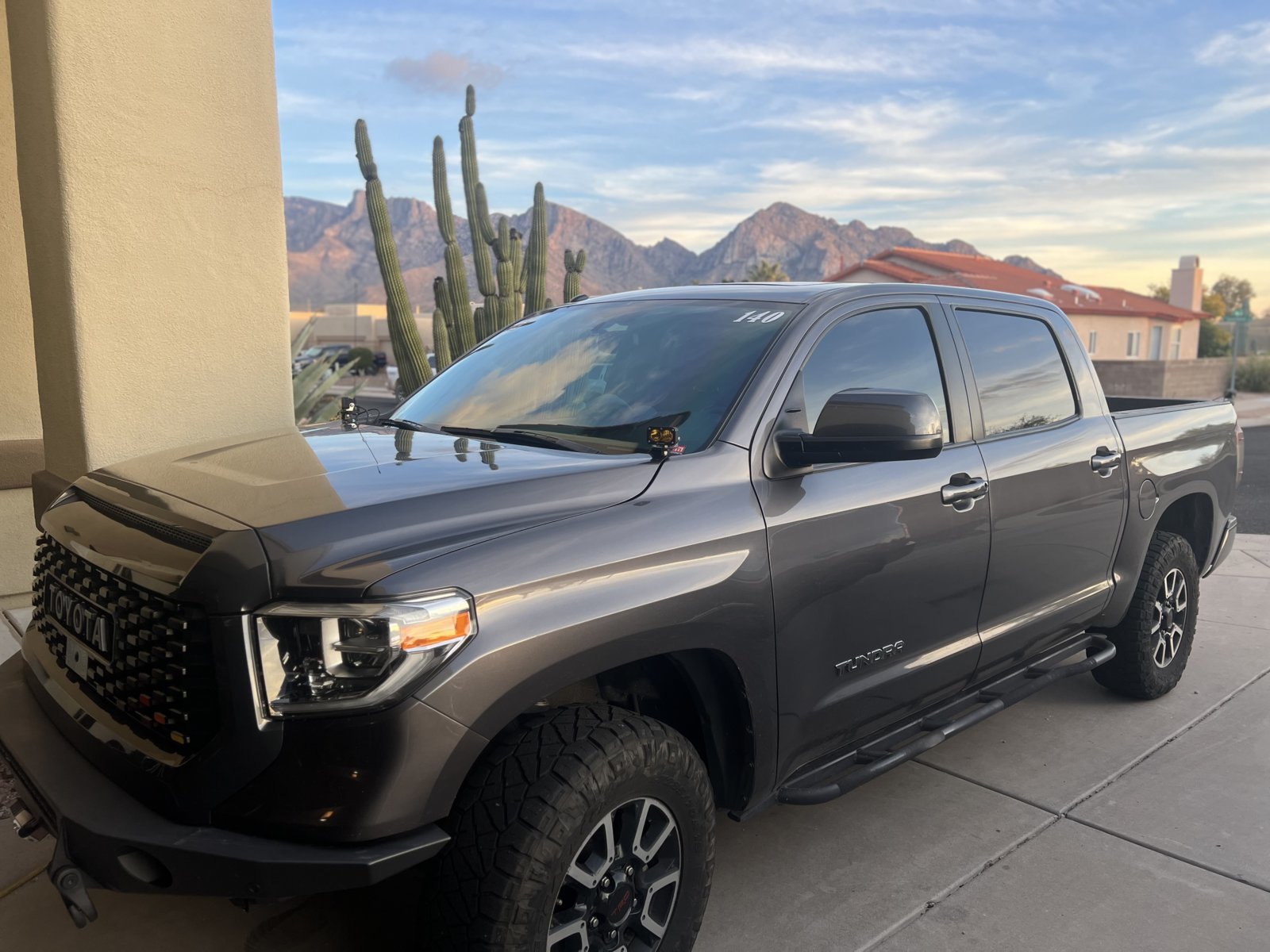

    WKOR bare metal sprayed with steel it guy here. 5 holes per side.

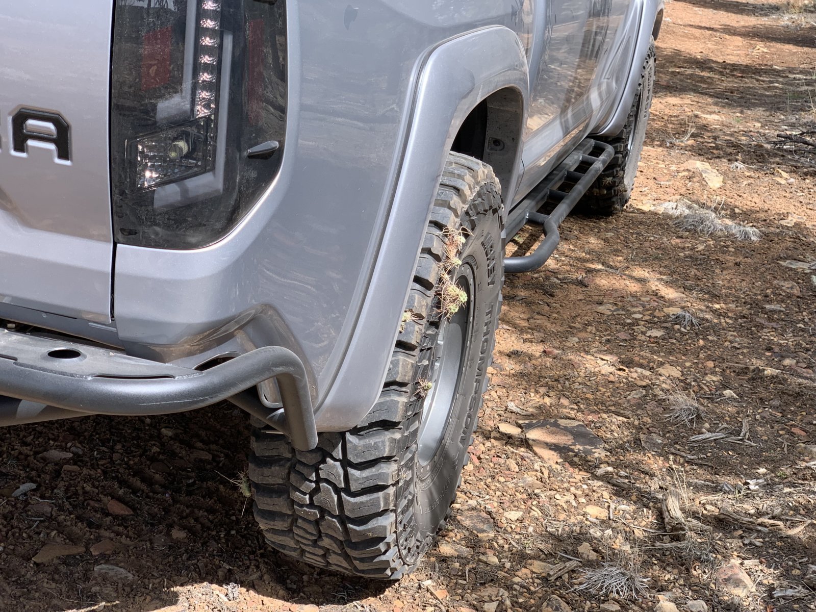

    No one's mentioned them, but I have Caliraised sliders on my crewmax. They bolt on, but have better gusseting and the base plate runs the whole length of the sliders, not just where the legs are. Plus they have extra clamping into the C channel. I've dropped my truck on them a few times with no permanent damage to either truck or sliders.
    Fwiw I got them bare, painted them with Rust-Oleum while they were on the truck, and put skateboard/grip tape on top

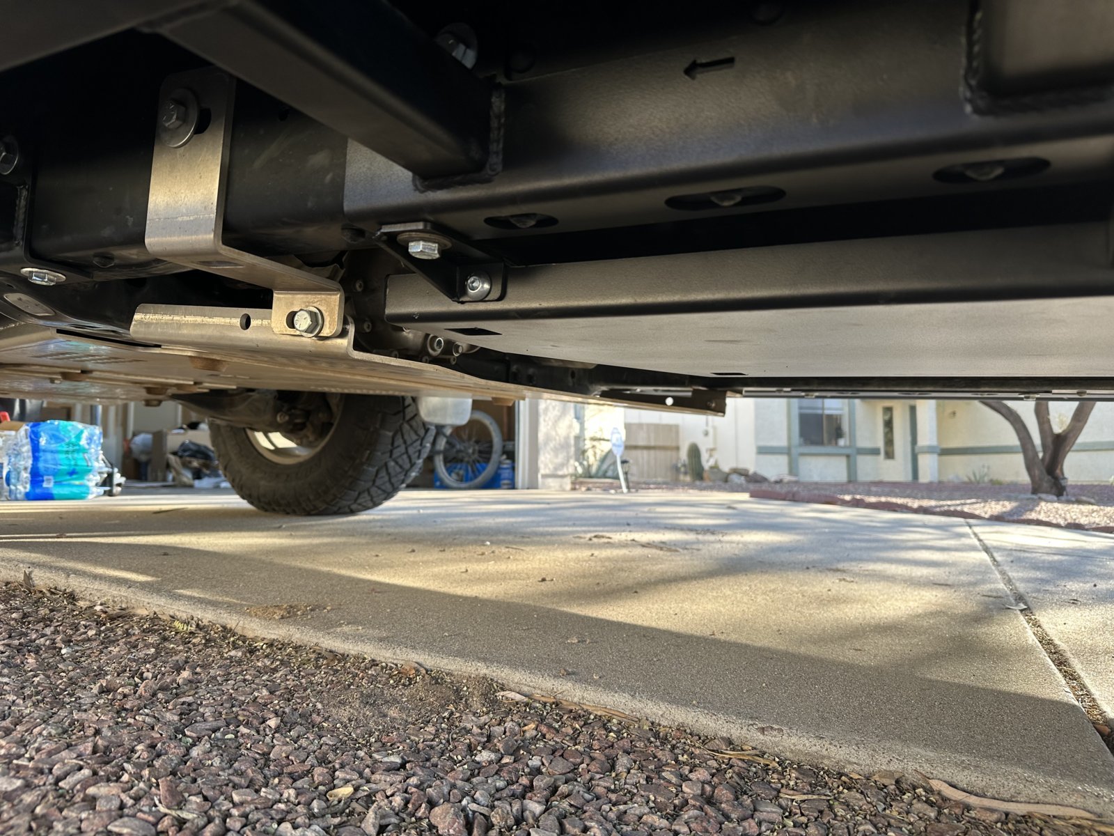

    I also did Victory 4x4. They wrap under the frame. Drilled underside of the frame, because strength. They've taken a few good hits, but nothing too crazy yet.
    I do wish they had a kick out, though.
    I chose them because they worked with Valhalla skid/cat shields and Victory 4x4's super tough gas tank skid.

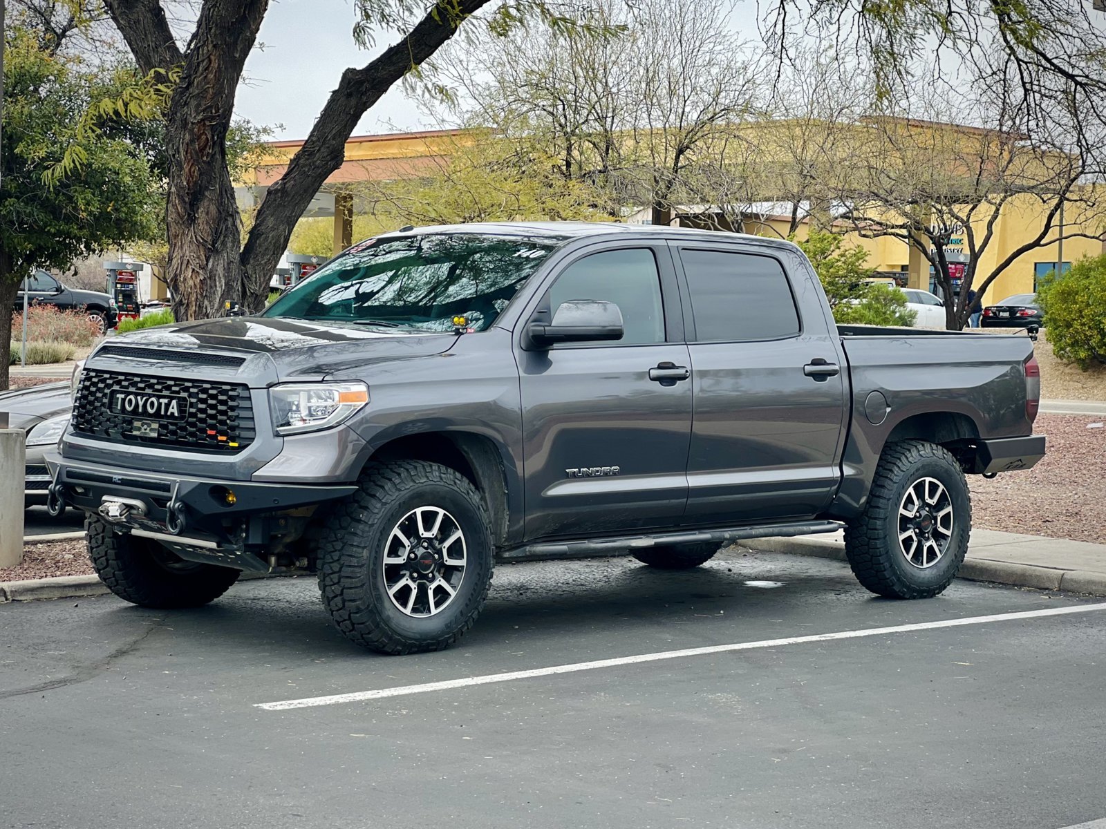

    I have White Knuckle sliders and they require drilling. I never had an Offroad vehicle that I did not have to drill holes to install.
    What is it about the drilling that you are concerned about? I can highly recommend the WK sliders for sure.
    I was looking for a pic that shows then but this one is the only one I found quickly
