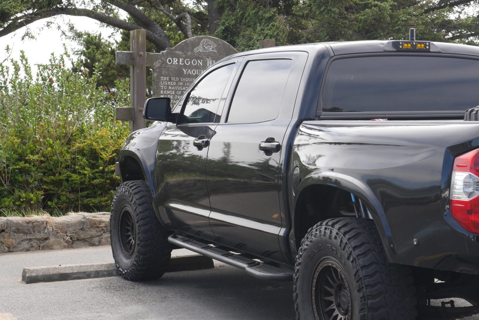

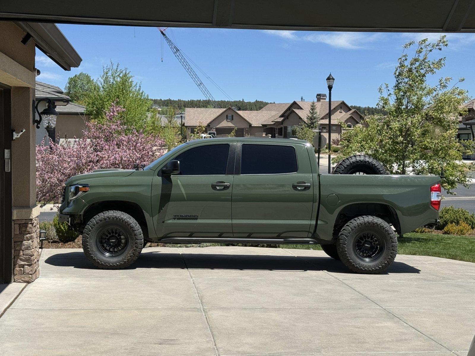

    Got my RCI sliders installed a few days ago. No top plates. Wife and kid dig them for climbing in and out. Slapped some 3m traction tape on the outer rails to make it easy to get in and out. With the Tundra doors being wider than the rockers, they sit almost as far out as traditional tube steps but not quite as low.
    I got lucky, my 4th hole was right next to the front gas tank strap so I was able to wiggle it into place. The frame in my truck did not have another big hole for the 5th bolt on the driver side near the middle of the tank. I did have a couple smaller M8 holes at the rear of the mounting plate and was able to use those.

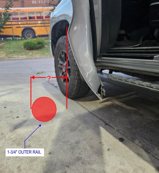

    So you are saying they sit flush with the door?

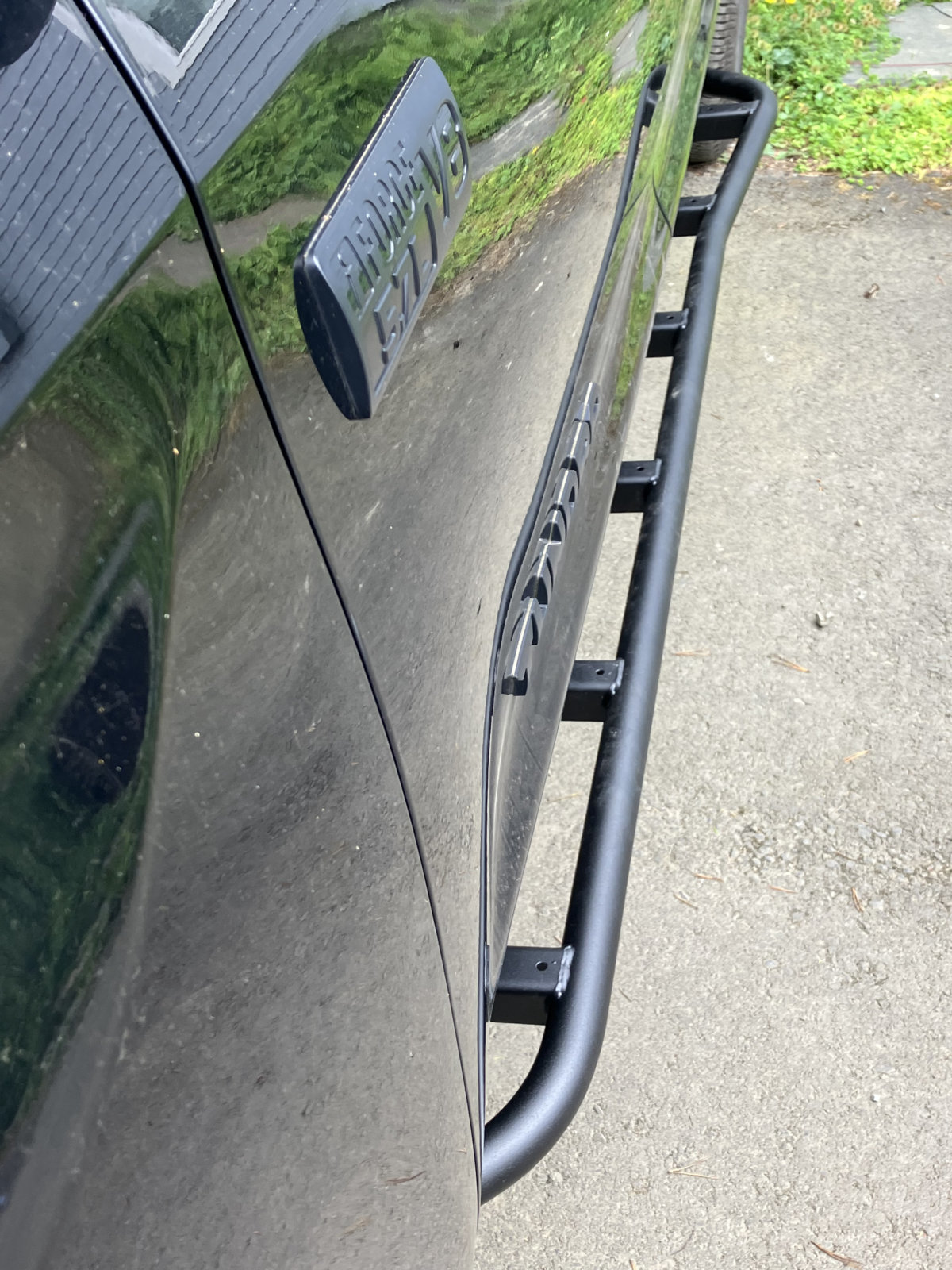

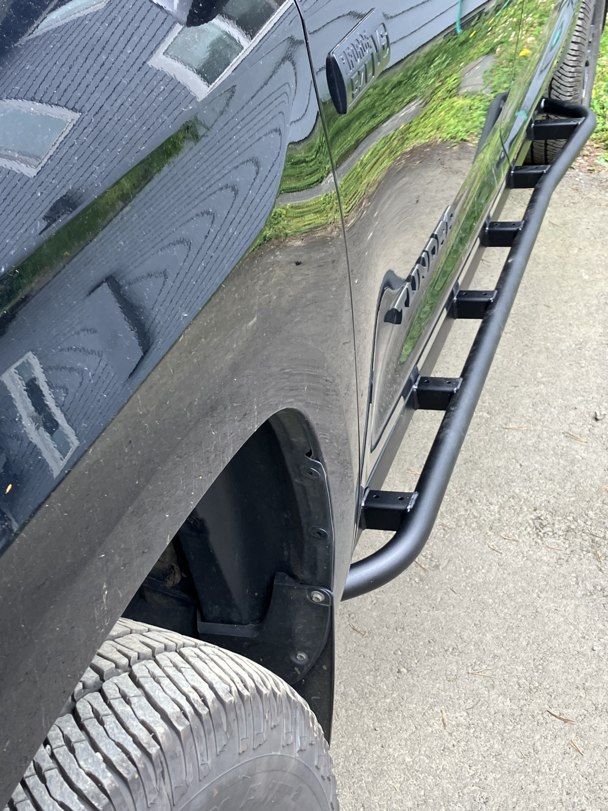

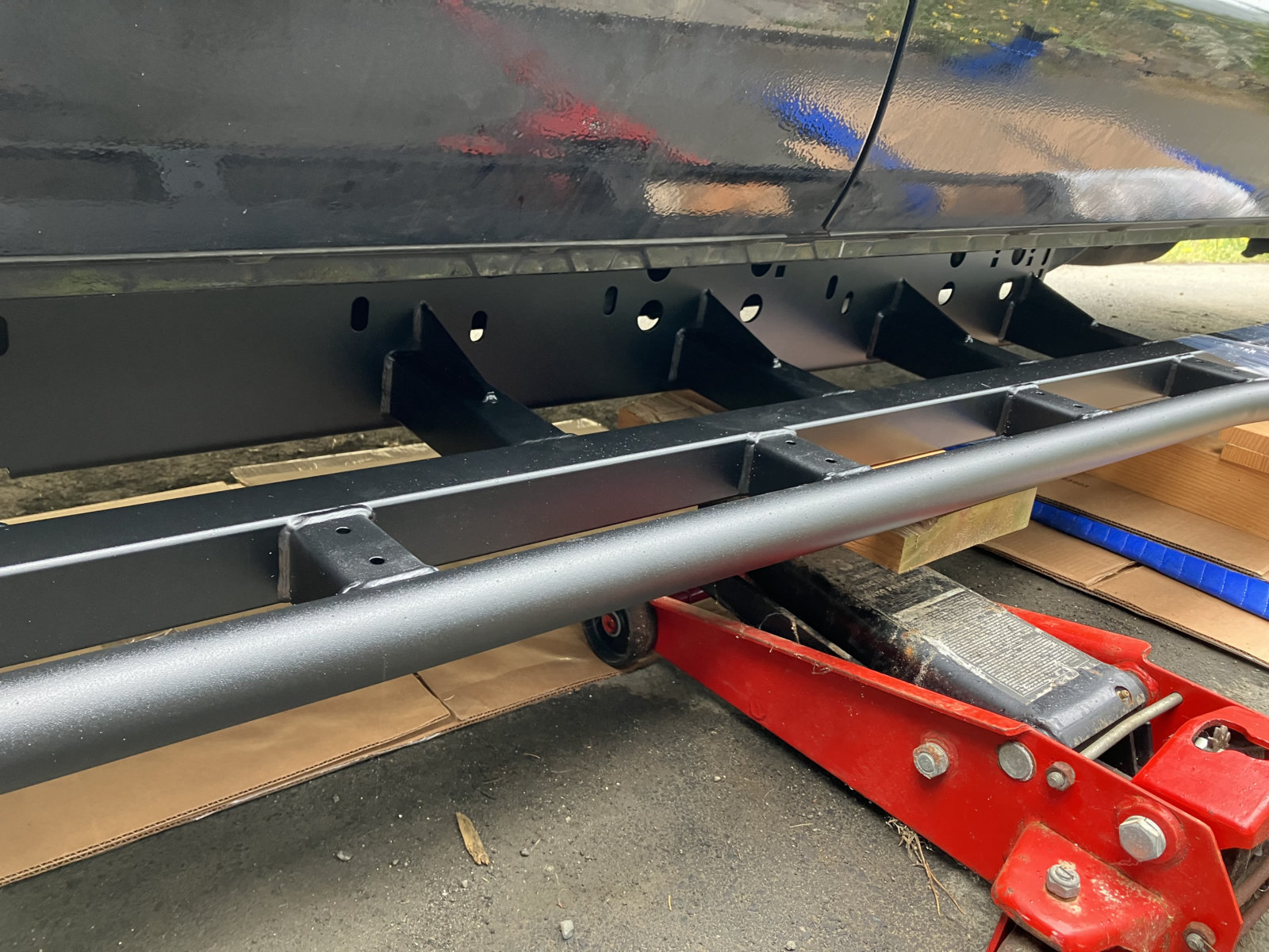

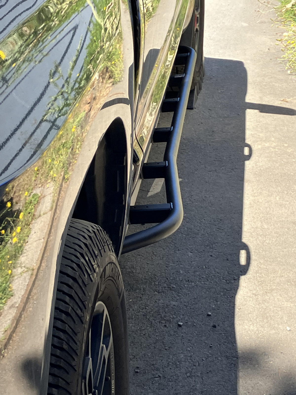

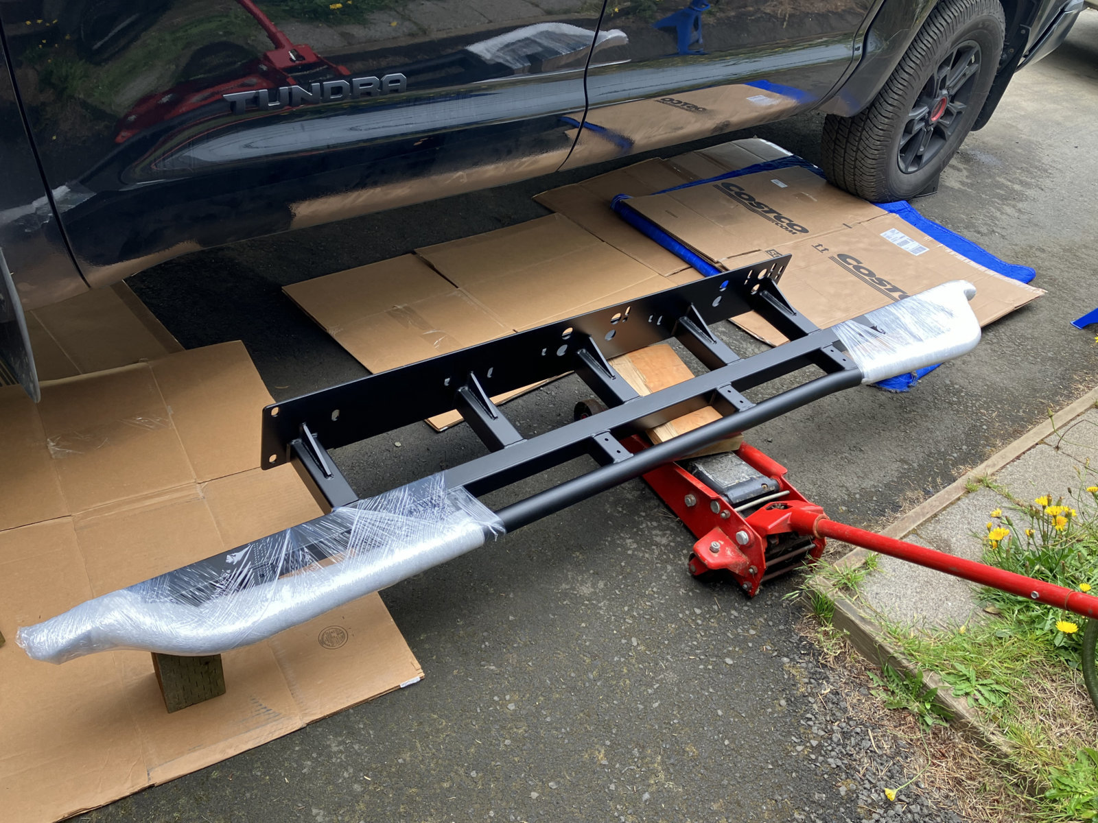

    These 2 give you an idea about the mounting setup, strength, durability of these units...
    Hopefully this will give you an idea about coverage... Also, I have no top plates on mine... But, if you want a better step surface and more paint protection from rocks, etc. you can order them w/top plates. If you are in snow and ice regularly, I'd recommend them as the powder coating is slick in icy conditions :thumbsup:

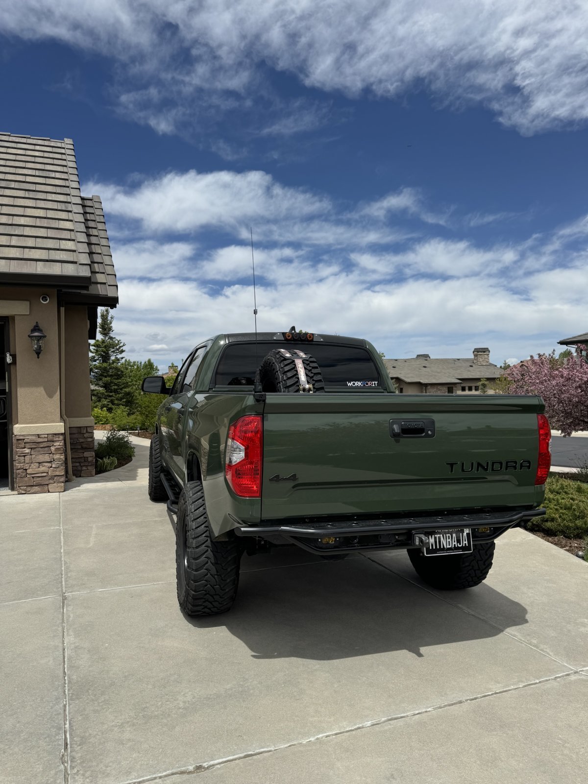

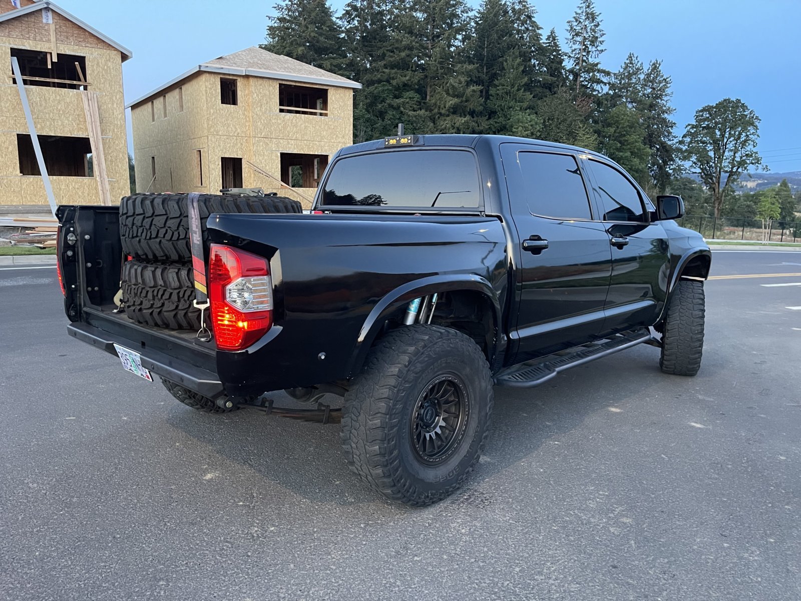

    Westscott designs sliders have worked very well.

    @pvn.beluga the above quoted message is what I'm asking about

    You have a nice setup! :thumbsup:

    Thanks!
