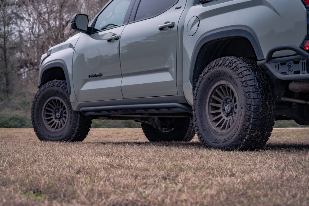

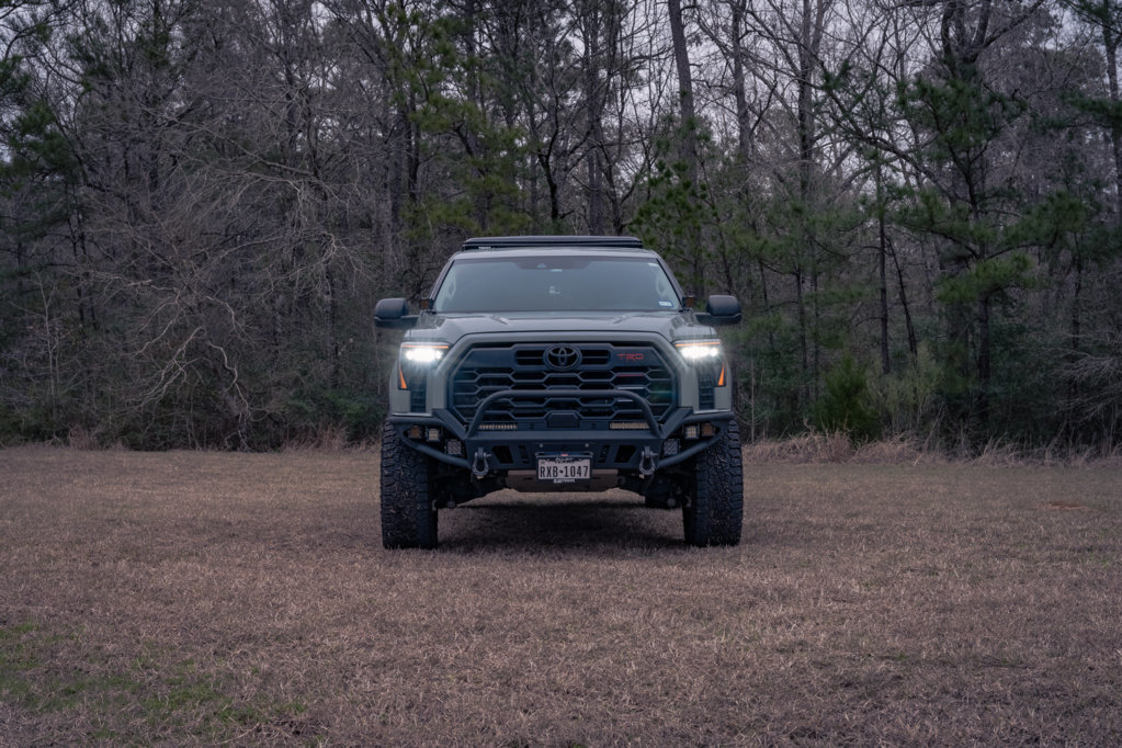

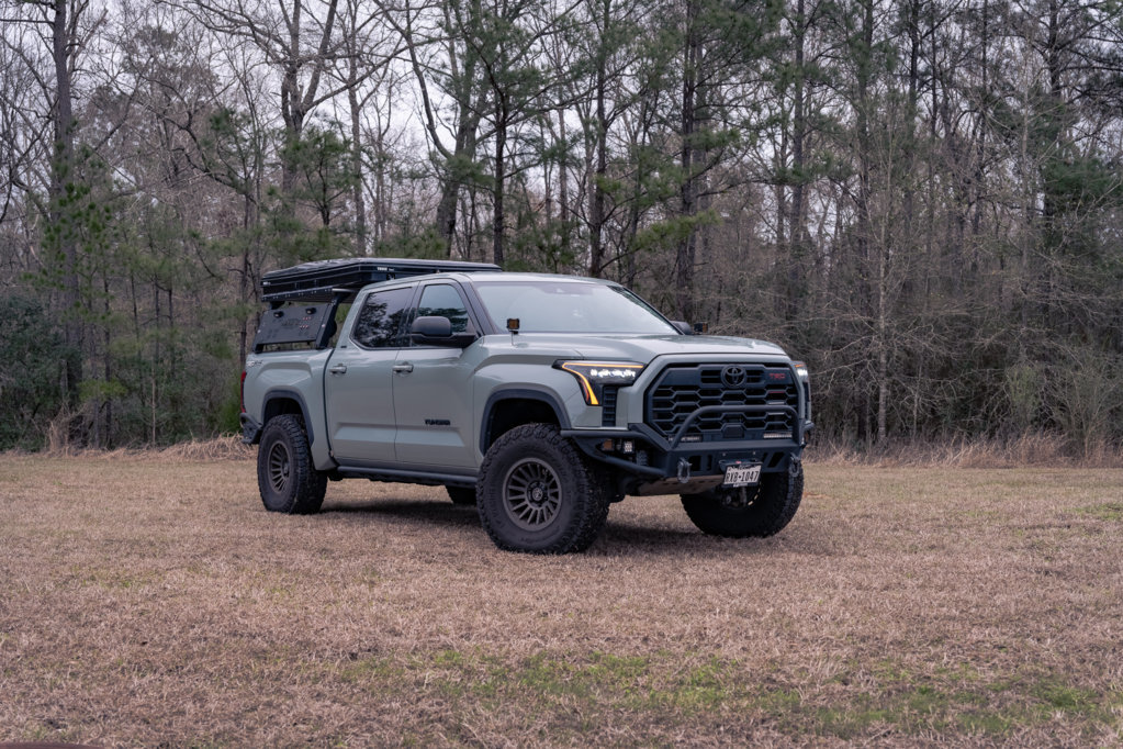

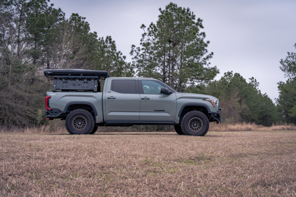

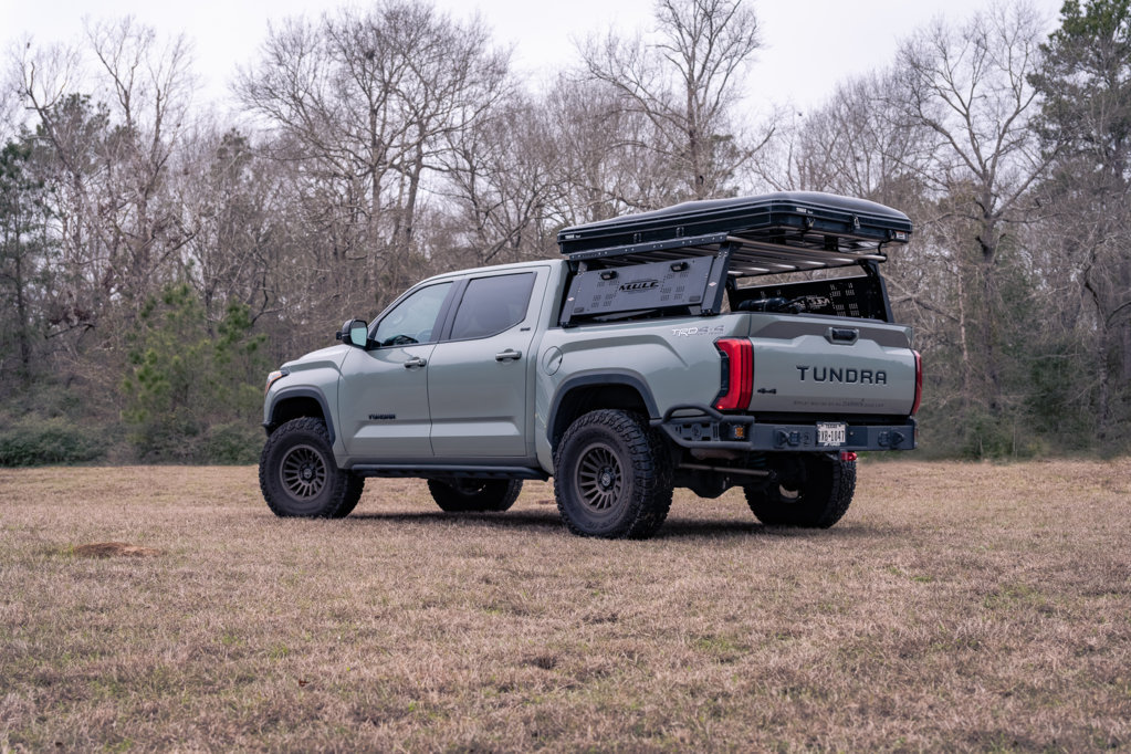

    Here are some updated photos of the the Tundra. I added a new Thule Basin Wedge RTT.

    Sorry for the late reply. I haven't been on here for a minute. To answer your question and if you haven't bought wheels yet, the ideal wheel width and wheel offset would be 8.5" wide and wheel offset of +25 to +35 if you want a flush fit using a 12.5" wide tire. A +40 would also work, but just be aware that a higher wheel offset would also give you a negative or lower scrub radius, which positively affects steering performance but may also negatively affect tire clearance on larger diameter tires (rubbing in inner fenders). If you're running 35s you need about a 2" lift and for 37s at least a 3.5" lift and you may need to do some fender trimming. I hope this helps.
