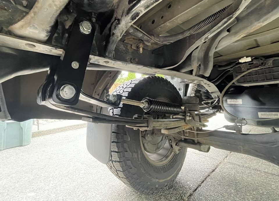

    Does anyone know what aftermarket leaf springs work with the RAS?
    369356023_10107233115565493_303950923637_b4873ce6dcf4c16e609b2868454836fdfe103afd.jpg
    I have 130k miles with plenty of towing on my OEM leaf springs. When I hook my trailer up I have a significant lean to the drivers side in the rear even with the HD RAS at the highest setting. I'm thinking my leaf springs are pretty shot so I need to upgrade but I don't want to lose the benefits that RAS provides.
    Option 1) Find a used pair of OEM leafs on marketplace
    Option 2) Buy aftermarket 5-leaf OEM upgraded pack - https://www.generalspringkc.com/2007-2018-toyota-tundra-heavy-duty-rear-leaf-spring-5-4-1-leaves/
    Option 3) Buy Deavers Medium Duty or Dobinsons Heavy Duty leaf springs
    Option 4) Deaver overload springs

    It'll work with pretty much any of them. You're just not going to have the downtravel that a long, progressive pack like a Deaver would provide. That's case with using a RAS with any leaf pack though.

    Thanks appreciate it! I guess if I went with a new Deaver leaf spring pack I could try with or without the RAS and see how that goes. My Tundra is more for towing and family trips not really off-roading, thats what my Tacoma is for!

    The other option here is that you could get a Deaver pack that is set up for your day-to-day use case to get the ride comfort and add a RAS on and off as needed. If you are towing enough to where it makes sense to leave the RAS all of the time, and you're happy with the ride height of the OEM leafs + RAS then my vote would be to just get a new set of OEM leafs.

    Yeah that's a good thought too. Typically only towing 1-2 times a month from March to September. So the Deavers alone, with my WDH might be sufficient.

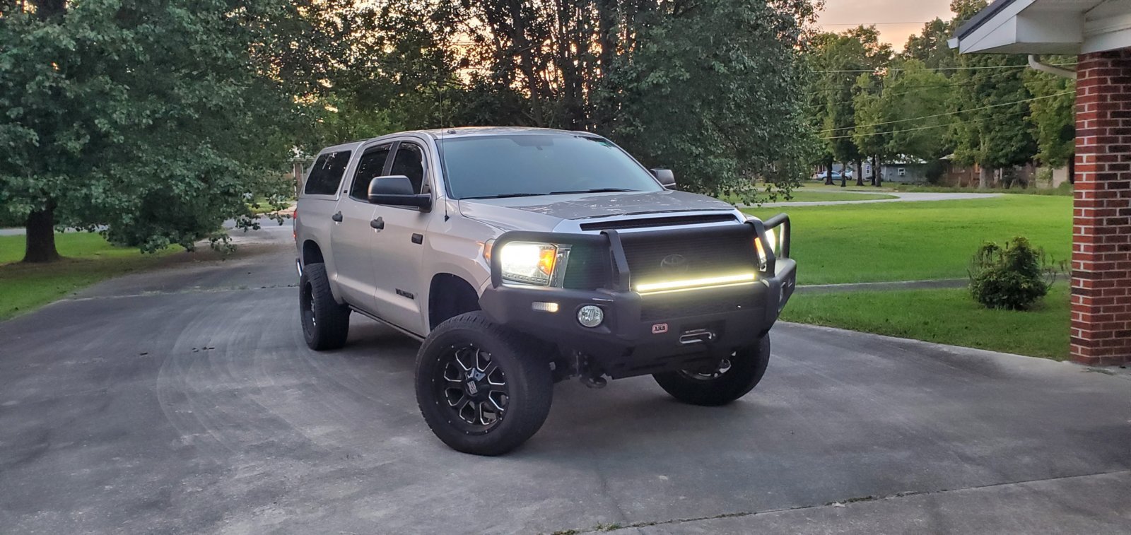

    20240809_193520.jpg So I'm looking at getting a truck camper and I currently have E rated tires. I have the Rough Country Vertex suspension but my leaf springs are either OEM or something lighter. They just don't seem very strong. They are almost flat with just a cap on the bed and various odds and ends in a tote plus a farm jack from HF.
    Couldn't I go with a set of HD leaf springs and be in good shape?
    My Tundra is a 2014 Crewmax 4wheel drive 5.7l. It has an ARB front bumper and winch that totals close to 400 lbs.

    there are tons of options and even more opinions. However, I put the ras hd on and adjusted it using the white puck and it took care of the sag from my topper and tools in the bed. I am amazed with the ride. I have 120k+ and just changed out the shocks and struts but left the springs in the back. The ras will make a big difference and no need to start replacing springs. They are also adjustable so if the white pick isn’t enough set it with the black one. Doesn’t get any easier. And they are easy to install and keep oem springs.

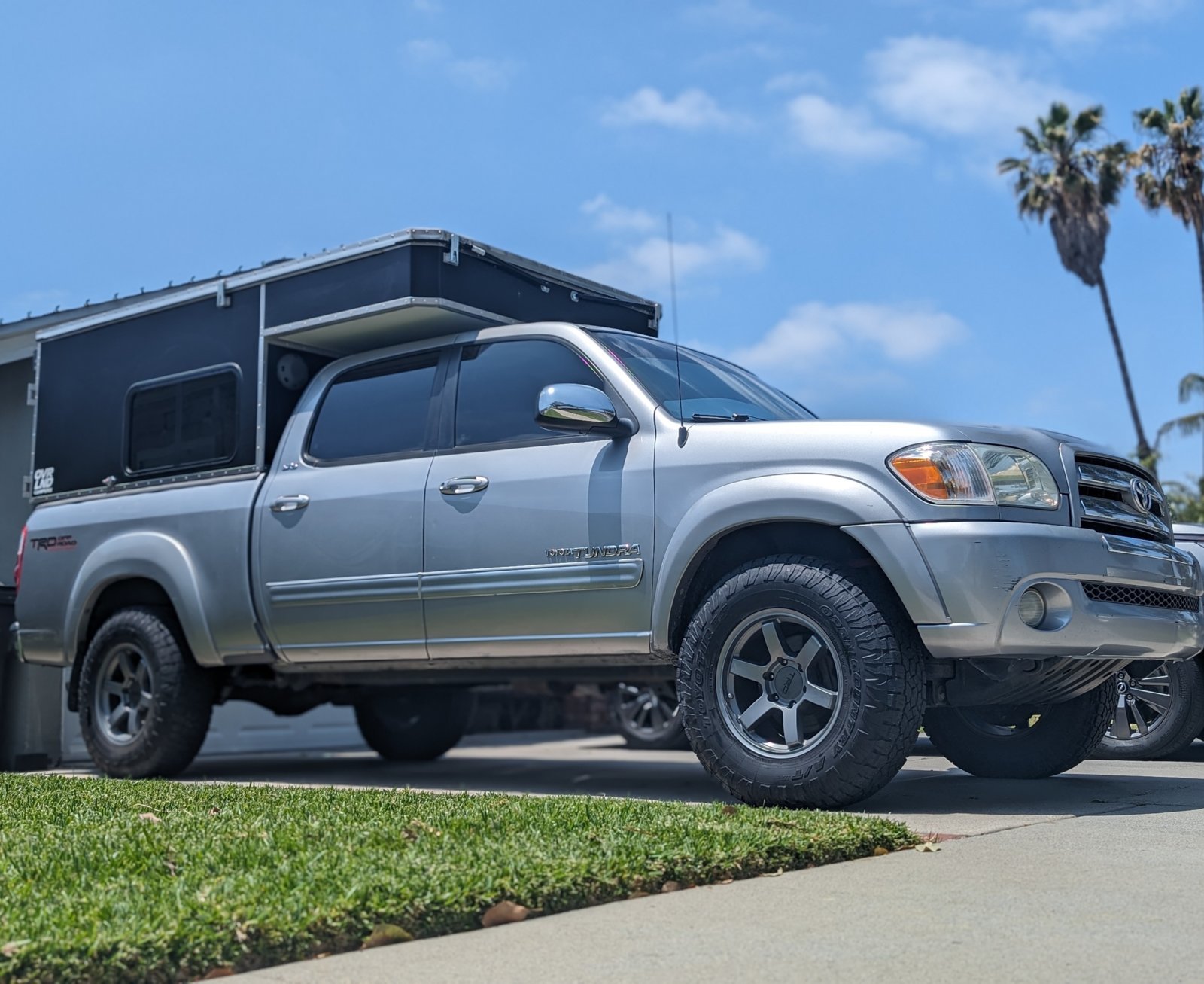

    Absolutely agree I have the same experience. "raised" the truck an inch using the black and it's been fantastic with about 600 constant pounds.
    Front is raised 1.5" with Bilstein 6112s. Rear has 5100s and stock leafs

    You can definitely go w/a leaf pack as another option, but it does seem to be more expensive and intrusive. With that being said, there's plenty of options out there if you'd prefer to go that direction, but reading what some of the others have posted it seems like many of them that went w/a heavier leaf pack ended up w/stiffer rides (especially when unloaded). I have no experience w/them, so for me it seemed much easier to run the RAS HD...
    Plus, if you end up not liking them for some reason, you can sell them pretty quick here on marketplace w/o too much trouble :thumbsup:
    PS>>> I do believe RAS does a military/first responder discount and you can get them shipped to you for just over $500...
