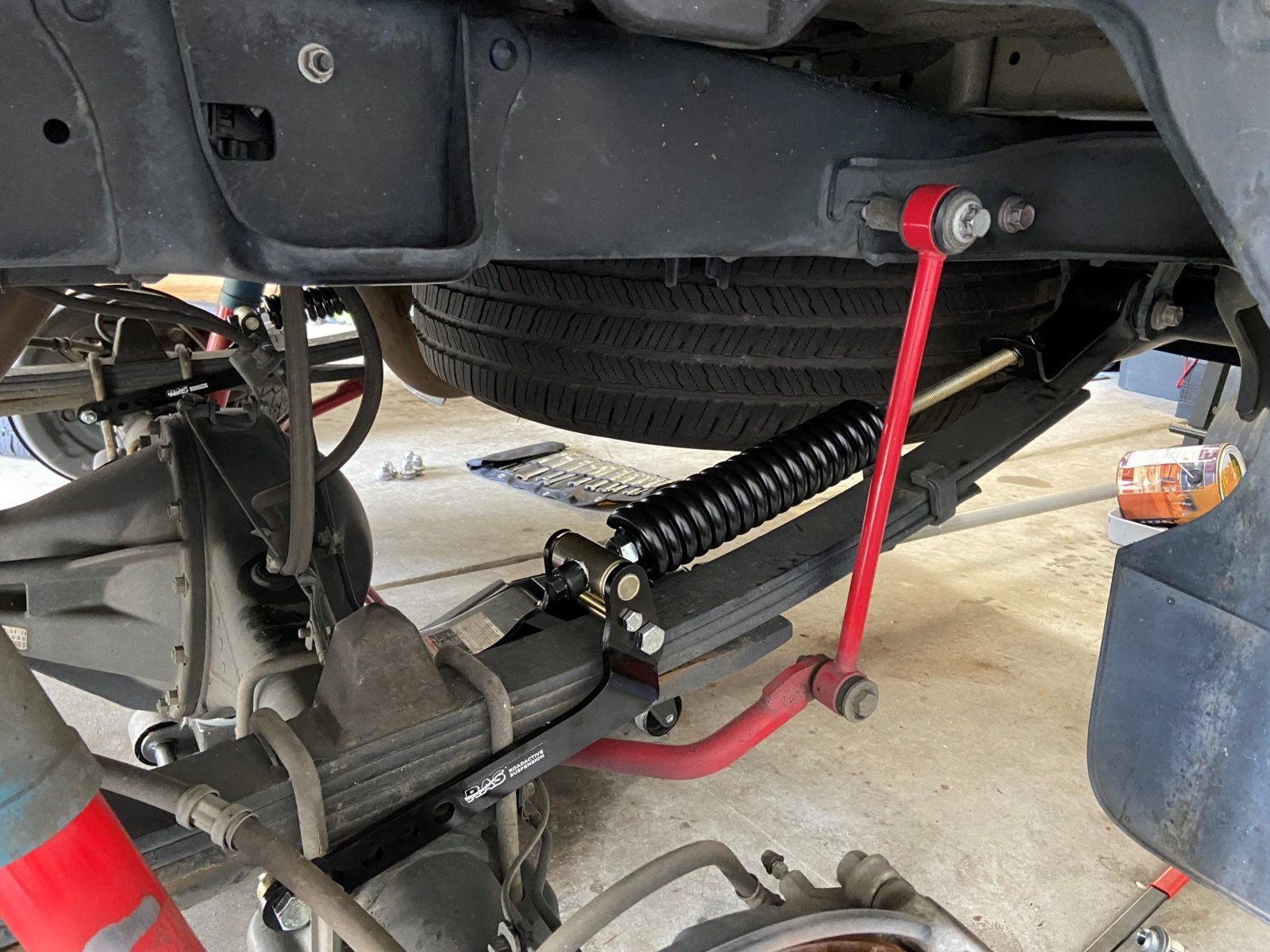

    Mines installed at the end hole, not sure how much difference it makes.

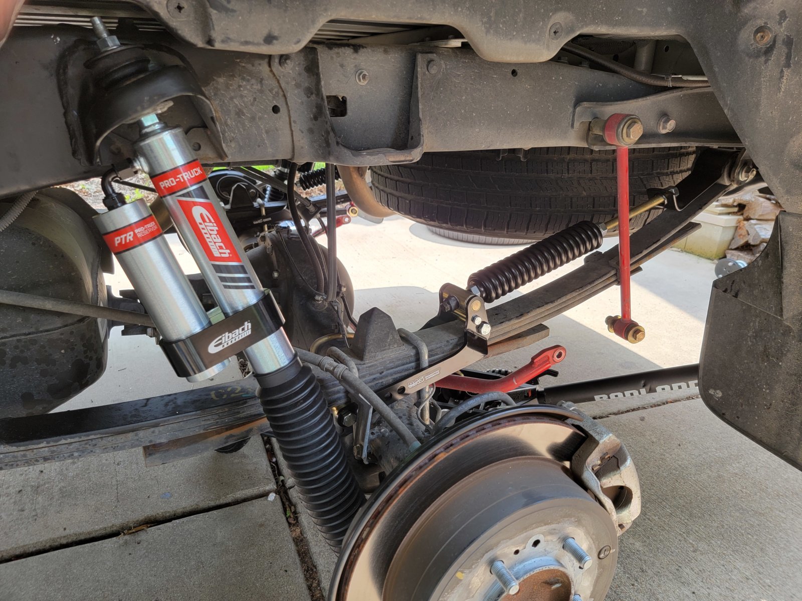

    Installed mine today, as well as my new Eibach rear shocks. Used the last/end hole, as shown in all the installation instruction pics. Just using the white disc, I'm able to see inside the spring enough to see the gold rod. It doesn't look long enough, but maybe to use the third from the end hole. I'll stick with the end hole.20240507_145940.jpg
