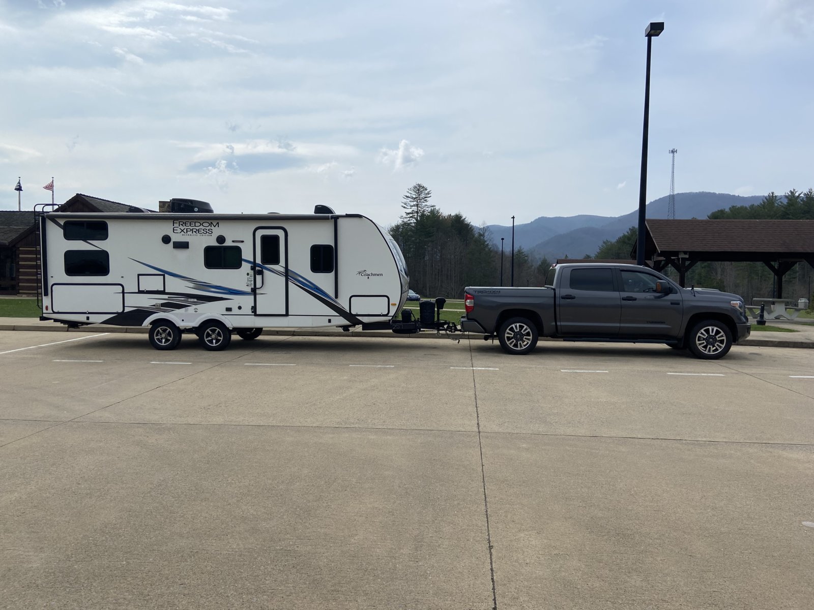

    I added HD RAS and set it on the lowest setting. Perfect setup for me.
