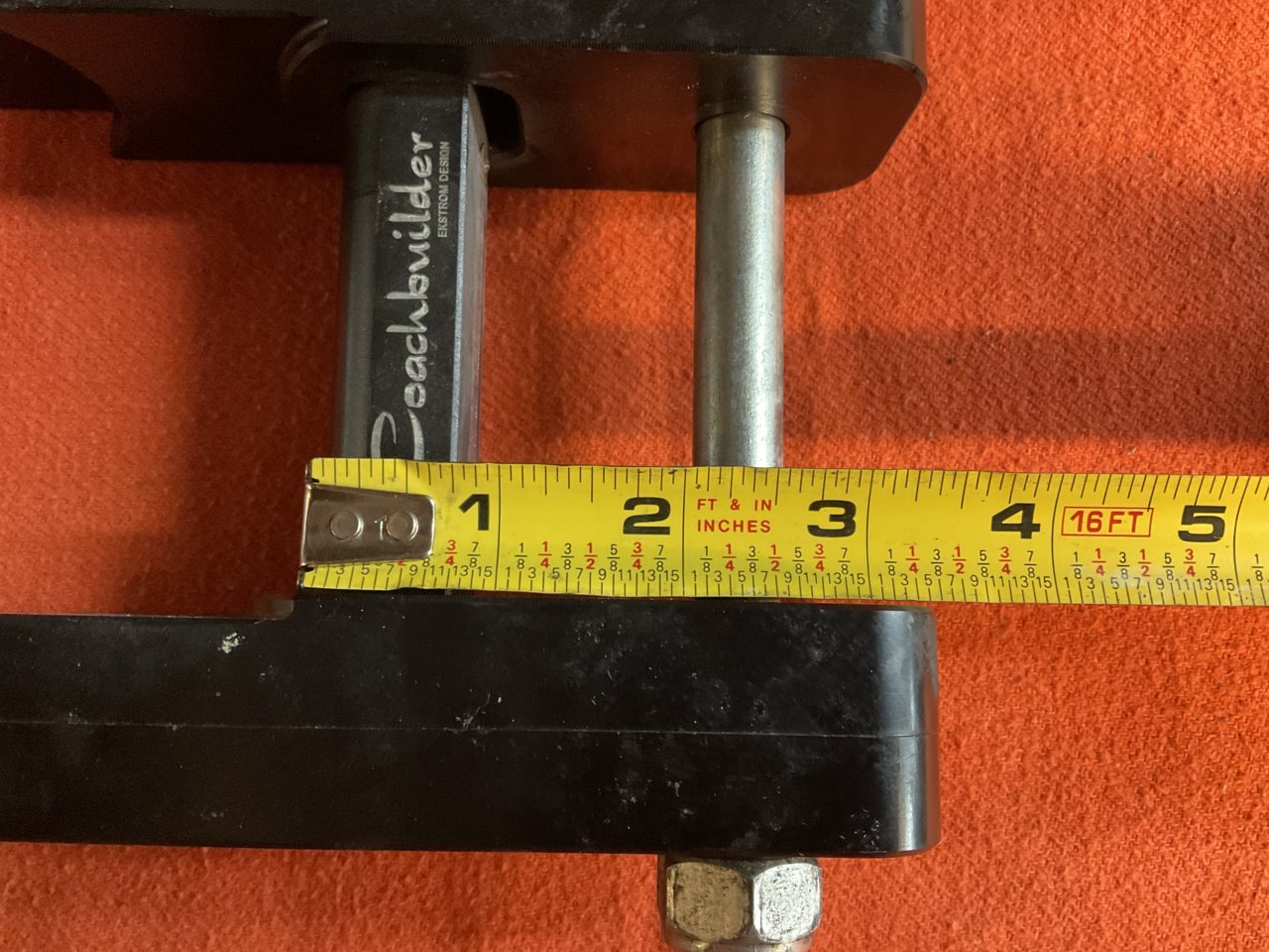

    I,m confused so the +1 rubbed not the +2? Im waiting for the +2. Will take a while before they come in but once installed, I post pics.

    Those braces can be moved. The brace is bolted on. I bet one can drill holes a bit higher and move the brace higher up. I will contact Coachbuilder and inquire about this. The brace is just to prevent side to side movement that the OEM shackles have. Im aware that the brace itself is square and the square part needs to be machined out for a perfect fit. In any case, one would not expect to have to play around with a product one paid 300$ for. How much would you think the brace needs to move up to clear the hanger of the RAS?

    I am talking to David now, he said they should work. Linked him to this thread.

    How thick is the metal of that ras eyelet top? I can't imagine why it would rub.

    I was originally running the +2 fit perfect , changed to the +1 they would not fit ,compared +1 and 2 side by side
    The brace on +1 was lower 1/2”best I remember , milled down installed ran with them about 3k,decided to get rid of
    Truck took off +1 and discovered they had been making contact with the RAS bracket , if any one purchase +2 measure from bottom edge of brace to bottom, picture of of my +1 , install is one way no adjustments, ,I probably could run with them this way but I got what I needed out of BECDCFC9-D85D-40A9-95D9-E37E7C28226B.jpg the RAS

    Thanks, were you using stock leaf springs? What was your total lift with these +1s included?

    Stock leafs DC , RAS set white spacer +1 had 1.25 lift , +2 had 1.75,measurements taken center of wheel cap to edge of bed
    If you get the + 2 CB check measurement against the one I posted

    I have to stick with the +1 or nothing at all. I am only looking for about 1.75" lift at the most since my 5160's are only rated to 1.5" total lift. I really want the RAS so i may have to forgo the shackles completely if the +1 wont fit.

    I talked to David at Coachbuilder and he said he worked with the engineers at RAS to ensure that their products work together, so I am not sure what the issue was in this case, but David seems to think something was not adjusted correctly.

    You have a 2nd Gen, David had to recheck with RAS when 2.5 came out so I am assuming it changed for whatever reason for the 2.5 gen.
