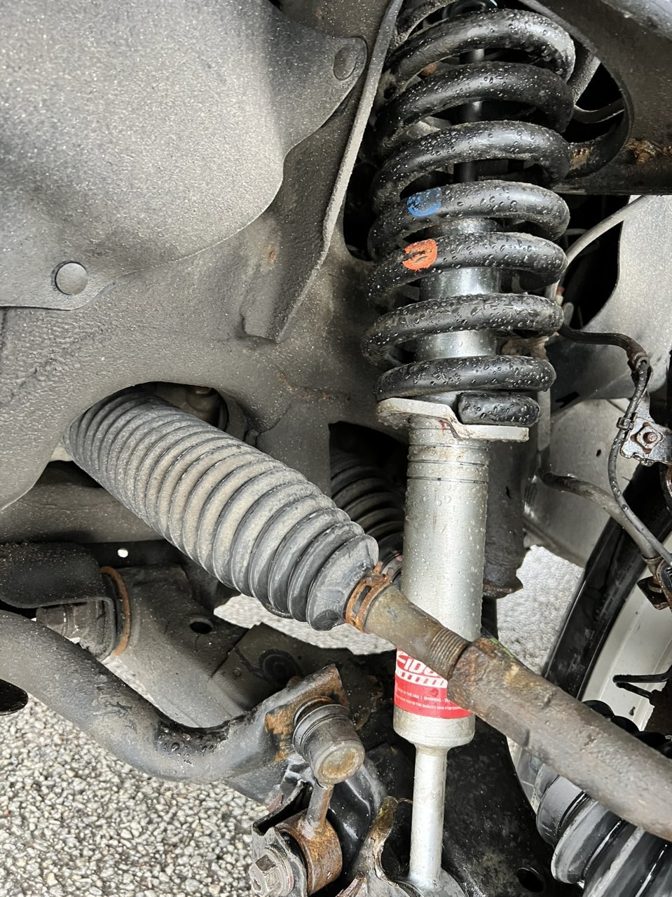

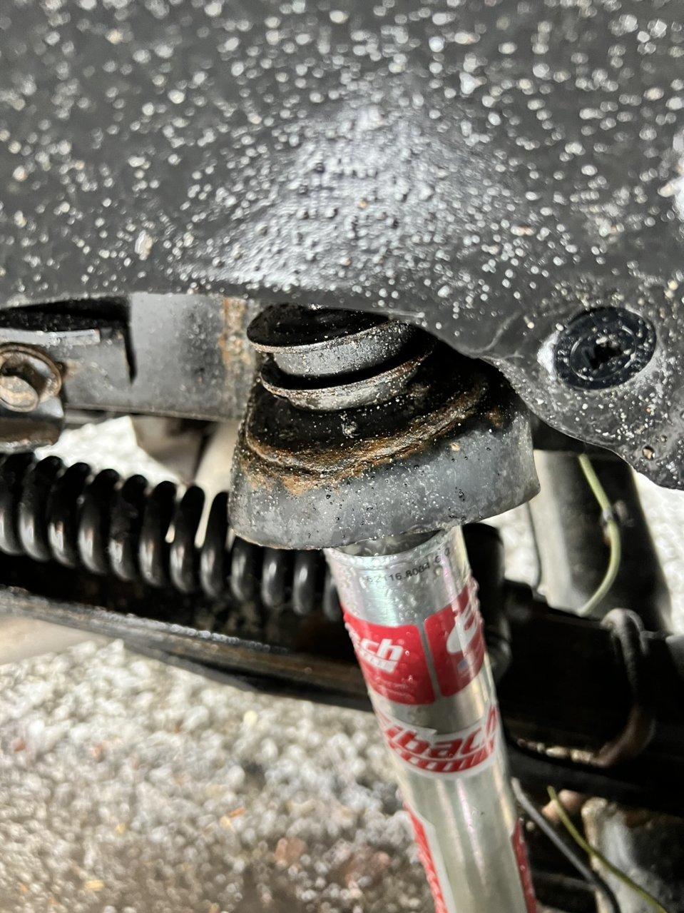

    Am I that tired or is that 2 bushings on top of the shock?

    Its one.

    But you are right. There are cases with two bushings , not mine though. Here the before and same bushing was installed on the eibachs.D129C5F5-1F2B-476D-BDCD-74B340E7AD71.jpg
