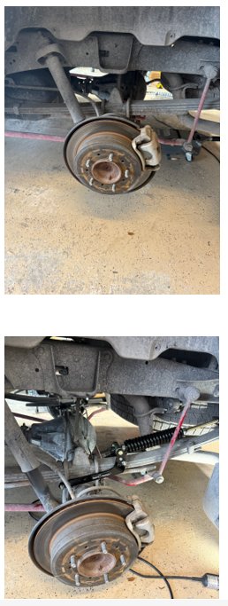

    Installed.
    Took about an hour.
    It's easier to install than the Toyota sway bar.
    I have the HD RAS. I used the thin tab as the setting.
    It raised my bed 1/2 inch.
    Now I have:
    Toyota Sway Bar
    Caltrac Tractions bars (in comparison, a BITCH to install)
    RAS HD
    does it ride better? insignificant difference. Considering all the shit I had before.
    will it help haul the boat? yup.
    Did it change the way the truck rides into the rough ass, lunar type, horribly unkept road into warehouse complex? No.
    note:
    The RAS did affect the Traction bars a wee bit.
    so, I will get under there and adjust them.
    You could surmise this by the way the RAS attaches to the axle.
    Am I pleased. Yes.
    and, No. I do NOT go off-road.
    although, all that crap holding the axle does allow for a bit of articulation.
    If I had to make one observation...
    You can tell the RAS changes the resonant frequency of the rear suspension.
    The Tundra was kind of "floaty" on the hwy....now it's noticeably less "floaty".
    now it's "smoothly lumpy"
    still very comfortable. maybe even more so.
    sidebar:
    and @Tripleconpanna , I could only achieve the last hole....Lord knows I tried.

    Maybe you just needed a little more grip strength to stretch it to the next hole... ;)
    All jokes aside.... sounds like the install was seamless, and I'm excited to hear how it does under load w/the boat connected :thumbsup:
