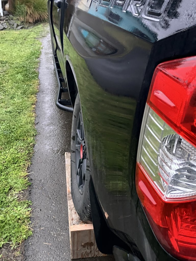

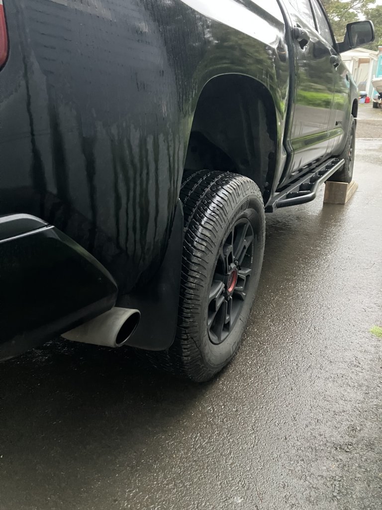

    Sorry, I couldn't find the photos of the rear stuffed while off-road...
    So, I just popped opposite corners on my ramps to illustrate the articulation. You can see the rear wheel start to angle in and up to 'stuff' into the wheel well, and on the opposite side you can see the extension in the travel. Conditions are certainly not at limits for the suspension, but it's still doing its job nicely...

    Thank you. Appreciate it. Seems much better than the TRD sway bar at articulation.

    Yeah, the sway bar really limits articulation... but that's also what creates the stability on the highway when cornering. If I was towing heavy or towing a lot, I'd have both on because the RAS and sway bars would significantly increase stabiity and reduce weight transfer from trailer sway, cornering and braking!!!
    I've still got travel left each way, but the ramps are only so high... But, that's what I was saying, the RAS won't limit your articulation unless you're doing some serious rock crawling and have dumped front and rear sway bars :thumbsup:
    It's one of the reasons you'll see certain off-road vehicles with sway bar 'disconnect' from inside the cabin...
