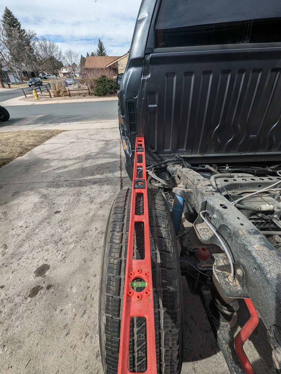

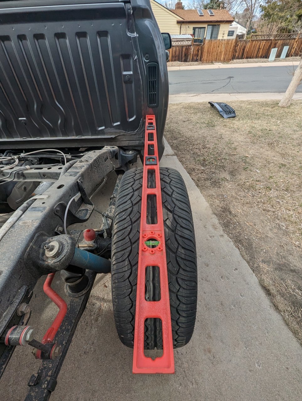

    Thats great of the frame is ok. The axle or axle shaft must be bent getting hit like that? Or spring hangers if it both wheels are facing the same direction?
  5. Apr 3, 2023 at 6:55 PM
    #305
    M3Tundra-JK
    M3Tundra-JK [OP] New Member
    May 3, 2022
    #77930
    2,841
    Scott
    2005 GX470
    Probably bent axle? I was thinking hangers or something, but the right side seems straight

    Something is bent on that rear wheel fo sho.

    Did the centering pin on the leaf spring sheer off and cause any movement?

    Very possible the axle shifted since it was converted from Spring Over to Spring Under Axle.

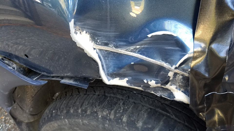

    In comparison, this my old Volvo that I crashed in around Thanksgiving and drove 200+ salty highway miles home. It sat outside in New England slushy winter for 2 full months before I stripped it down and junked the carcass. Just rejects to rust. New ones are crap, start to rust at the dealer parking lot, btw. Pretty much like everyone else these days.

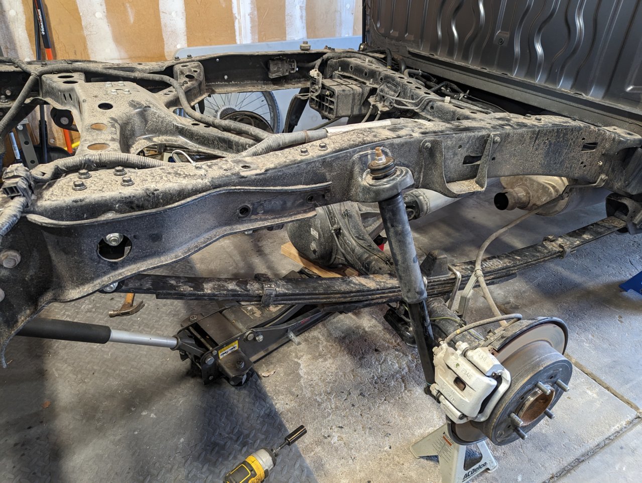

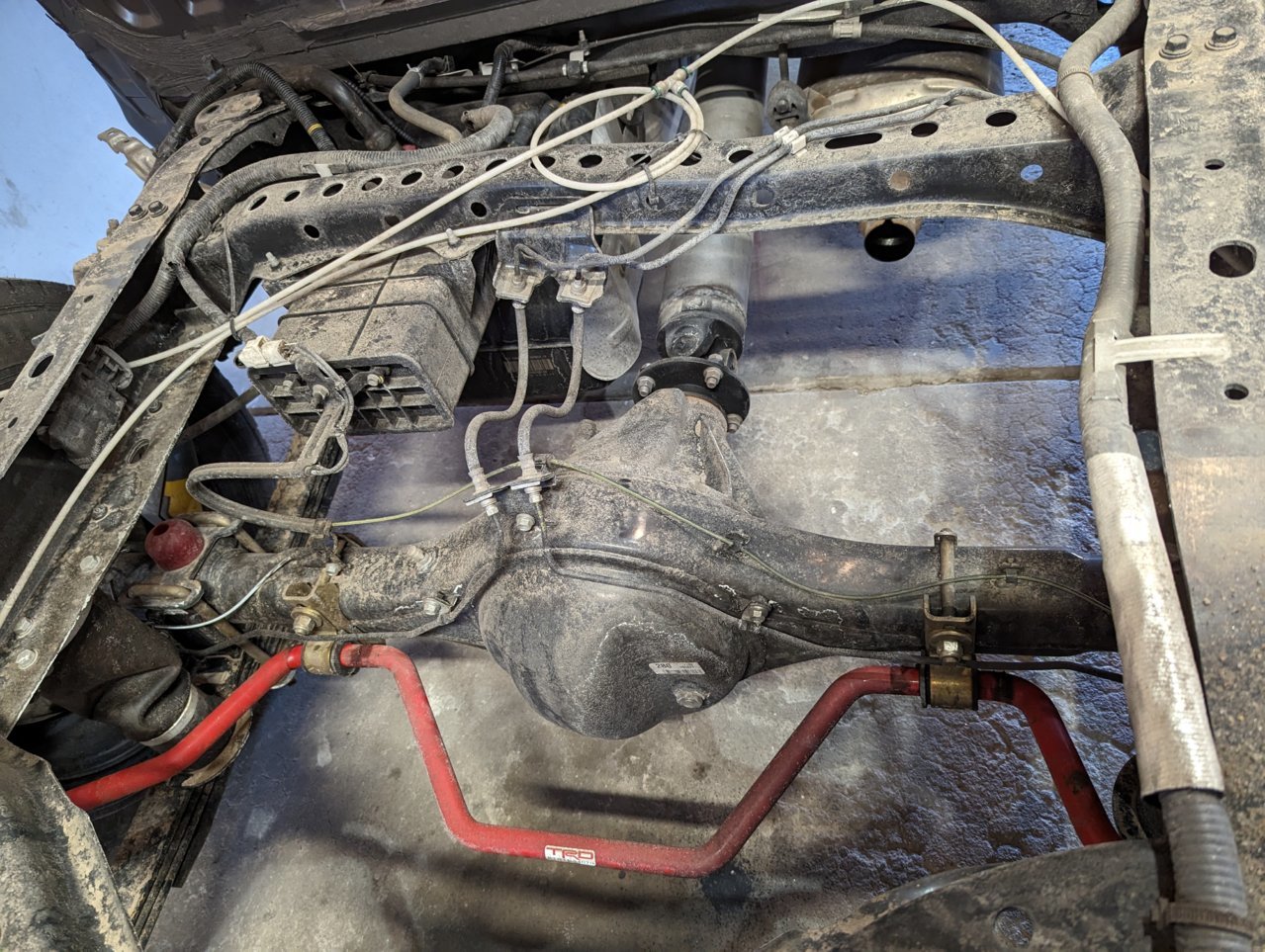

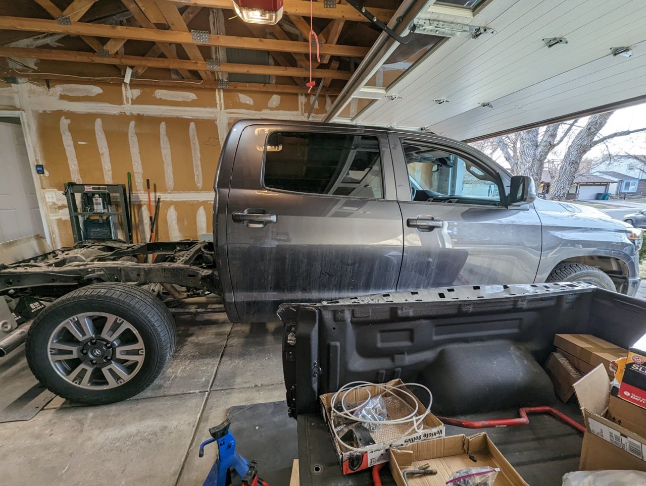

    Gonna start taking off the rear suspension stuff. TRD sway bar, air bags. Maybe return leafs back to the topside of axle

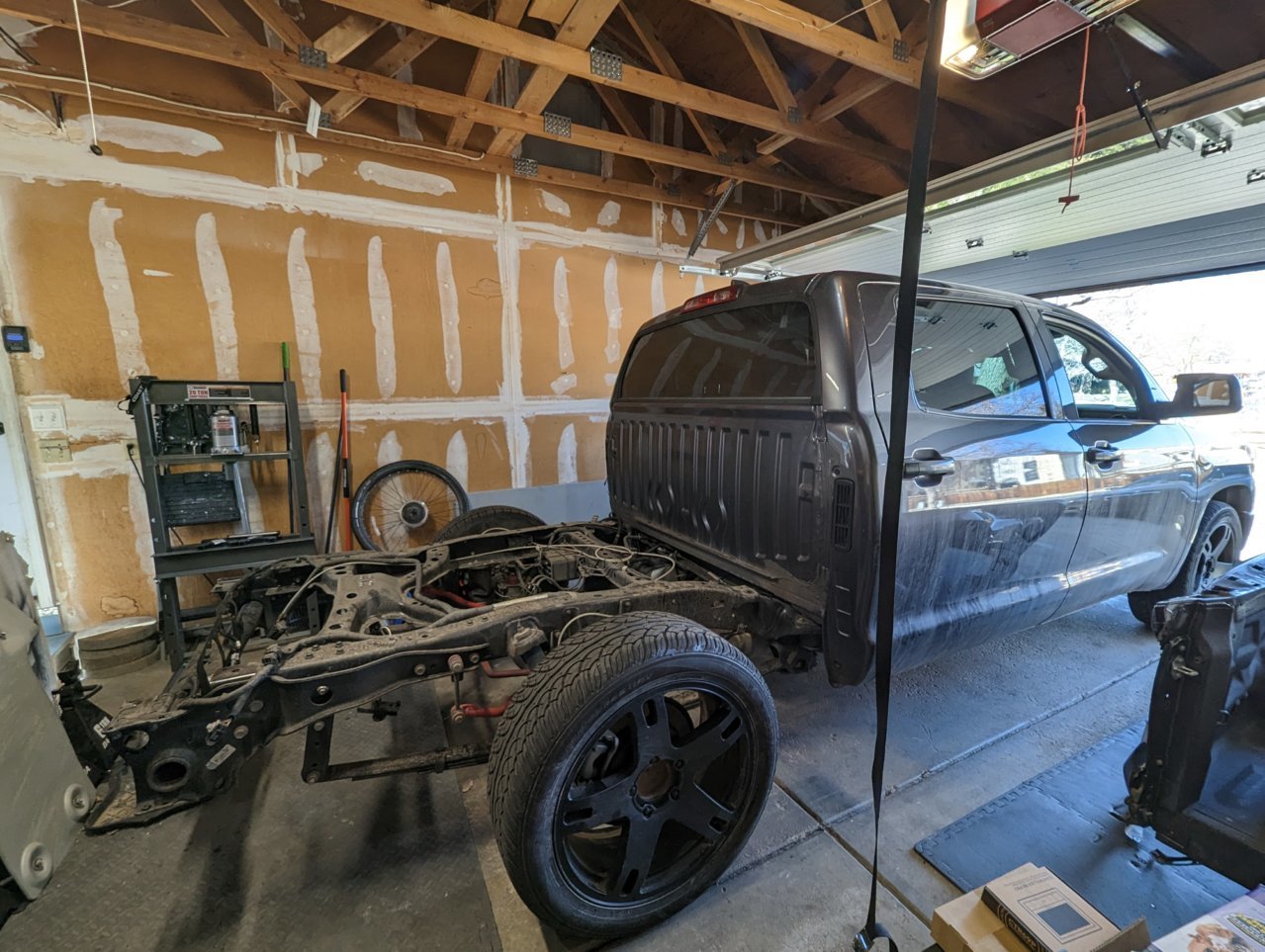

    Rear suspension back to stock

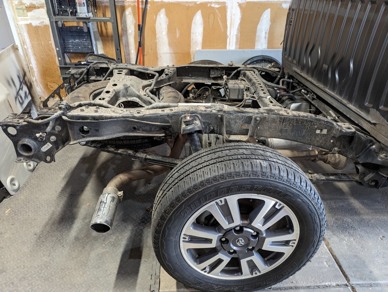

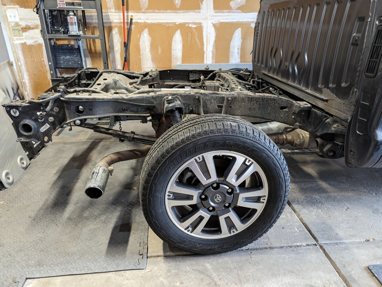

    Ok now the rear is back to stock as much as possible

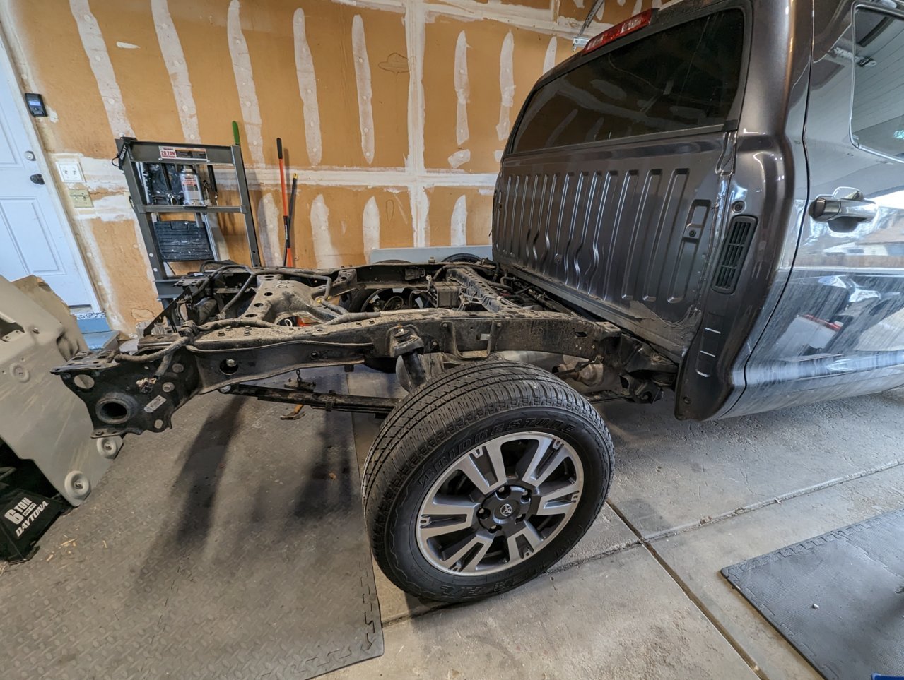

    Reverse squat hot rod stance lol

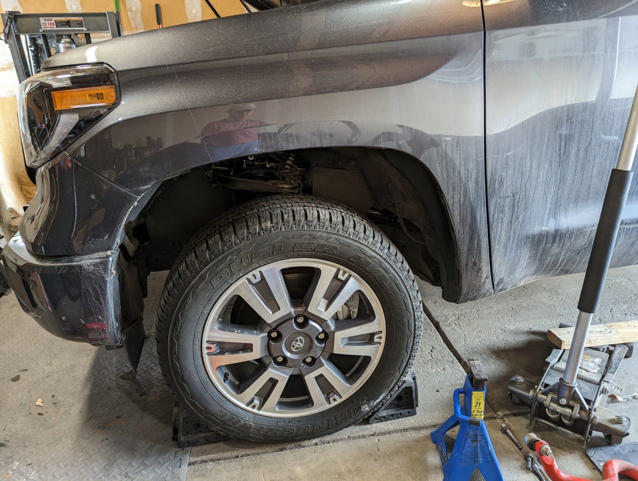

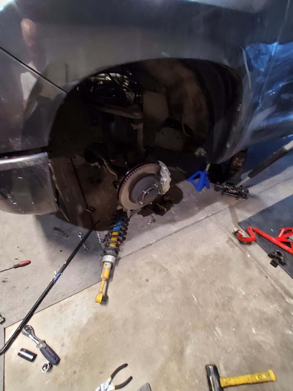

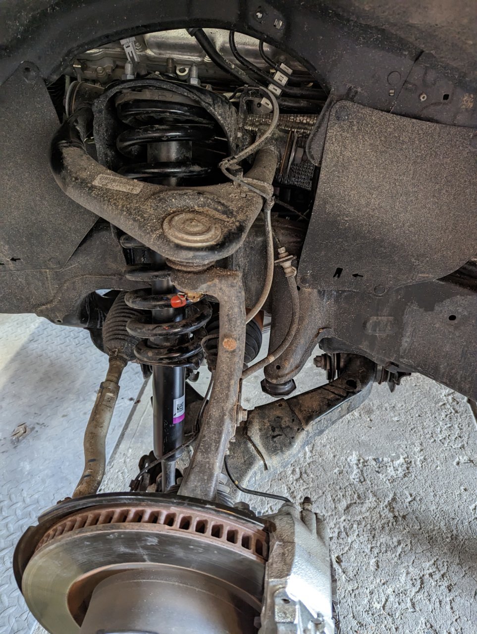

    On to the front

    Back to boring

    Truck is now mechanically back to stock. What a pia it is to remove the transmissions cooler lines!
    Next is to remove the black led headlights and fog lights. Then the paint matched handles. And that should be it.
