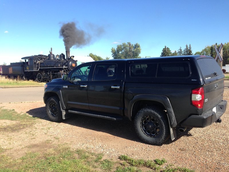

    Looking back at old posts and looks like the mall "crawler might" have been the head on the nail. Lol
    The truck came all tweeked out with 20" fuels that were prettier then I was looking it. But I love it. image.jpg image.jpg

    what flares are those and how much do they extend? i like
