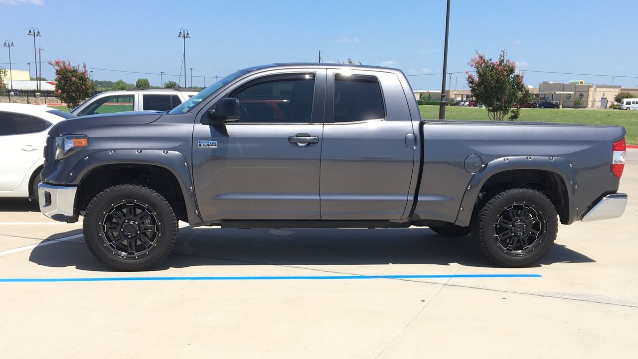

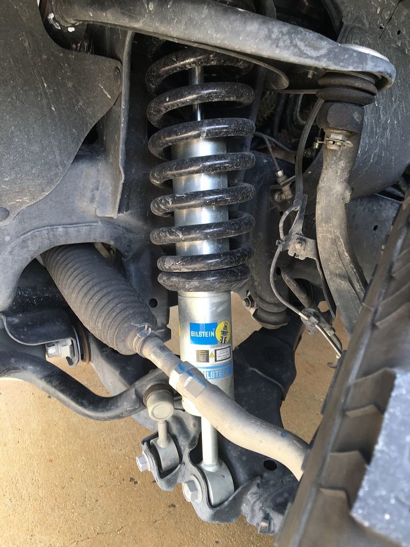

    My 2¢...
    My 2014 SR5 DC stock black shocks were like being on a boat.
    My 2005 SR5 DC rode so much better stock.
    I wanted a lift/level and did a ton of research.
    Ended up with 6112 and 5100 rears, the 5160s couldn't be found at the time.
    A few months later added the 5160s to the rear and sold the 5100 rears.
    Observations;
    The 6112s mounted second notch from the bottom with a CB shim on each side.
    For some reason I felt that would make the ride better.
    Gave me 2.5" of front lift.
    They are stiff as f*ck, even after 3 years and 60K miles.
    I feel every bump in the road, be it a seam, city titty, transition from asphalt to concrete..
    Potholes are jarring.
    But I love the look of the lift/level.
    27C5334C-E17F-4296-8080-38F28356153D_zps_e4bc8eec8808248cd1648a6ac214ac93927bffd4.jpg
    The 5160 rears ride just like the 5100 rears did.
    It was a waste of money to have the cool looking reservoir.
    Even Bilstein says the 5160 is a 5100 with a reservoir.
    But it looks cool.

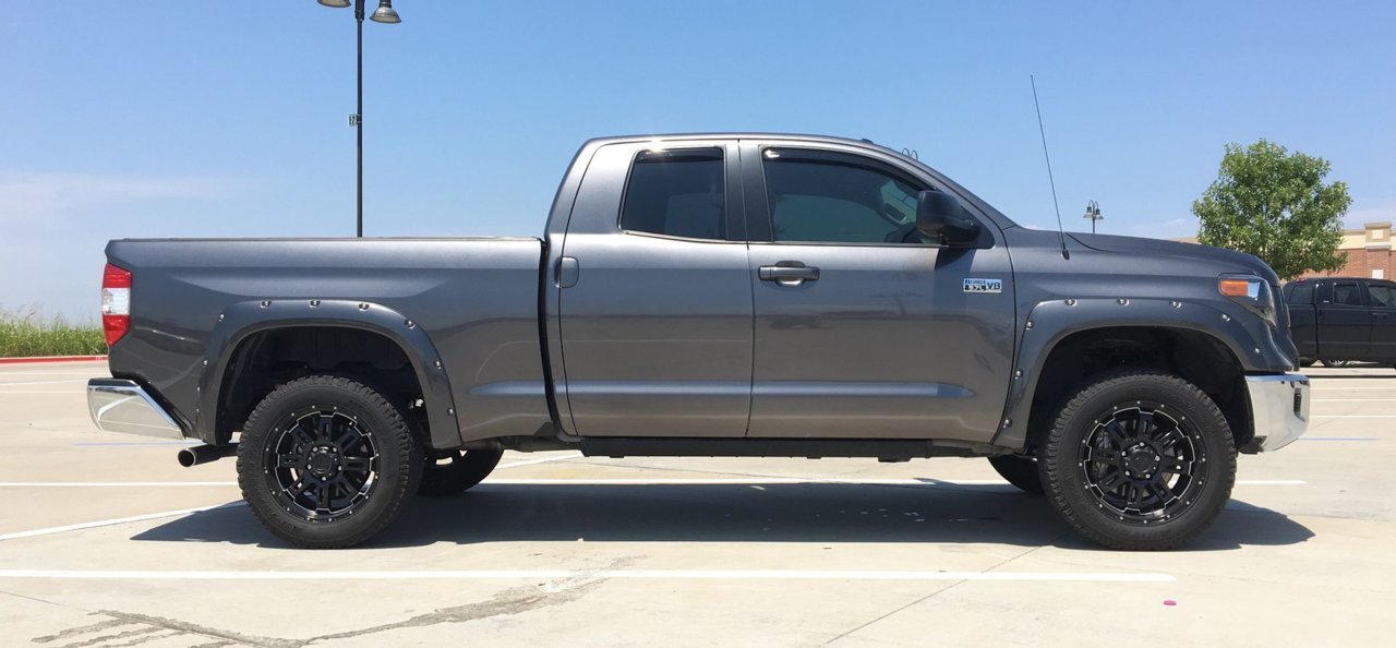

    6B175E39-6926-4D0F-A7CC-7FCFC72DE766_zps_f614225affa99dba3d75113a425fe7b15aab8c3b.jpg
    I used Toytec shackles on the 1" setting for the rear lift.
    They have an option of 1" or 1.5" of rear lift.
    The truck actually sat perfectly level with just the 6112s and stock shackles.
    But it set off nanny warnings on quick turns.
    There is a mod to fix that, putting something under the sensor under the console to make the CPU think the truck has rake, but I just lifted the rear a little to get the rake back.
    Not sure what I would if I had to do it over again.
    Either leave it stock and add a crappy spacer lift, or just leave it stock.
    I cheap spacer would have done it for me, I rarely get off road anyway.
    Too late to go back to stock now with the bigger tires.
    Even though I still have my stock black struts, springs, and rear shocks in the attic.
    Maybe a better riding brand of shocks someday....
    Stock shackles before the rear lift..
    Measured damn near perfectly level, but looks to be a little front high..
    763B91DF-899D-4443-A7EC-B9CE39DA5452_zps_40bc24ad3f26a52479708d1be3d2d728905eb2e0.jpg
    Finished product..
    About of inch of rake..
    942B7FE5-470C-4383-9C30-59887BC9D6D9_zps_606f21455805f4ad53d67b1b8905b09d6269bebc.jpg
