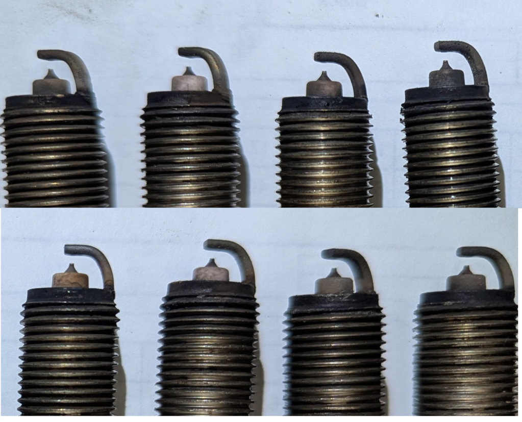

    Pulled the plugs today, cleaned and gapped.

    Wild. I wonder if it's not sparking during cranking sometimes. Wonder if you could test for spark or power at the coils during the initial start. I know some older toyotas have the injector and coil power run through the ignition. Not sure if our tundra are that way. I had an issue this winter where my ecu would only come on during cranking. It would fire instantly but then shut off as soon as I let go of the key. Wiggled the ignition wires and suddenly ecu turned on. Been working fine since then.

    It's becoming an issue at this age where the coolant can eat the head gasket at the small coolant port between the cylinders. Usually won't show combustion in coolant or coolant in the oil. Will smoke a bit at start up and misfire a bit or hard start a bit at first. May go away as it warms up. My friends truck had this issue. He finally realized the problem after chasing misfire codes when his truck had no heat one day due to coolant loss.

    Interesting, thanks. Did he ever see spark plugs that looked steam cleaned and did he end up pulling the heads?
