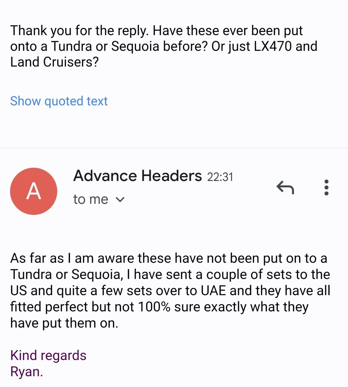

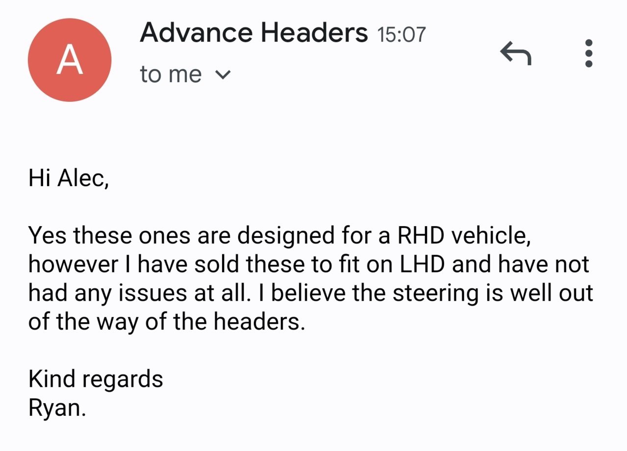

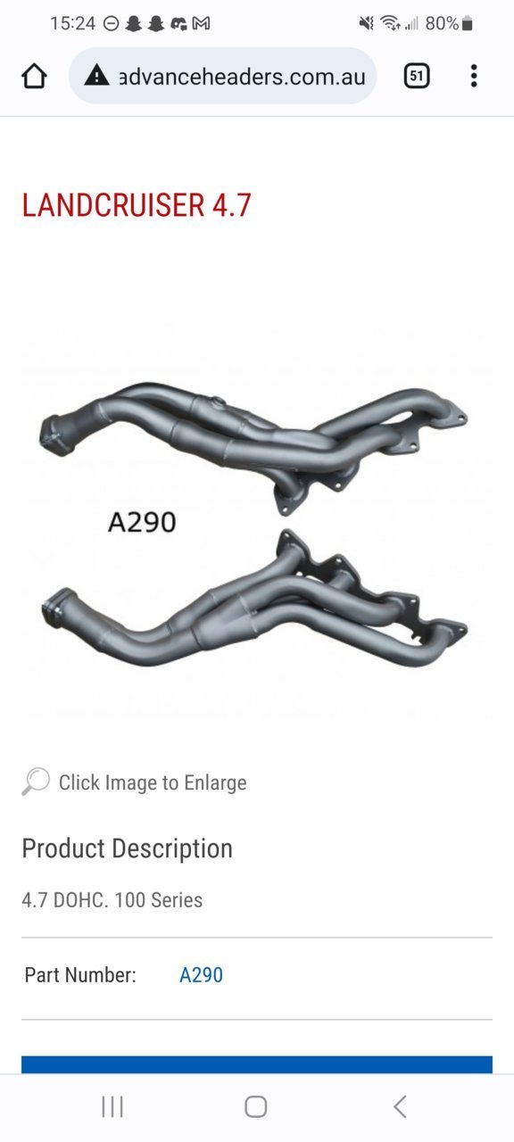

    An update: these guys finally got back to me, it looks like they have fit them onto some LHD vehicles but who knows if they were Sequoia/Tundra. My guess is UAE, probably Land Cruiser, US who knows. I will inquire further if I can.

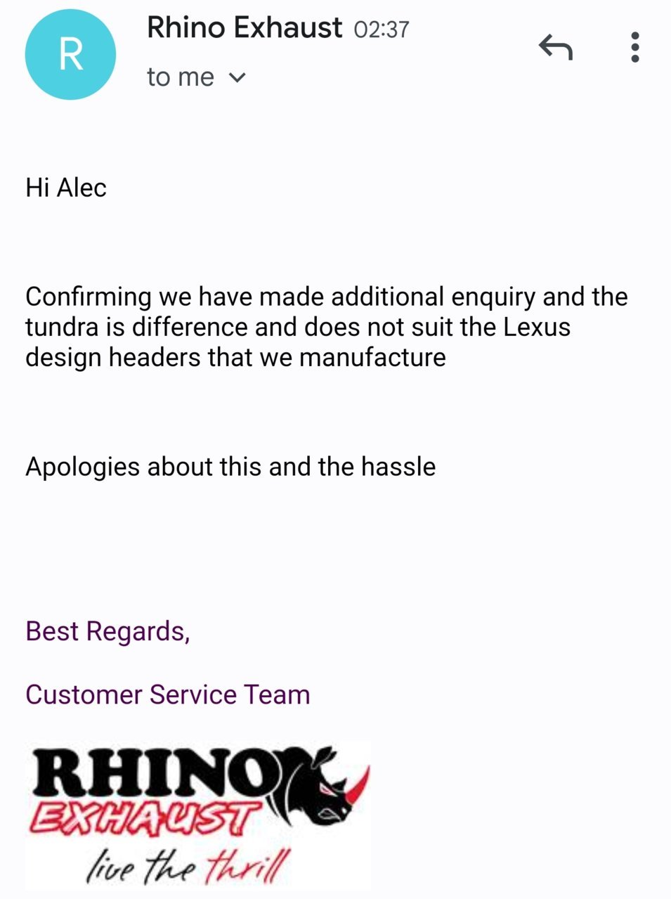

    Well, looks like Rhino is off the table. After months of waiting lol.

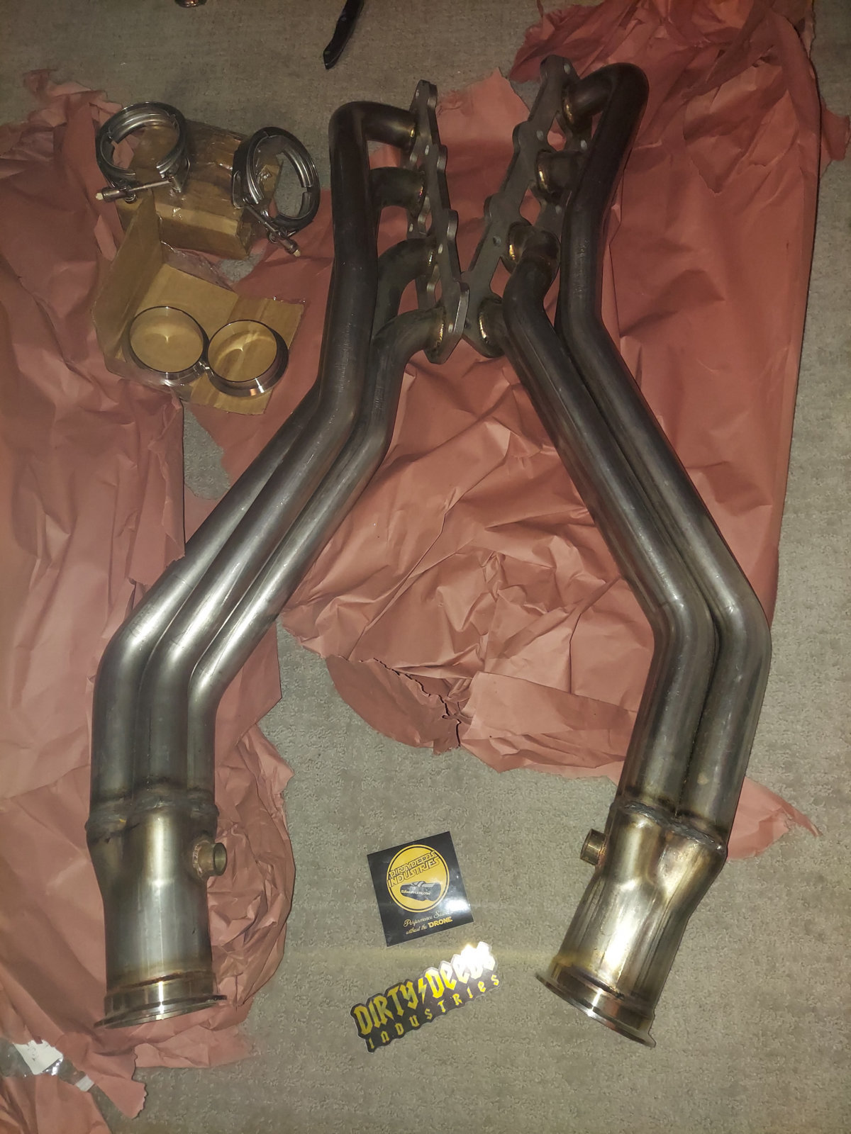

    Our first batch of 5 is almost done.
    the second batch of 5 has 3 sets sold already.
