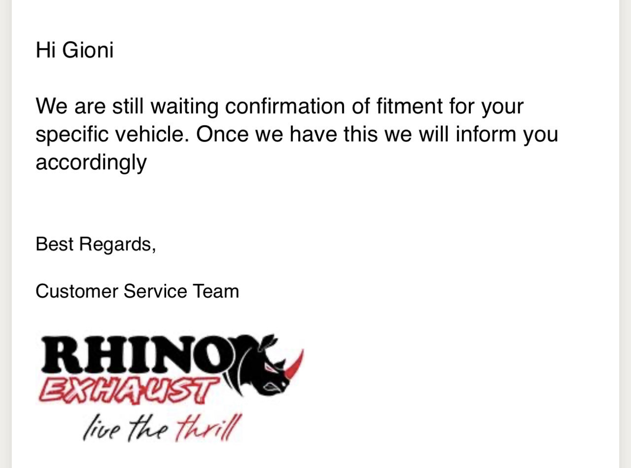

    I got an email on the 4th asking for information about my truck, in order to verify fitment and then they send me an update on the 6th. I followed up with them this morning, still waiting to hear back.

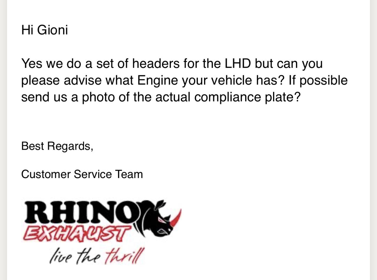

    Hey guys,
    On the 6th I reached out to Rhino Exhaust for an update on their headers fitting my 2001 Tundra and I never received a reply. Personally I lost confidence in them and will be moving on.
