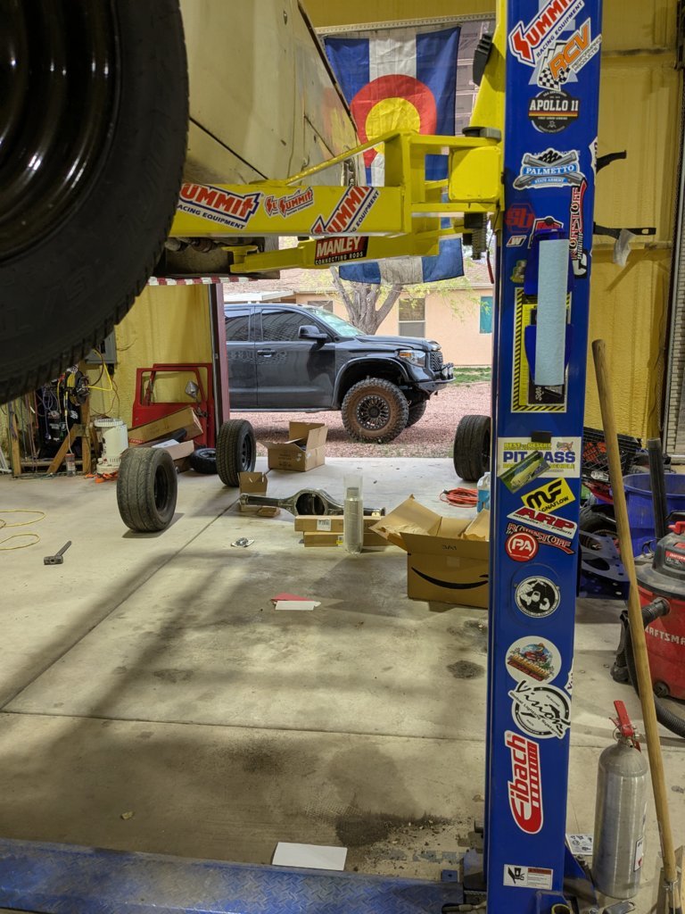

    Here's an update for this thread

    Definitely need to update this thread quick version below. I’m probably forgetting a few things we’re doing but I’ll add that later.
    Updates during this round happening
    LSK race kit (custom shock tower)
    New shock package front and rear
    2.5 CO dual springs, 3.5 triple bypass remote resi fronts
    2.0 king bumps
    4.0x18 rear triple bypass
    2.5 king bumps new mounts
    Newish 3URFE (less than a 1000miles ordered from TRD)
    Remove bad engine for full forged internal rebuild (5.7-6.0 liter)
    Ported heads and cams
    Full frame plating front to back with trussing
    Relocate fuse boxes etc
    Shock tower tie-in
    Hidden hitch on rear bumper
    Clearance and tube front fender area
    Carbon fenders/ Carbon Hood
    New transmission (Already installed)
    Upgraded valve body to install
    Upgraded 240 amp alternator
    Big 7 wire upgrade
    Camburg turning brake with wilwood calipers
    Steering rack bushings
    Body mount bushings
    Custom intake box
    Two piece driveshaft with billet carrier bearing
    Solid offroad trans mount (when available)
    DBM trans/supercharger heat exchanger combo
    Driveshaft safety loop
    Vented front skid plate
    V-band exhaust/ new catback or muffler (oil soaked from hurt motor)
