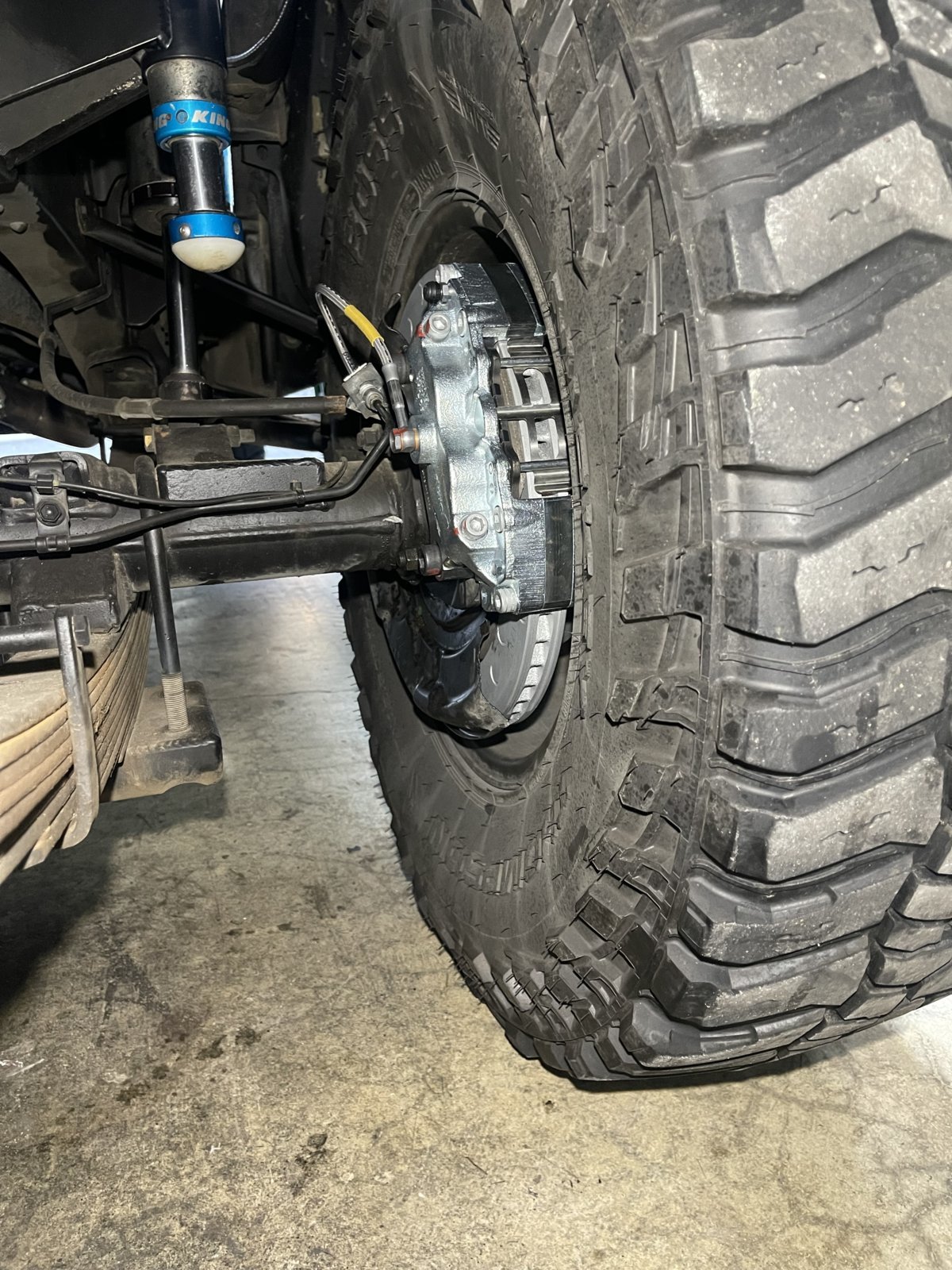

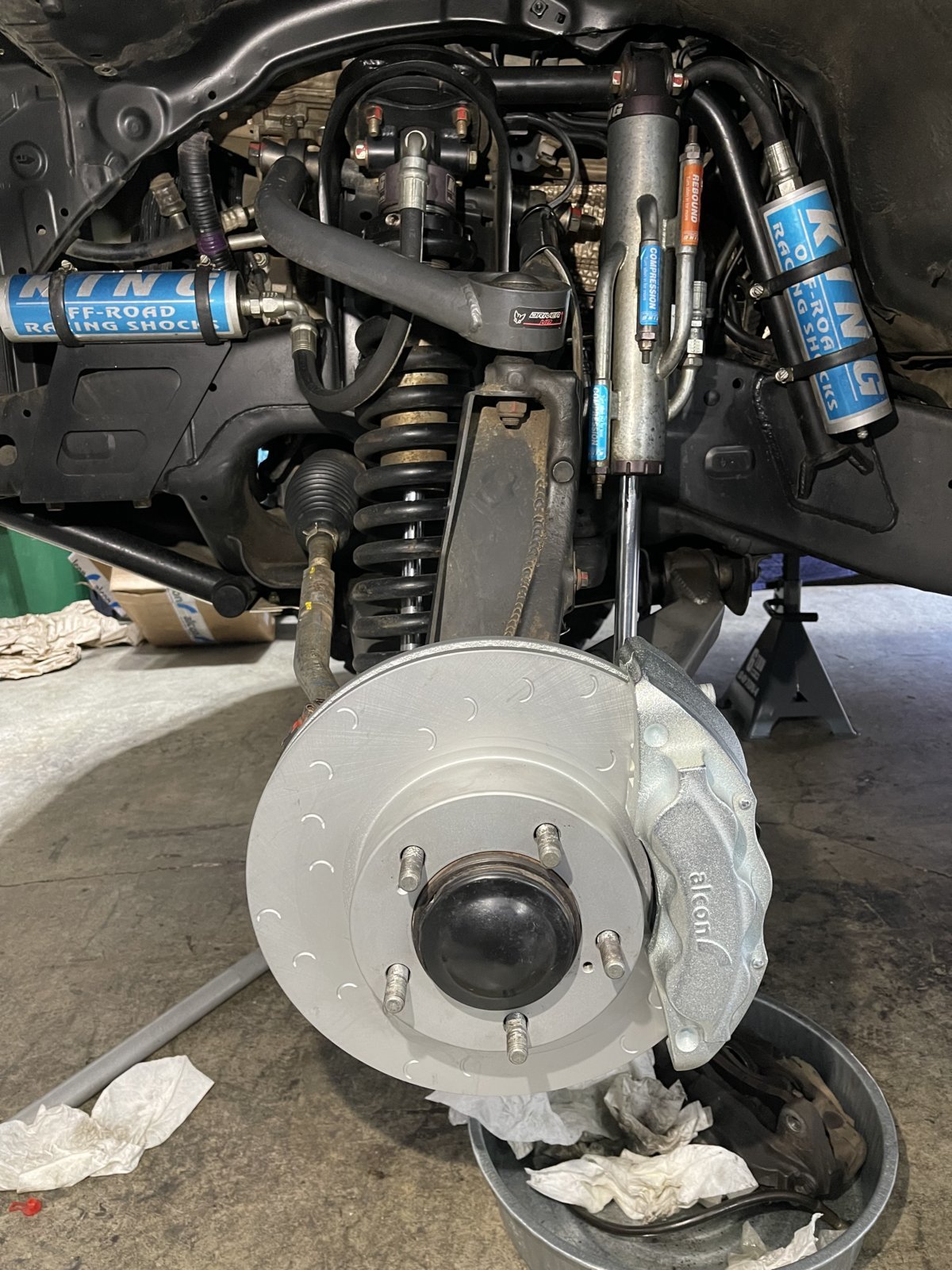

    Build update 3/20/24
    Front and rear Alcon kit installed. Massive difference than just running the fronts alone. Throwing a maf code since we're at the limit of the 4.5" intake tube. Custom 5" tube getting made up as well as installing the LS 103 throttle body I snagged from Viktor G. Should be interesting to see the boost gains since I lost 1-1.5psi from the efficient exhaust. We'll need to do a ton of tuning to get the TB dialed but excited.
    Awaiting install- updated camburg lt shackles, new leaf bushings and ubolts, extended wheel studs again since addition of new wheel bearings.
    Next on the to do list- Prp harnesses, maybe some prp seats, custom harness bar, more forward lightning
    Awaiting pricing and timeline for- custom J arm kit, and Full back-half. (probably start stock piling parts for this)

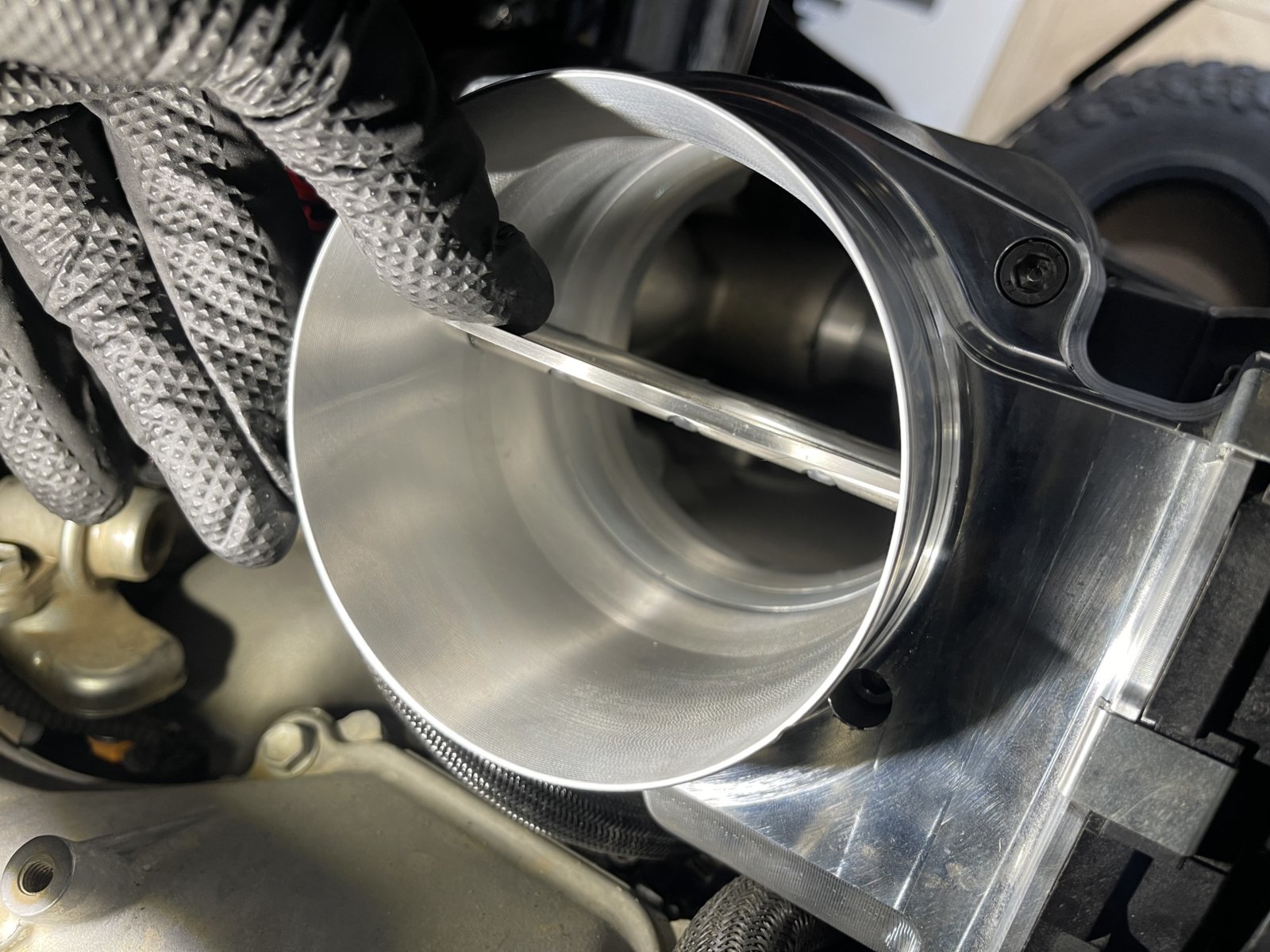

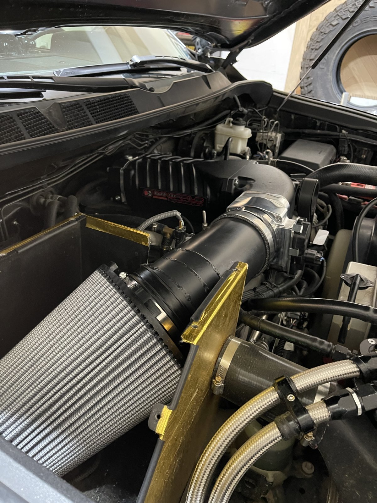

    Build update 5/10/24
    103MM LS throttle body is in with the custom @snivilous throttle body adapter and 5” intake tube. Also added the new @TurboKits.com boost referenced full pressure regulator. Updated the grill cover (50+hp). Next is retune and dial it in.
    Need to get the harness bar ordered to install these prp belts.

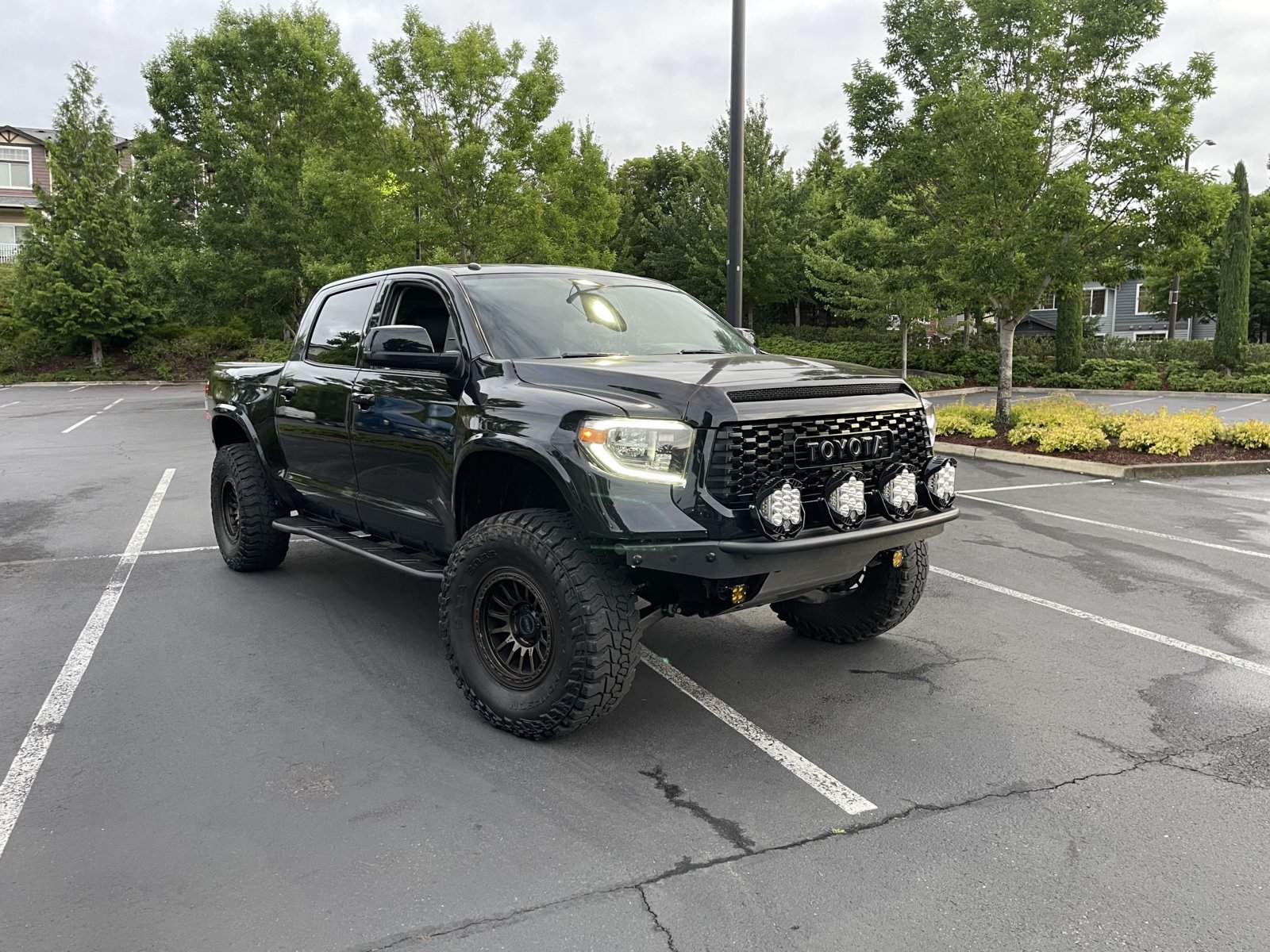

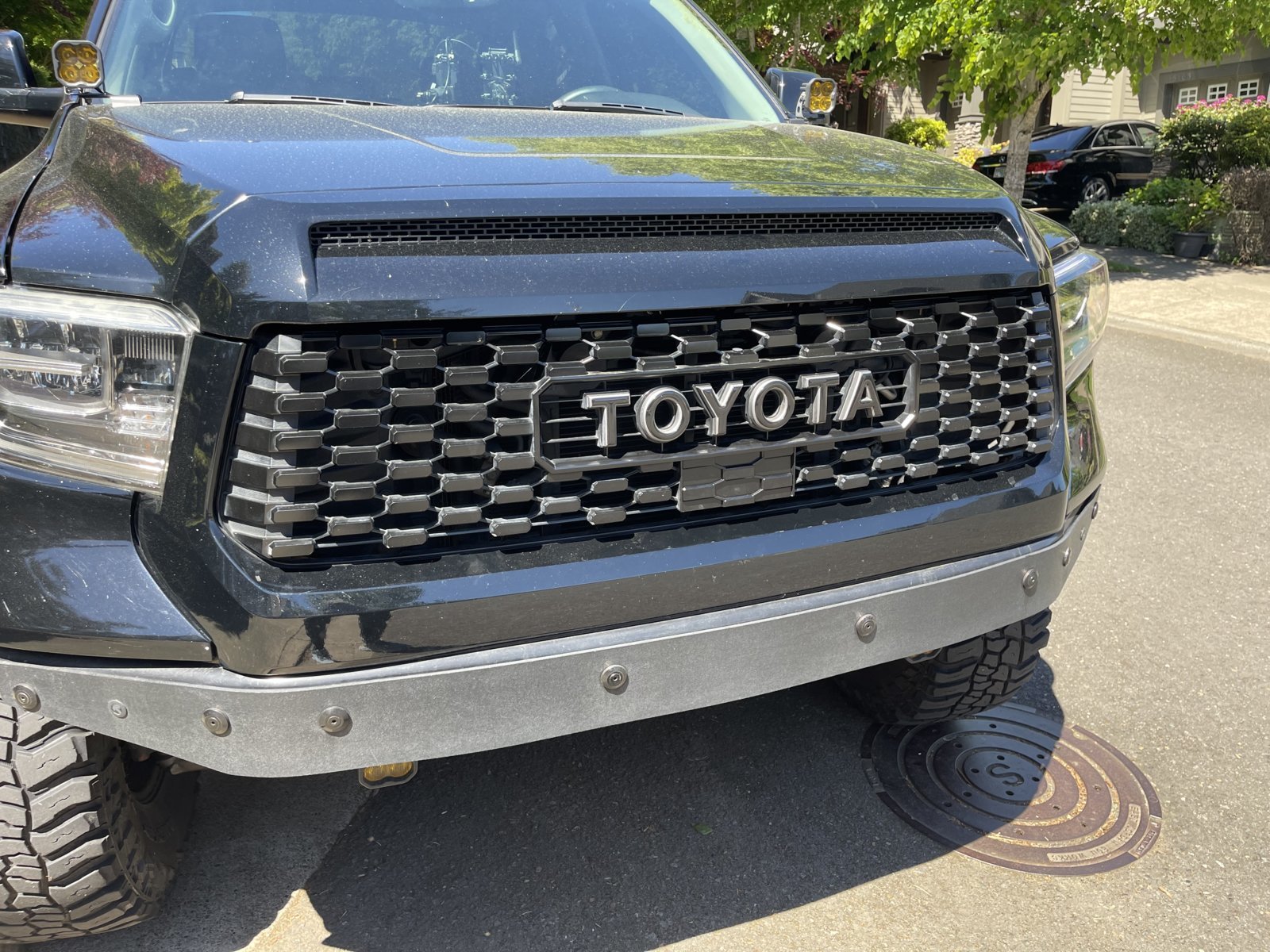

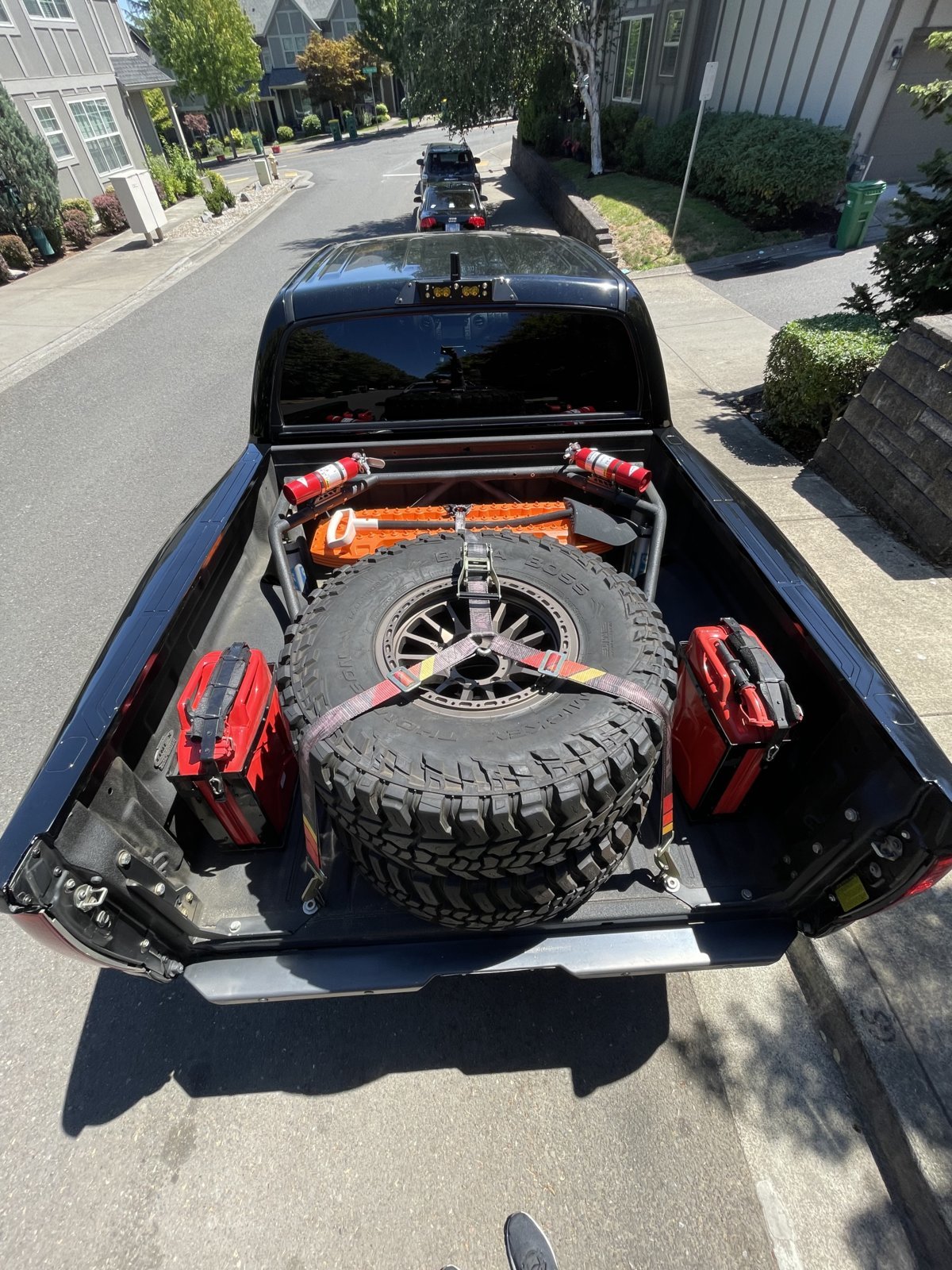

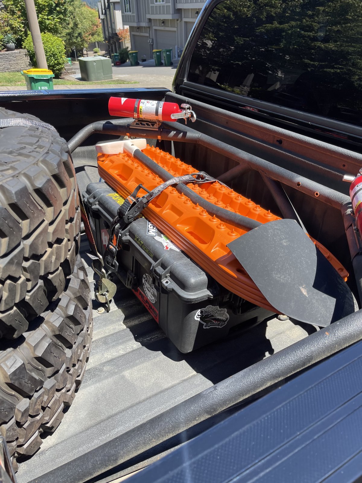

    Build Update 7/16/24
    Per usual I keep forgetting to update this. Notable updates below
    Changed all lighting to Baja Designs 4 LP9's Pros (2 spot, 2 driver combo) all clear lenses
    Push bar added to front bumper for the new lighting
    Removed the king 2.5 triple bypasses upfront and added king 3.0 triple bypasses with custom valving
    Second full size spare in the bed added
    Tune updated
    Full size jack added into new pelican case
    Updated recovery gear
    Parry parts front bumps on order
    Maxmia fluid container mounts/holders on order
    Garmin tread xl added
    Rago fab dash mount reorganized
    Added 2 more orange maxtrax total 4
    Spare fuel pump
    Order 4.0 king 5 tube bypasses to replace king 3.0x16 triple bypasses
    Revised bed cage
    Harness bar fabricated - waiting on the shop to drop the truck off
    4 new tires soon
    Send blower back to whipple and maybe add blower porting to it
    New plugs, new Lexus coil packs
    Prp Alpha race buckets with heat

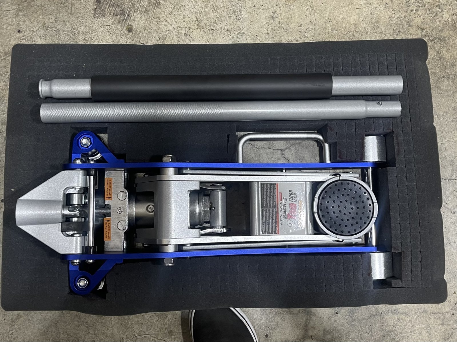

    more pics/info on the jack & pelican case setup?

    Yea added an aluminum jack and cut the foam to fit into the pelican case. Inside is also my recovery gear.

    That's pretty slick

    Careful with that jack, I had the same one and it folded over basically.
