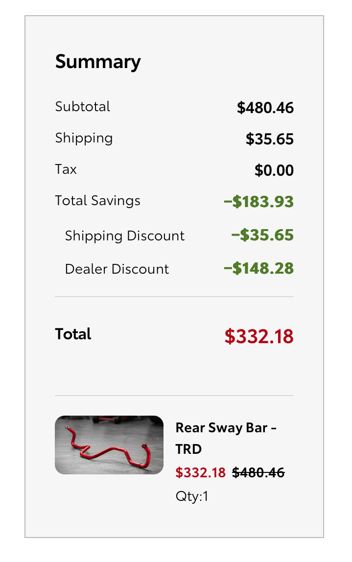

    Stating the obvious here, but the closer you are to a dealership, the better the shipping cost (sometimes it’ll even be free).
    This may be a bit tedious, but it’s worth the time spent if you want to find the best total price:
    1. Go to the official Toyota Parts Dealer page: https://autoparts.toyota.com/find-dealer
    2. Enter your Zip Code and you should see a list of dealerships
    3. Go down the list, one by one, and do a search for PTR11-34070
    4. Look for lowest base prices, then look at shipping cost in cart
    By doing this, I was able to find a dealership near me that was the lowest cost around AND free shipping. The upsides are that shipping transit times should be quick due to the close distance and it’s guaranteed to be an OEM part.

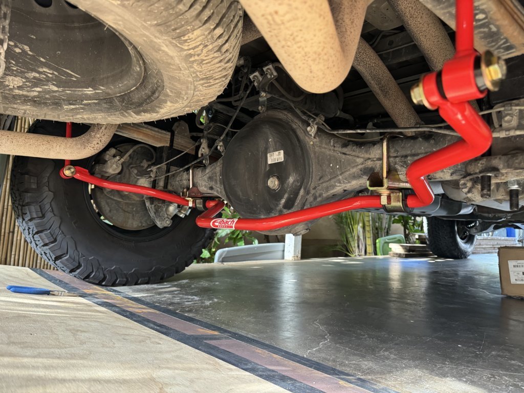

    3” lift, black step bars, aftermarket wheels, LT305/55R20 was this way when I brought it.
    I see you sway bar looks like it is on the rear of the axle, most I see mount to the bottom of the axle?

    2014 Tundra Platinum MGM CM
    Hey Rex! I'm trying to mount my swaybar like you did to get some more clearance under my axle for offroading! Did you have to trim your swaybar brackets to fit it over the axel welds? Also, did you have to bend/move the brake lines so the bracket fits?

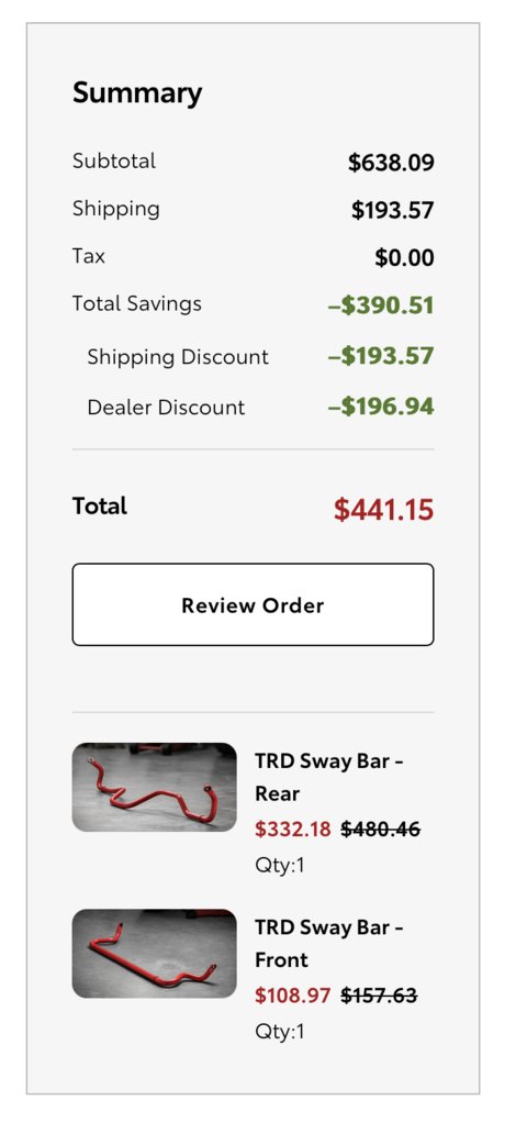

    This is my next project. Should I do just the back or the front as well?
    I am waiting on a 25% coupon from Fred Anderson Toyota or anyone else if you any?
    Still a good price if I get I now.

    get both.
    they are easy.

    3/2 SUSPENSION, 315/70 KO2, SNUGTOP AERO SPORT
    Answered my own question - yes it can be installed with lift, 2.5” rear blocks to be exact and the sway bar makes a huge difference with less body roll, better handling
