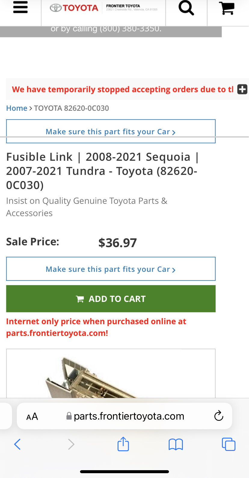

    I checked in a Google search to see if the Tundra has a fusible link, and it seems it might depending on some options. With my 97 LX450, it’s the first thing to go when stuff like this happens. Might suggest to see if you have one, and if so, make sure it isn’t fried.

    I just pulled the fusable link. I tested it all over for continuity and it seems fine. Not even sure how this fusable link is designed though. Not sure if I should replace it anyway.

    fusable link is removed but I can't see anything odd and seems to meter out just fine.
