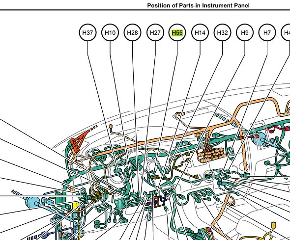

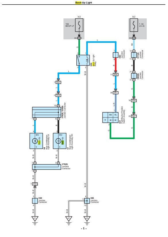

    For future reference here are your wiring diagrams if you ever need them.
    Ultimate SEQUOIA Wiring Diagrams Collection | Toyota Tundra Forum

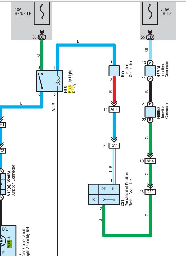

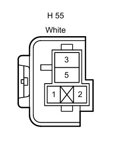

    Did you check the relay?

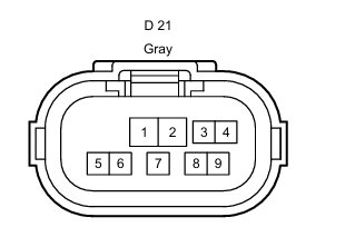

    Did you test and see if there is power sent to and from the park/neutral switch when in reverse with your DMM?
    Pin 1 lilac/ w red stripe wire, should be hot when in reverse with the ignition on.
    Pin 2 green wire to the switch from the battery, should be hot with the ignition on.
