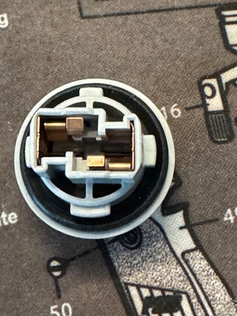

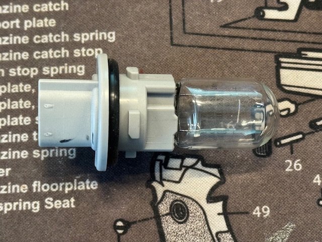

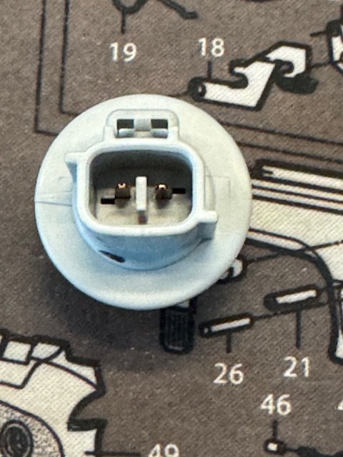

    I reread your post and edited mine..
    Sounds like you've got a bad or dirty socket.
    You might try bending the contacts out on the socket and bulb (if possible) for a better connection.
    Maybe spray some contact cleaner into the socket.

    And clean both ends of the socket if you go that route.

    I can never run LEDs in my tail lights (2nd gen). I think the extra weight makes them work themselves out of the socket after a short time, especially on rough terrain. I had to switch back to filaments. I also bent out the brass tabs inside the socket a tiny bit and tried different LEDs before I retreated to stock. It is too bad because the LEDs were much brighter.
