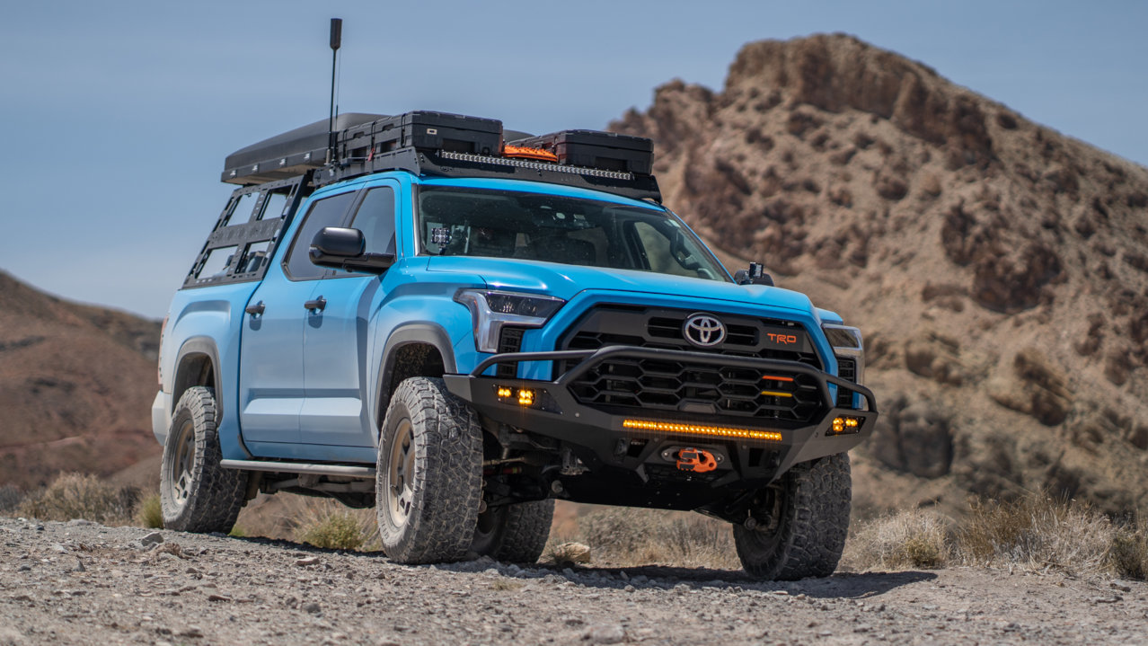

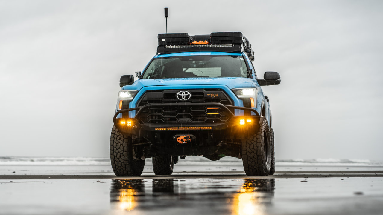

    PHASE TWO
    A LOT has changed in the last few weeks with the Tundra, and there's very little that has carried over from phase one. In fact, just the roof rack setup, wheels, and tires are the same.
    The biggest change is that it's now blue:
    Phase two build video:
    Mods in the order they're in the video:
    Avery light blue wrap from Adventure Motors
    CBI front bumper
    Warn VR12s winch
    Factor 55 Ultrahook
    Heretic Studio Tundra kits
    30" light bar (amber)
    Quattro pod (amber)
    BA-2 pod (amber)
    TRD Vinyls
    Ditch light brackets
    Quattro pod (white)
    CBI sliders
    CBI skid plates
    Desert Does It Seat Jackers and Multi Mount Panel for accessories
    Icom ham radio
    Antenna
    Mic mount
    Weboost Drive Reach OTR cell phone booster
    Satellite messenger
    Starlink RV
    SHW seat delete
    REDARC RedVision and Manager30 bundle
    TrailRax RedVision screen mount
    Batteries
    Inverter
    Roof power box
    120v AC outlet
    12v DC outlet
    SHW drawer system
    CBI bed rack
    iKamper roof top tent with inflatable mattress
    Lift kit
    Method Wheels 705 18x9 +18 offset (20% off with this link)
    Tires: Toyo Open Country ATIII 35x12.5xr18
    Prinsu roof rack with cutout
    40" light bar (white)
    KC wire hiding kit
    Prinsu Summit handles
    ROAM 83L cases
    ROAM 83L lid organizer
    Maxtrax
    Maxtrax mounting pins
    Prinsu Maxtrax mount

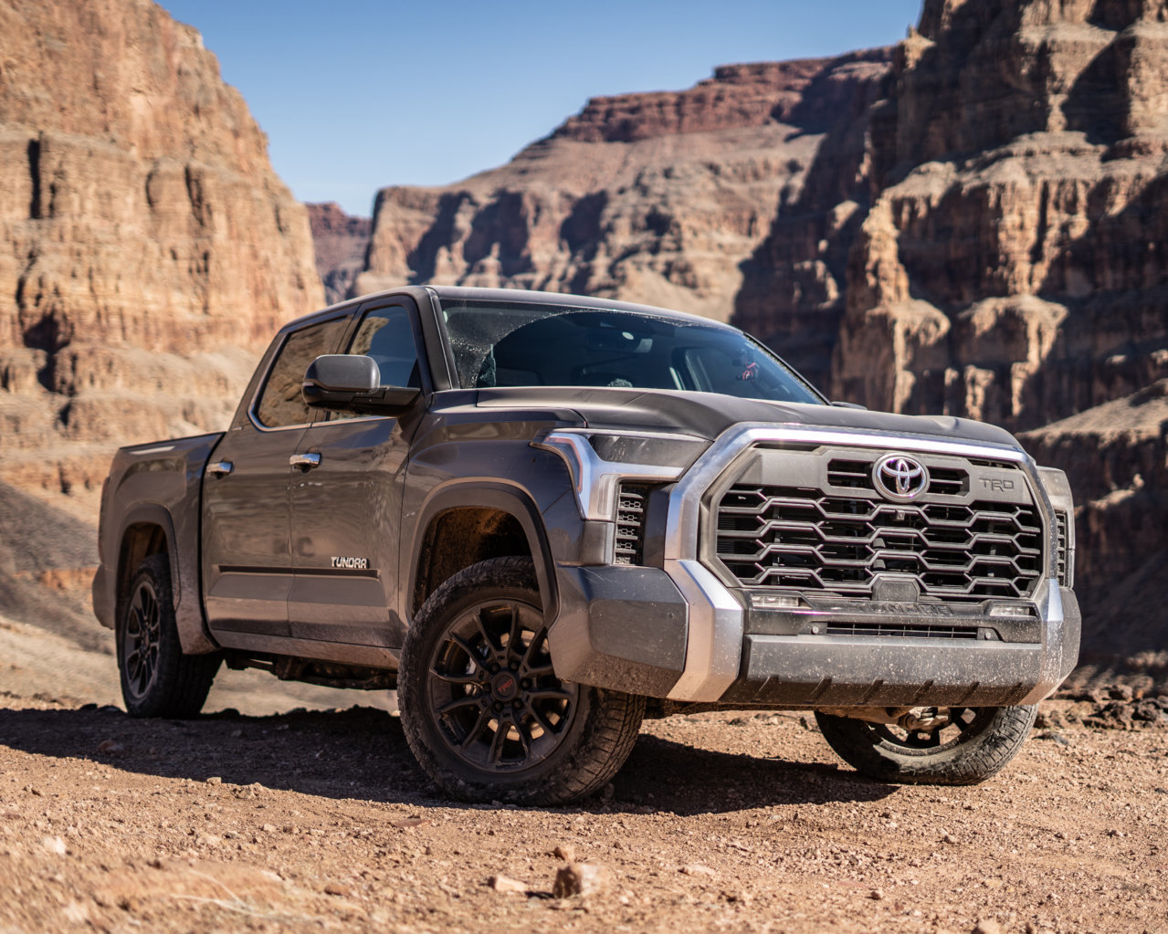

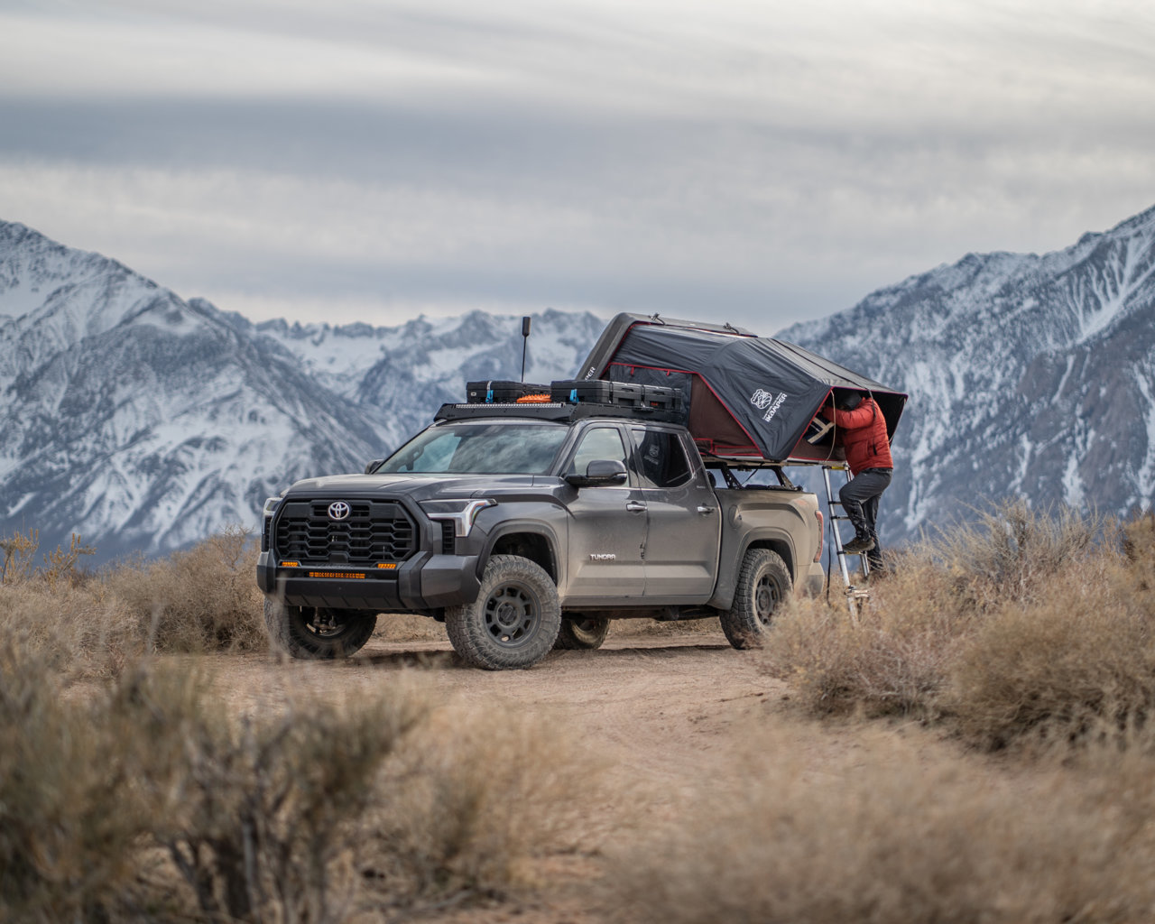

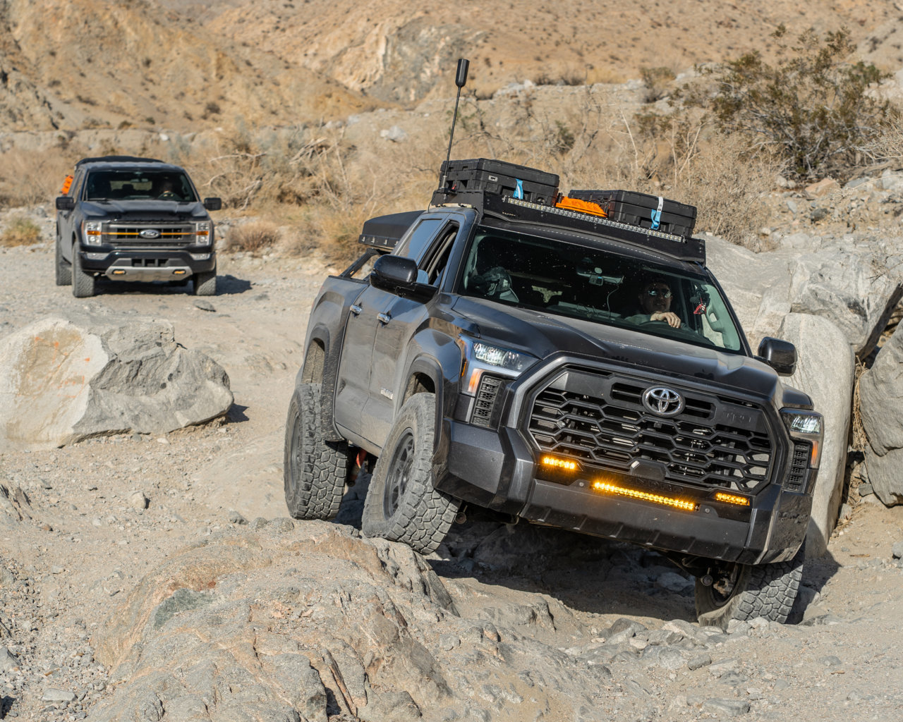

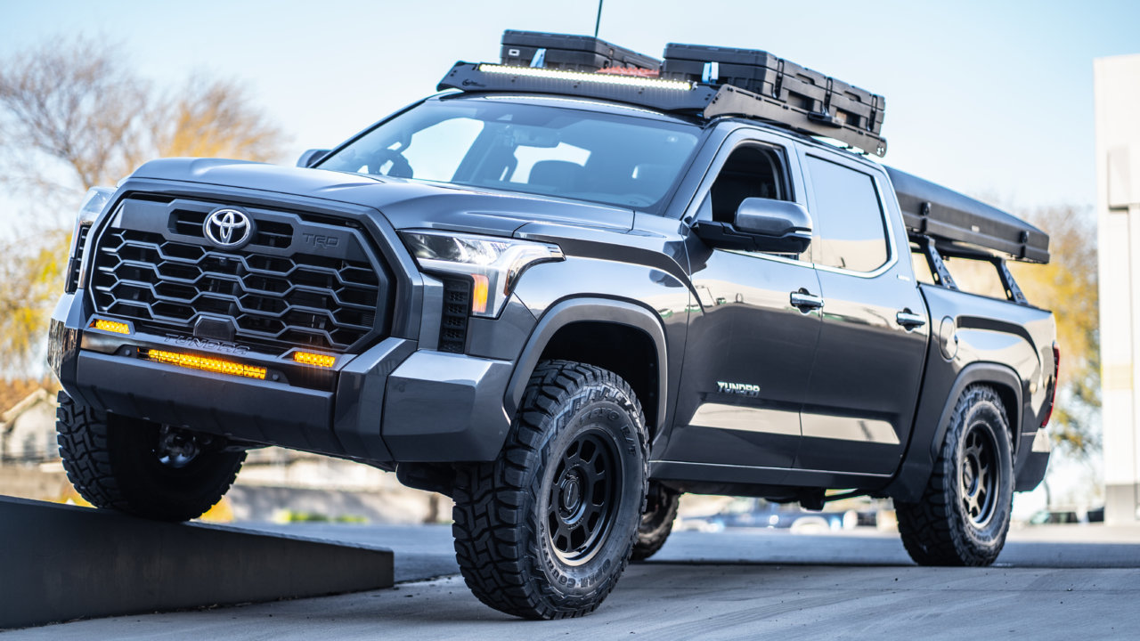

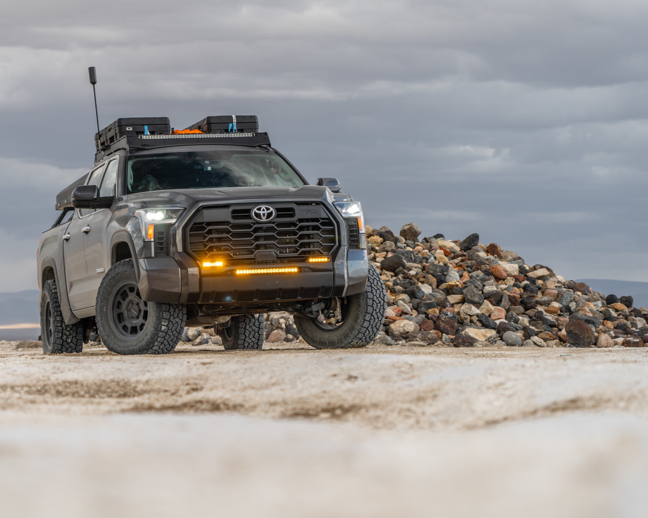

    PHASE ONE
    With just 4 days before our most recent trip, we got the Tundra ready to take off road. 7,200 miles later, and I'm home! There's still plenty to do, but I figured a mid-build thread would be worth doing. I'll update as more is added! Some of the stuff is reviewed below.
    We started with a 2022 Limited with the TRD Off Road package:
    And are here as of 3/2/22:
    Complete-
    Lift: Westcott Designs 3/1" lift
    Wheels: Method 705 18x9 +18 offset (20% off with this link)
    Tires: Toyo ATIII 35/12.50/r18
    Roof rack: Prinsu with 40" cutout
    Roof light bar: Heretic Studio 40" light bar
    Fog lights: Heretic Studio Tundra fog replacements (coming soon)
    Bumper light bar: Heretic Studio 20" Tundra bumper light bar (coming soon)
    Roof storage: ROAM 83L rugged cases
    Traction boards: Maxtrax with Prinsu mount and Maxtrax mounting pins
    Roof rack handles: Prinsu Summit handles
    Cell phone booster: Weboost Drive Reach OTR
    Bed bars: CBI Fabrication Overland Bed Bars
    Roof top tent: iKamper Skycamp 2.0 (on sale until sold out, then replaced with 3.0)
    2nd battery: 200Ah LIONcore
    Battery charger: REDARC Manager30
    Power distribution: REDARC RedVision
    Fridge: ICECO VL75ProD (10% off with code PD10)
    Seat: Desert Does It Seat Jackers to lift the seat and Multi Mount Panel for accessories
    Grille: Paint matched the hideous chrome
    Coming soon-
    Front winch bumper: CBI Fabrication
    Full height bed rack: CBI Fabrication
    Rock sliders: CBI Fabrication
    Skid plates: CBI Fabrication
    Drawer system: SHW Off Road
    Solar: REDARC solar panel
    Some links are referral links since I'm affiliated with the companies.

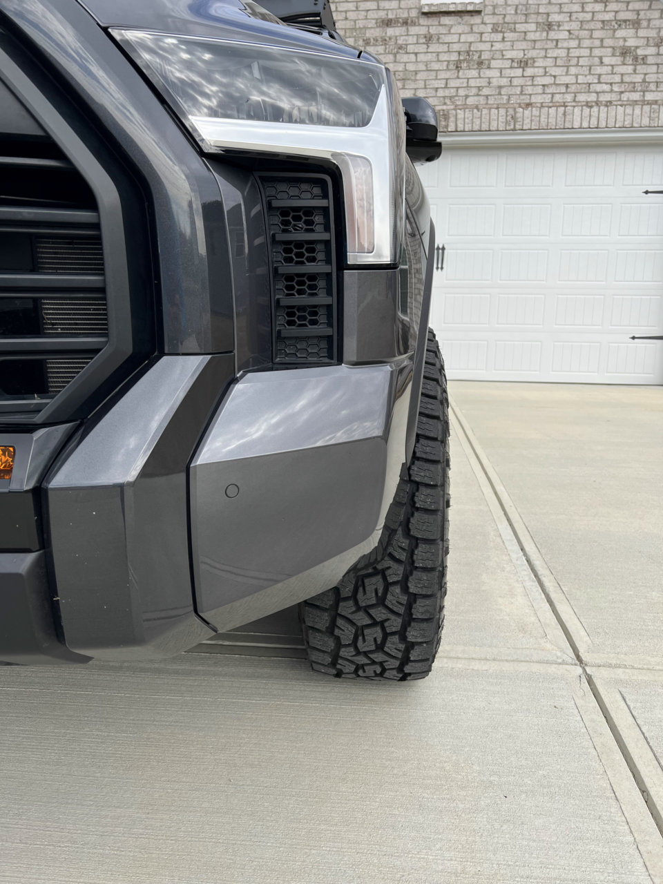

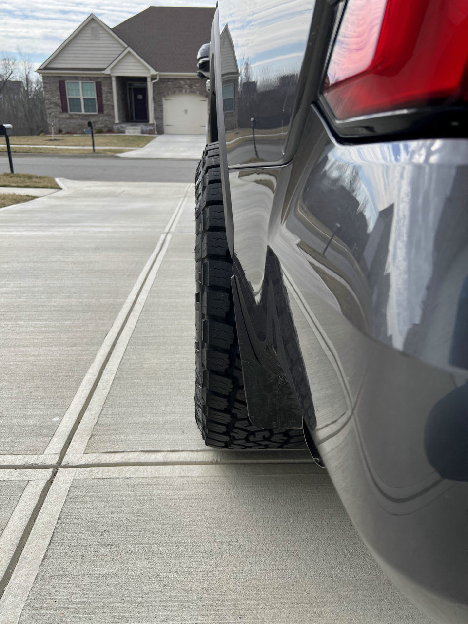

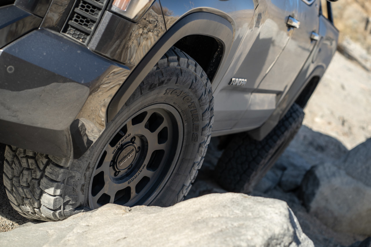

    Westcott Designs lift info (PHASE ONE)
    The lift is a preload collar from Westcott Designs. It works by adding a spacer collar at the base of the spring rather than a spacer to the top of the strut, which keeps all of the factory geometry. It's much better than a traditional spacer.
    Any time you add compression to a spring, you're going to change the ride. It's fine for road and light off road use, but I wouldn't recommend it for anything tougher than maintained dirt roads. Washboard roads get old quickly with the firmer ride.
    Unfortunately the stock suspension (TRD OR package) on these '22 Tundras has pretty terrible flex, and since Westcott reuses this in their lift, it still has terrible flex. You'll lift tires regularly.
    I'd recommend a max tire size of 35". It fits well, and is the max that will fit in the spare tire location. We tried 37s (see the picture below), but with even the slightest flex you'll get rubbing. This is as far as we could go before it bottomed out:
    The tires in the picture are Toyo RT, but we switch to Toyo ATIII. I chose them because they were the only tires available! I actually really like them, and they seem to perform a little better off road and in the snow than the KO2s I had previously - albeit with maybe fractionally more road noise. We'll have to see how they wear over time.
    Wheels are the 705s from Method Race Wheels, and are fantastic. Not only do they look great, but they're also bead grip wheels... plus you can get 20% off! The bead grip wheels have ridges and oversized safety humps that help hold the bead of the tire better. This means you're less likely to lose the bead when you air down to low pressures. In this picture I'm at 13psi:
    EDIT: Added pictures of the wheel poke to show how the offset/wheel/tire combo stick out:
