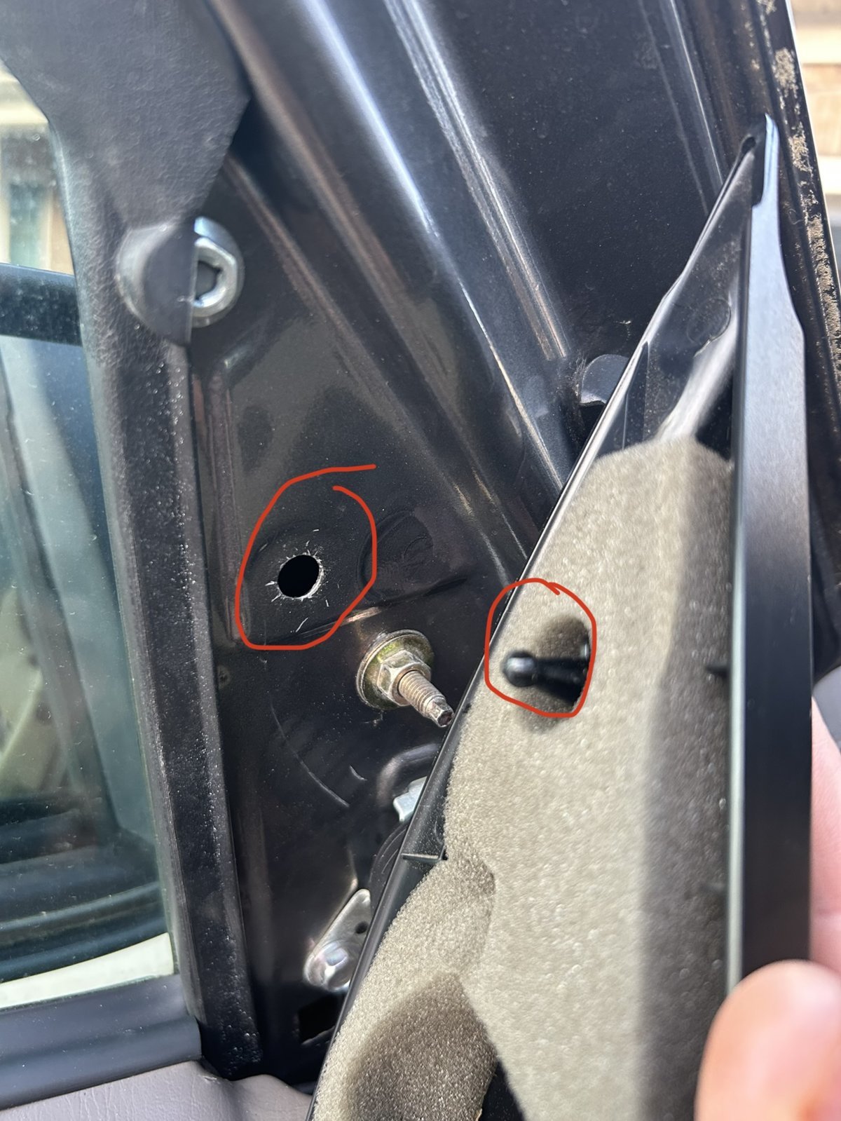

    Gentlemen,
    I can’t seem to find these pieces on any diagrams. The first one is a small plastic piece the tweeter cover is secured into. All help is appreciated.

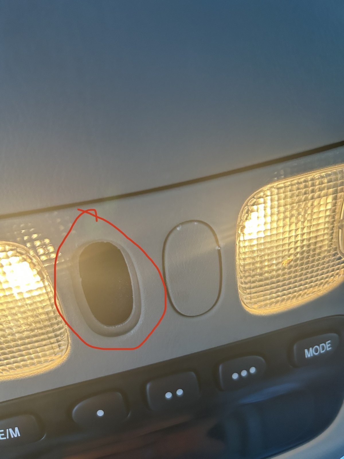

    The sail plate piece looks like the same white receiver used for the cowl. Should be in EPC-DATA’s diagrams, where did you look?
    the overhead console bit is part of the console assembly; likely need to hit a junkyard.

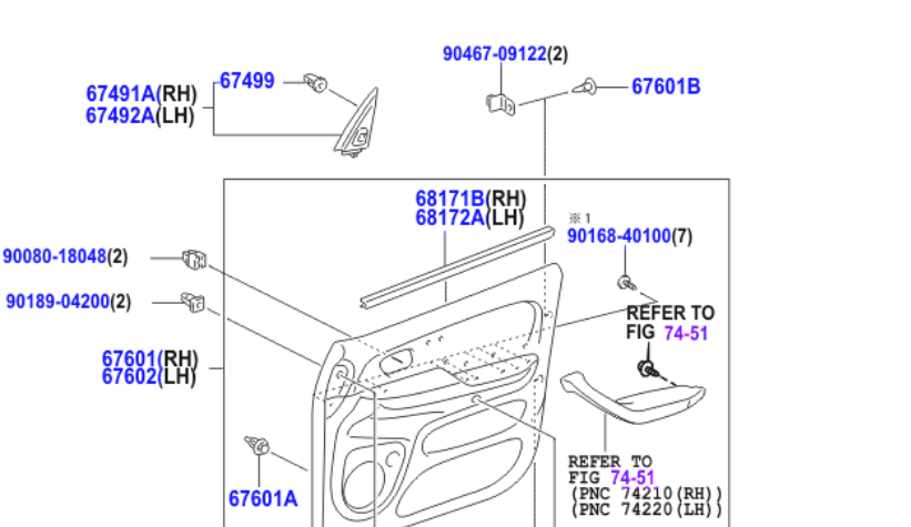

    I'd use the system listed in the bullet points at the top of this post: https://www.tundras.com/threads/howto-use-the-toyota-parts-system-to-find-order-parts.113808/
    I don't have your exact VIN so this may mean nothing, but I ballparked your chassis and got here under Body / Front Door Panel & Glass: https://toyota-usa.epc-data.com/tundra/uck41l/3813/body/6751/
    If I click on the exploded to blow it up I get here: https://toyota-usa.epc-data.com/tundra/uck41l/3813/body/6751/?full

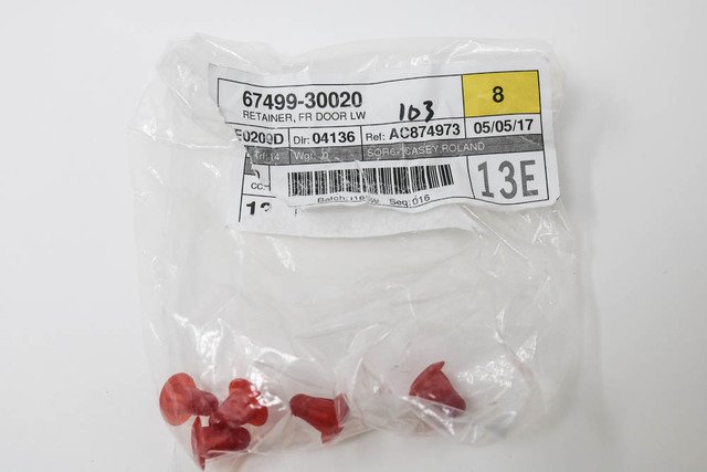

    And it looks like "67499" (upper left) is your part. Clicking it in the exploded tells me 67499-06010 is the intended part, and 67499-30020 is a favorable substitution.. But don't trust me on that. You need to follow the steps in that 1st link up there, plug in your VIN, and get the EXACT part for your truck.
    This is what that the 2nd part number looks like, which is nearly identical to the cowl clips, albeit red and deeper ... and I can't find a pic of the part ending 06010:

    I have been lookin for this part. Just talked emailed someome from my local toyota and they confirmed that part number for the speaker cover clip is 67499-30020
