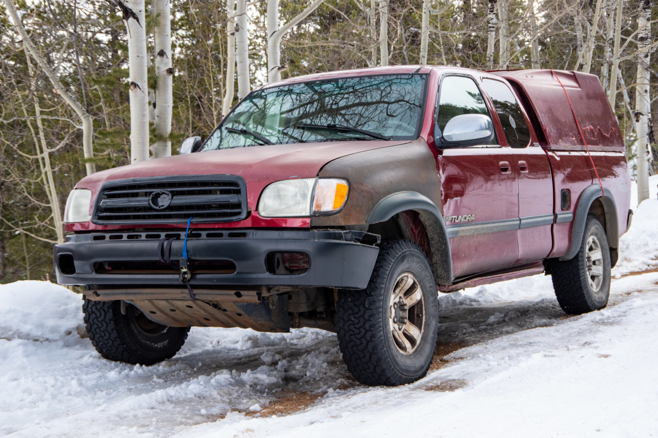

    I'm starting this thread on behalf of a good friend and housemate who recently acquired a 2000 Tundra TRD, which has been nicknamed 'Roony due to being maroon. Over the course of this build he'll be chiming in as well.
    As the automotive adage goes, "buy the best example of the vehicle you want". This went out the window when he picked up the cheapest Tundra in the state. $3,200 cash and it was his. It needs a bit of love, but has good bones. Being a Colorado Toyota rust is pretty minimal.
    The intended purpose of this truck is to be a winter daily, a camping truck, light duty tow-rig, and a snow plow host when needed.
    (My 80 in the background - a 1997 LX)
    As far as we can tell it's been in one accident and had the fender and bumper replaced. At some point the door will be replaced but it is functional for now. The window goes up and down, but only the exterior handle works. Thankfully, the frame is still straight.
    The interior is about as clean as one would expect for a truck of this age and mileage.
    The seller was kind enough to include a generic timing belt kit, which is desperately needed. We plan on getting an OEM Toyota belt to replace the one from this kit. Thankfully he has another car to drive while we gather parts and tools for the job. The Tundra is going to stay parked until the TB job is done.
    It currently has 228,718 miles on the clock, so the break-in period has been completed.
    A quick check with the CEL scanner indicated that some oxygen sensors may be needed. I'll have to look again but I think it's P0135. No other codes are being thrown.
    Under the hood, everything appears to be solid. All fluids are clean, nothing leaks as far as we can tell, and the battery is new. No milkshake in the radiator. Transmission works as it should. AC and heat are fine. 4-Hi and 4-Lo engage easily. No weird smoke coming from the exhaust. Overall it seems pretty mechanically sound but cosmetically rough.
    The front end is... loose. There are a lot of worn components in the steering department. Per the previous owner the brakes were done pretty recently. Wheel bearings may also be needed. There's play when wiggling the wheel at 3 and 9, but not at 12 and 6, so the ball joints may be ok for now.
    This is going to be a joint wrenching effort and we have our work cut out for us. We're both mechanically competent and have all the tools required to get this thing fixed up. The short term to-do list:
