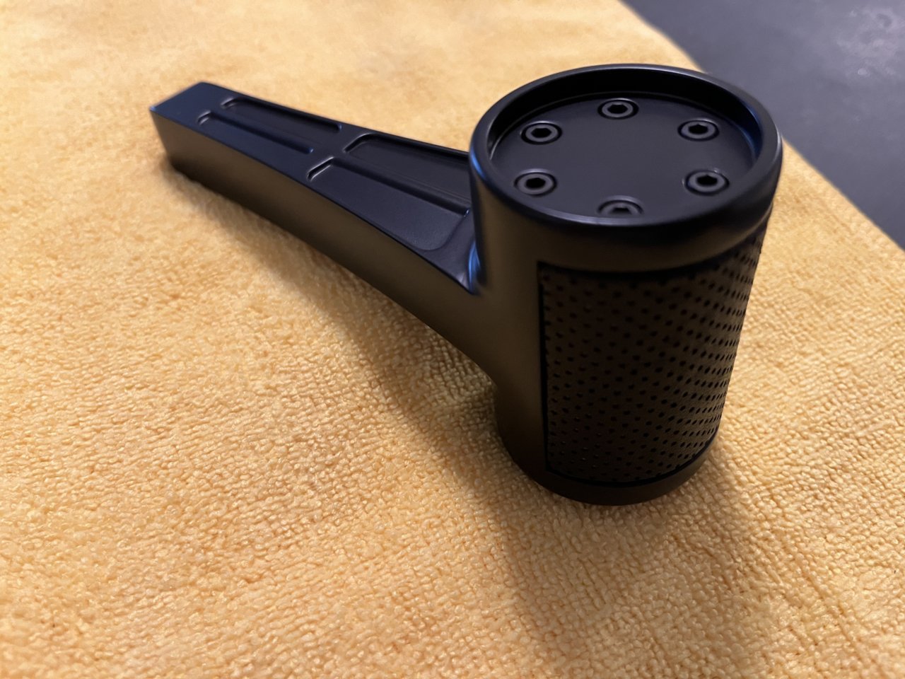

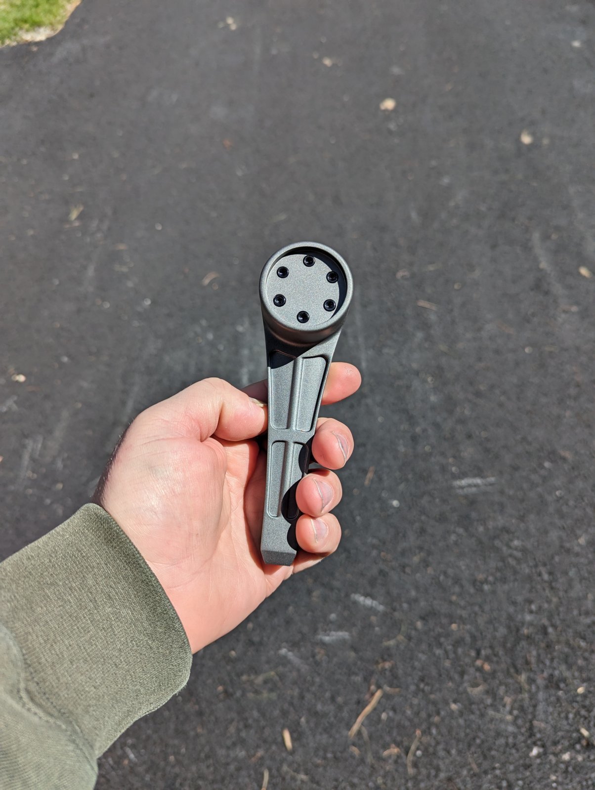

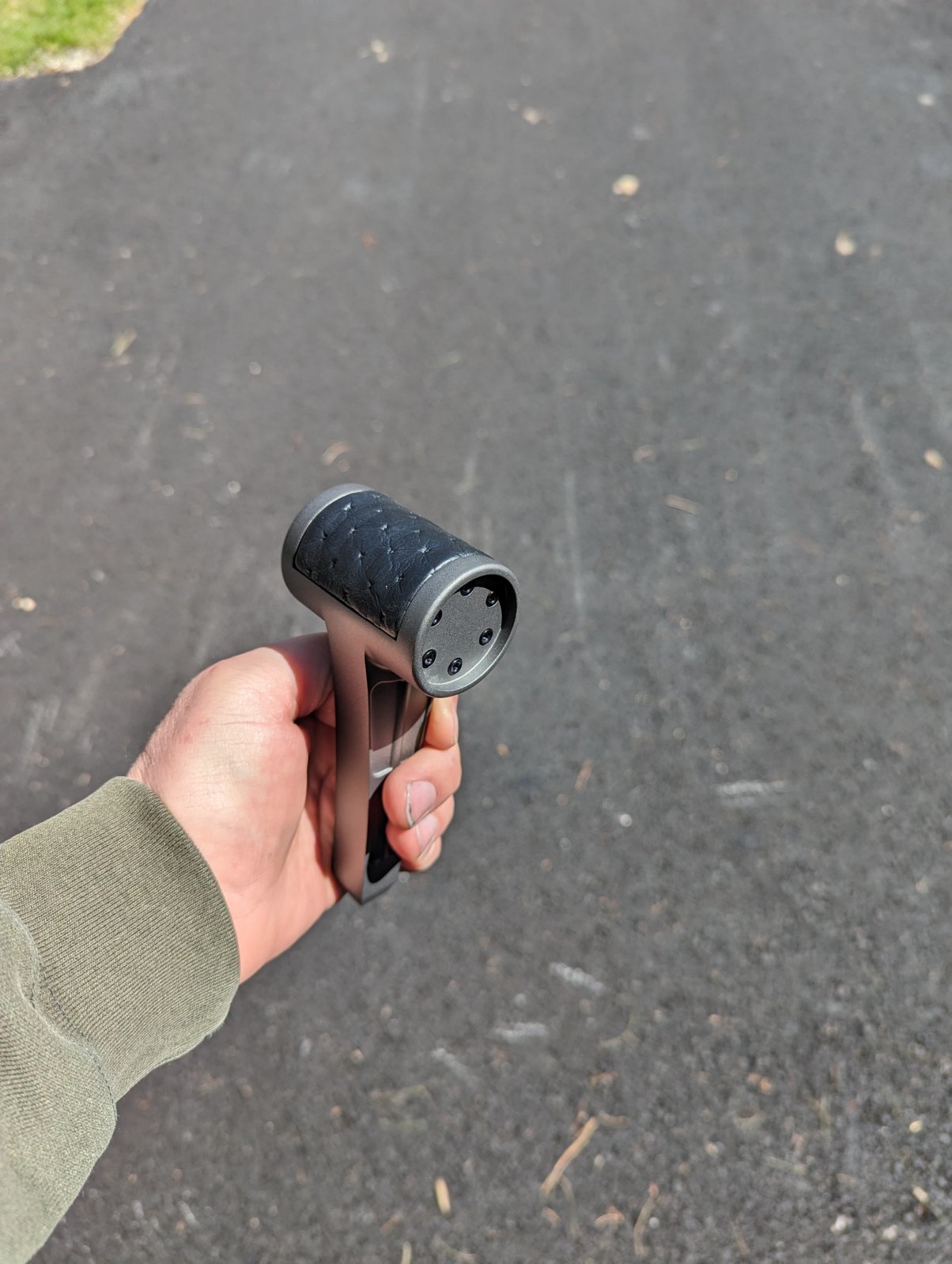

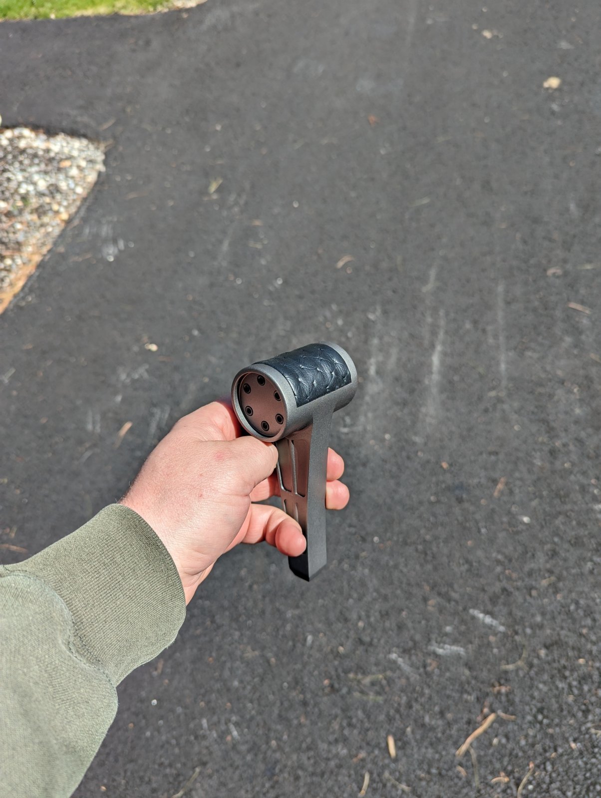

    Here’s what I came up with:
    Black Cerakote
    SS black hardware
    Perforated black leather

    Looks very clean!

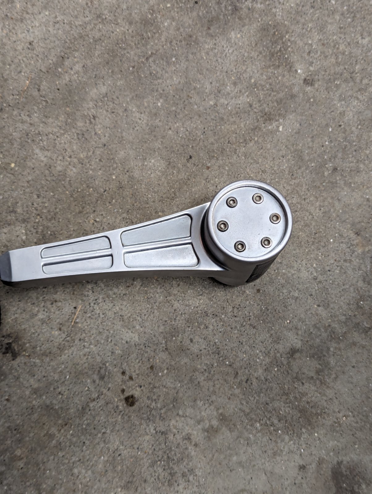

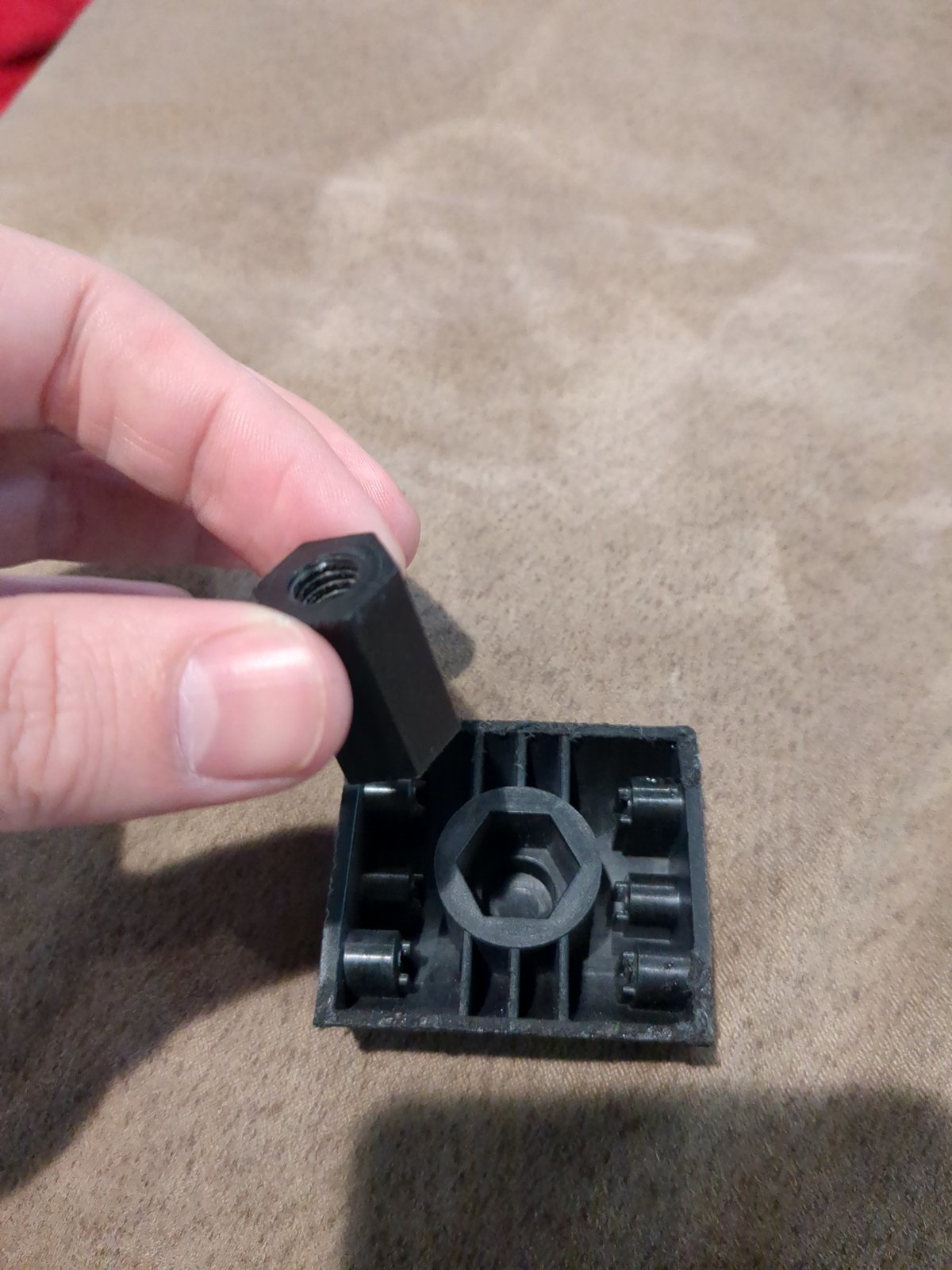

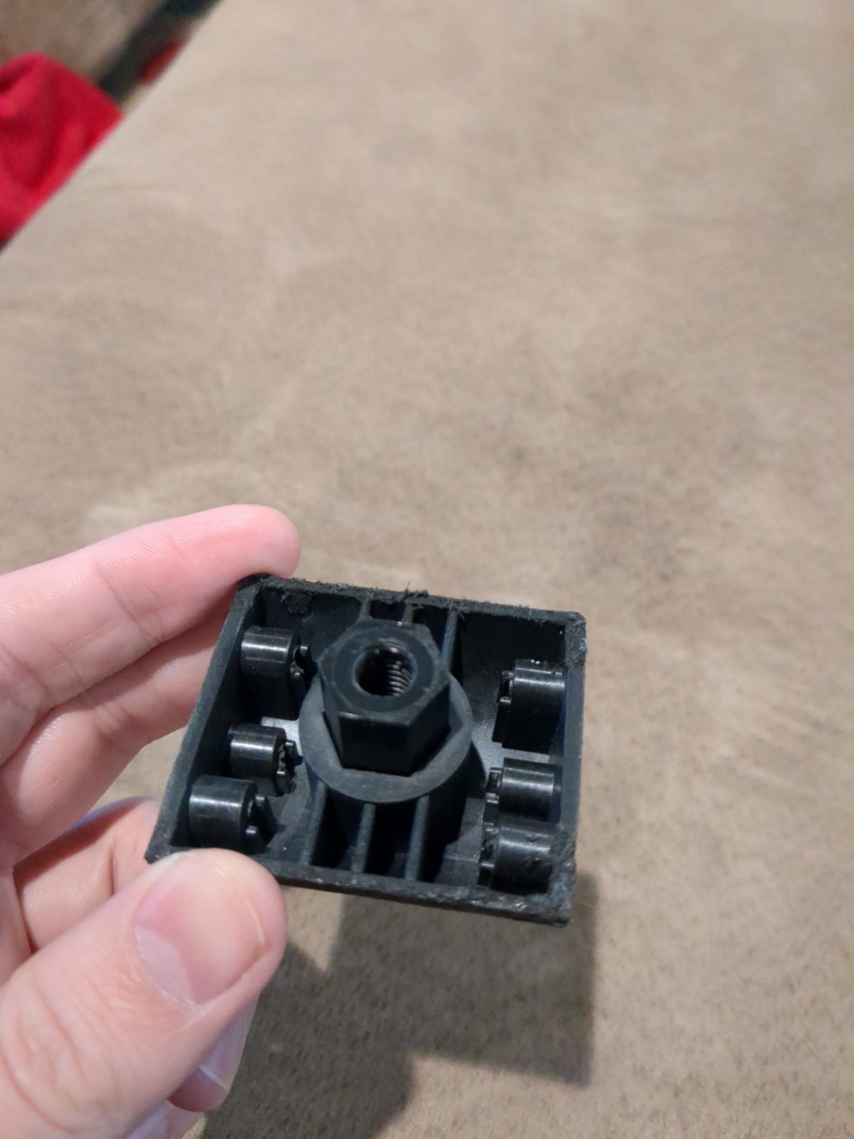

    So this is my spare that I am experimenting with as far trying to replace the plastic with solid metal stock.
    @crbr what two pieces of plastic are you referring to? Mine is one solid piece of plastic. Also as far as removing paint I would suggest sand blasting, or a chemical spray and some light sanding
    this was also the first tomahawk I came across that didn’t have leather on it and it came with a polished black insert
    bulldog93 and crbr like this.

    The plastic part that it screws into on mine is an insert into the half cylinder.
    Shanet421 and bulldog93 like this.

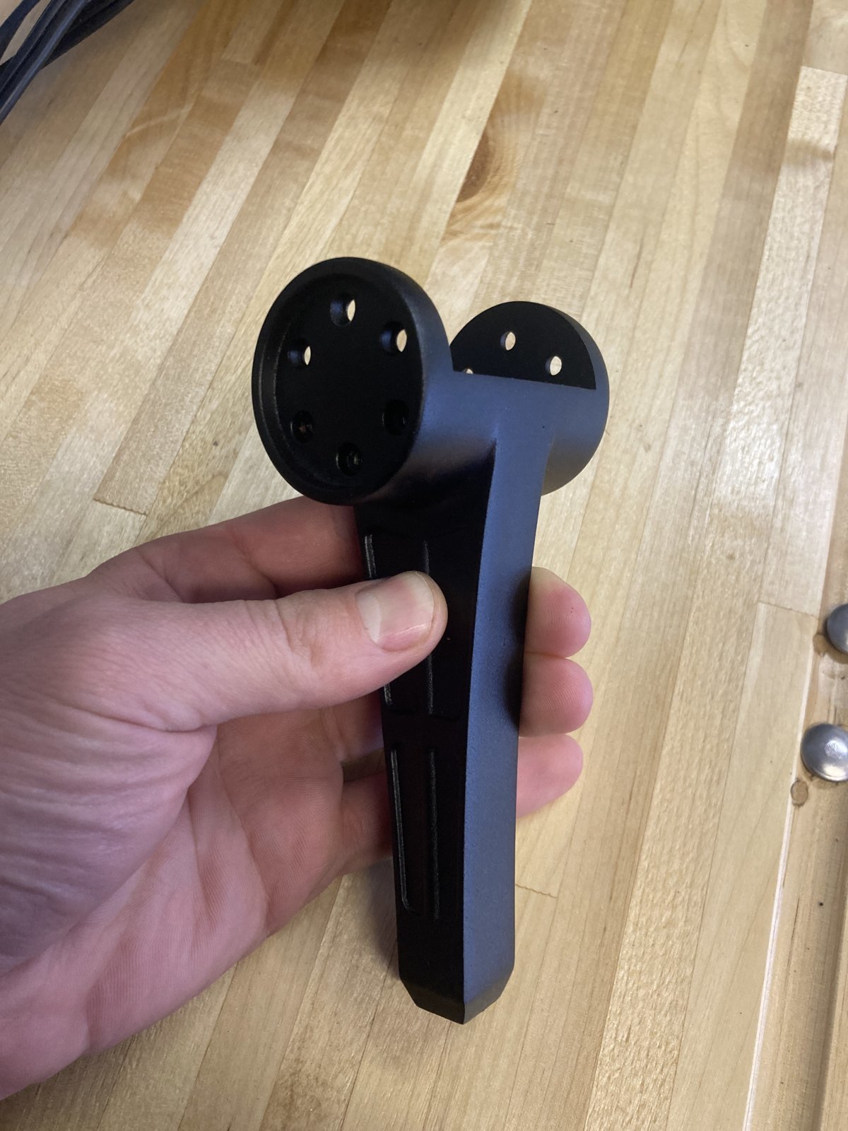

    Just finished installing the leather today. Powder coated and need new screws and done ..

    oh wow, i feel foolish, I have taken apart a dozen or so of these doing restorations since doing mine and have never known that!

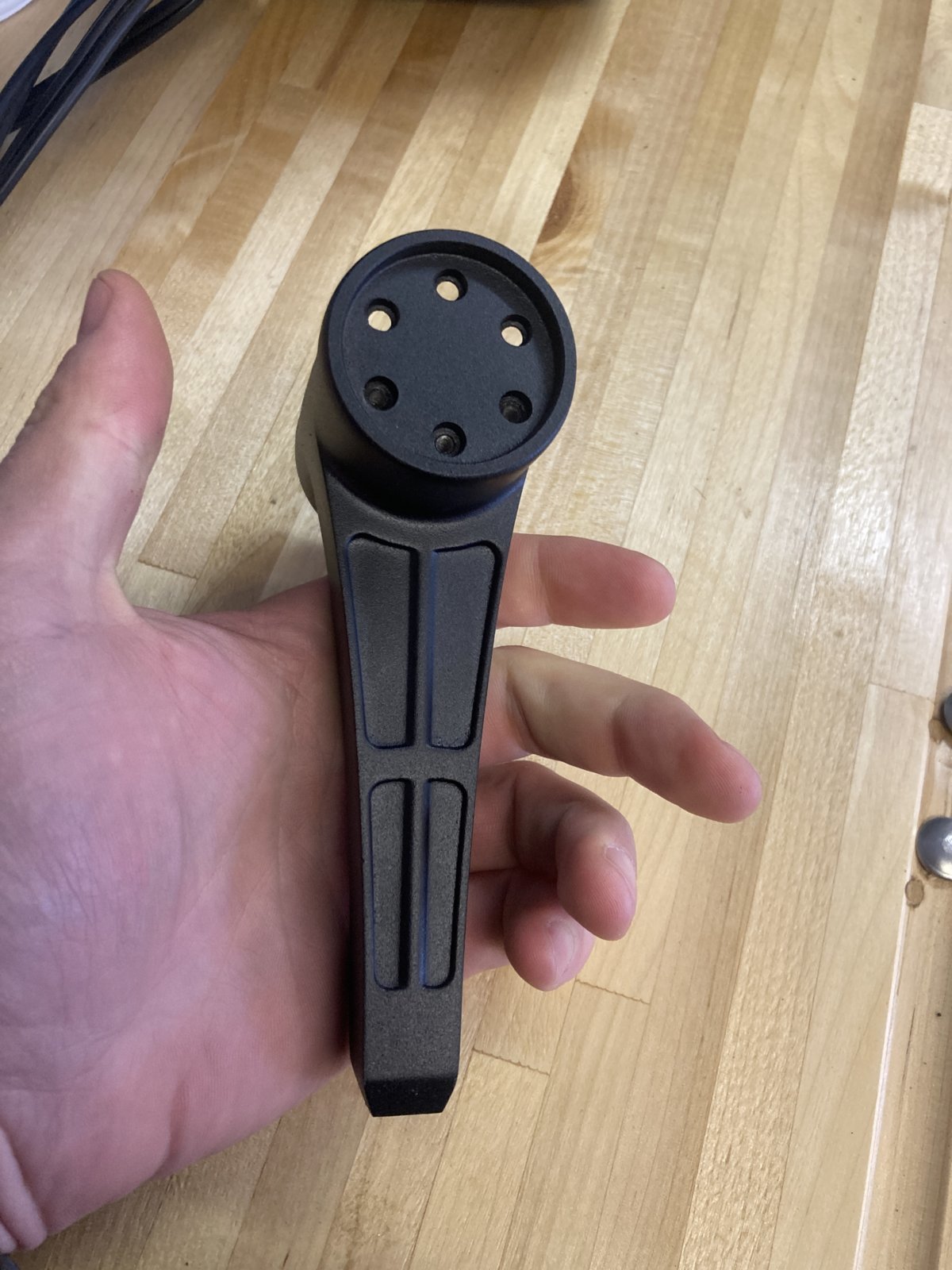

    Just got this tomahawk shifter back from powder coating. Unsure what color leather I want to go with. Black or Red is where my head is at.
    Going to post it for sale soon.

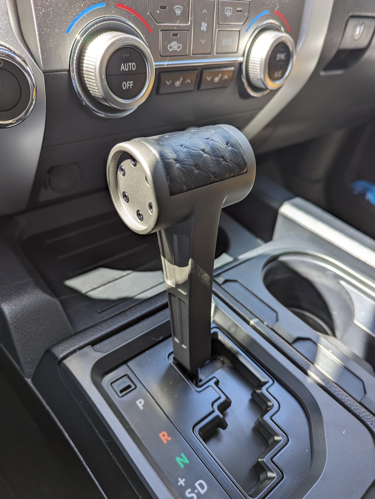

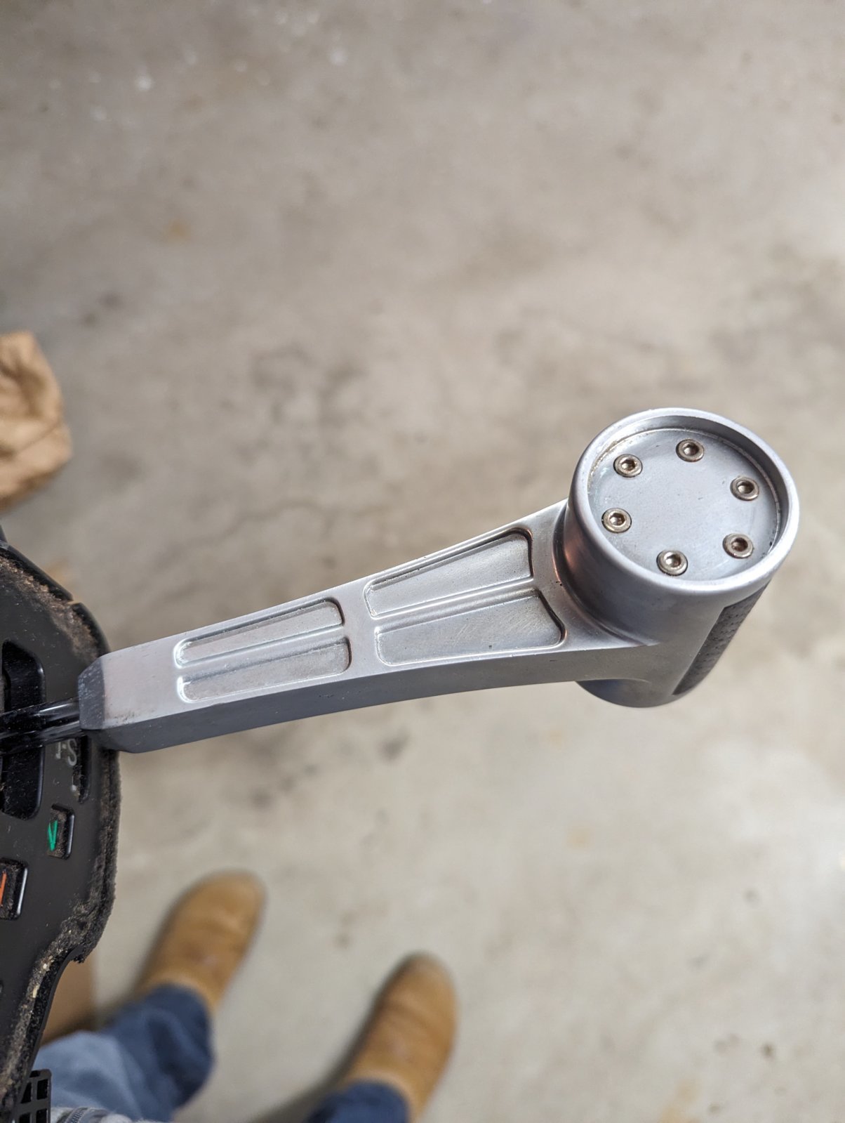

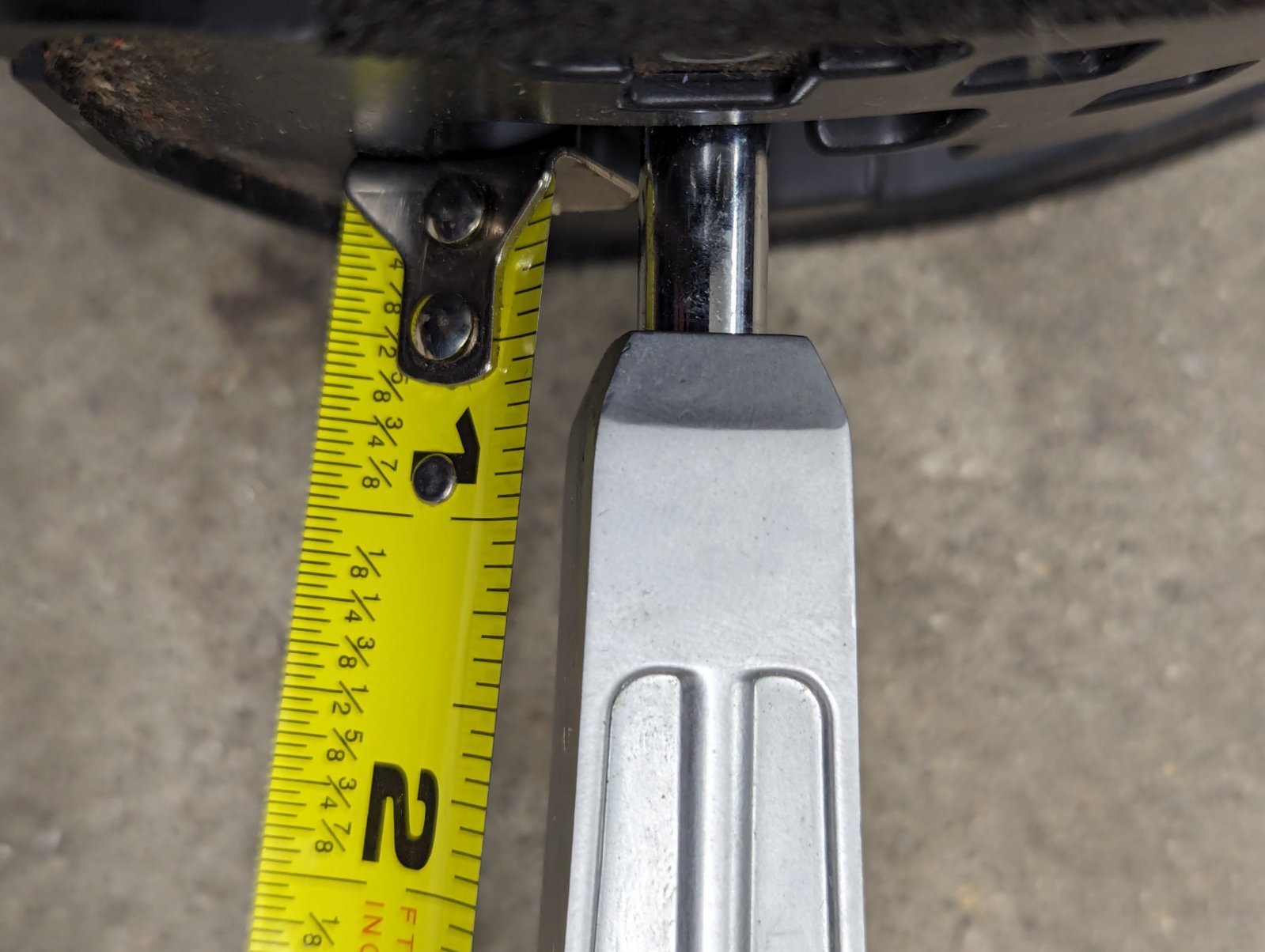

    Is everyone installing back to stock height or counting turns? I found the instructions (for an FJ, but the same shifter) and it said to install to 1/2" height above the shifter gate. It's seems to be how both of the ones I got were installed, and they were both 15-17 full turns to remove.
    Dropping them both off for "brushed aluminum" Cerakote tomorrow. Have an upholsterer friend helping with the replacement leather. Fun little project. One of them was nearly perfect, the other has some putting and needs blasting.
    Thanks to all for blazing the trail.
    Edit: place called it brushed aluminum but maybe they meant satin aluminum (Cerakote name). I now need to look at it vs battleship grey (Cerakote name). Regardless, keeping it classic.

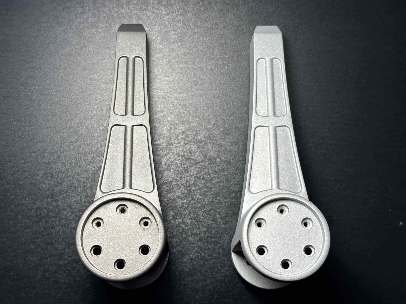

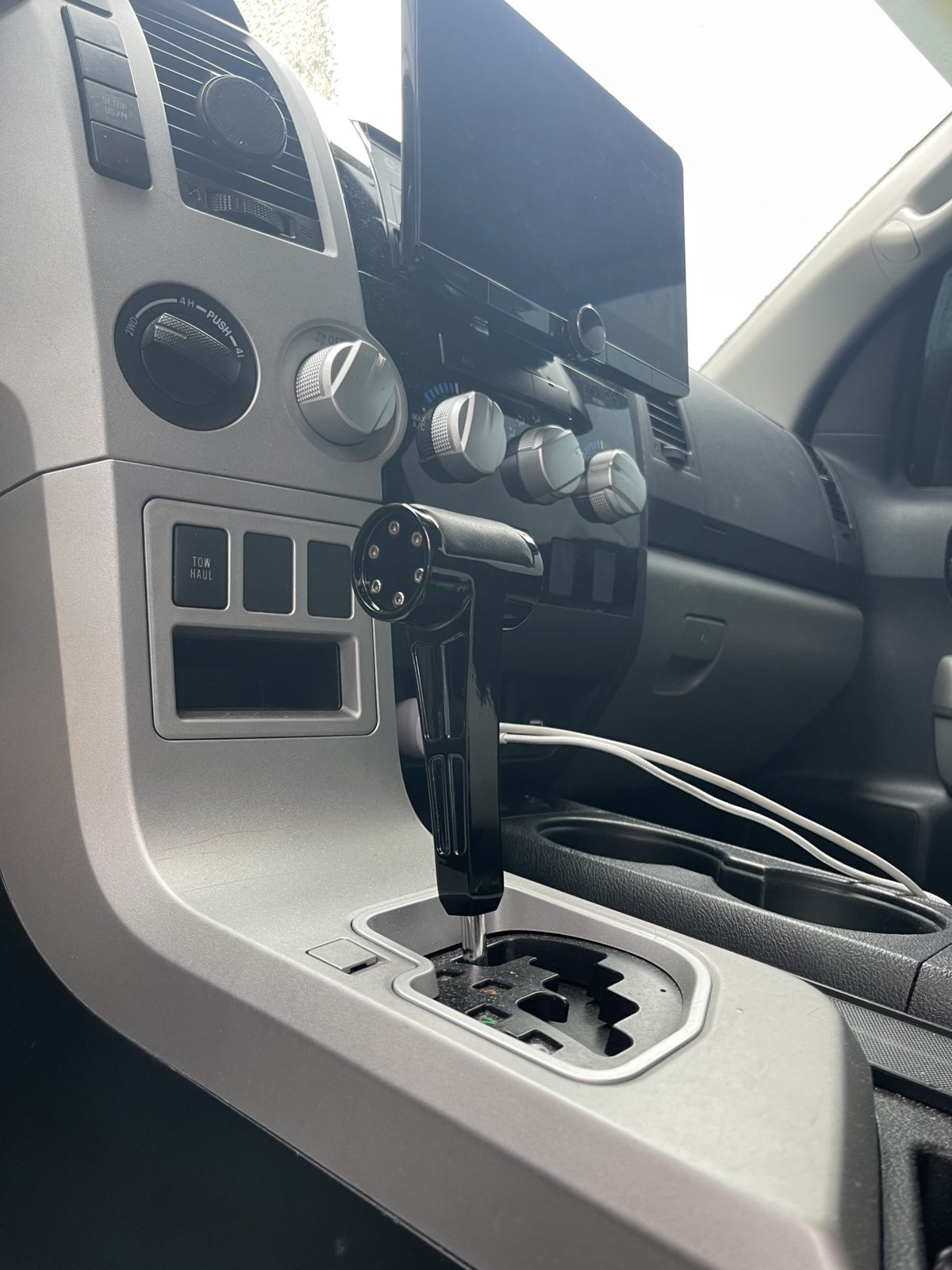

    Progress. Went with one of each color, and while this photo washes the tungsten out a bit, they both came out great. New polished aluminum heads for the silver (factory look), I got black bolt heads for the tungsten. Both will be getting new leather, which I'm hoping to get done this week.
    Thanks to @RainMan_PNW for his build thread. Following his lead, my local firearms shop turned them around in just a couple of days.

    If you run them down too far they will hit the shift gate trim in park and mark it up. I’ve had it happen in the 08 and the 21 - both times when a service tech twisted them down to a full bottom out. :mad:

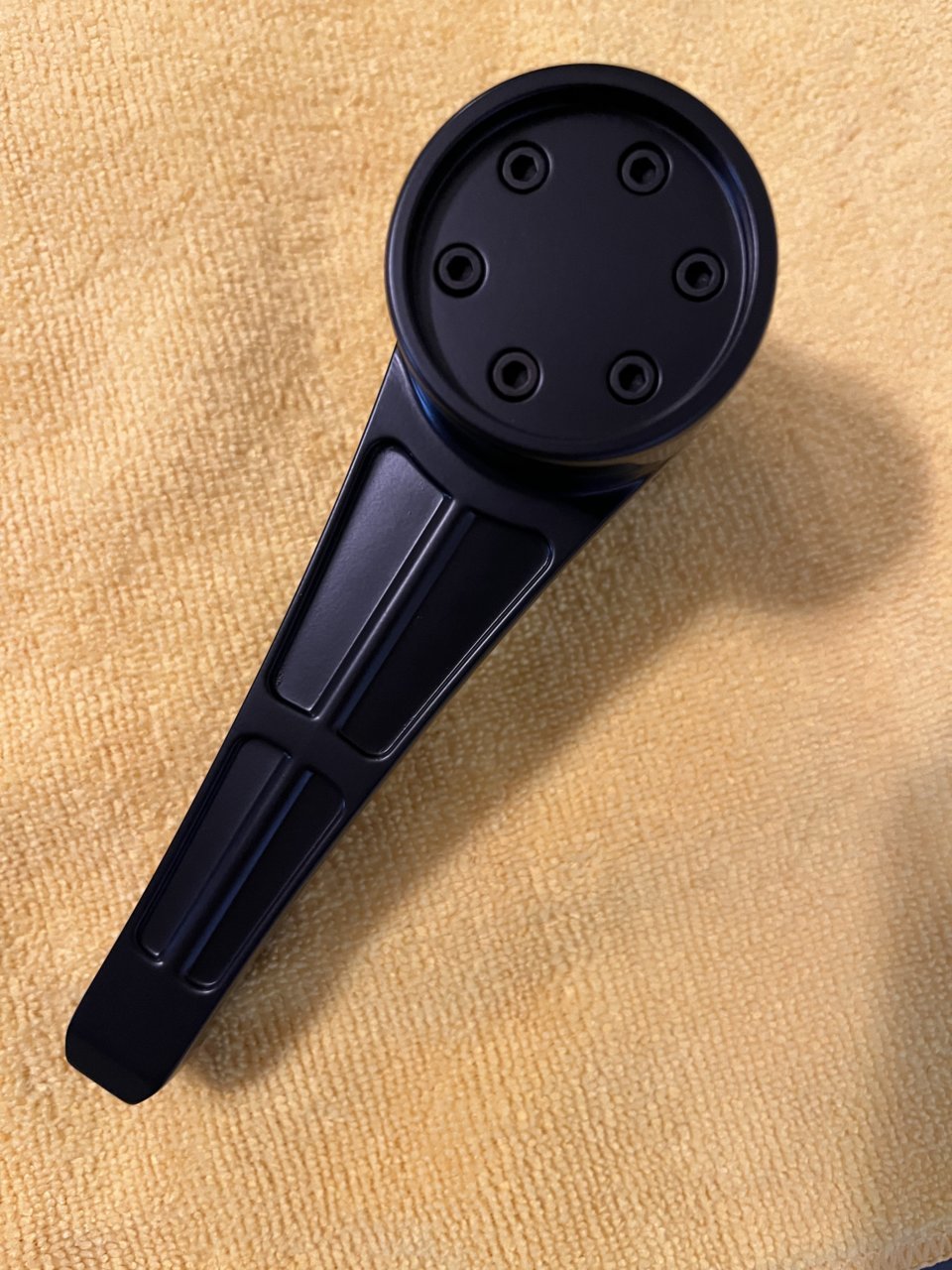

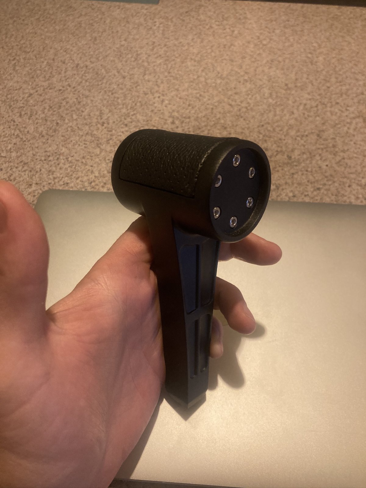

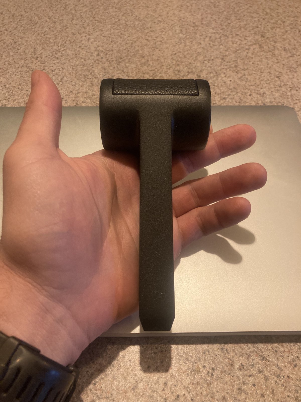

    Finished the shifter restoration.

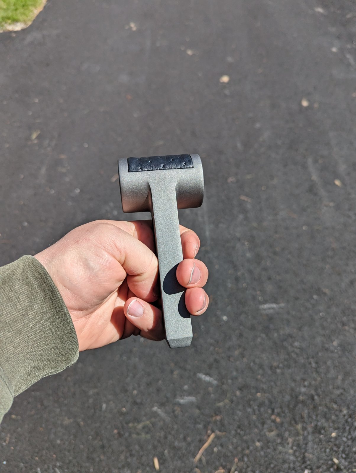

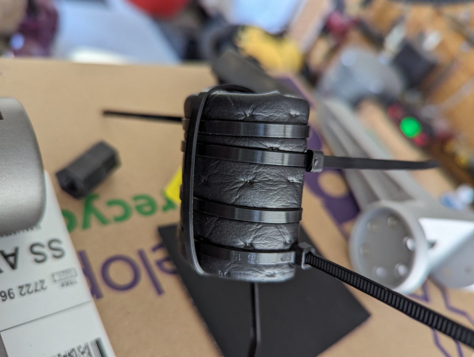

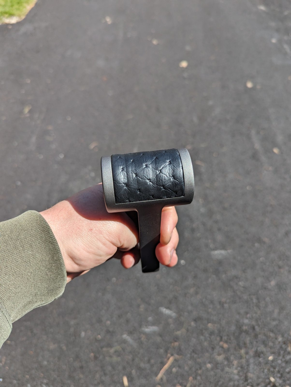

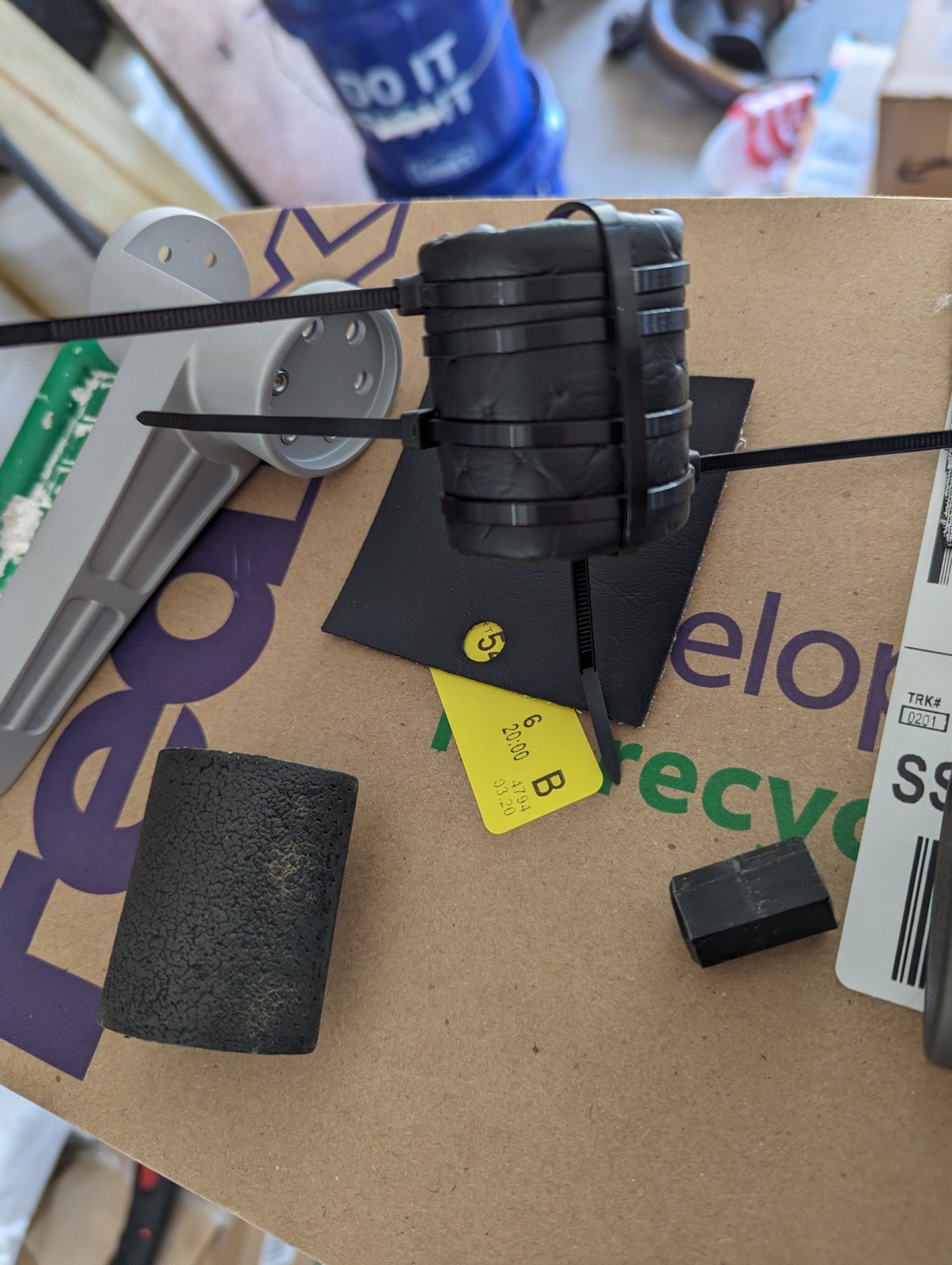

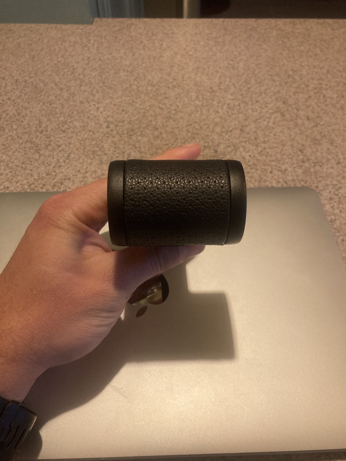

    Just finally got around to doing my first leather replacement. Went surprisingly well once the adhesive cured enough for install. Zip PXL_20240408_153111735.jpg tie marks have all relaxed with time and after being used.
    The silver one I'm debating doing the smooth leather on since I'm selling it, but curious as to everyone's thoughts on the "diamond" I put on the titanium.
    PXL_20240408_142316611.jpg PXL_20240408_142305318.jpg PXL_20240408_151846583.jpg PXL_20240408_151848619.jpg PXL_20240408_151855177.jpg PXL_20240408_151859772.jpg PXL_20240408_151913782.jpg
