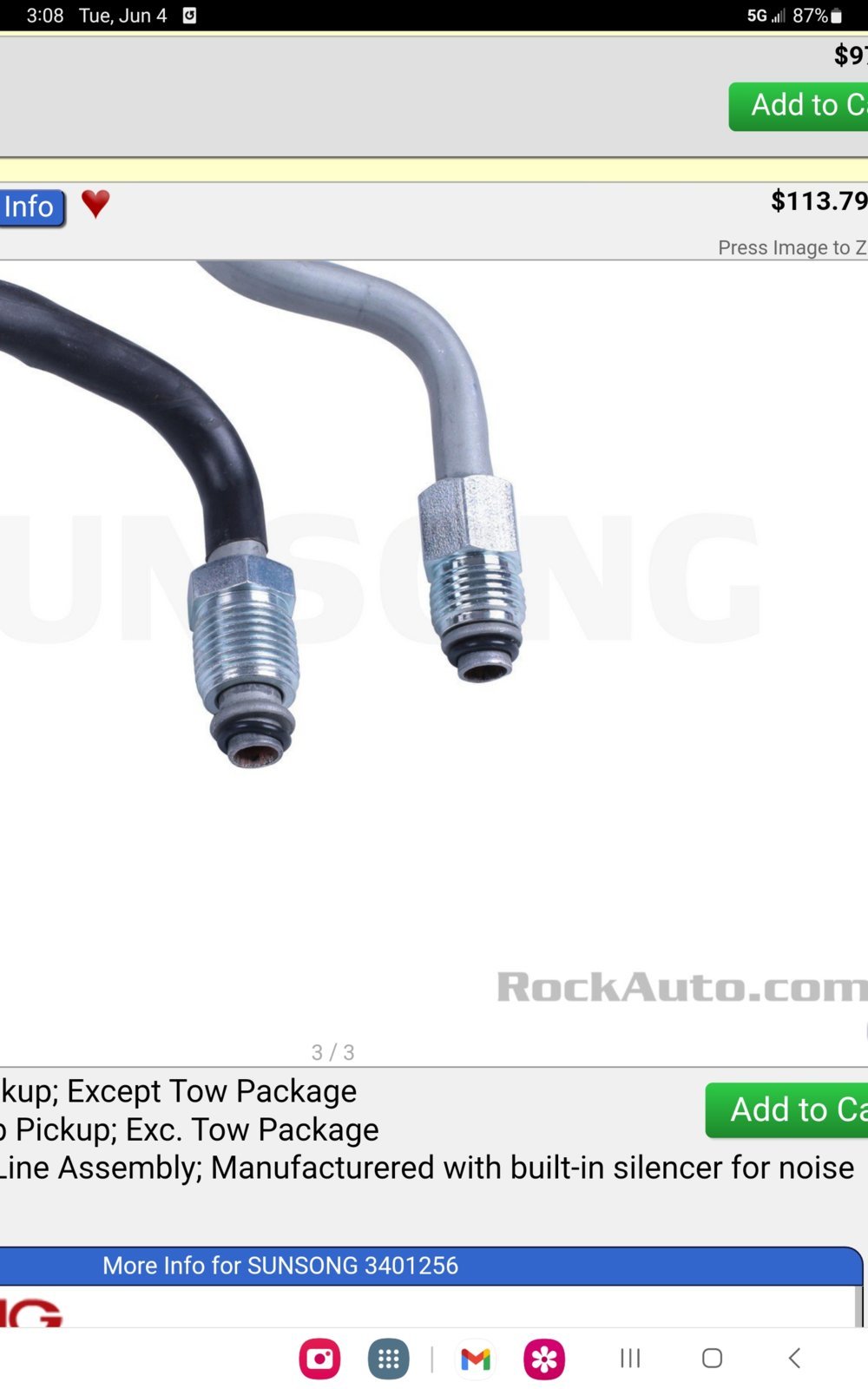

    So that part I'm not sure of. I bought the lines, but had the kids in autoshop class at the school I was working on install them.
    However, upon inspection of the Suosong hoses on RA, it looks like they do.

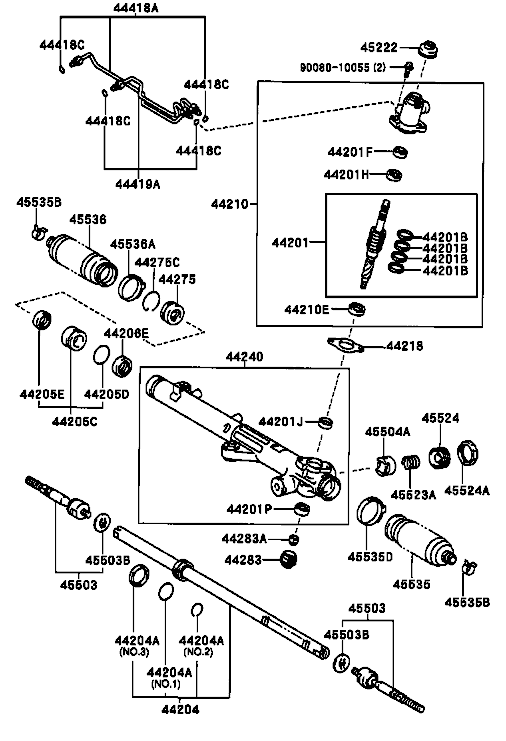

    I'm still having no luck with this. This is the equivalent diagram of what we looked at at the Toyota dealership. It does not show the O-rings

    I believe that is the part that I had found, but I believe it is for the pressure lines that go from one end of the steering rack to the other. All the racks come with that included and assembled
    These are the O-rings where the lines connect to the steering rack from the Power steering pump and the return line that goes to the PS fluid cooler
    maybe they're the same. But then they should be in one of the diagrams somewhere.

    If you can find those four O-rings for the pressure lines, which are all the same part number, then why can't you find a part number or reference to the two O-rings on the other line? There's absolutely no reference to it anywhere that's the reason we first thought there were no O-rings.
    I did just look at the old rack and those 2 both appear to be the same.
    and I don't see O-rings in the steering rack as you can see in that picture and I don't recall there being any on those two lines when I disconnected them
