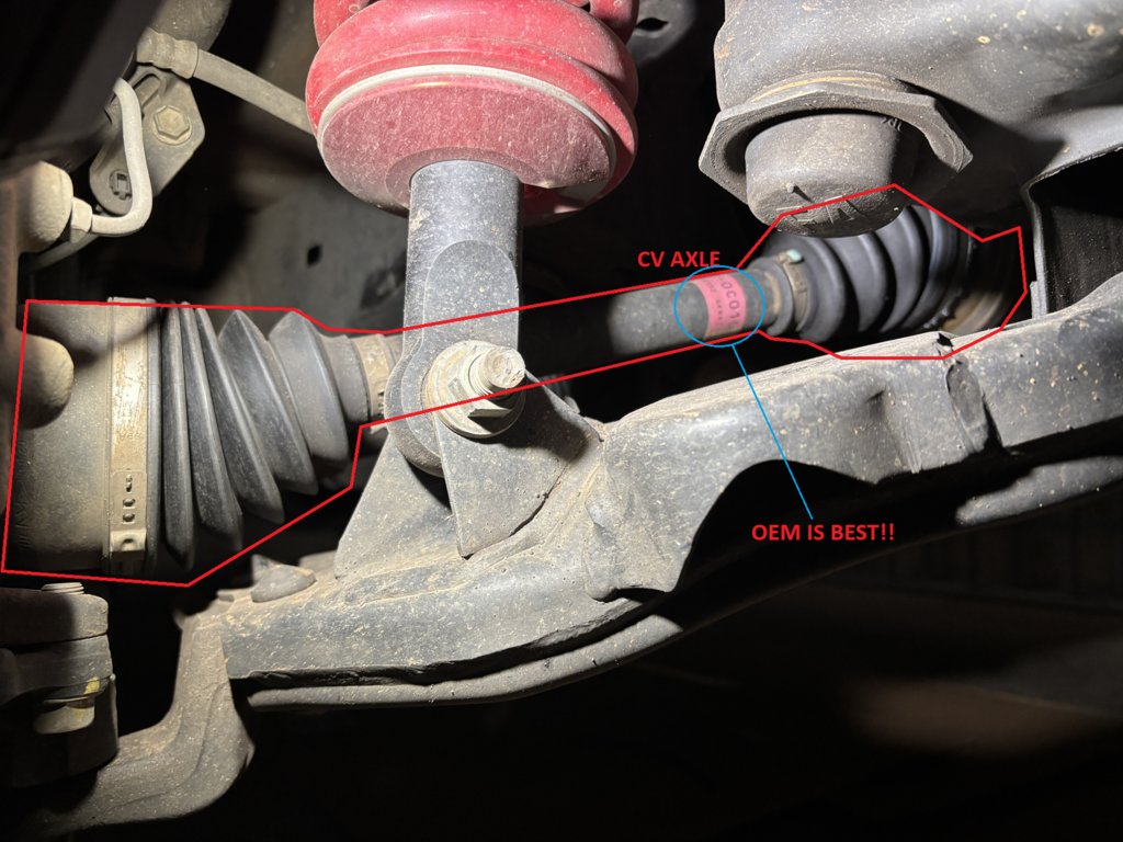

  26. Jan 18, 2025 at 8:03 PM
    #26
    Jwerthy
    Jwerthy New Member
    Nov 12, 2024
    #125786
    15
    2005 4WD DC 98K Las Vegas, NV
  27. Jan 18, 2025 at 8:03 PM
    #27
    Jwerthy
    Jwerthy New Member
    Nov 12, 2024
    #125786
    15
    How do these look?
  28. Jan 18, 2025 at 9:12 PM
    #28
    shifty`
    shifty` Countin' and breathin', disappearin' in the fade
    Jun 20, 2020
    #48239
    30,167
    ATL
    '06 AC Limited V8/4WD
    This is wrong. That nut is not tight!! Jack the truck up at the LCA ‘til the bolt is parallel to the ground and no pressure on it then tighten it properly so the cam stays parallel to the ground also. Compare to the other side if necessary to see your mistake.
    FirstGenVol, bfunke and FrenchToasty like this.
  29. Jan 19, 2025 at 5:42 AM
    #29
    Jwerthy
    Jwerthy New Member
    Nov 12, 2024
    #125786
    15
    Yes. I tightened both sides lower bolts to the prescribed 40 ft-lbs. Good catch.
    How about the bushing compression. I don't have a torque wrench that tightens to 5.5 ft-lbs, so I am hoping to go off of compression appearance.
  30. Jan 19, 2025 at 8:04 AM
    #30
    shifty`
    Jun 20, 2020
    #48239
    30,167
    ATL
    Straight from the instructions, which should've come in your package, you want the bushings to be touching metal, but not starting to flare out, or they'll wear out too quickly, i.e. vertical side walls, and not loose enough to rattle around:
    noahrexion likes this.
