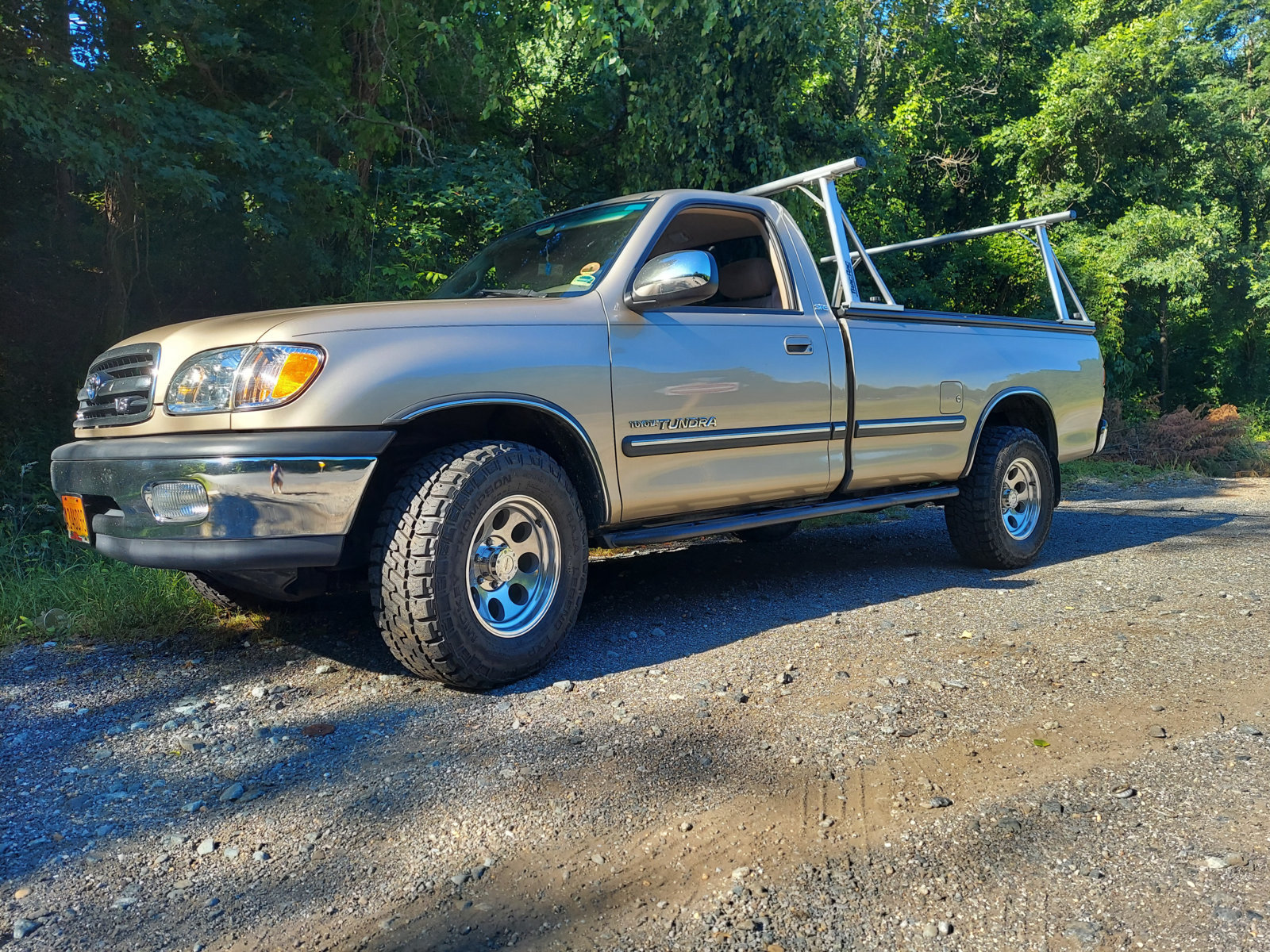

    Im trying to acheive the same as you ( i think) basicslly level front end , then raise rear when leafs start to sag.
    If I remember correctly. 2885 would give too much for might set up (3+") but i have a rclb 4x4 V8.
    Thats why I want to find people who have weighed their trucks, too help community out when picking springs.
    My sticker states mine is 6,200 LBS. What does your door sticker state. I think its close to that but I suspect it might be lighter.

    This is how mine sits stock, im on a slight grade leaning toward drivers side, but you get idea. , about a 2" rake with 120lbs slides and 350lbs box in back.

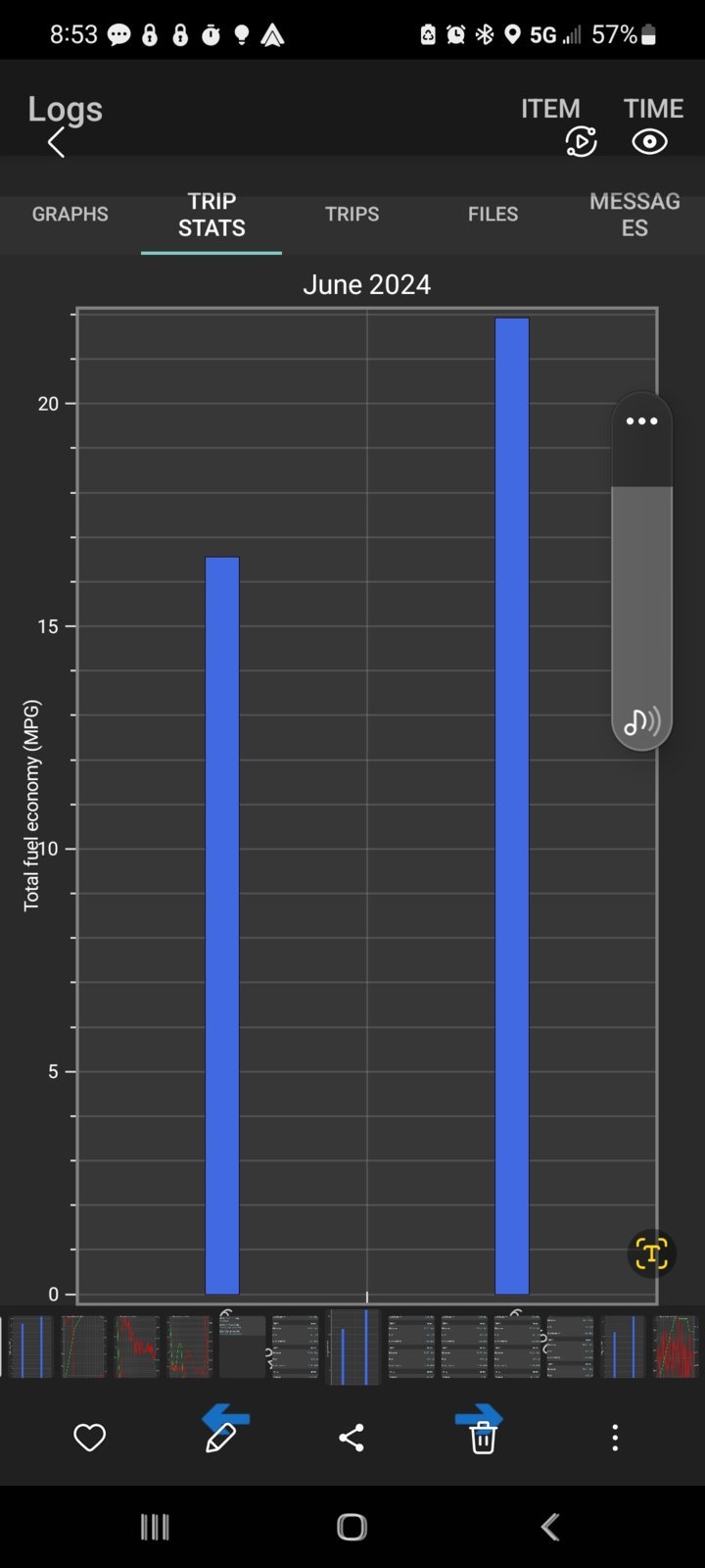

    ,( i also have some cool maf /mpg/O2 sensor info showing how load effects MPG. I know off topic, but see pics of same commute mpg with just above as payload vs addition 400lbs roll of thin aluminScreenshot_20240610_085353_Gallery.jpg um.

    The lighter tundras get decent mileage. Yours can prob do low 20's highway too. Sea level, 80*, 32", 90% 65-70mph cruising.
    Stop and go. Im getting 14.6mpg. I think you should try dobinsons bc they are extended , just like your 5100's
