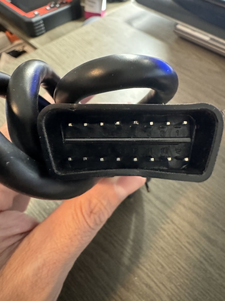

    I ordered the Launch 431x Elite from Amazon while it was on sale. Weird thing I noticed before opening it (so I stopped and didn’t open) is that it says “Creader Elite T”

    Connect it to your truck and see if it reads/functions. If not contact the seller.

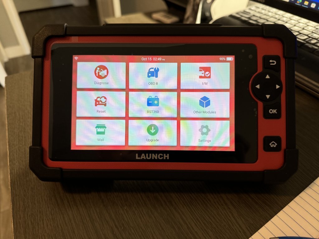

    After a bit of a delay my Launch X431 CRP919E Elite arrived. I tried to contact the seller on Amazon, but it looks like I don't have the option to do that for some reason. I'm being told if there is an issue it needs to go through Amazon for a refund or at least that's what the new amazon AI bot tells me. Not sure if this is a common theme or not, but the OBD2 cable that came with it is deformed a bit on the end that would connect to the truck. It appears to be made of a flexible rubber type material. My guess is the cable that is wound up with a twist tie pinched against the end of the cable inside the storage case. I was hoping to see if I could exchange the cable for another one from the seller. I don't want to deal with returning it and possibly getting another one just like it. I tried to persuade the rubber a bit which made it a little better. Anyways, I found a replacement cable from eBay that looks like it has a hard plastic formed end which would eliminate any deformity so I ordered one of those for about $30 which should arrive in a couple days. I also searched and picked up a screen protector for the X431, but that had it's own issues. It claims it's for the X431, but the screen protector is too small. I see others that posted the same comments under the reviews...I should have read those first. If anyone has found a screen protector that fits please let me know. Played around with it a bit and am pretty impressed by all of the functionality this little unit can do.
    Rugerla1 likes this.
