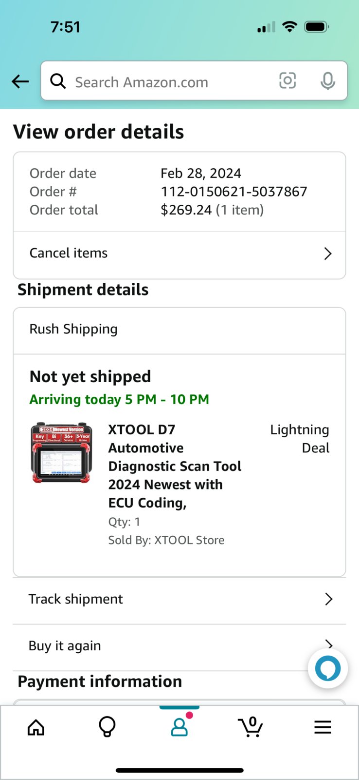

    Lightning deal on the Xtool D7 just snagged
    OldGuy03, AZTundra and Ohannon7 like this.

    I would make sure the D7 in your post has the same functionality to reset fuel alcohol calculation as the D7S that you have used.
    If so, that is a good price.
    ToyoMafia[QUOTED] likes this.

    Tampa to Naples isn't far so that would be really appreciated but this lighting deal has me really thinking about buying it, especially since this seems like an ongoing thing I will need to do from time to time.

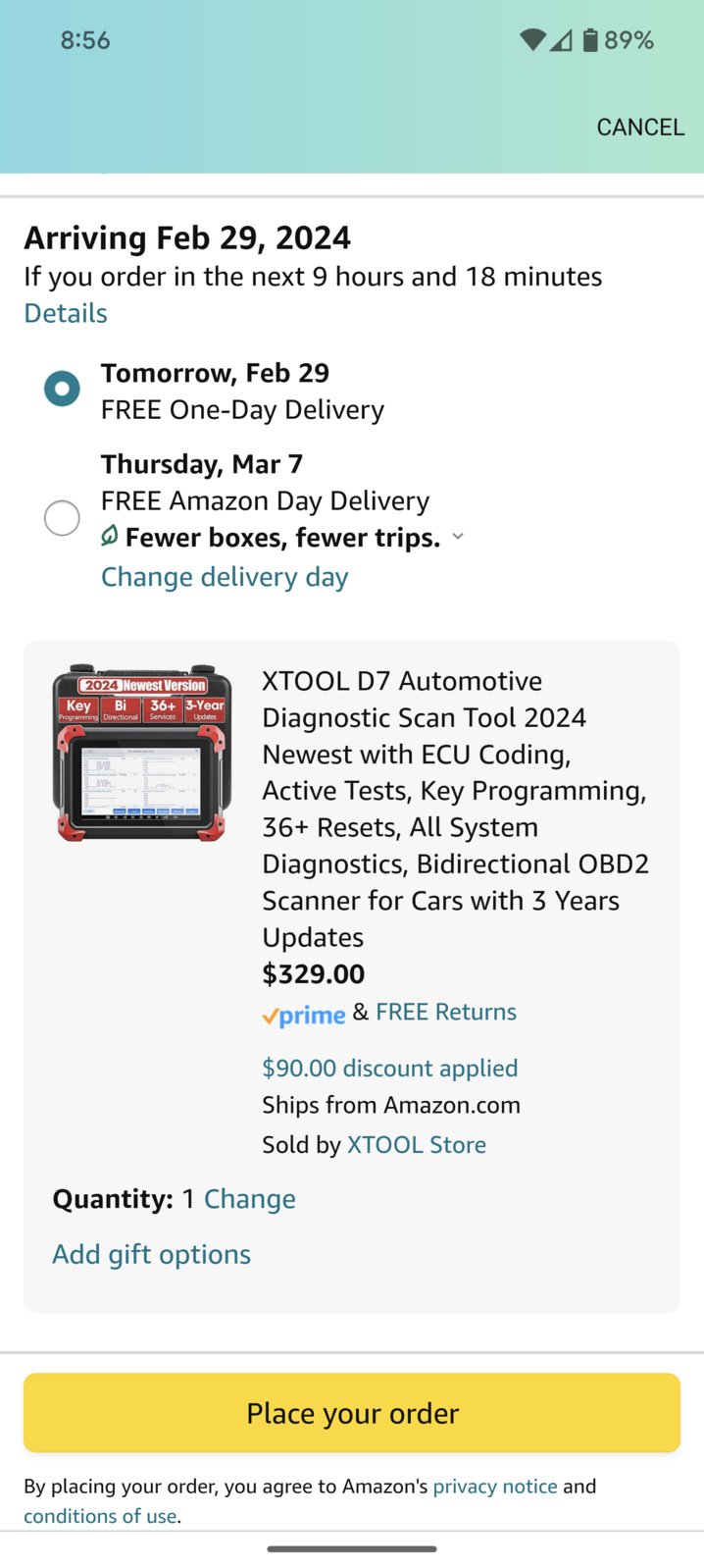

    I've been trying to buy it but it's $329 for me. Idk how you got it for $269. This isn't the first time Amazon won't give me the lower price that others see either, it's very odd.

    When originally posted, there was a $75 coupon in addition to the lightning deal price.
    ToyoMafia and Ohannon7[QUOTED] like this.

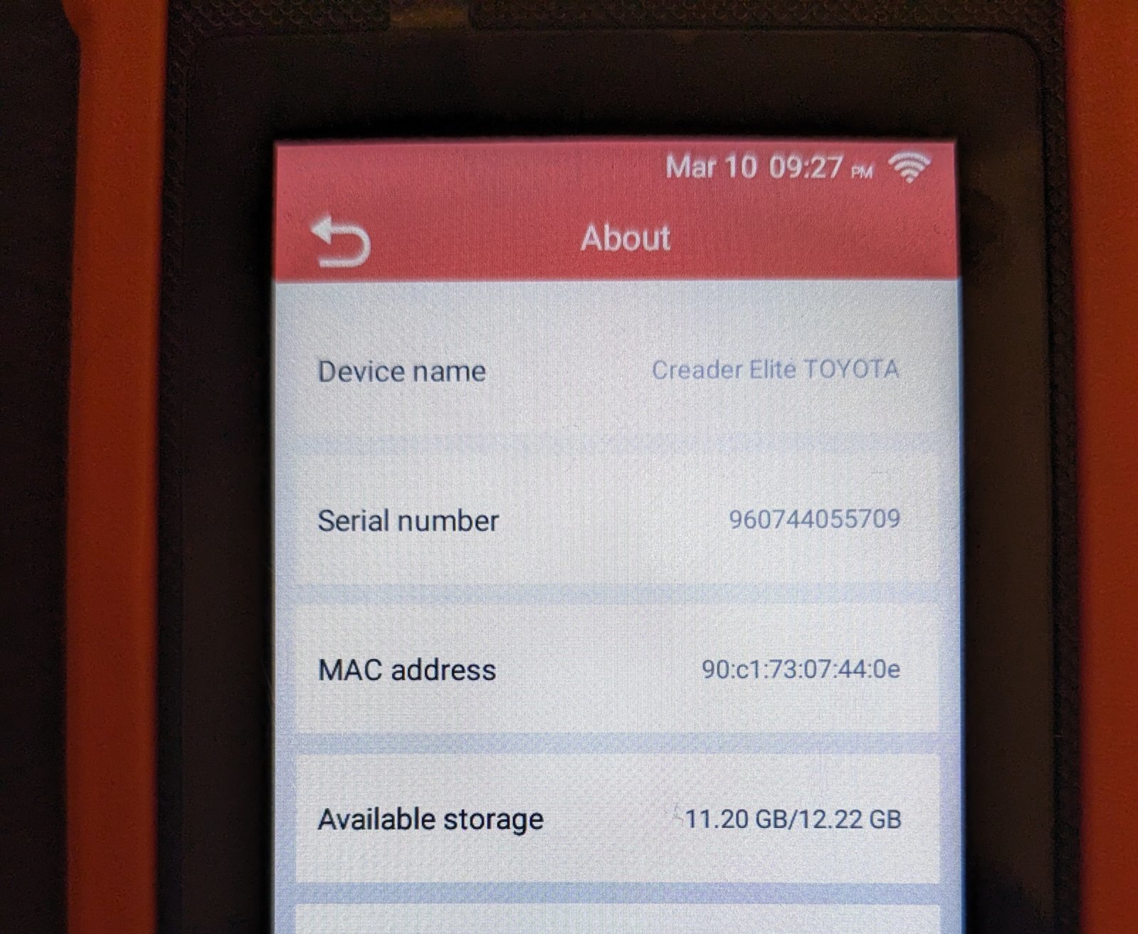

    Just arrived.

    @texasrho83 What is the UPC/Part Number on the one you received? There are a bunch on Ebay, not sure if there any different models.

    2016 DC MGM 4x4
    See build link
    #88
    kbahus[QUOTED] likes this.
